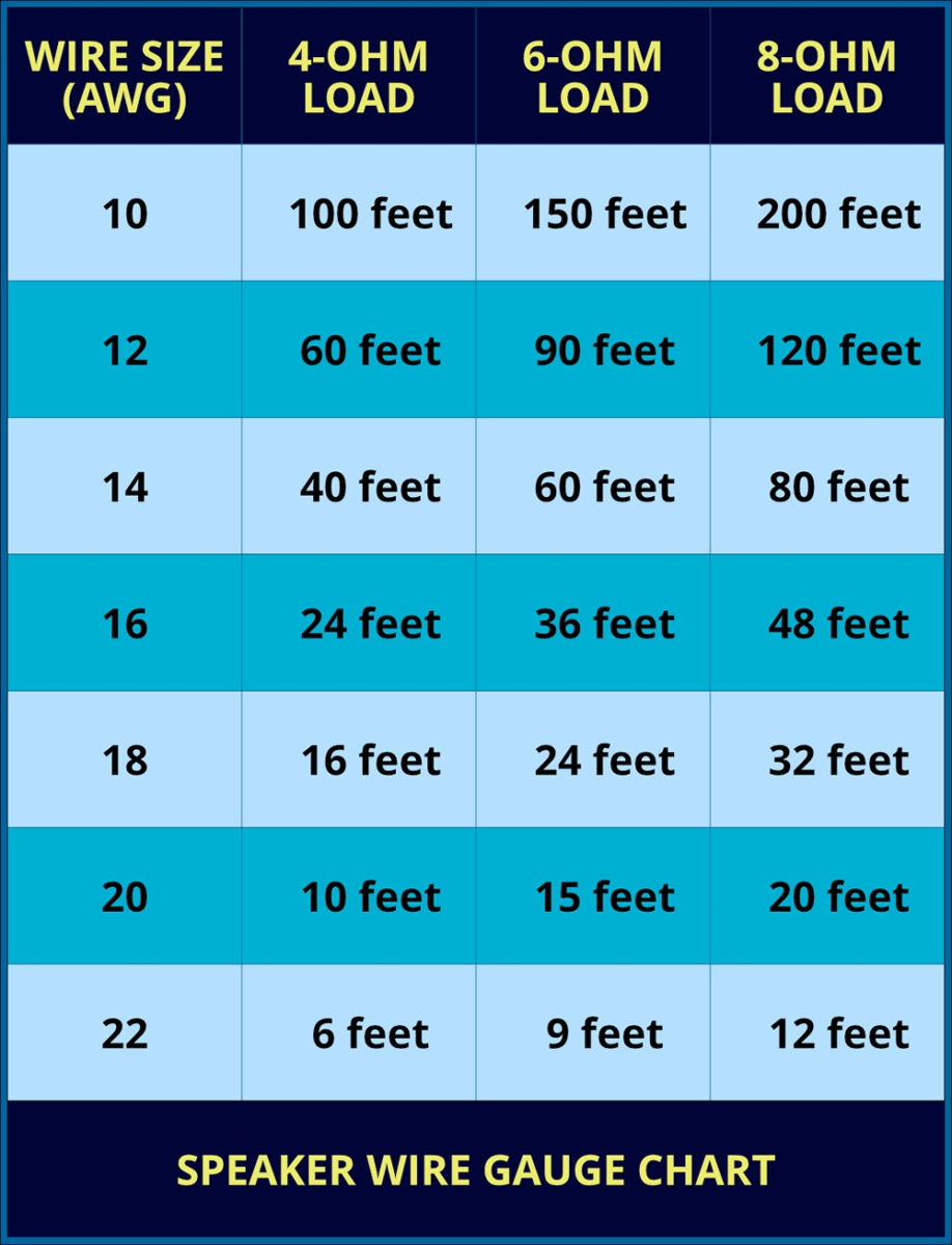

The one question I am asking of stereonet theatre users today is what to do with the cabling from the right rear of the theatre to the front wall sound stage?
My preference is to use a long speaker run, with processor and amps located in an equipment rack.
The alternative is to use balanced cables from a processor in the rack, and locate a 6-ch power amp in the theatre front for the L, C, R and also a stereo amp (large) for the passive subs.
From a neatness perspective, I would prefer to run speaker cable and keep all the electronic gear in the one location, with good ventilation/fan use outside of the theatre walls.
I am getting advice on the build and the design.  However, this is an issue which I haven't yet broached with people I trust.
Hence my question to you.
Is a balanced solution going to be that much better/needed for some reason vs speaker cable (14 AWG)?
The cable run will be about 15 metres.

The Hyperphonix 45s are rated as 8ohm. So 14 gauge should be fine for 15m.

The MX-40 LCR and passive subwoofer modules are also rated at 8 ohm impedance.
They are the speakers with the long run.
Thanks for the simple advice.
Benje
@Benje assume that you are in discussion with Krix about the best way to connect their system in your installation.
Since the cabling will presumably be in wall, then you won’t have a 2nd chance to vary things if there is a problem?  For a small cost, you could easily run the additional XLR interconnect cabling alongside the speaker cable. Then, if there is noise/signal degradation on the speaker cable, the XLR interconnect is already in place.

Don’t run the power cable and speaker cable side-by-side.
  • Author
NO!
Actually, your advice and cdave's has clarified what I will do, and what I can do if I get problems subsequently.
I'll install the amps in the rack, and have a long feed with 14 AWG to the front speakers.  These will be wired around the rear and left of the theatre in a sub-attic (there is a large open-air space under the roof surrounding three sides of the theatre).  The speaker wire will be kept away from power. The sub-attic is about 3 metres by 3 metres with a diagonal roof.  Easy to work in and / or store 'stuff'.
In the event that I have problems with noise/degradation etc, then I can use XLR cables on the outer wall where the speaker cables will be, and come out by the front speakers.  There is power there already that can run the front amps if they are relocated.

Benje there may be an argument for locating the sub Amps closer to the drivers and/or using a thicker speaker cable, due to the higher power demands and increased driver control. Krix will be in the best position to advise you.
