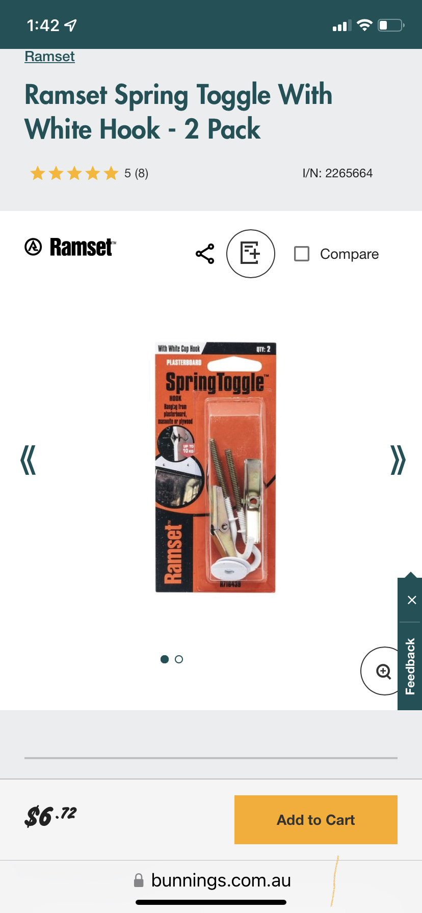

What might be appropriate ways to secure the nylon cords emanating from the Megasorber panels/frames to the ceiling? Options appear to be Ramset Spring Toggles, Toggler Toggles, etc.

The options you mentioned would be fine for that weight (they specify their holding weight on the packets).  Hopefully you'll be lucky enough to have some purlions/joists at some fitting points as well to screw directly into.
I’ve successfully used these
  • Author
Thank you. I checked those out yesterday. Expensive little buggers, for what they are!
Toggle bolts are perfect for your situation. Don’t pay the Bunnings tax. Check out your local electrical wholesaler and save.
