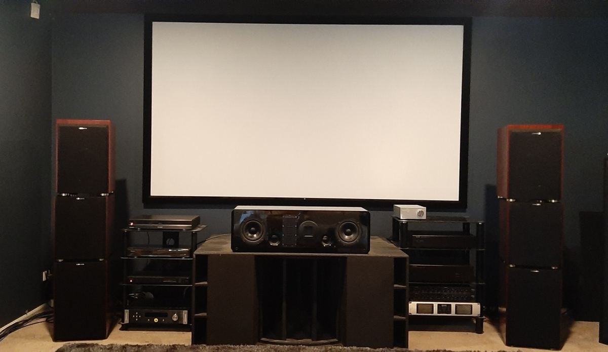

ok, so, the active speaker project that ended up in the home theatre, is about to go through another round of development.
As a reminder, here they are, in place.
Edited by Sentient

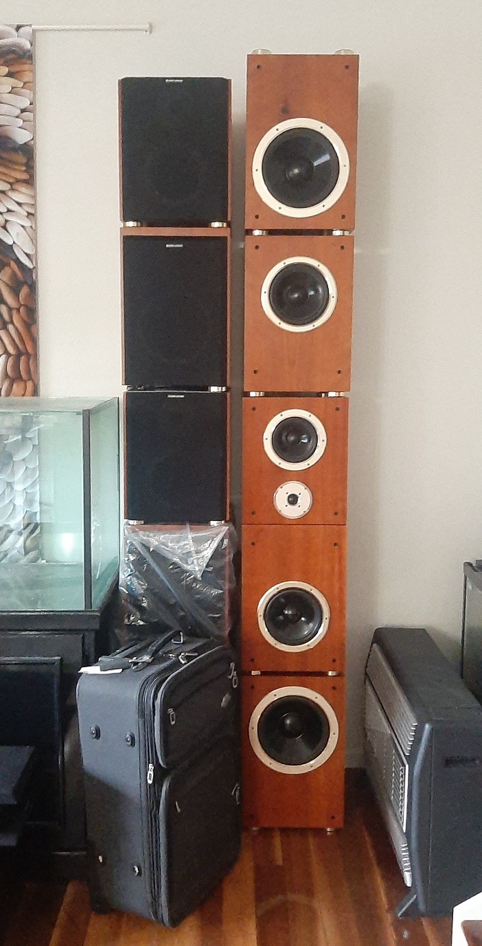

I'm planning to add more bass drivers.
And they could look like this......
Edited by Sentient

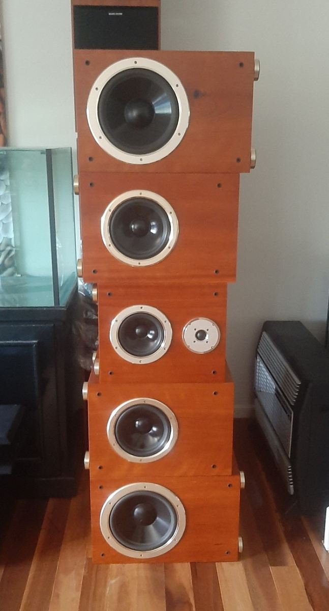

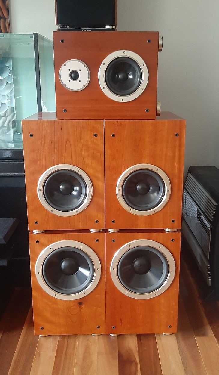

  • Author
or this.....
  • Author
I definitely prefer the 'look' of the monster tower.   Although mildly concerned about bass wave cancellation.
The latter image will probably blend better, but the aesthetics arent really doing it for me.
Was that the Mrs packing her bag……..😀
  • Author
lol, i put the suitcase in there for scale. 🤣
havent had to answer to one of those for many years. 😎

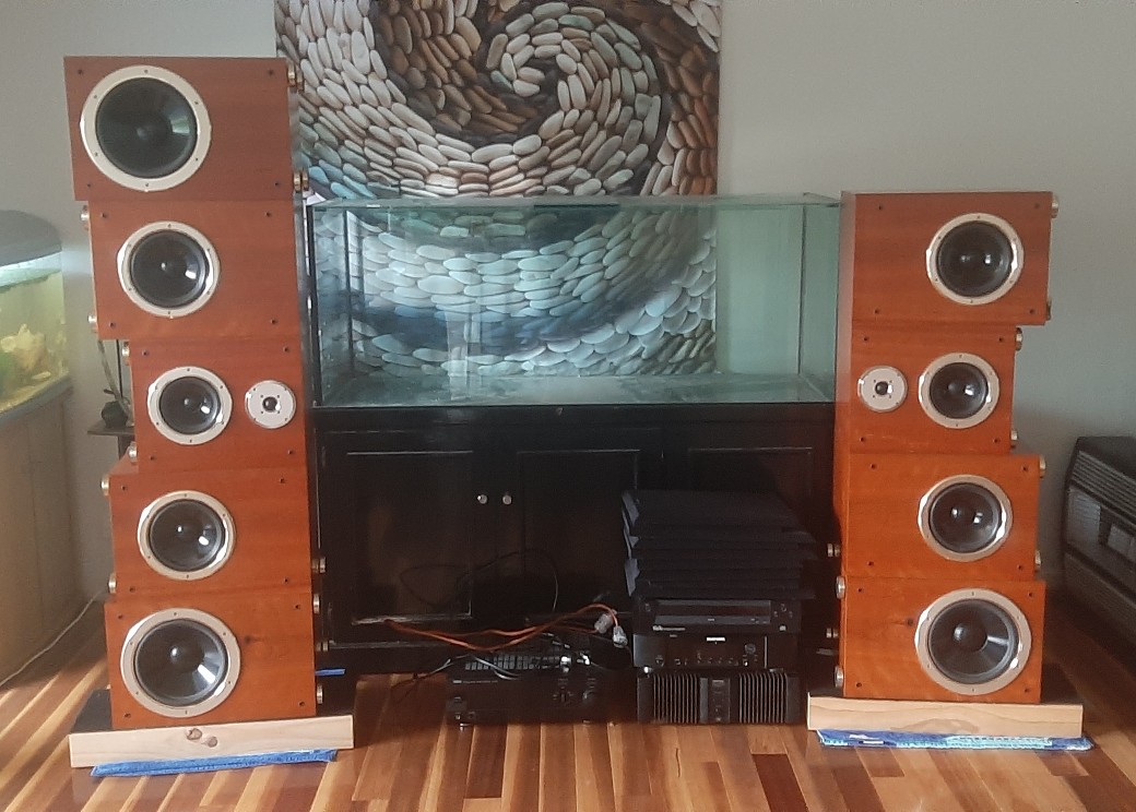

  • Author
kinda leaning towards this, but with an additional box on the right. 🤔
  • Author
Ok, I got the other box out.
Quite like the tower on the right.
@Sentientwhat will live between the speaker towers?  I remember my sister once had seahorses and they appeared to react to certain types of music as they would swim up and down vertically in the tank and all other types of music they wouldn’t react.
  • Author
Hey, they're currently standing in a temporary build location.   That empty tank is due to be given away,,, it has developed leaks, and I am not interested in re-sealing it.
These towers will end up in my home theatre, if they sound another notch up, on what I did previously?
Edited by Sentient
Your speaker setup reminds me of B&W Matrix 800.
