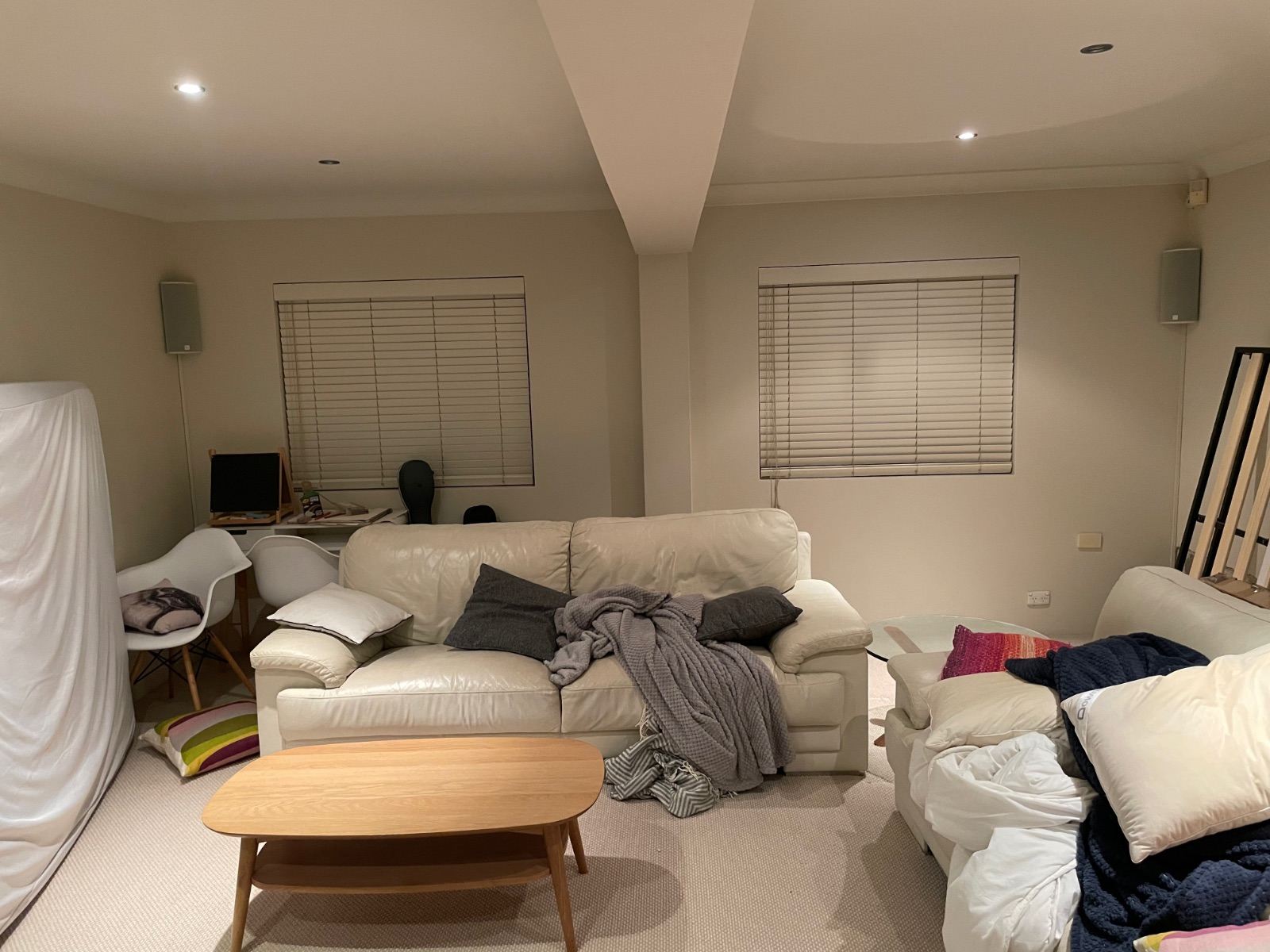

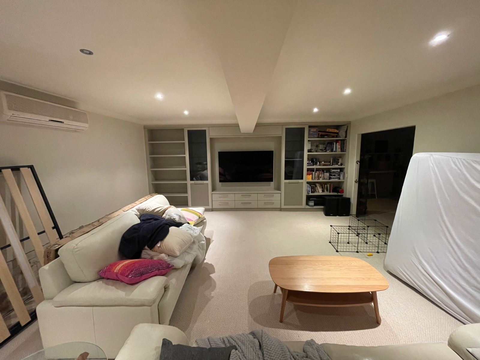

We bought our first house which is a 1979 build. It has a large Living Room that I will be slowly transforming into a dedicated home theatre.
This is its current state, please excuse the mess, one of our walls is being repaired from some water damage:
The room is: brick rendered
 Ceiling Height 2380 mm and there’s the centre beam drops down and is 2040 mm from the floor. Length of room is 5620 (tv cabinet to back wall with windows) and width 5130.
Right now I have a 65” LG OLED, We are getting the house re-carpeted, so we have to do the lounge room now. The walls are getting repaired and rendered, I’m getting a nice dark grey carpet and will be painting the walls a slightly lighter grey.
I’ve already got my couches picked out (which might be a mistake in hindsight for viewing distance for the OLED TV but my end goal is a full on home theatre with projection and that’s my starting point so that’s that.

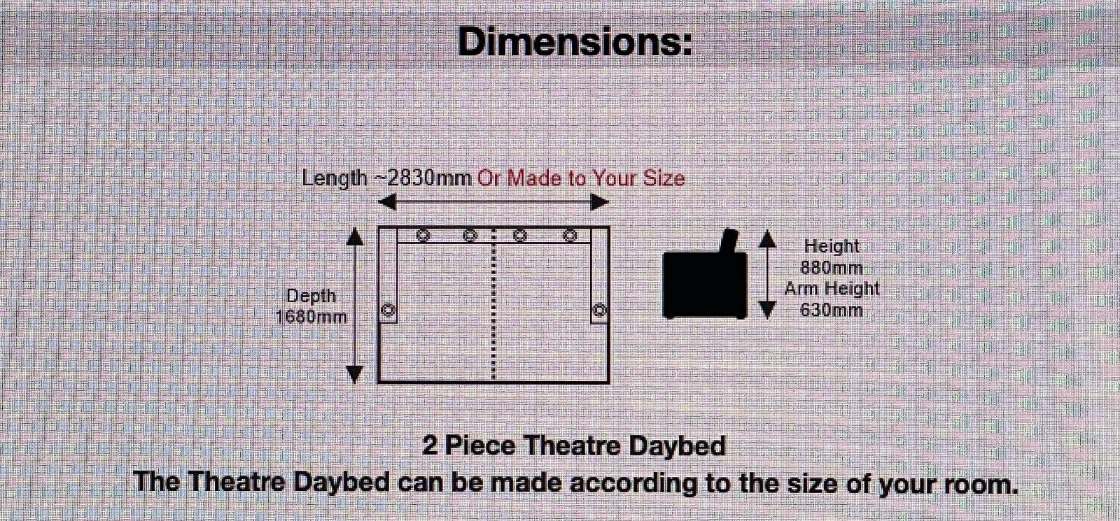

we’ve picked the day bed in a dark grey and the Theatre Seats are leather.

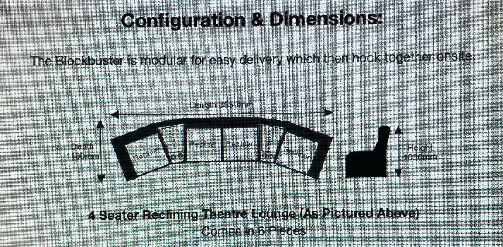

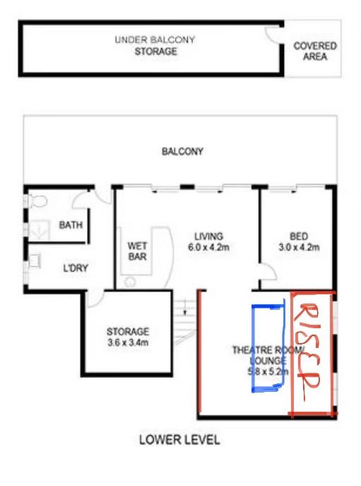

I’ve also measured the Theatre Couches and they are 1870 mm fully stretched out. I’m thinking of getting a riser made that’s 2 metres stretching the width of the room and will build is 300 mm high (lowest height recommendation) this will pose problems because of the structural beam but I’ll need some sort of riser to get over the day bed, so I think this is the best idea.
So my first question do you think this 2 metre Riser is a good size or should I make it bigger? The larger I go, I’ll be pushing the Day bed towards the TV

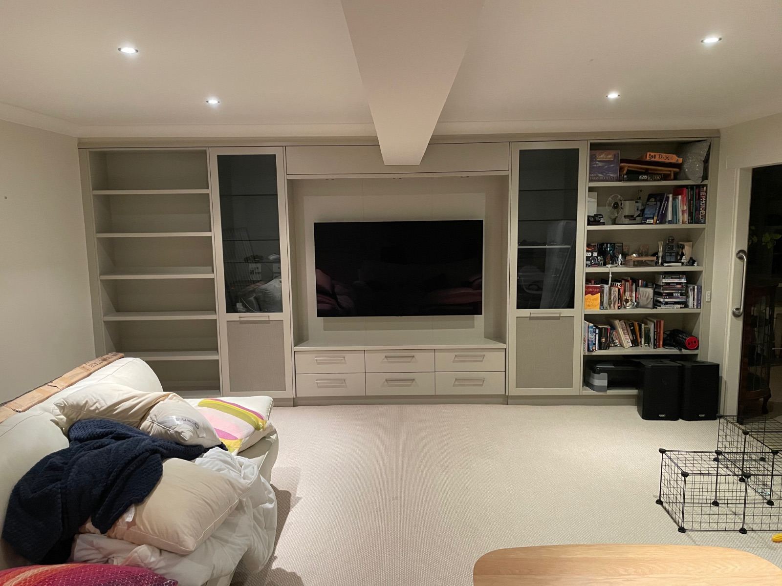

I really like that room, even the existing cabinets.
Ideally you want some space behind the seats so speakers aren't directly in your ear, but that brings everything forward. Where will the MLP be? Day bed or recliners? If recliners, move them forward, if day bed stick with what you got. It's best to not have seats against back wall. Do you need 6 seats?
I don't think your screen is big enough, be ok for day bed but not the rear seats, it's a big distance from the recliners.
I also use a 65 TV, I sit about 3.2m from screen and I want a bigger screen. Projector in that room would be ideal, otherwise 85 inch TV minimum.
Please keep posting progress, could be a cracking room.

The 65" is not enough IMO as well, I will be saving for a projector and screen in the future, i'm hoping I can possibly repurpose the cabinets, by moving the two glass cabinets together and making the AV rack (possibly on the far left of the room and then opening the middle section up, getting speakers behind the screen, sort of deal.
I actually moved one of the couches last night to get the ideal viewing distance for the OLED, like you said 3 metres is what i read as well (1.8 to 3 metres)

WE need the Day bed to act as a quasi fold out bed for guests, as we have a 2nd child on the way, so downstairs lounge room, will suit family members staying over.

riser: 2 meters deep remember to leave room to actually walk on the front of the riser. this can be made difficult with recliners on the back if one person is reclined and one person wants to leave etc etc. reason why my recliners are at the front, i sit the rear on a couch.
but the problem with that is sitting at the front with a large projection screen may not work for some people, although you have the choice of swapping to riser later. the thing with the recliners at the front is the screen height from floor. you dont have a lot of room so it will be under or close to 600mm most likely. i found 600mm is about the lowest you want to go.
get rid of all that stuff at the front when you go pj and do a diy spandex A/T screen. not sure why everyone keeps there av gear at the front as it limits screen height. lower gives much more immersion imo.

Why don't you switch the couches. Have the recliners at front and mlp. Then riser has day bed, you wouldn't need much riser in front of it. Viewing in the front row would be ideal I think. My recliners are middle ish, but my room is 8m deep. Even with projector front row would be immersive and good.
I like the shelves, try to keep some of it.

I like this idea, I'm going to defiantly try it both configs, I'm thinking of making the Step 2200mm, will double check with my Brother in law and see what he thinks. Hopefully get some more pictures up over the next few weeks.

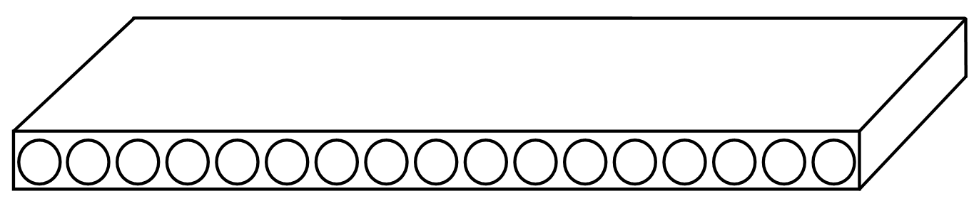

If you could increase the riser height to about 330mm, you could fit in 16 of the $AU98 12" JBL Stage 1210 subs facing forward in the front of the riser.
Now power it with a a Behringer NX6000D ($900), or other pro style PA amplifier, and this would be an absolutely insane amount of bass, for less than the price of a pair of SVS SB2000 Pro subs ($3000).
These are highly regarded "bang for you buck" subwoofer drivers (also called JBS CS1214 or JBL CX1200), and because they are so cheap, you can get lots of them, which means that each cone hardly has to move to get enough SPL, which in turn means that there is really low distortion and clean bass.
The 12" driver in the SVS is better than the JBL, but if you're comparing 8x JBL to 1 SVS, the 8 JBL will have far more clean output, headroom and just wipe the floor with the SVS. If you're interested, we could model this in WinISD for you to see how it'd perform.
Alternatively, even 4 or 8 of the JBL drivers in the riser would give you some amazing bass for a fraction of the cost of commercial subs.

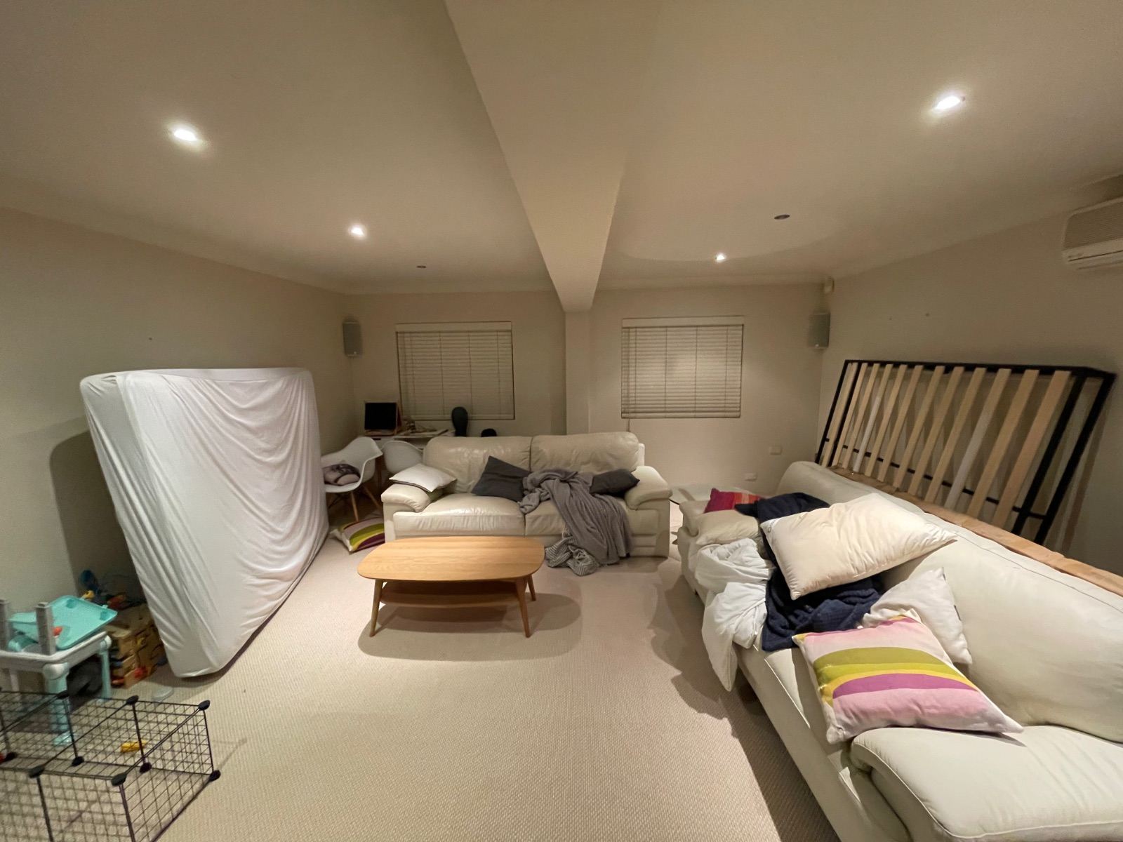

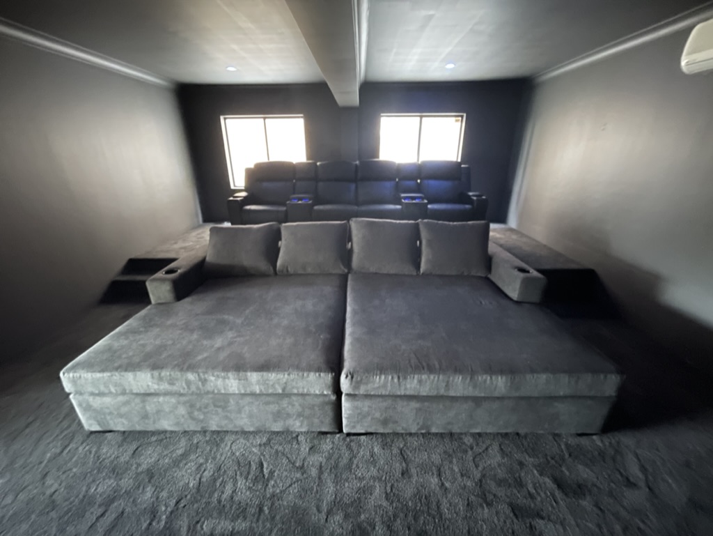

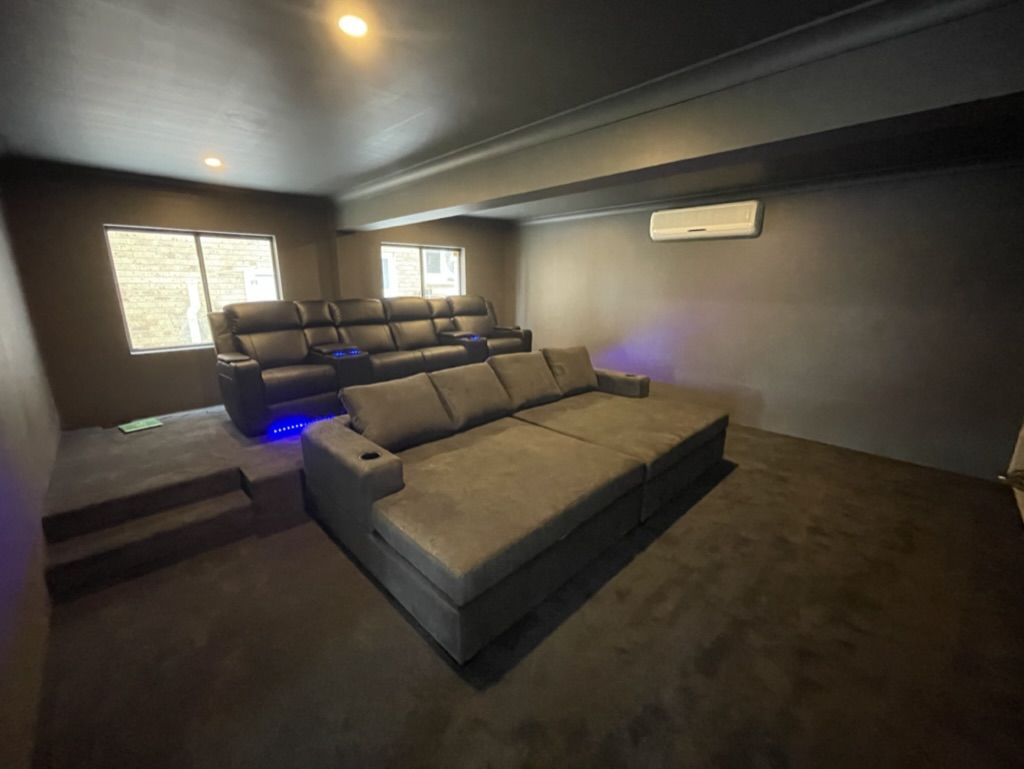

Made some updates, it will be. awhile before I can get an actual projector or home theatre, but its a great start!

Just discovered this thread. Great build Ben! Really excited to watch the progress. Have you considered a motorised projector screen to roll down just in front of the existing cabinets?
Have you considered a BOSS or HoverEze setup built into the riser? Think of subwoofer drivers installed in the riser facing up at the recliners with a plywood board suspending the recliners above sandwiched with bike tubes that seal the drivers. I've been working on this type of setup in my room for a while. Just waiting on my builder brother in law to help with cutting the plywood.

thanks Justin, the plan is to get a projector and either pulldown screen in front of the cabinet, i'd love to ditch the whole cabinet and put in a Krix  modular system  behind the screen type setup, but there's some saving to do!
One step at a time! I actually think your cabinets work well in the room and give some good storage. You might even be able to get creative with some built in acoustic panels down the track. :) You have lots of flexibility with that riser setup too. Keen to see the room progress!

Well we just had another baby, so with two kids, the home theatre updates have taken a back seat!
We've got new pulldown blinds and i've got some hardwood doors, that i need to stain and get them installed. I've got some money tucked away (if the wife can't find it) so hopefully i'll be able to get some audio components to get me through in the new year.
