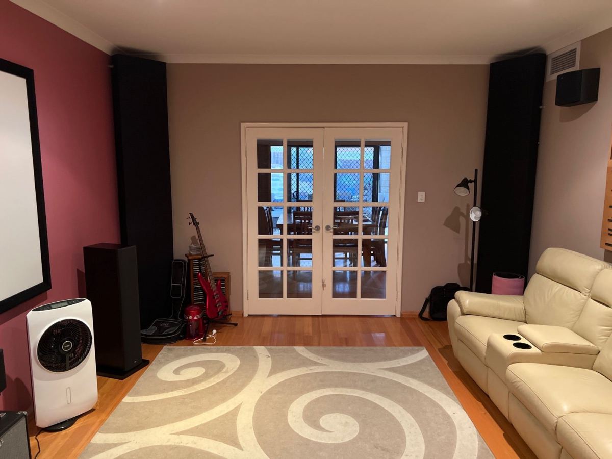

On 03/04/2022 at 7:15 PM, Adrian123 said:
Thanks for your responses. Im leaning towards a sold doors currently. Im presuming they would be a much better acoustical wise vs holllow glass French doors
Acoustic engineer's advice.
If it's shake and rattle that is the issue, I doubt the glass panes are what's rattling? Add Raven RP48 door seals from Bunnings. This will stop the doors rattling in the frames and give minor breakout improvement, although the gap under the door will remain an issue.
If you want to control sound breaking out to the next room. You will need to include an acoustic drop seal which needs to be machined into the bottom of your door. Otherwise you are wasting your time going for solid doors over what you already have. It must be airtight on all four sides, including where the two doors meet each other. And solid doors core, 53mm or greater. 10.38lam in a French door would help. If you go solid doors or 10.38lam, they need to overlap with acoustic seals where they meet.
