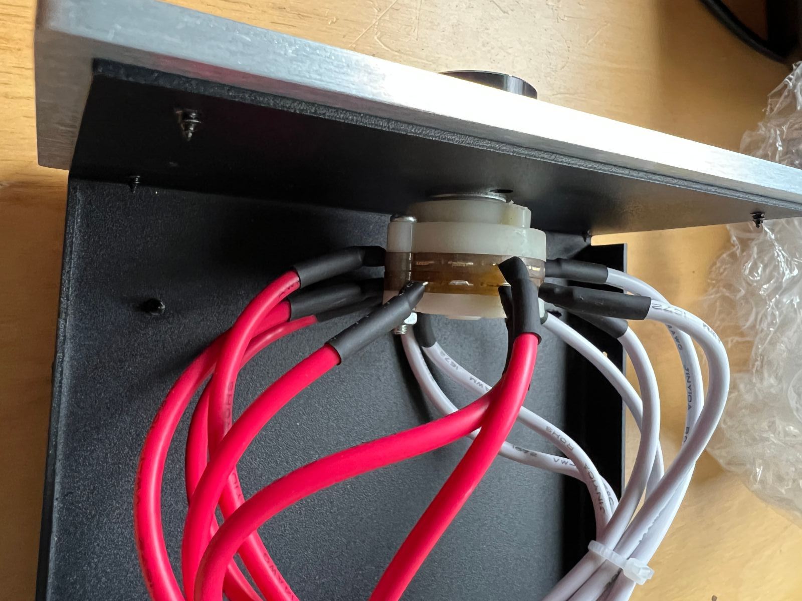

Tweaky Posted March 29, 2022 Posted March 29, 2022 (edited) 10 minutes ago, rocky500 said: If you use a device like this above, do you have to turn off the amps first before switching? Also if you don't and switch to the Solid stare amp, then do you have to make sure the tube amp is turned off as in it no longer has a load from the speakers? Supposedly reading info on line, tube amps need a speaker load while on at all times? I'm just reading the instruction manual that can with the switch unit and nothing is mentioned about this.[Not much info in the manual anyway ] If the switch unit works like a dummy load for the amp that is switched out, but not off, is I suppose what is needed to be known. That I don't know. I've got the unit in front of me, I'll take the casework off and take a photo of the internals, then possibly somebody can look at it and work out if its safe to do what you are asking about. Edited March 29, 2022 by Tweaky

Tweaky Posted March 29, 2022 Posted March 29, 2022 Well as expected there is really not much to see apart from it being well built. 1

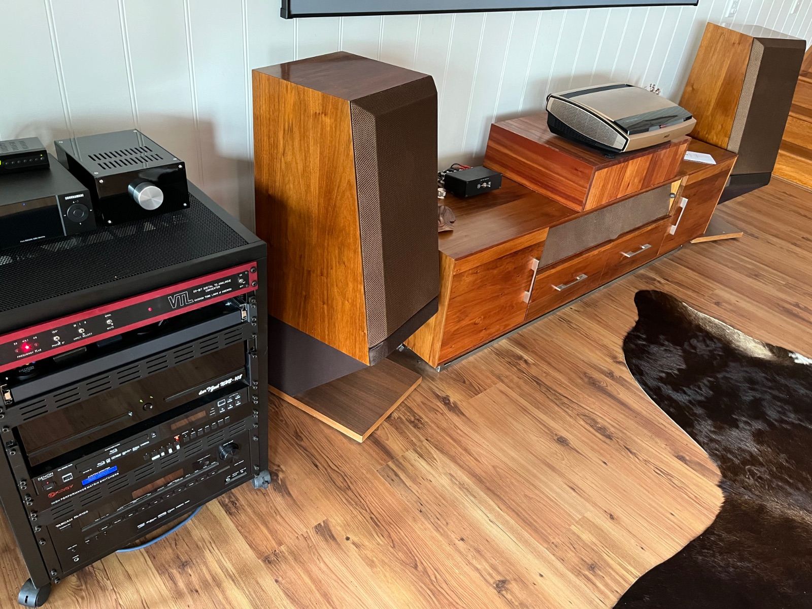

MattyW Posted March 29, 2022 Posted March 29, 2022 I do switch between two amps and a single pair of speakers for my 5.1 movie viewing and music though not Klipsch La Scala's. I've a pair of restored B&W DM-16 speakers switched between a Denon AVR and a darTZeel NHB108 circuit based power amp with VTL Reference DAC & TVC pre for music. I prefer to run all channels from the AVR for movies as keeping the sound coherent between channels is somewhat more important for movies than anything else and the Denon does a fantastic job of this despite a hodge podge of DIY centre speakers and surrounds. Sounds fantastic. An old photo when I had the Tascam PA-R100 in there, it did nowhere near as good of a job sonically as the Denon I now run.

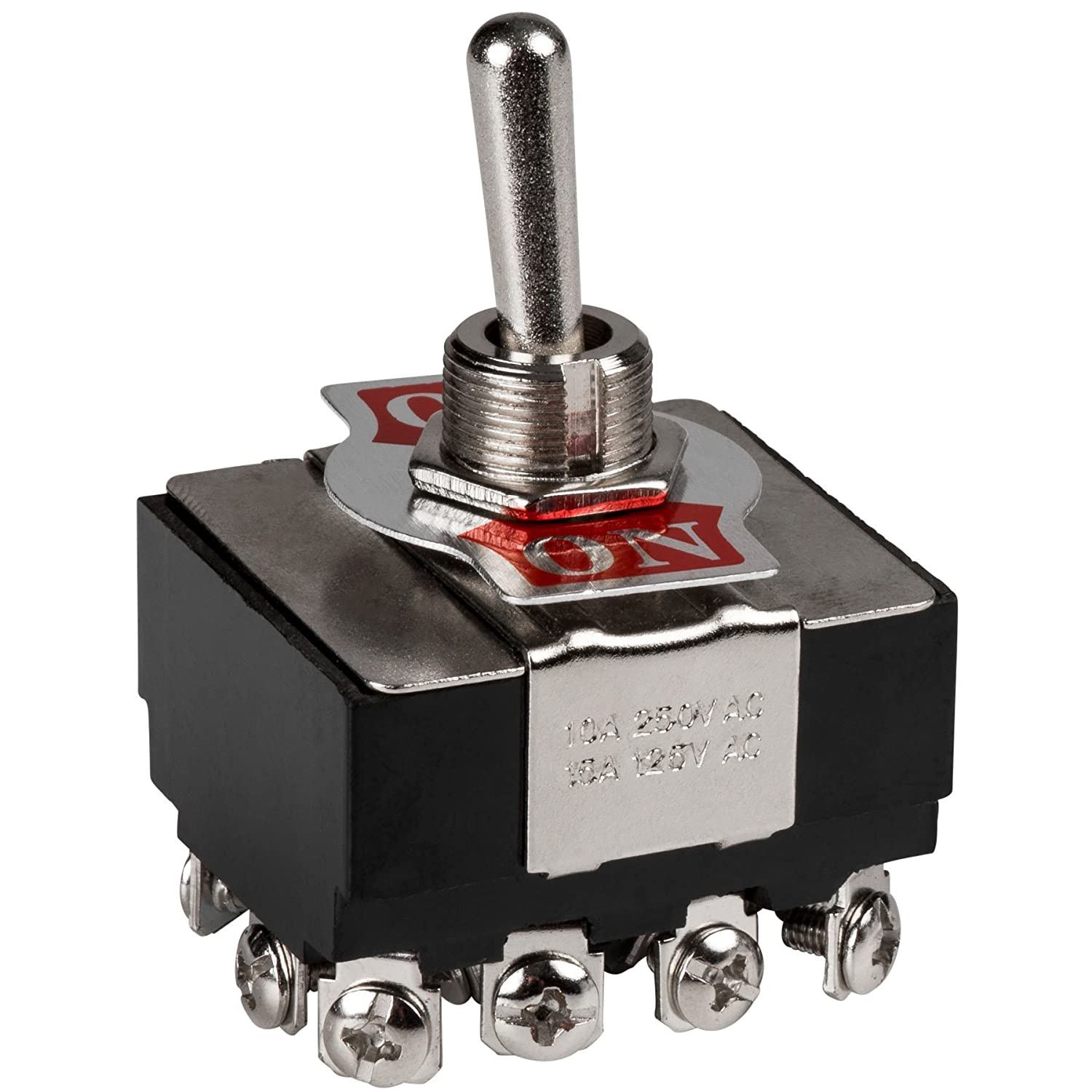

Guest crankit Posted March 29, 2022 Posted March 29, 2022 A inexpensive option is using a 4pdt switch
