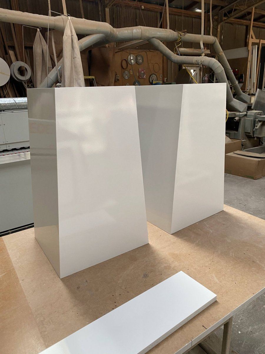

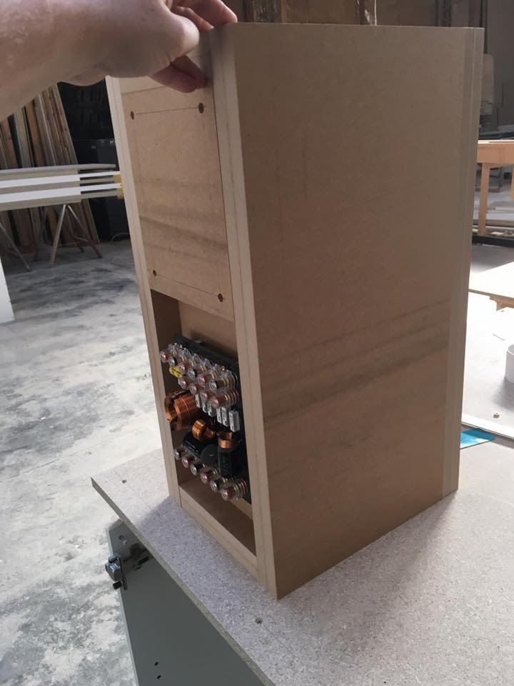

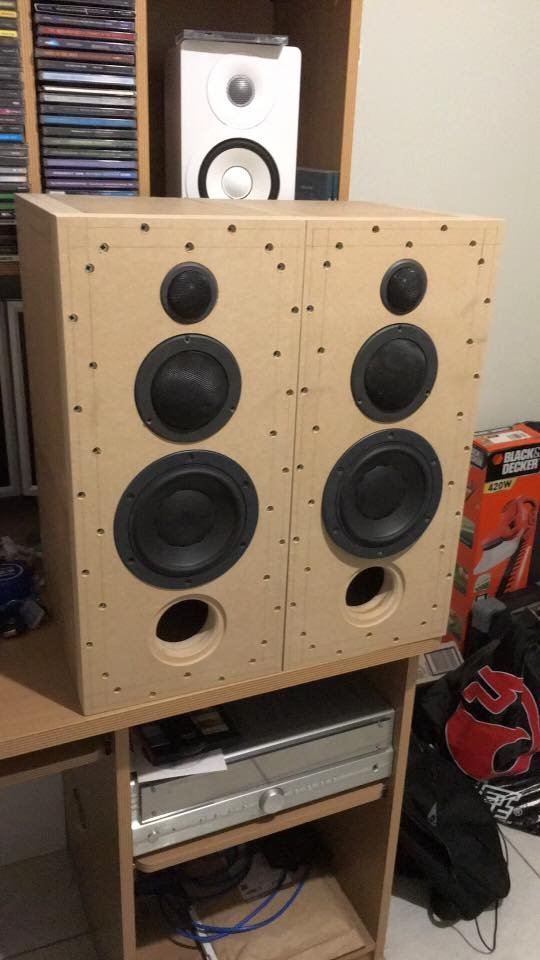

Eventually, I bought my first entry level amplifier and started from there: a Cambridge Azur 551R, bought from a good friend of mine.  I had a spare pair of Dyn Audio Esotec 242 2 way component speakers and together with a pair of MD140 midrange drivers and some customised 3 way passive crossovers, set out to build a fantastic pair of bookshelf speakers.  I designed, built and painted a pair of ported enclosures,  These enclosures are made with 36mm MDF on sides, top and bottom with 50mm baffle and 72mm rear panels, braced and lined with sound diffraction foam panels weighing in at almost 40kg each.  Each of these enclosures were laminated and then high gloss white painted in two-pack.

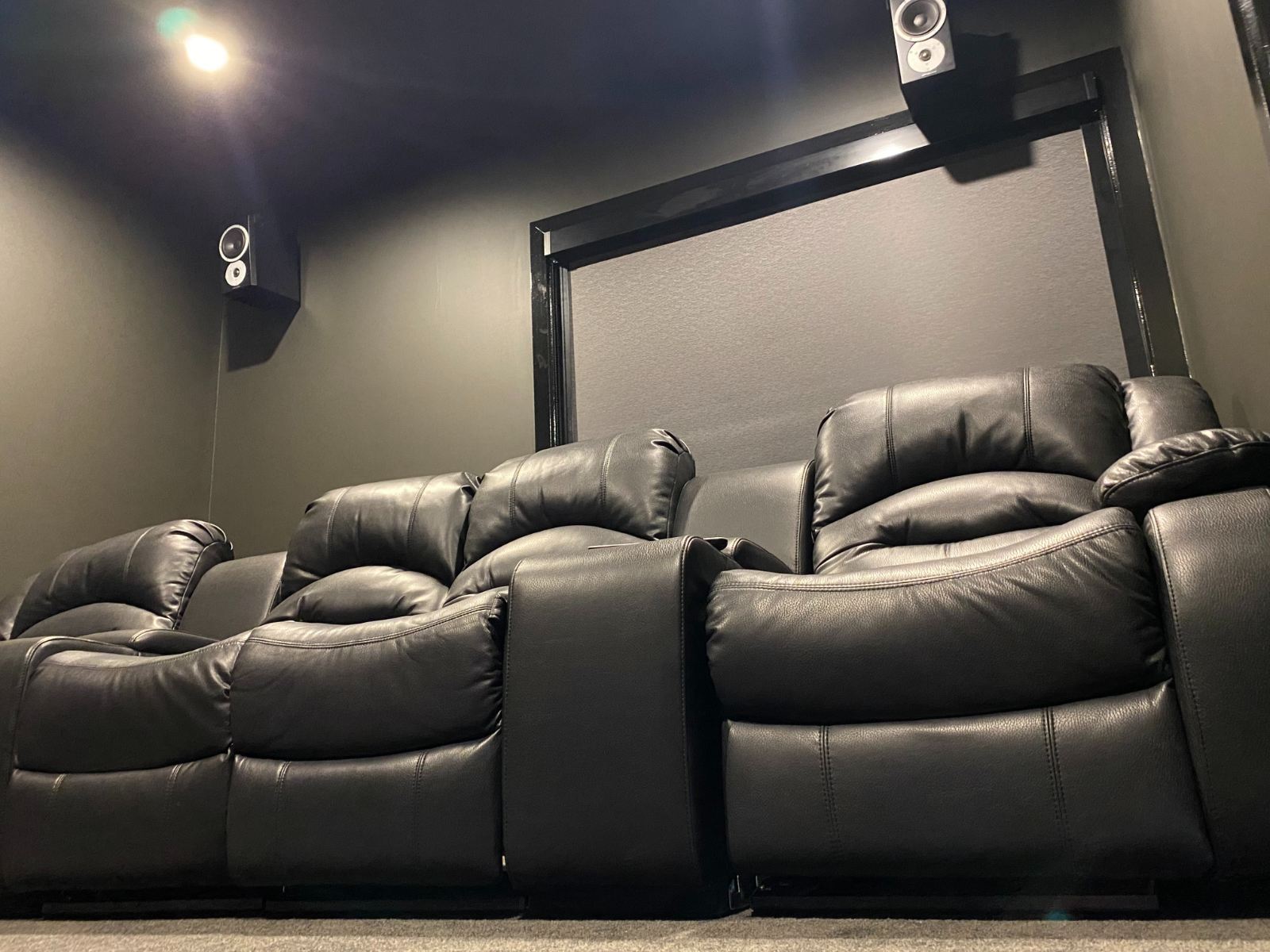

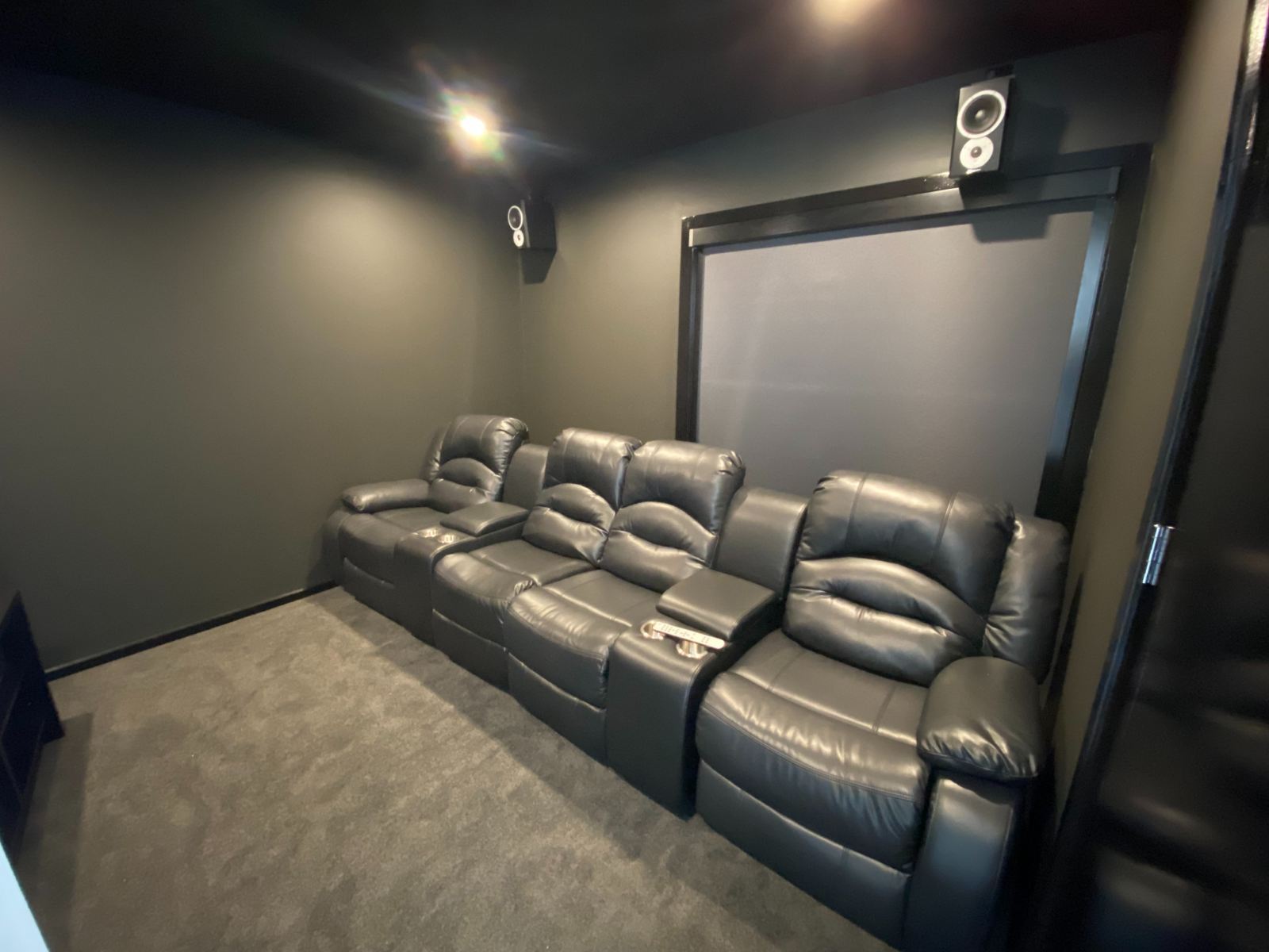

While I didn't have the ability to completely ground up design a house to suit cinema/listening, I did modify an existing plan to make work for my intended purpose.  I have an empty bricked cavity adjacent to the cinema so I modified the framework to accommodate  a future subwoofer to be flush mounted into the wall.  I added sound batts throughout the room and two layers of sound check plaster on all surfaces.  I pre-ran large gauge speaker cabling to accommodate a 7.1 speaker configuration and ran HDMI, cat6e etc cables.

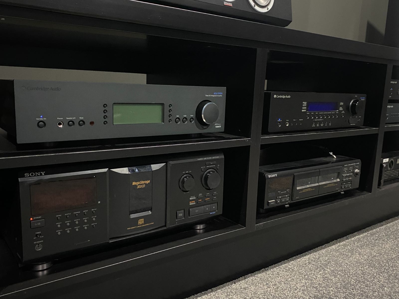

Cambridge Azur 840A Integrated Amplifier
Cambridge Azur 840C CD Player/DAC
Cambridge Azur 640T DAB AM FM Tuner
Sony CDP-CX355 300 Disc CD Player
Sony TC-WE661 Double Cassette Deck
Yamaha WXC-50 Streamer

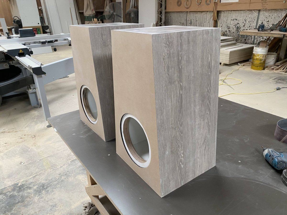

As the house was nearing completion, my father and I set about building a pair of subwoofer enclosures for the Dynaudio MW182 front subwoofers.  These would act as stands for my existing bookshelf speakers albeit with a dense foam isolating pad between.  The are designed and styled identical with the same overkill construction.  I decided to do a full colour change to satin black to match the new furniture I was designing and building for the dark grey/black room.

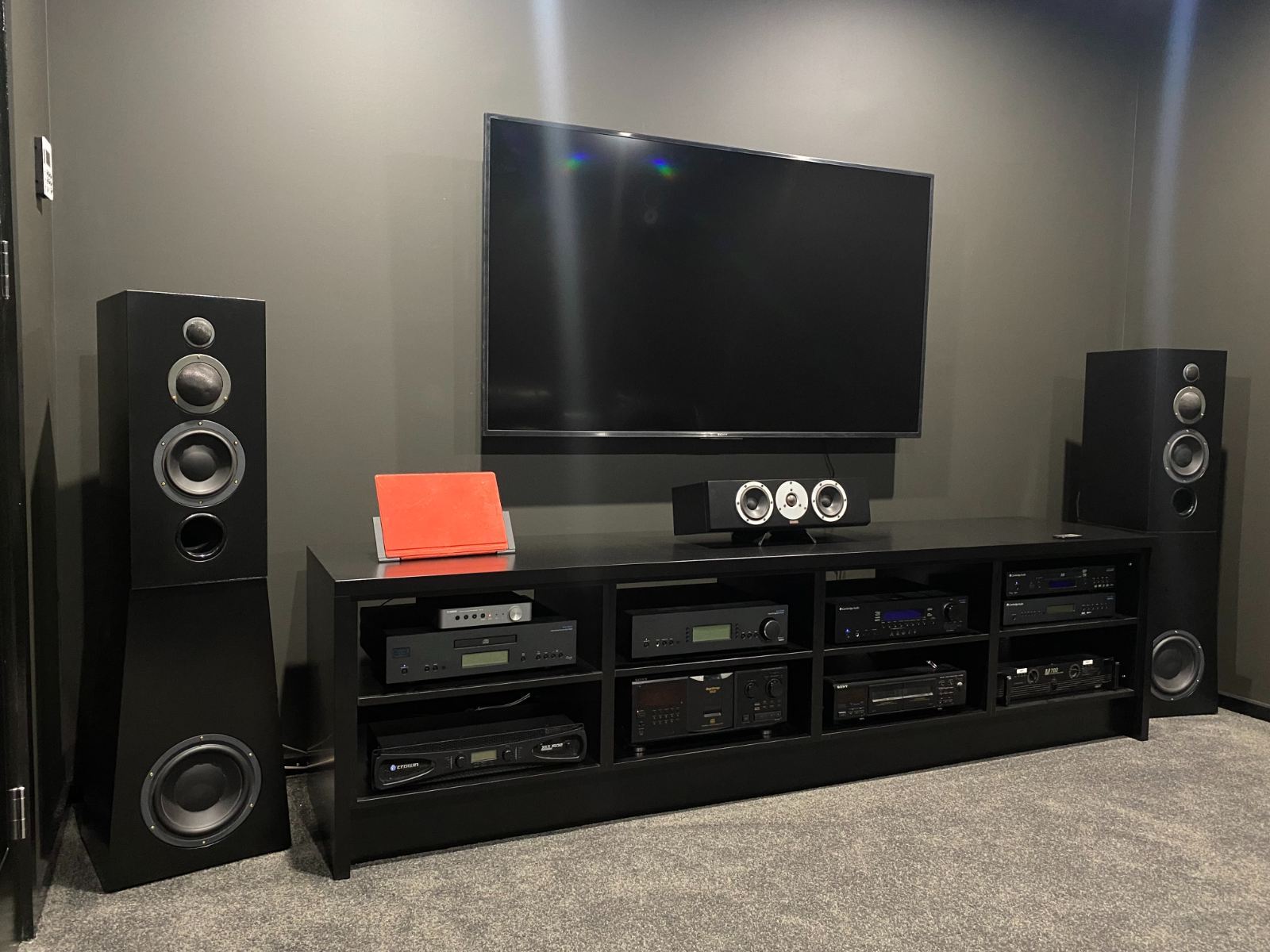

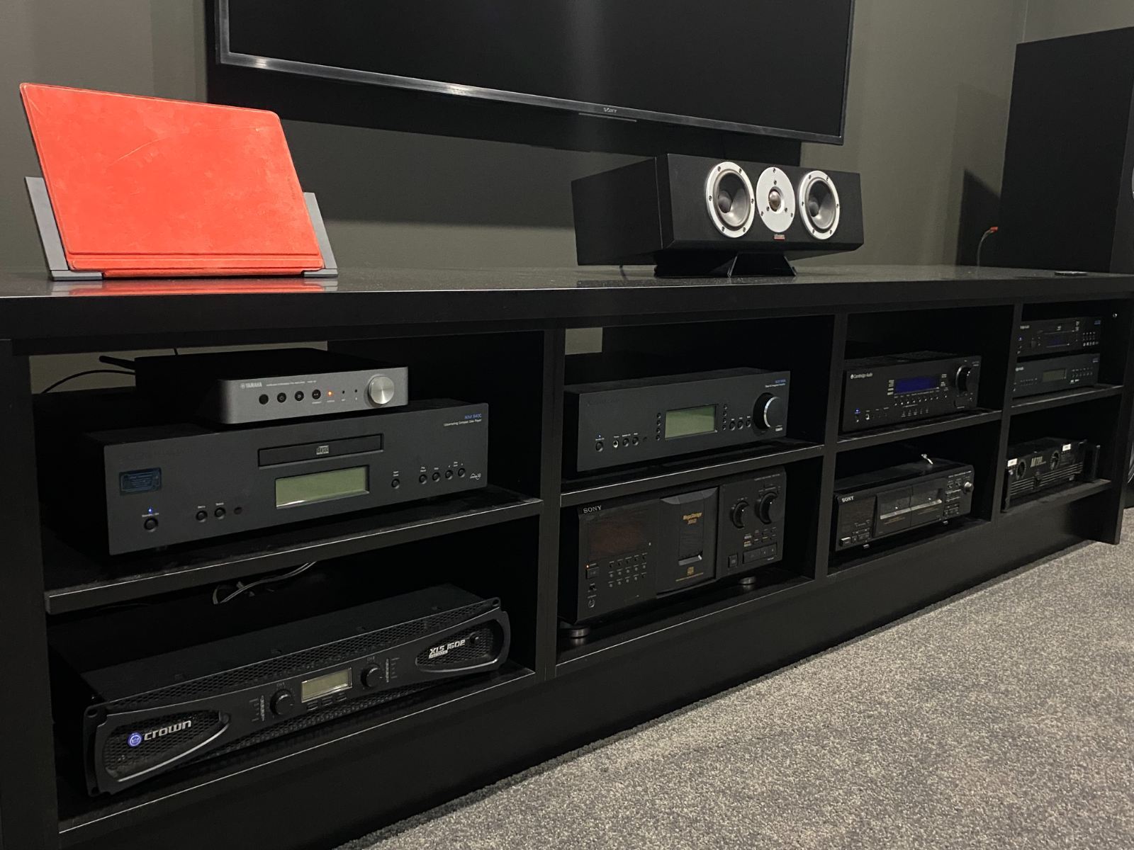

I designed an built a tv unit featuring 8x 4RU locations to give ample room and cooling for all of the equipment with a little room to add on later.

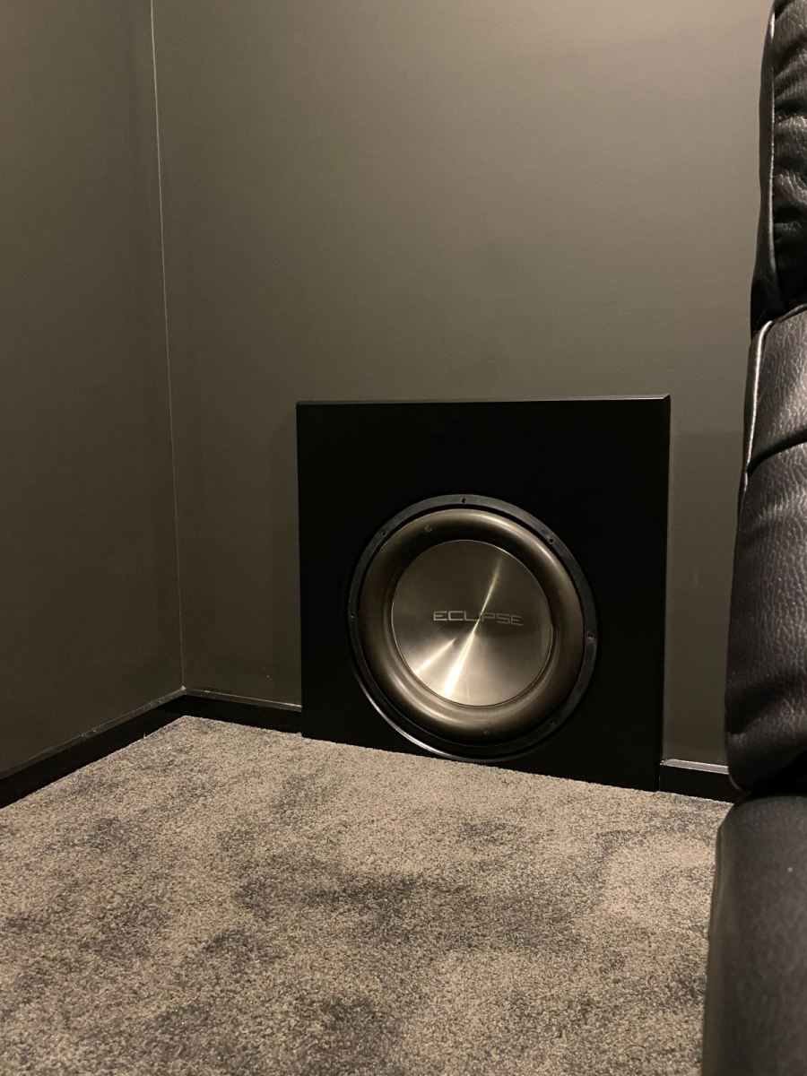

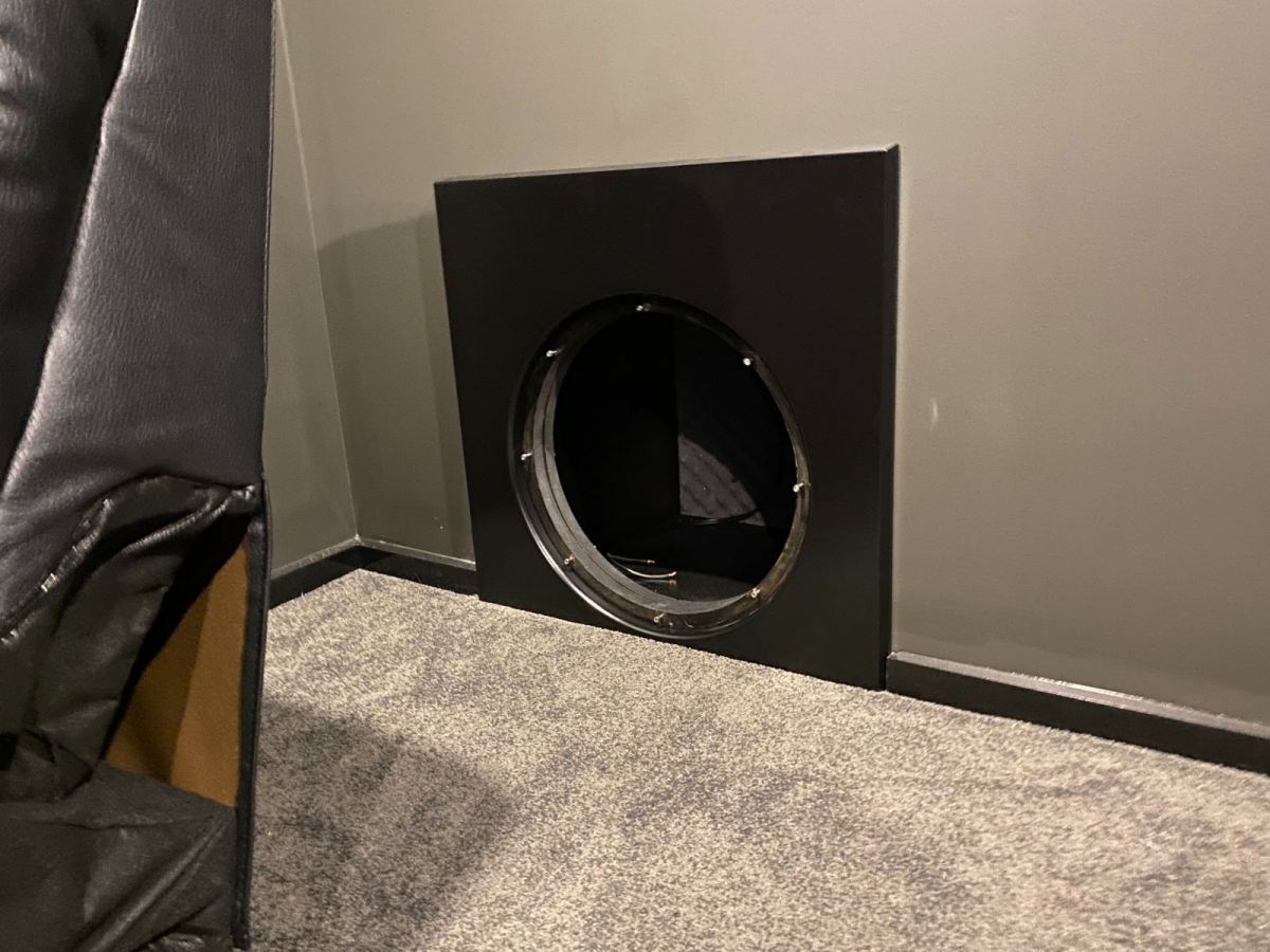

I also built the largest enclosure I could that would accommodate the system subwoofer flush mounted in the wall.  this was using multiple layers of 25mm MDF, braced and fiberglassed internally and externally, then lined with sound absorbing foam.  It may not be the perfect dimensions but I didn't anticipate such a monster sized cinema subwoofer.
