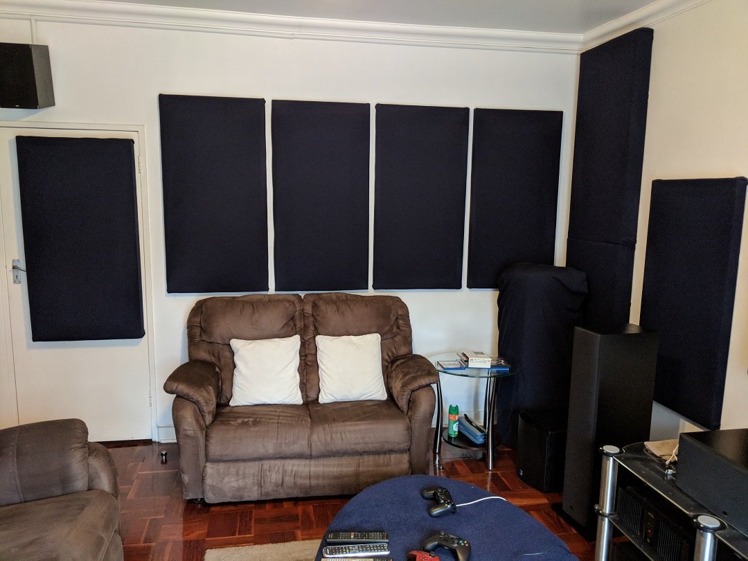

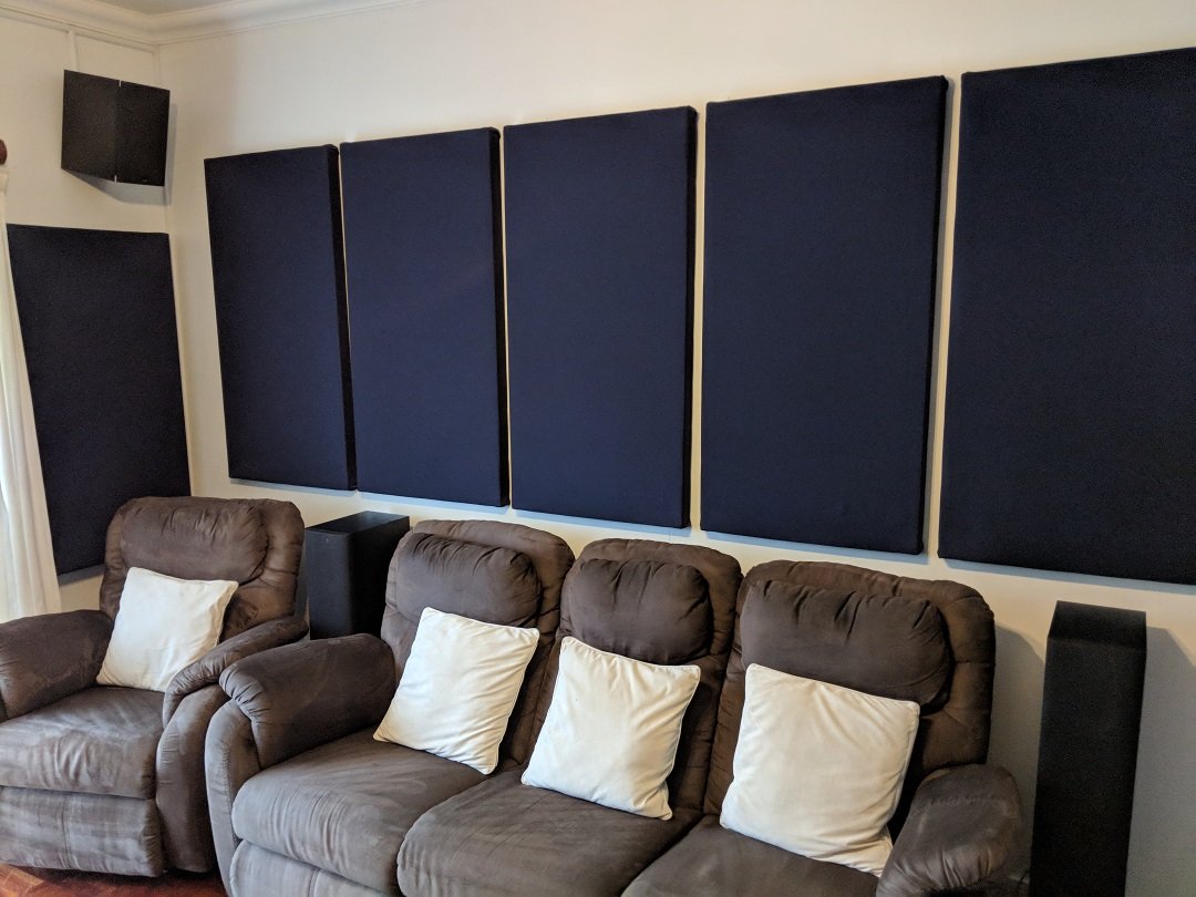

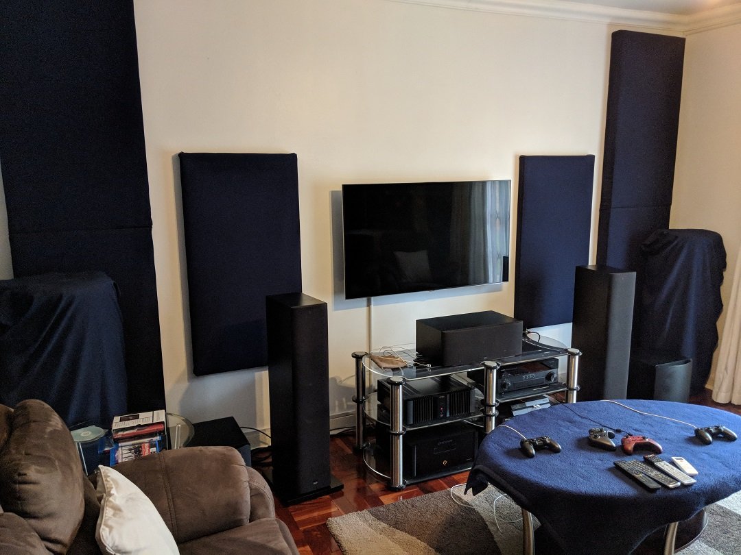

This is my setup from my old house, it took about 3 years to collect everything, build panels, REW measure everything, fiddling, adjusting, listening, repeat.
Unfortunately having been on the move for the last few years everything was in storage, now having settled again I've come to remember what a mission it was, what was required, and how as a tenant it's often not possible to get it the way you want it. I'm considering ditching HT altogether and going for a simpler stereo setup.

@reactor_au  I am all for room treatment ... and whoa you certainly have a lot on those side and rear walls.  I cannot comment whether this is optimal but did you ever consider the ceiling too?

Hi MrC, yes I did consider it but I felt the ceiling was a lot of work for not the most improvement. I wouldn't bother with the whole ceiling though, probably just the corners where the wall meets the ceiling. In order of importance; first reflection points, then DSP, then bass traps and diffusers.
I wish I still had the before and after measurements from that setup to share.
Many people find that the ceiling actually contributes more than it appears.

Any hard surface will contribute as it is reflective, but speakers are quite directional so first reflection points I think have the most impact. If you don't have any flutter-echo in the room then I think there is sufficient treatment for a traditional stereo-7.1 setup, if you have atmos speakers in the ceiling or upward facing atmos speakers then you may have first reflection points in the vertical plane as well though.
