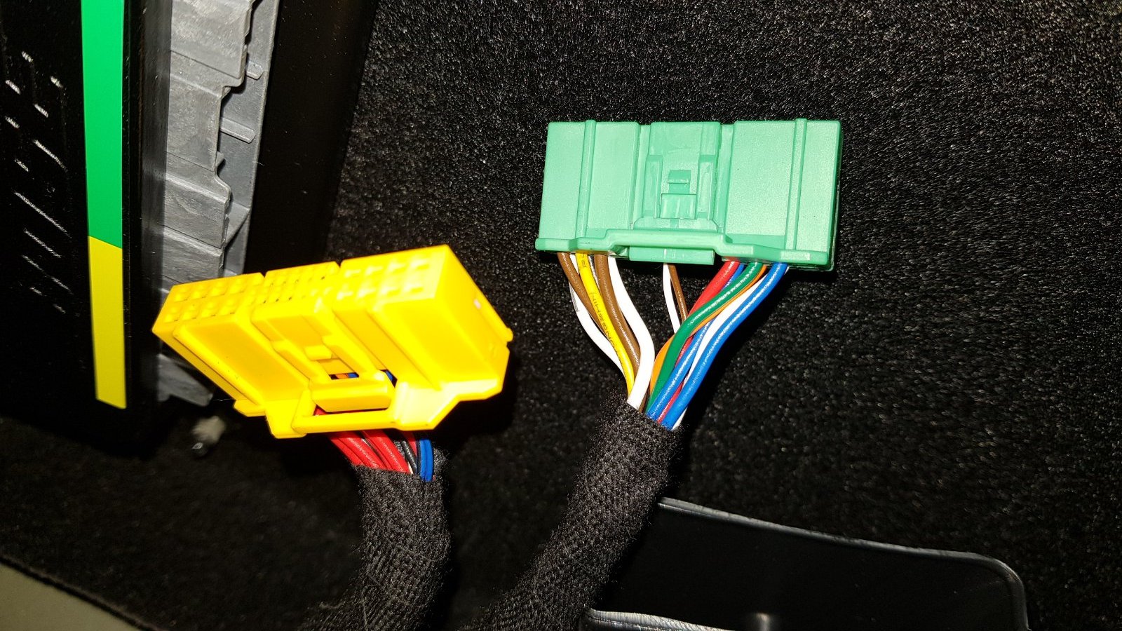

tamamontu Posted November 21, 2020 Author Posted November 21, 2020 10 hours ago, gat474 said: knock test. Thanks for your suggestion. Floor is definitely a big job, thats the reason for asking whether generally its recommended to do floors. I will start with door first to keep it simple and manageable. You also mentioned knock test what is it, i read it being mentioned in other forums aswell. I took further look around the bose amp, its a tiny digital amplifier with two automobile style connectors. I am guess the yellow one is some sort of input and the green one is output for the speakers. Yellow connector has got 4 red and 4 black wires along with few smaller guage wires.

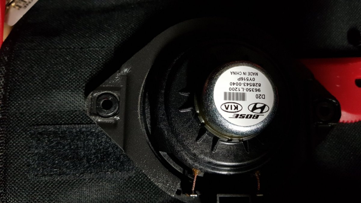

tamamontu Posted November 24, 2020 Author Posted November 24, 2020 Finally got around measuring the speakers, one correction front speaker is 4 ohm and not 2ohm, (Multimeter battery issue) Center => 4ohm, 85mm Front mid => 4ohm, 148mm Front tweeter => not 100% sure multi meter showed 20ohm(apprx). There is a small cap in line so not 100% sure about this measurement. 32mm Rear => 4ohm, 145mm Center speaker
