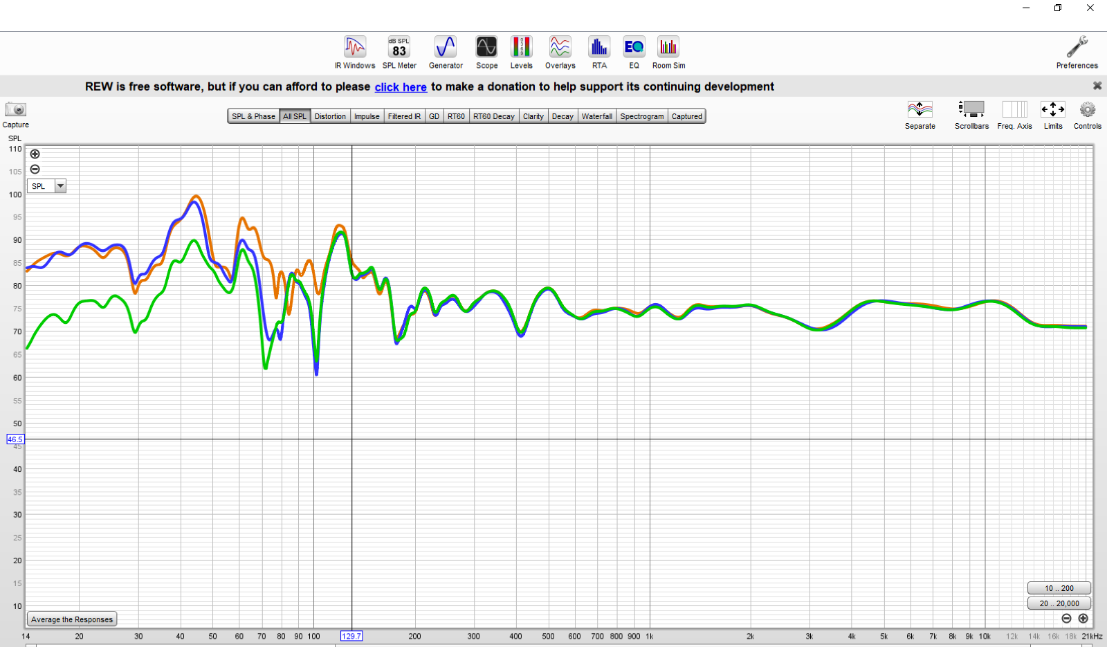

@Satanica @andyr @tuyen
Thanks guys Fixed it.
I reinstalled new version of REW, used different usb cable on umik, relocated the whole rack so i can postion sub into more ideal location. Nothing has changed, then i  unchecked "Enable Audio Enhancement"  found some info online and fixed it.
Funny enough even tho the graph was off it still pointed me in the right direction.  Ill do more fine tuning now as i just set sub on 0 phase but yeah IT WORKS!

If your orange line is "sub on" - then yes, you seem to have fixed it.  :thumb:
But I have one query:
  • What frequency is your sub roll-off frequ set to?  100Hz?
Andy
Andy

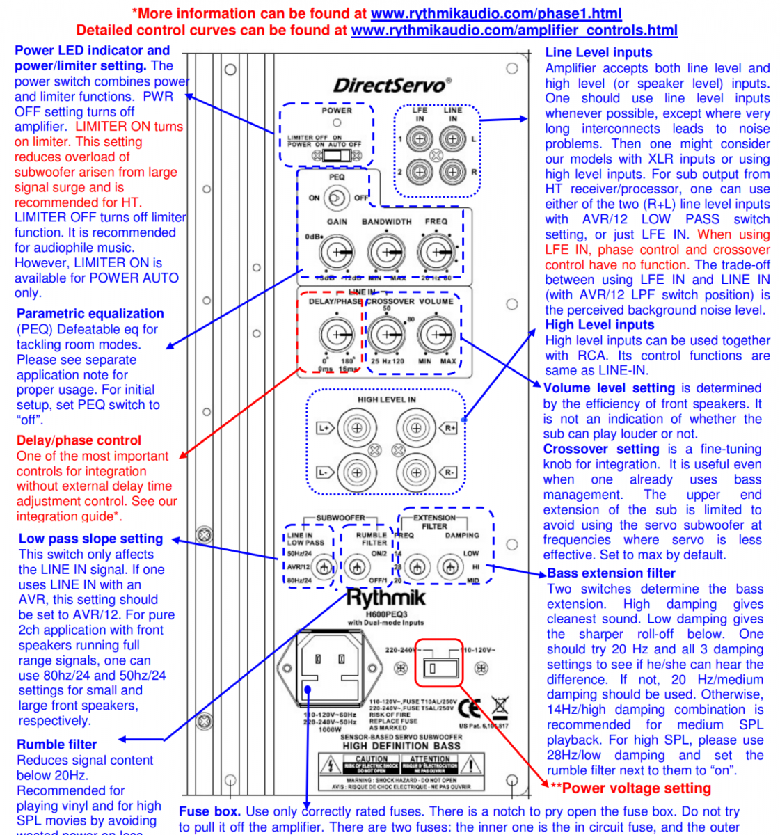

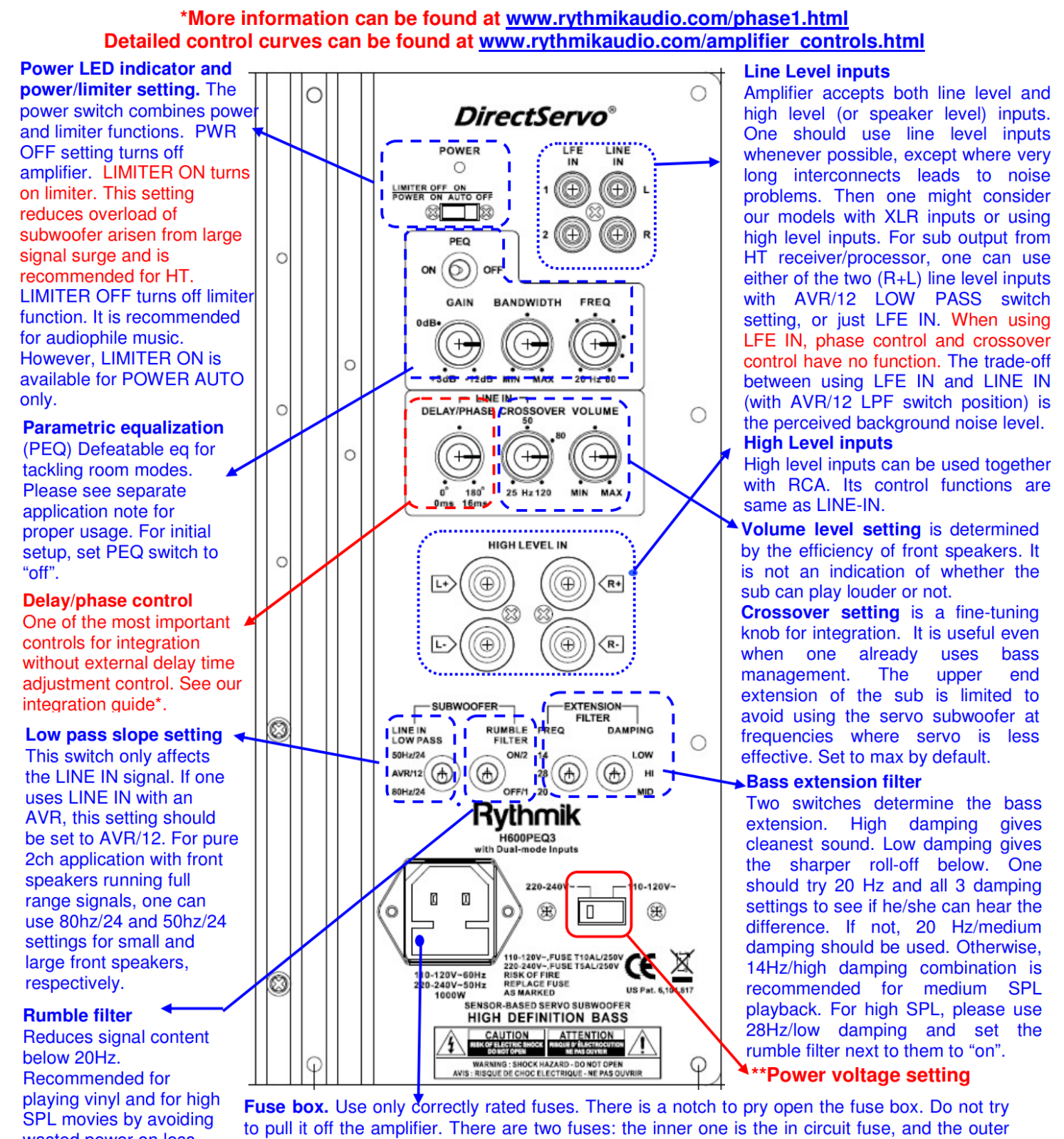

Orange is just about all it can give, volume 95%.   Extension is ( 14hz,28hz,20hz )Damping (Low,Hi,Mid)    I prefer on all tests 20hz with hi damping. Less SPL but sounds better to me. 14hz makes it work harder and windows shake more but not what im after.  These settings i dont change.
THen the crossover for orange is 120hz with Line in Lowpass on 80hz/24  this setting is for smaller speakers from what ive read but it seems to get rid of my issues at 70hz and 100hz.   I need to listen to it more but i dont prefer this setting is overpowers speaker.
Blue like is set to 50hz on crossover with line in lowpass set to 50hz/24, it compliments speakers more but still issues at 70-100hz
I may play around with orange and lower the volume see how that goes.
**edit: green is no sub now. but that looks weird too 14hz..
Edited by Pasic007
Your orange line is pretty damn good, IMO!  :thumb:
With this measurement, you have got rid of the sharp dip at 100Hz that shows on the blue & green lines.  Did you change the sub phase control for this measurement?
I too have set my Rythmik plate amp controls to:
  • extension - 20Hz
  • damping - Hi.
Andy
  • Author
  • extension - 20Hz
  • damping - Hi.
Andy
Yeah i took 3 readings every 5 notches from 0ms to 180ms.  This probably made most difference, i found it seems happy at 5notches away from 180ms.
One thing im not sure with is PEQ, do you use that? ive got mine on off still i do have minidsp but ill play with that once i get another sub  :)
Yeah these are great! F12 as well?  my KRK was 2500$ when i got it i think and this just destroys it in SQL.
Edited by Pasic007

50 minutes ago, Pasic007 said:
Yeah i took 3 readings every 5 notches from 0ms to 180ms.  This probably made most difference, i found it seems happy at 5 notches away from 180ms.
Well the REW graph shows it's pretty damn good - so keep it there!  :thumb:

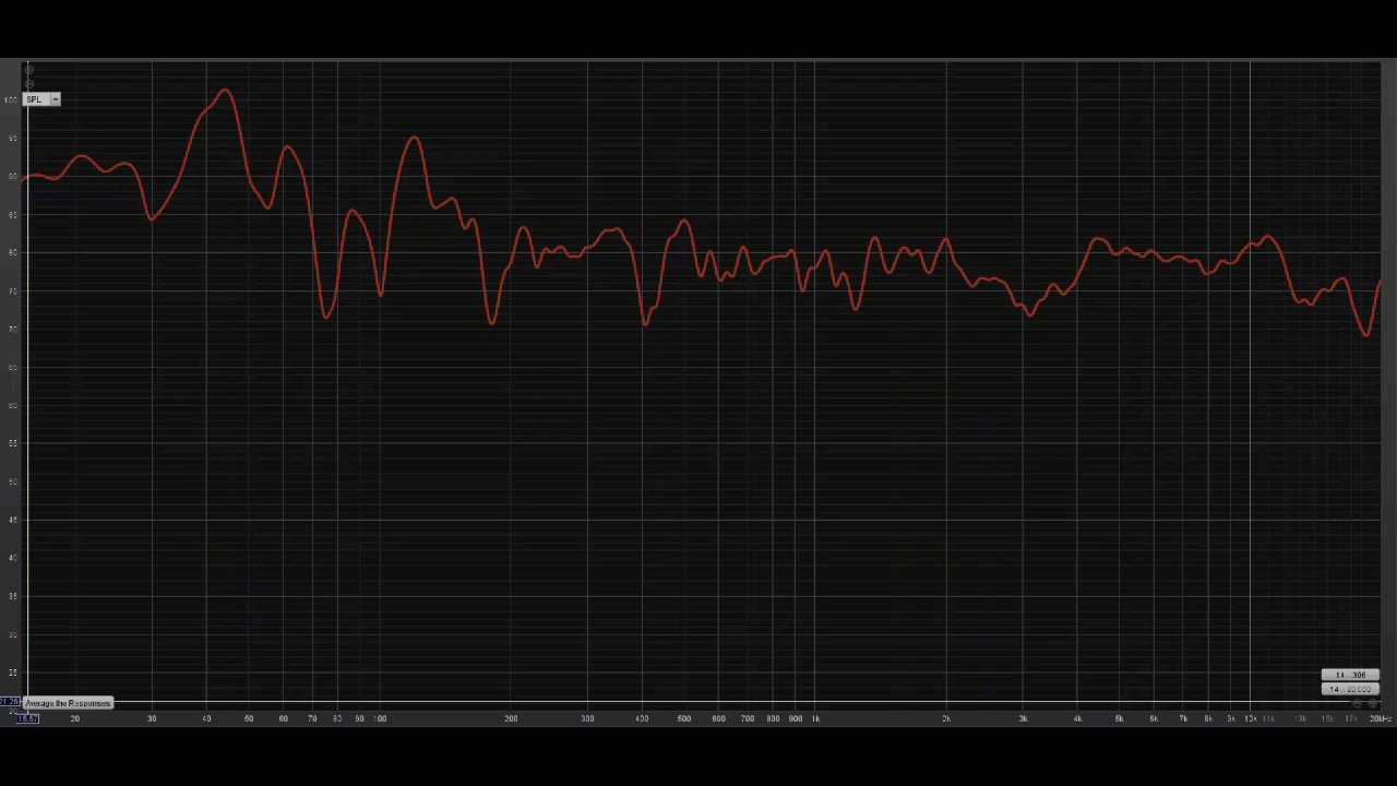

Had massive win last two days. Recently since moving the rack ive noticed so much more noise, hum coming from the speakers. So much so that i couldnt listen to music any more. It was that irritating.
Ive re arranged the cables, move the preamp away from the rack. Removed the sub from the system as this was the latest addition. In the end i used extension cord from laundry..... as i know this runs on separate circuit breaker and voilà. Both power amps are now powered from laundry lol. This just shows the importance's of having dedicated power line.
This morning i decided to play around with sub. I played Tone from 20hz up to 300hz and observed where my vibrations were coming from. I had few issues windows shaking at 45hz, half full beer bottle no **** was resonating like crazy and there is crack in my glass on front door that was high pitched buzzing when sub was playing 100 odd hertz.
i decided to play around with PEQ,. I boosted it 3db on 76hz to bump to even out the frequency. This made a measurable change but not enough. So i went back and reduced 44hz  by roughly -6db 0 bandwidth as there was a decent peak there. This was a big win in my books, frequency looked much more even and it reduced the damn windows shacking.
Very impressed with 12" Rythmik, im thinking of placing an order on 15s.  12" Is fabulous just too small for my open space not enough headroom in it.
RED - Before PEQ
GREEN - PEQ ON -6db on 44hz with  bandwidth in middle. Also increase the SPL every so slightly, now that it wasnt working soo hard at 44hz :)
Now, need to read up on waterfalls and RT60 measurements.
Edited by Pasic007

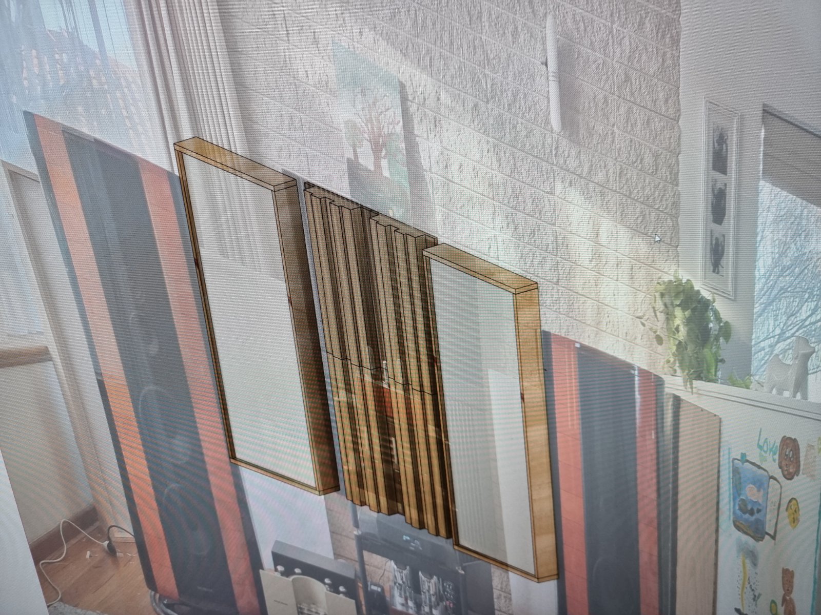

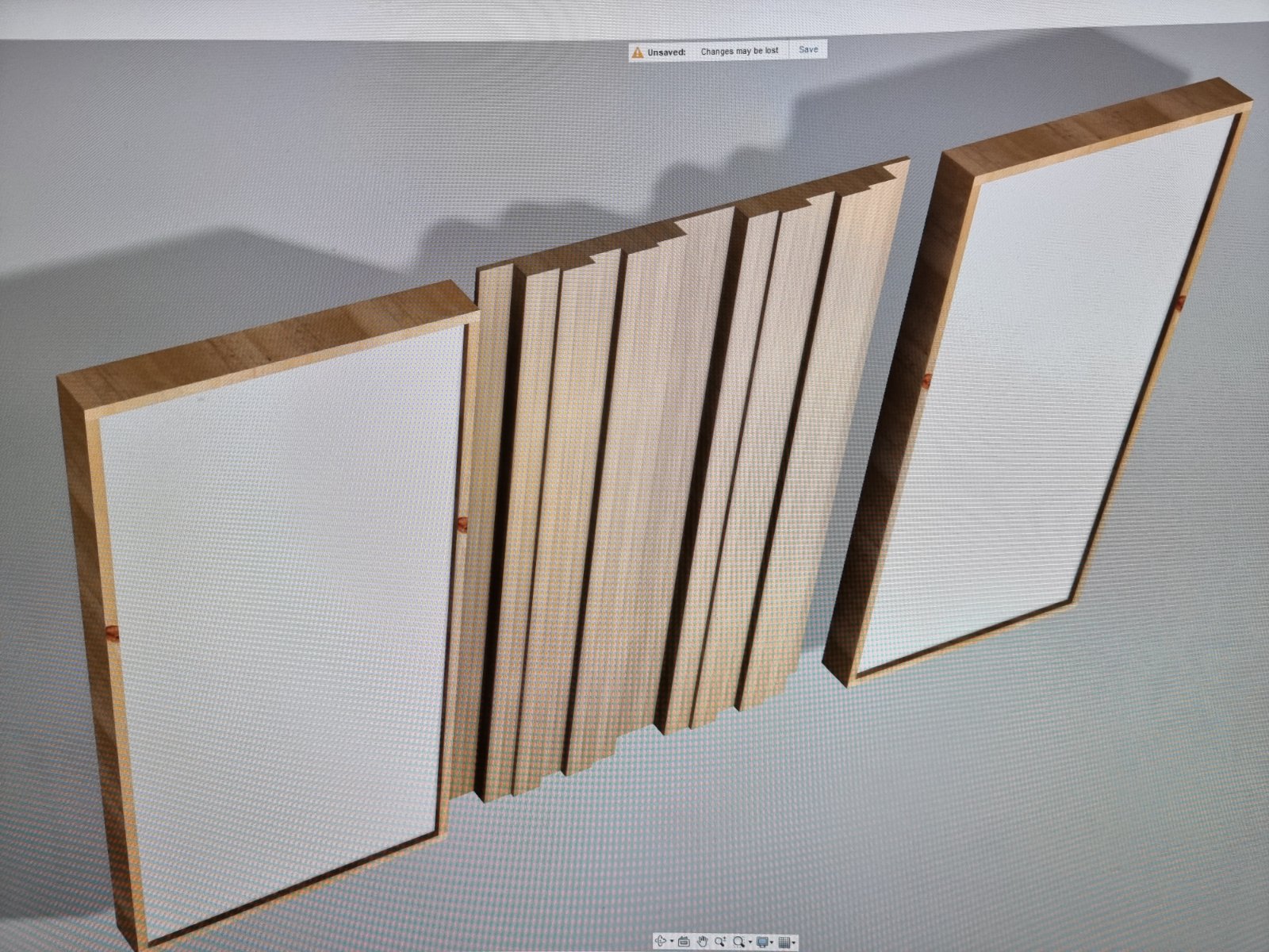

  • Author
Diffuser With two 1200x580x75mm polyester batts on the side.
I drew up the diffusers base on Tim Perry design.
They look small compared to amps and speakers. That's because rack is 1m away from the wall.
