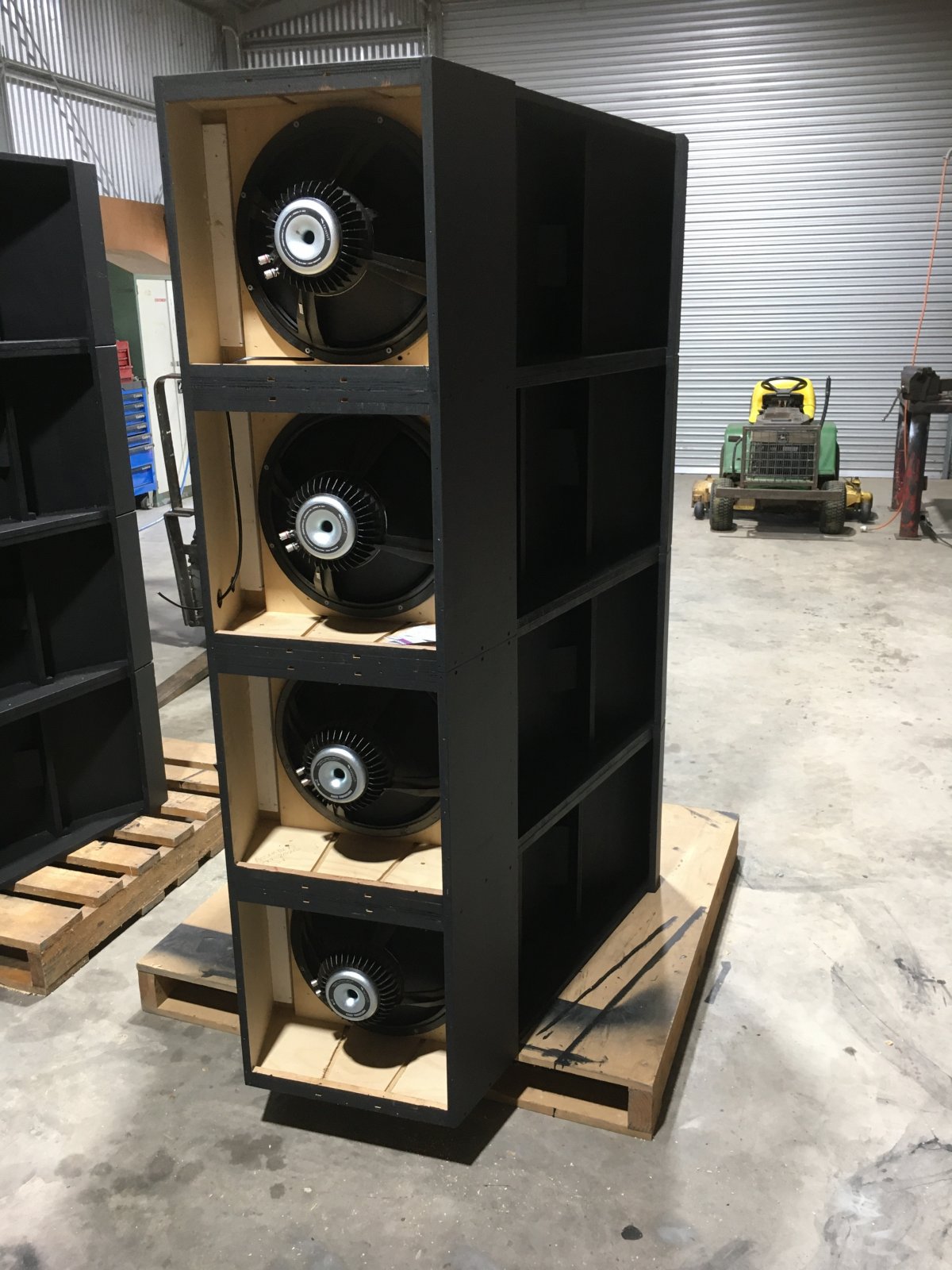

Just thought I'd post this for anyone interested in live sound music reproduction.  We have just finished building this system to go into our live music venue.  ' The Bundy Hall' in Gippsland Victoria.
Live at the Bundy runs regular music events and has a focus on the very best live sound.
We wanted to update our previous LENARD inspired system that we built out of leftovers about 5 years ago.  We asked John Burnett to design us his version of the ultimate in live systems and this is what he came up with.
There is a youtube clip HERE if you want to see what it does in an outdoor environment.  ( Use headphones for the full experience)

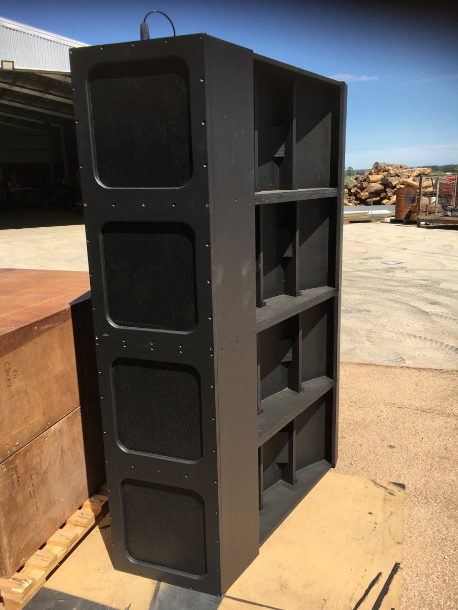

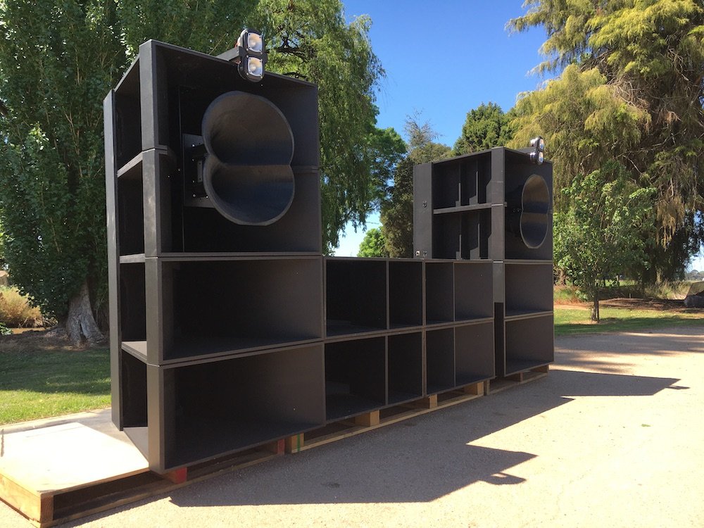

A total of 16 x 15" drivers are used in the sub bass and mid bass.  The sub bass drivers are in compound pairs inside the 4 folded horn bass units.
4 x 4" diaphragm 2" exit compression drivers & 4 x ring radiators make up the 4 active band pass components.  Power comes from 8 channels per side running in bridge for the sub bass and mid sections. There is around 2kw available per side.   The voice horns are 3D printed.
Seems like madness for a small country hall sound system I know, but if you want a truely unlimited dynamic high fidelity sound in a live venue then this is how you do it!
