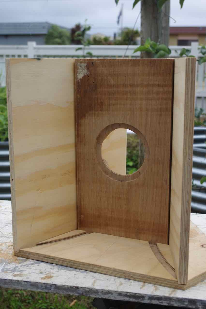

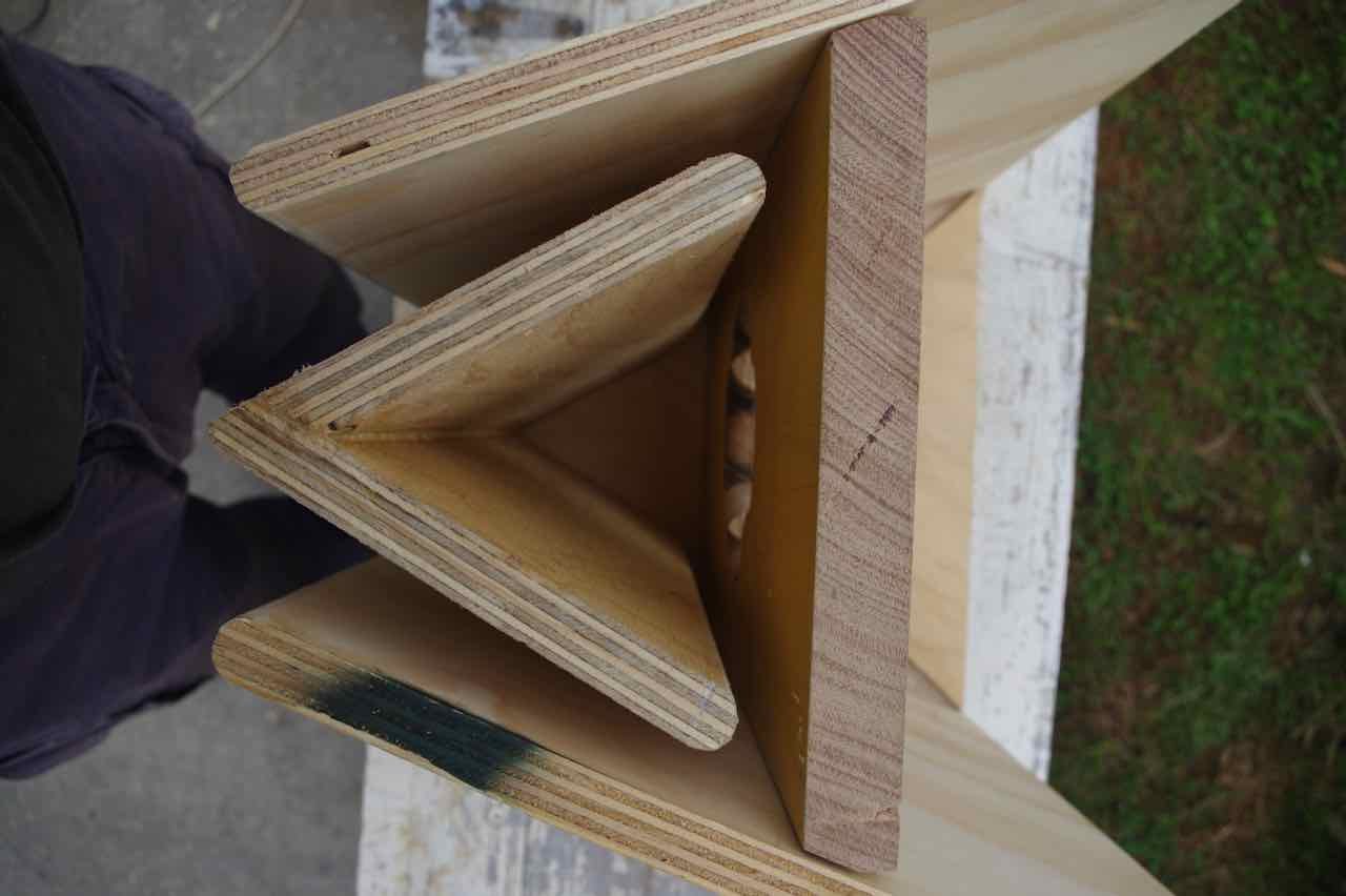

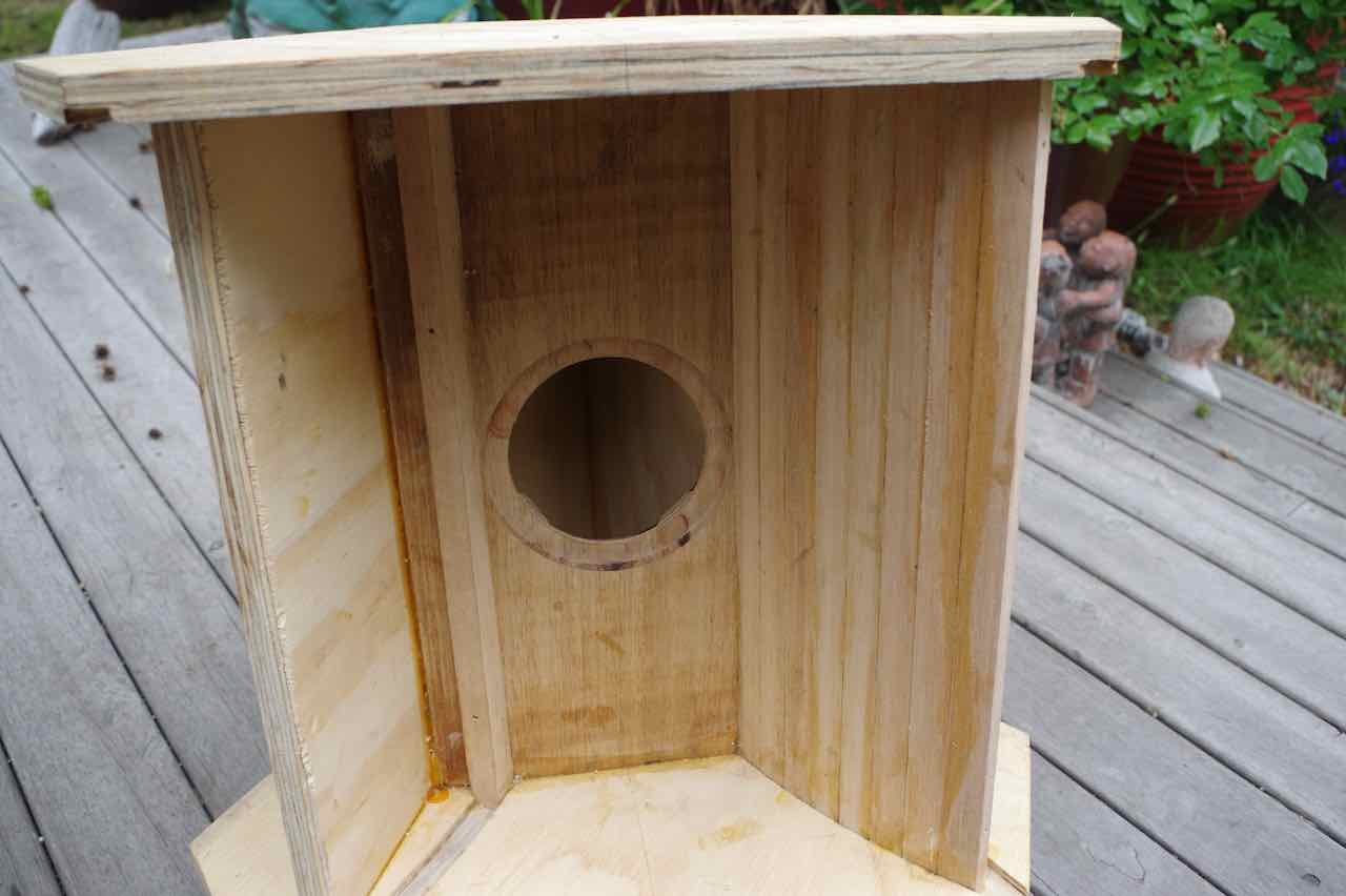

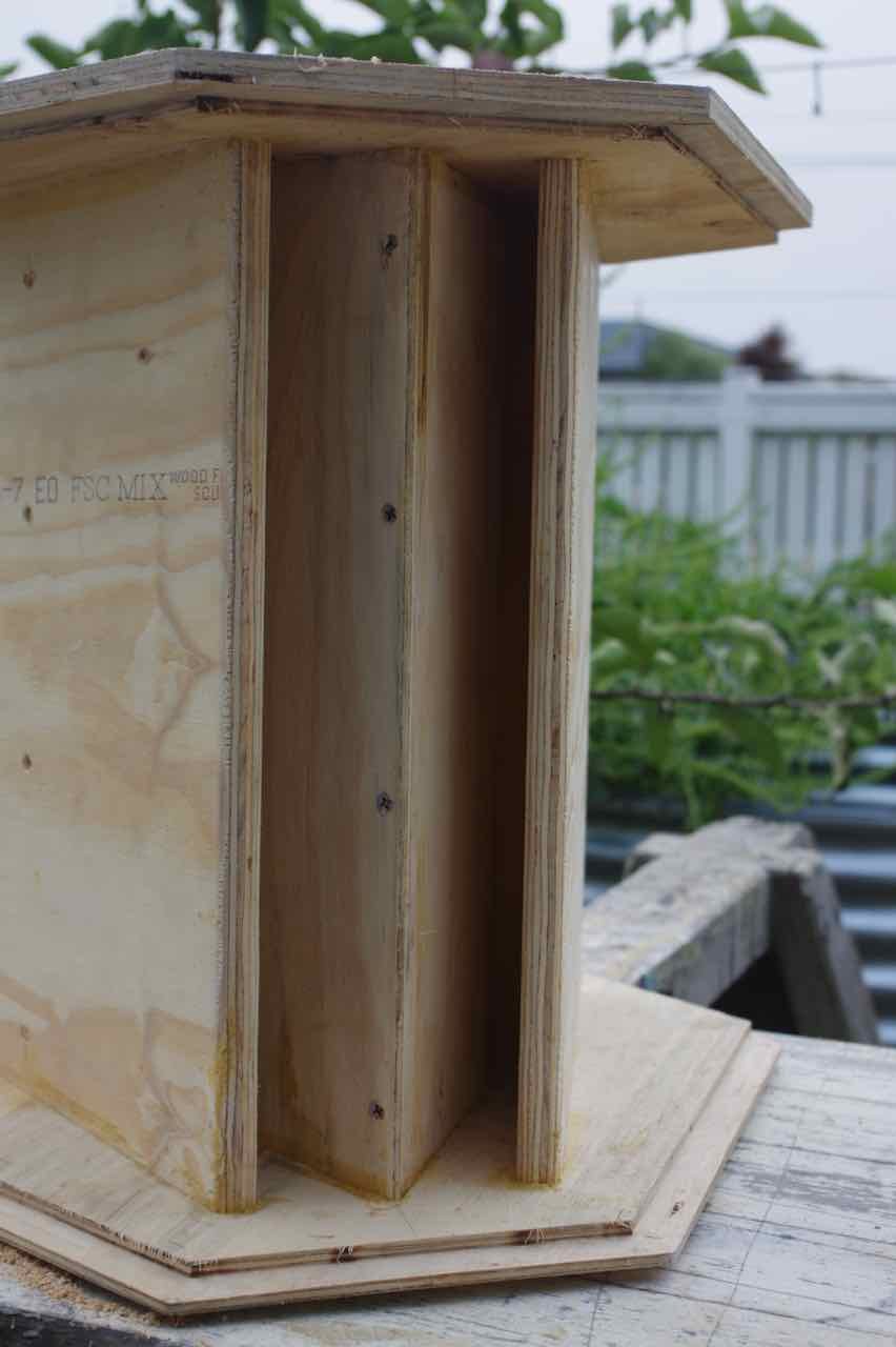

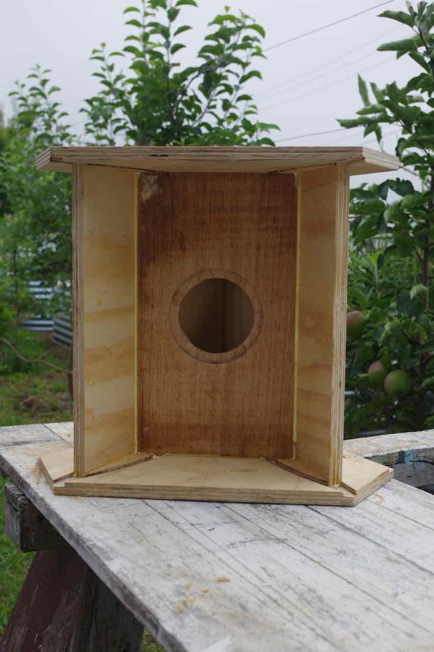

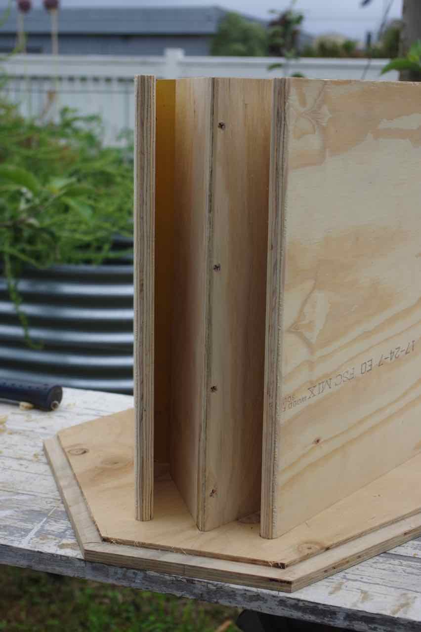

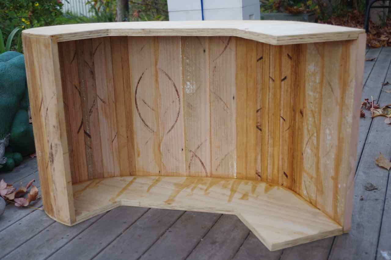

Here are some progress pics of my build to date.
And one pic of the finished horn which i built a couple of week's ago.

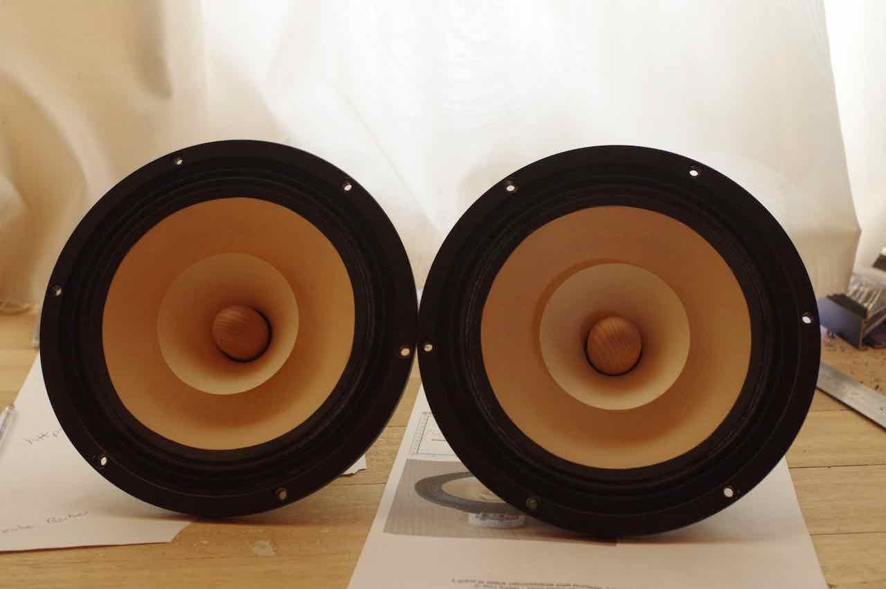

This is scaled down version of a test build for a pair of HPD 385 Tannoys, The speakers used here are a pair of Mark Audio Alpair 7.3 Enabled from Planet 10.
I thought i would build the scaled down version out of left over ply and recycled timber to work out how i was going to actually put the horn together before committing to building the large version.

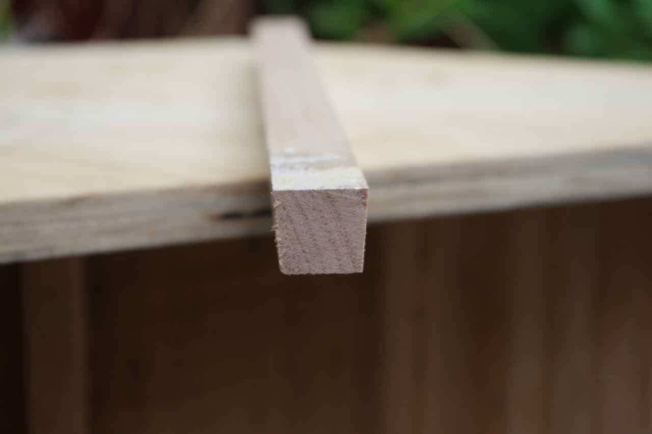

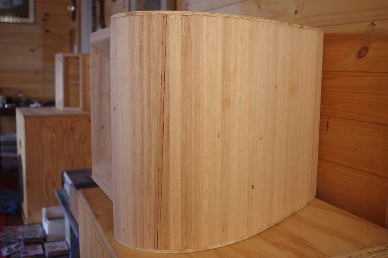

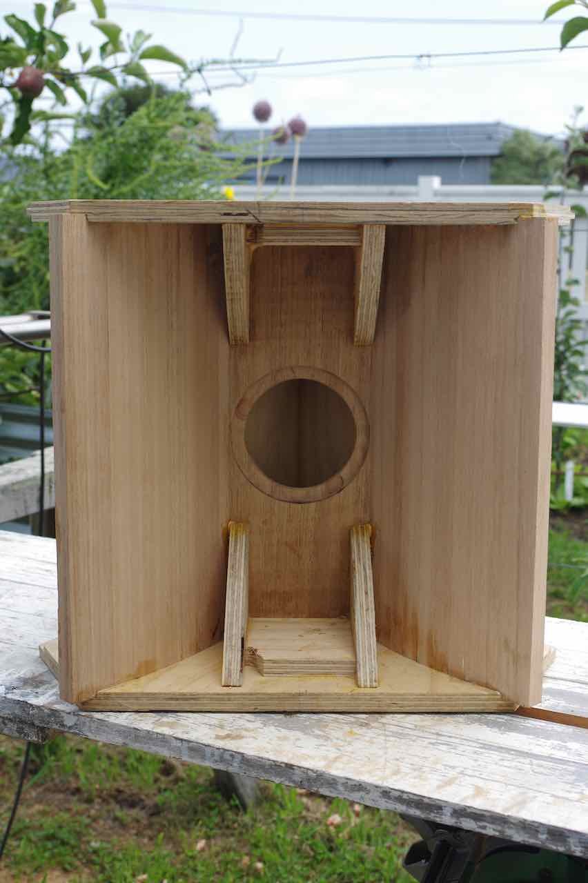

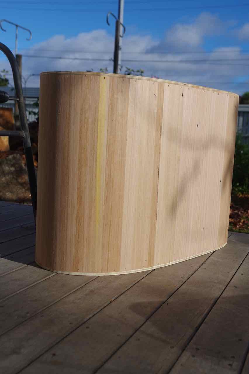

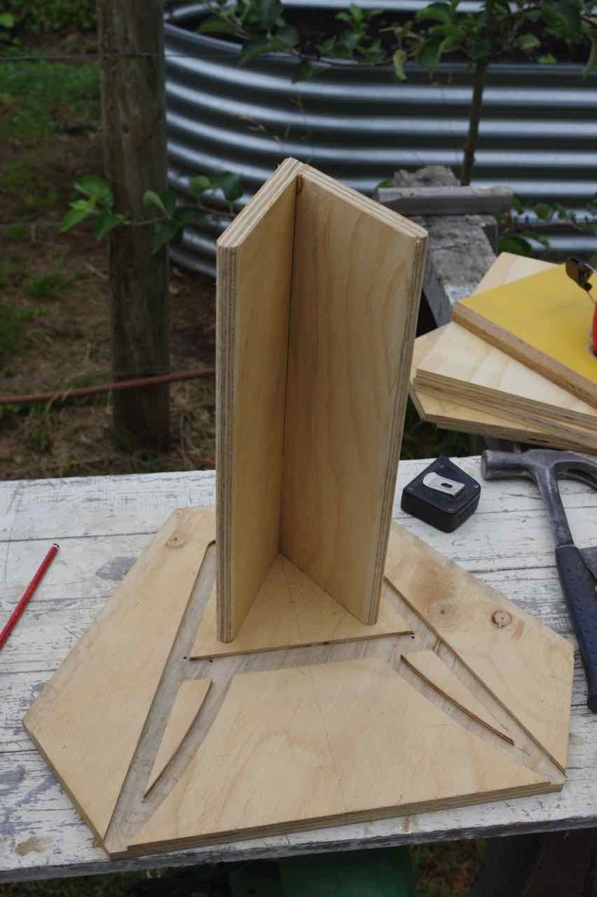

The curves are made up from a number of pieces of timber 20mmx20mm with a 3 degree off 90 and each piece is glued together in the routed rebate to form the curve, That's the easy bit.
Then sand the curves so they are smooth, the next step is to fit each piece over a profile cutting compound mitres at both ends of the timber to fit against the curves.
I will be doing the next step in a couple of days and will show how it's done, or pics at least.
Steve.

Building these Horn's!!. This is what happens if you wear the tin foil hat for too long.

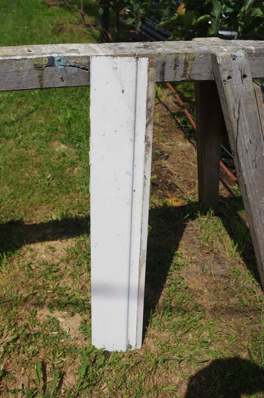

As for being solid that is the timber i have on hand recycled and all.(see pic)
Might have to look into a Gtg in the future, i would like some opinions on how these horn's sound to others.
I have a pair of Sonido SFR 200 AINiCo drivers and will build the same type of horn to house them as well as the Tannoys. (might need to finish the renos first)
Steve.

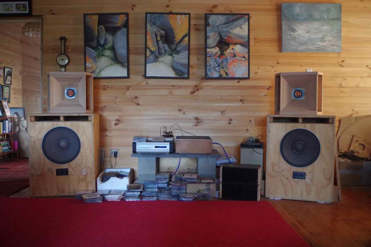

And here is where i got the idea for my version with the added extra at the front( hence the Franken-Horn).
It's not practical for me to place the horn's in a corner at the time being but seeing as my wife has claimed these for her studio, in the future they will be placed in a corner.
The 15" JBL driver's are some of Bill Darts handy work from a few years back.
Steve.

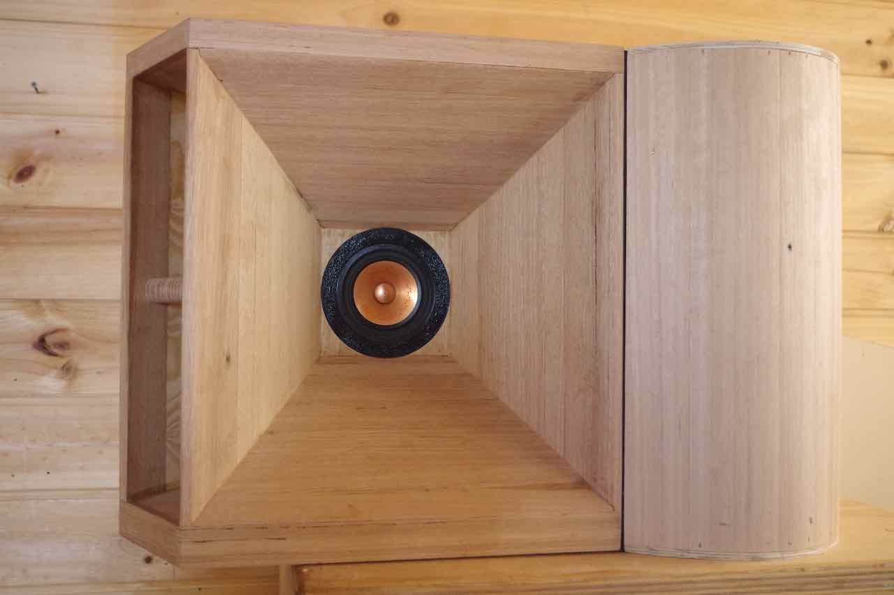

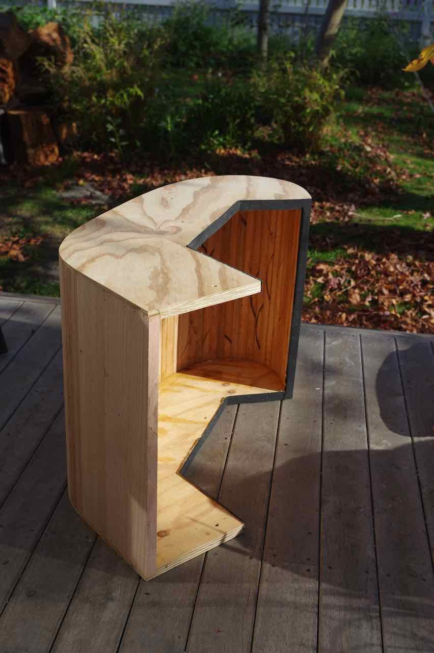

Thought an update on the horn's might be of interest.
After Dave brought up that the Franken's will not go down very low got me thinking about how i might increase the bottom end a little.
And also Sam asked how they sound in a corner, not having any useable corners in the room.
Thought i would add a chamber with the exit running parallel to the wall.
I did not expect the change this has made.
  • Like 6

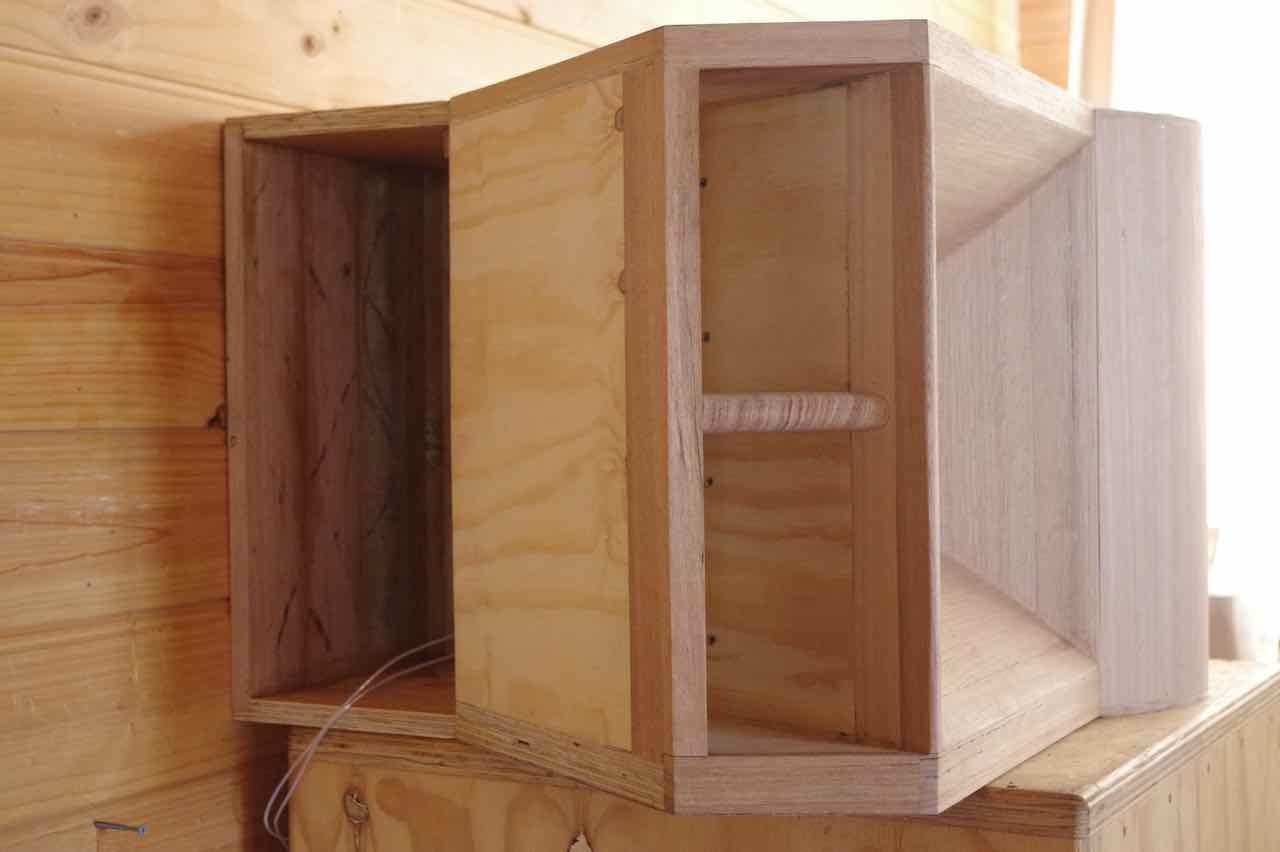

And here is the other one done.
What started out as an exercise to work out how to form the radius curves on the speaker for another project has shown me how good these Mark Audio 7.3 Alpair speakers are.
In the end i have blundered my way into a Fullrange speaker box with 3 different points for the sound to exit at different frequencies and also the wall comes into play.
Steve.
