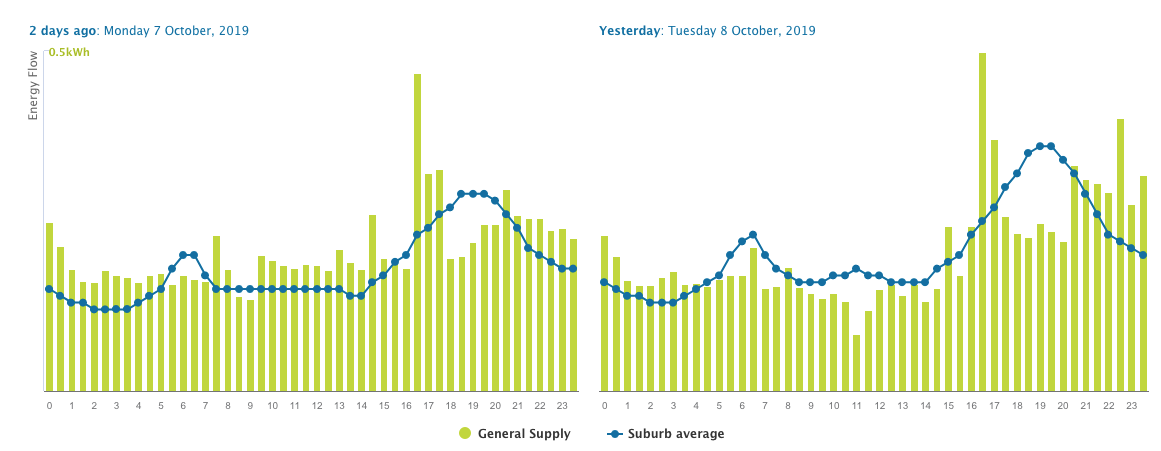

4 minutes ago, Spider27 said:
Here is my usage report that I got from powercor. I expect to go a bit up once aircon is installed but much..
Got a per-half-hour version of that?
Should be exportable - will show seasonality in your hourly load profile.
