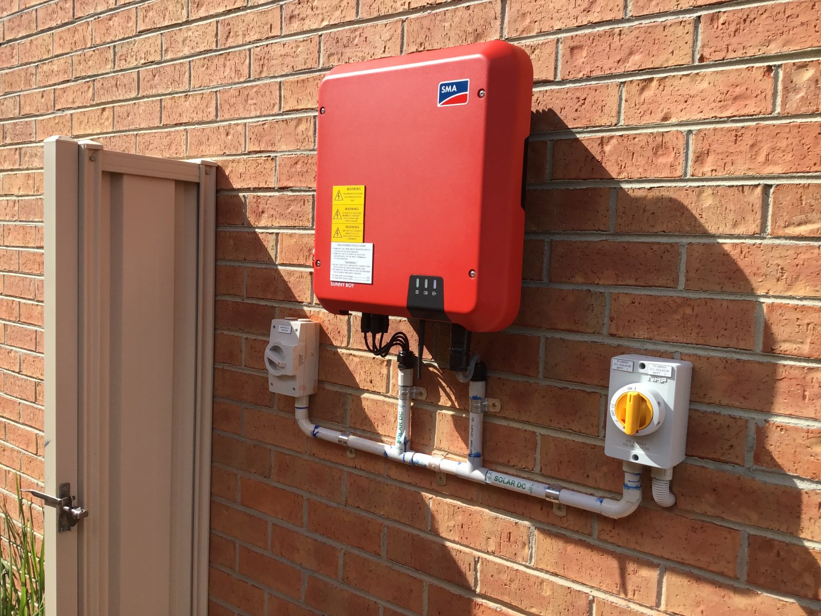

We got there at last.....
i had 20x 330W Qcells Maxx 1/2 panels and a 5KW SMA inverter installed on Tuesday....  finally....
Had to call Glen up and push some buttons to wake him up.  The Victorian Solar rebate of $2225 that I was approved was going to expire on the 25/4/2020.     If an installation was not to go ahead we would have had to reapplied and this time it’ll be less; $1888... I believe, you guys can check the site.....
As part of the agreement I had that rubbish 3 solar hot water service panels that weren’t in service due to constant reliability issues removed so I need to disposed of them sometime next week.
Glen is coming back and no doubt the inspector for Solar Victoria will be making an appointment to inspect the installation...  At least through the SMA portal we know it all works....
Edited by Addicted to music
Nice, SMA, there's no effing around with their kit - very good stuff.
How often is that evap unit shading that string?
Very nice.
