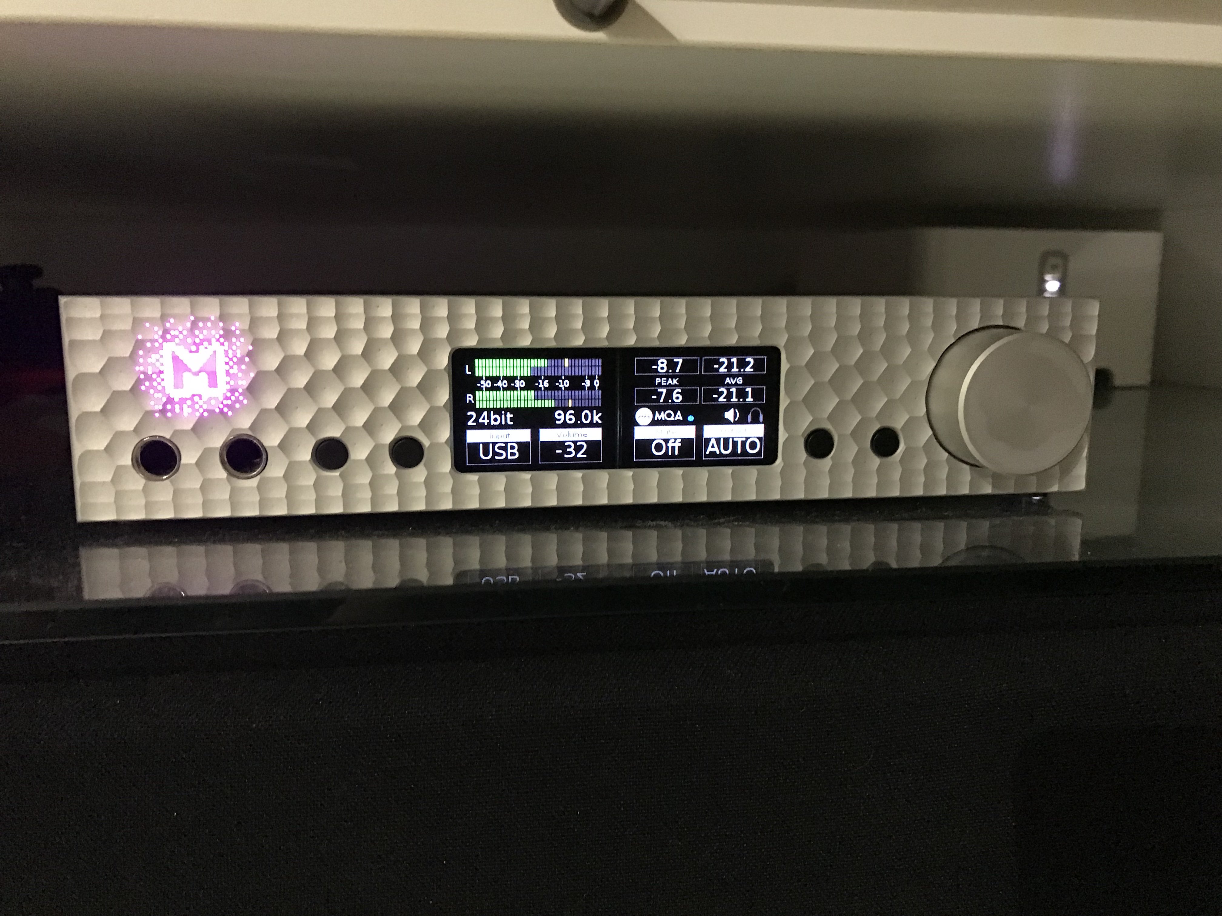

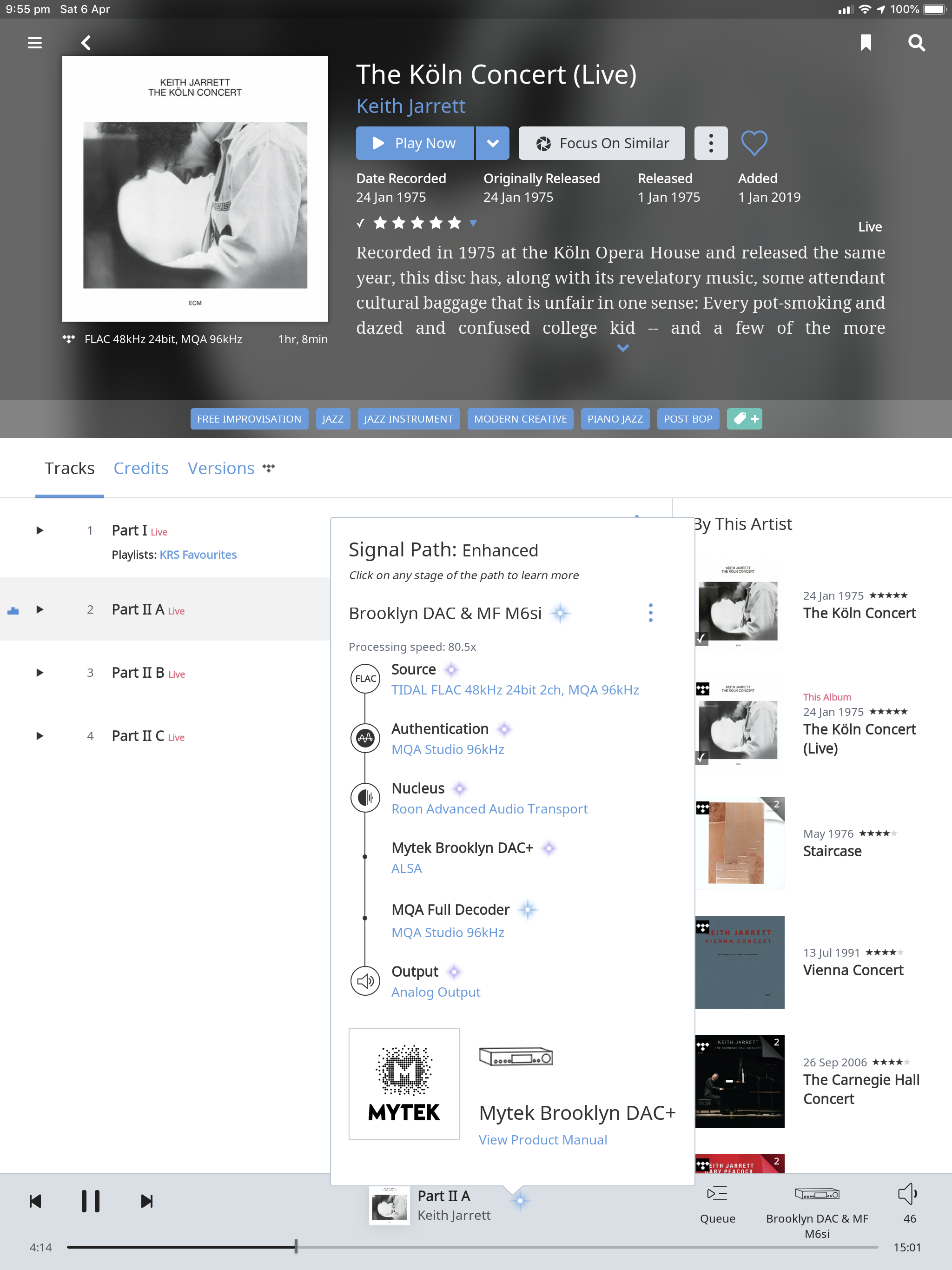

KRSDarwin Posted April 6, 2019 Posted April 6, 2019 (edited) Hi Perthpete, I am a long way from being an expert (or maybe even fully competent) but I have recently pursued MQA decoding on Tidal, kicked off by reading reviews in Stereophile. I am not familiar with the mconnect but can say: - To properly use MQA I believe you need a MQA decoder in your DAC, I purchased the Mytek Brooklyn DAC+ specifically to do this (photo below). I love it but would also say it is not always better and I can sometimes get just as good sound (or better in some cases) with other non MQA DACs in other systems I have. - Roon is a great way to use Tidal with your existing music library and has added, for me, a great deal of additional information and way to explore new music and obtain information on artists and albums - my main system is all connected by Ethernet cables, USB cables and interconnects and I am not sure whether wi-fi will allow you full access to these called hi-res audio. Lots of reading Hi-Fi magazines and sites such as this helped me on my journey. PS. This was typed on the iPad that controls the Roon software which includes Tidal (iPad screenshot below) while listening to Keith Jarrett via Tidal Masters (from a Roon Nucleus) using the Brooklyn DAC, Musical Fidelity amplifier and Paradigm Studio 100 speakers. Edited April 6, 2019 by KRSDarwin

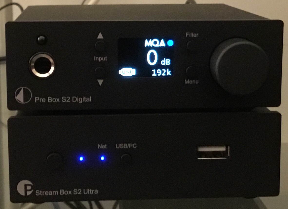

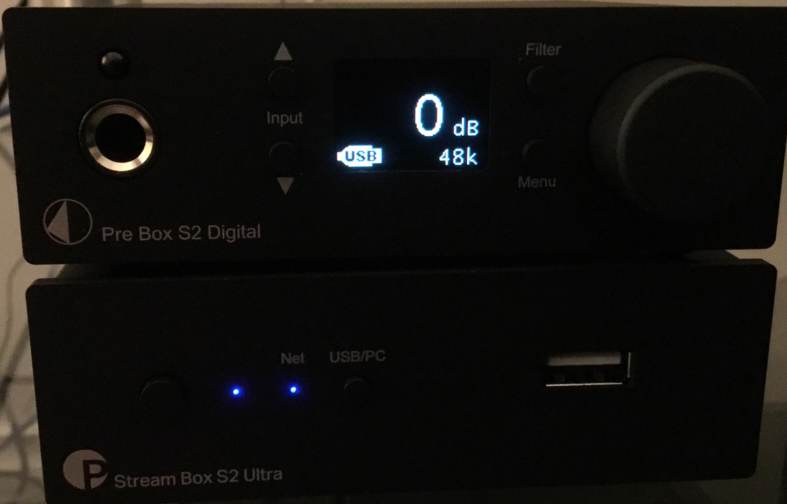

perthpete Posted May 7, 2019 Author Posted May 7, 2019 So I’ve got my (can I say cute? :-)) little boxes (stream box S2 ultra and pre box S2 Digital), all connected (usb in between them and RCA from pre box to receiver) and listening to Tidal by using the Project app on the ipad.. A challenge at the moment is anything I play shows up on the pre box as 44.1k or 48k and NOT getting MQA indicator in any track... even when playing playlist with only MQA tracks (including tracks which should be 192k). Not too sure what is missing (if anything) OR whether the issue that the full unfolding / MQA only can be achieved when managing the streamer/pre box from an actual computer (in others words not from ipad). I would think it should not make a difference given I am using the ‘embedded in the Project app Tidal so for now a little vexed... I have send an email to Pro-ject (which is forwarded to distributor), so hoping for some help from there... If anyone has experience with this particular setup (or additional ideas) again, appreciate any advice... [emoji16] (Note: should change the title of the topic, not sure if I can though)
perthpete Posted May 13, 2019 Author Posted May 13, 2019 Right, got it (thanks to someone on avsforums) I did not realise that while the app managing the Stream Box has a volume dial (virtual), it MUST be set to 100. If any other level you’d actually be editing the signal which means it will stick to 44.1 or 48 kHz max.. 1
