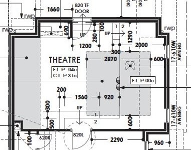

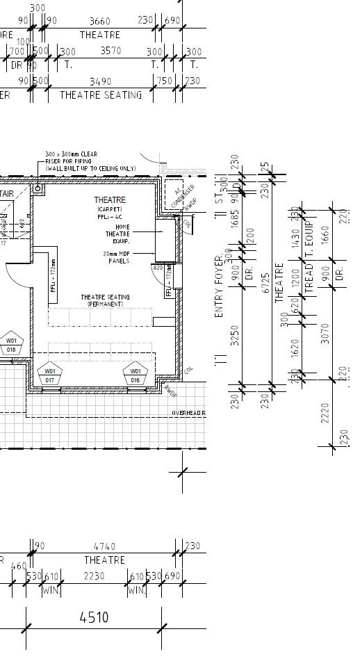

The finished room measures 4070mm across the front, opens to 4760mm at the rear, 6725mm long, 3000mm height at the front seats, 2650mm at the rear riser seats.
I allocated space for a dedicated equipment rack and had speaker cabling done to allow 7.2.4 surround setup.
I considered many bulkhead designs and opted for a drop bulk head at the front to allow some plumbing from upstairs to route through, and also allows an area to mask and hang curtains. This then gave me room to put speakers (and junk) behind an AT screen.

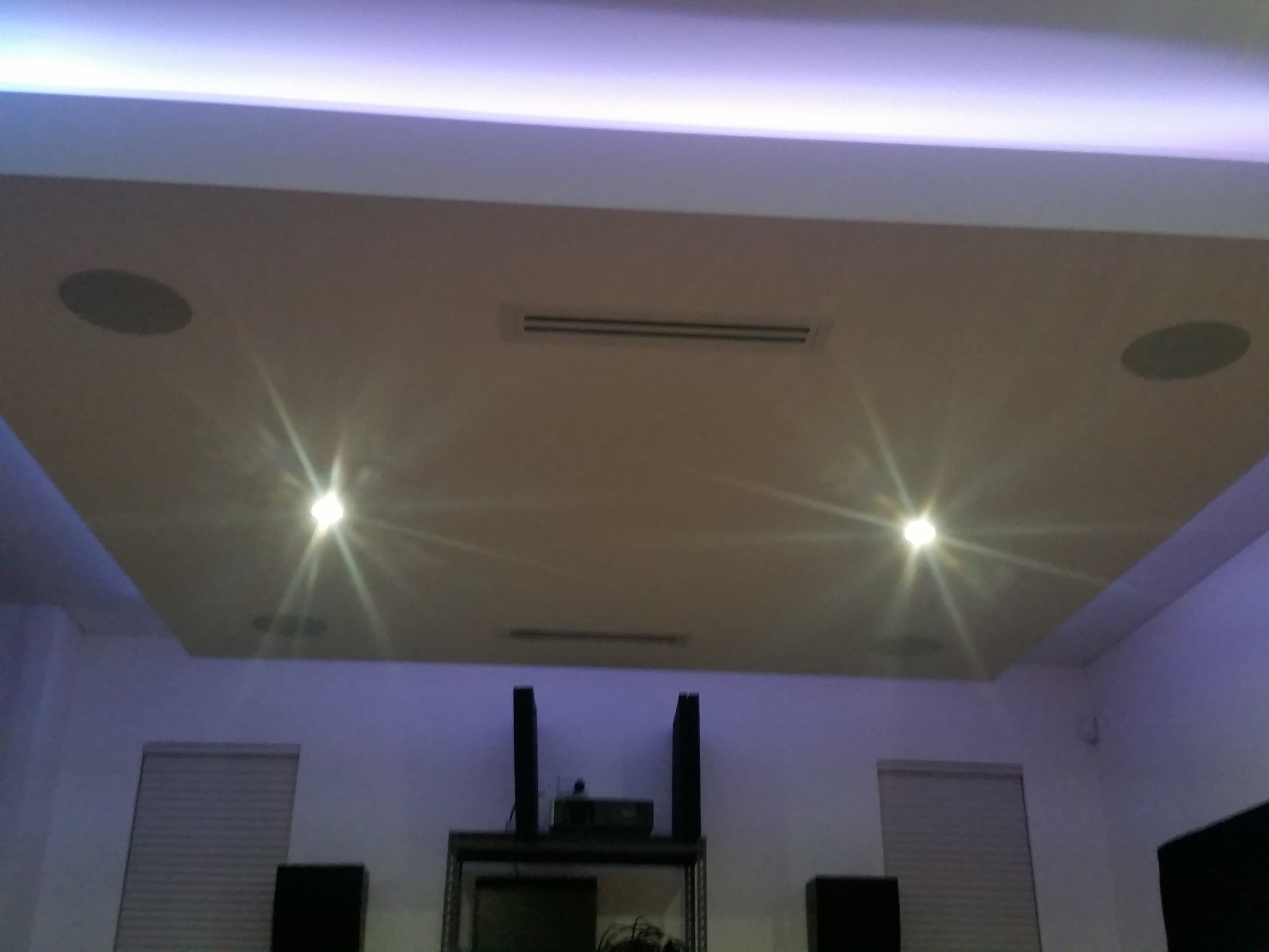

Rather than a perimeter bulkhead I did a 'reverse' bulkhead which gave me the ability to route ducted A/C directly to the seating area, LED around the bulkhead perimeter, general lighting and more importantly the 4 ceiling speakers.

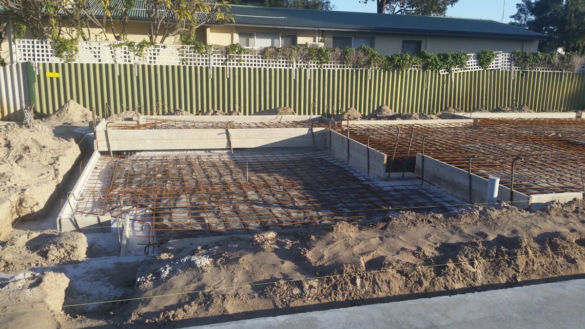

Shot of the theatre slab looking from the front to the back. You can see where formwork for the rear riser steps runs.
I deliberately sunk the theatre to gain the extra height for the riser steps and the dropped bulkhead.

Sinking the slab is it seems to better absorb the bass and together with double brick cavity construction its fairly muted standing outside, even when cranked right up.

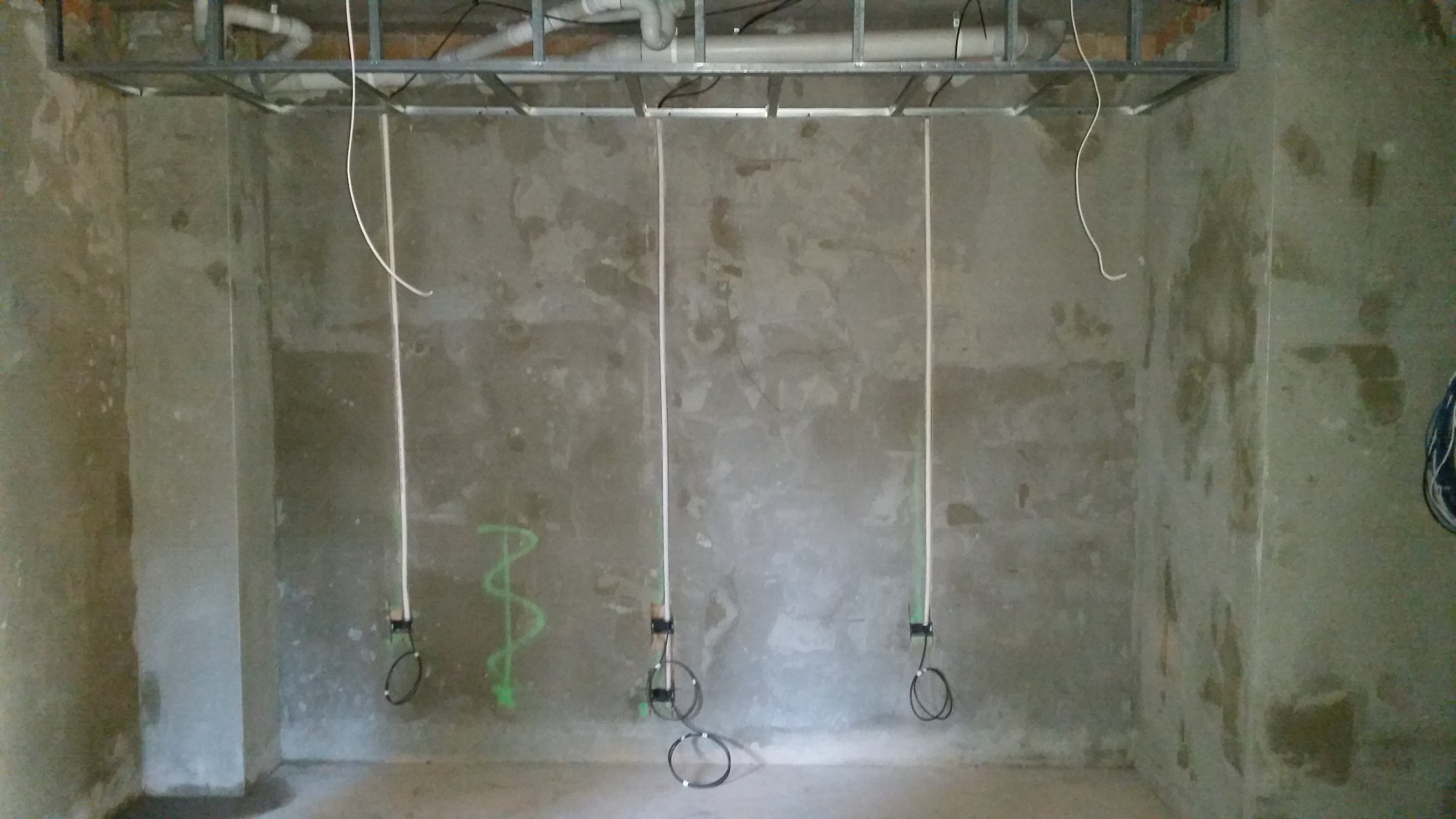

Shot of the front wall/bulkhead. Holes for 3 x LCR speakers, Sub1 and wall plate for power.

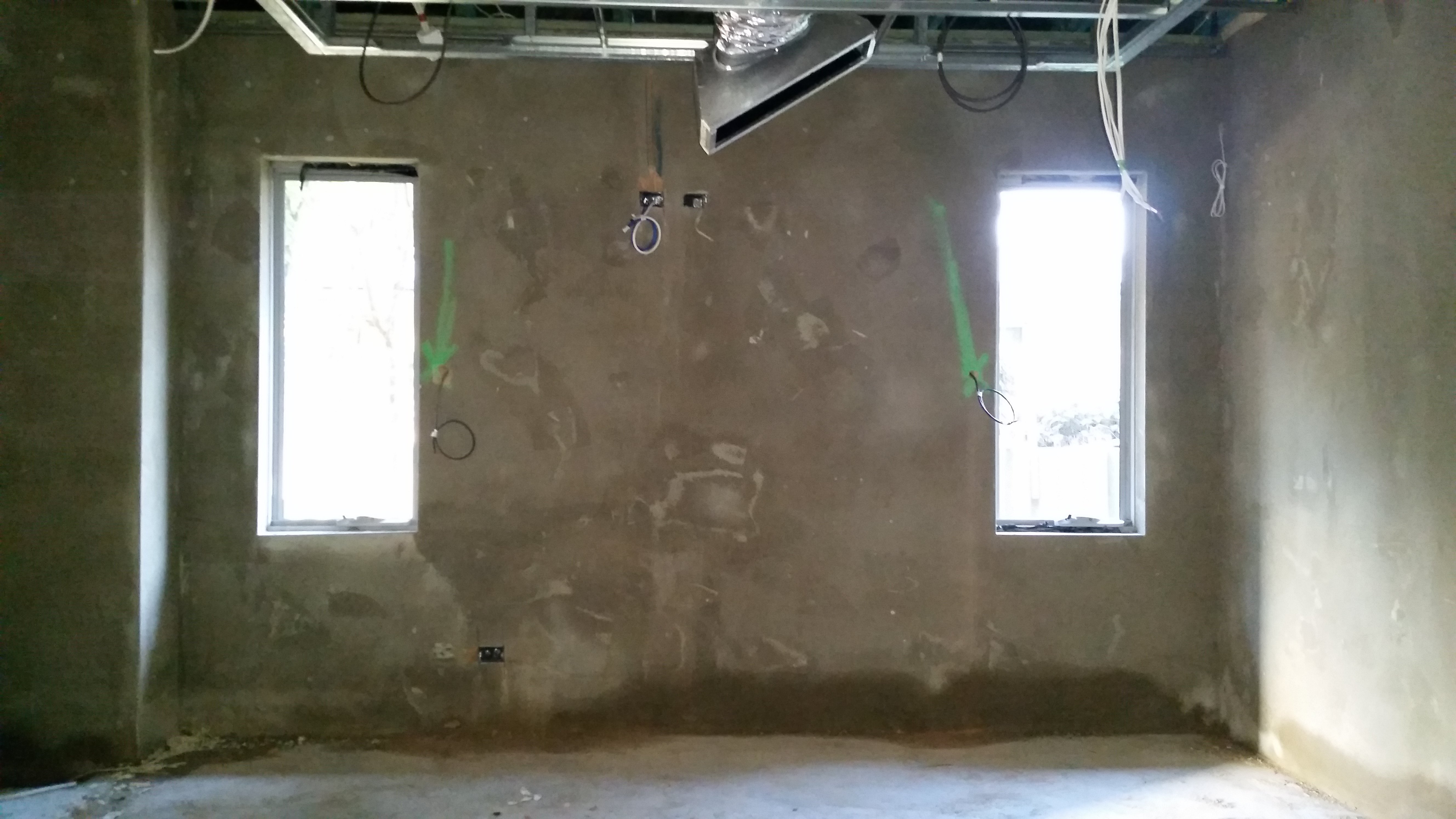

Rear wall with awning style windows. You can just see the reverse bulkhead, A/C duct and cabling. At the top middle is HDMI, CAT6 and wall plate power. The bottom leftish of photo is wall plate for power and Sub2

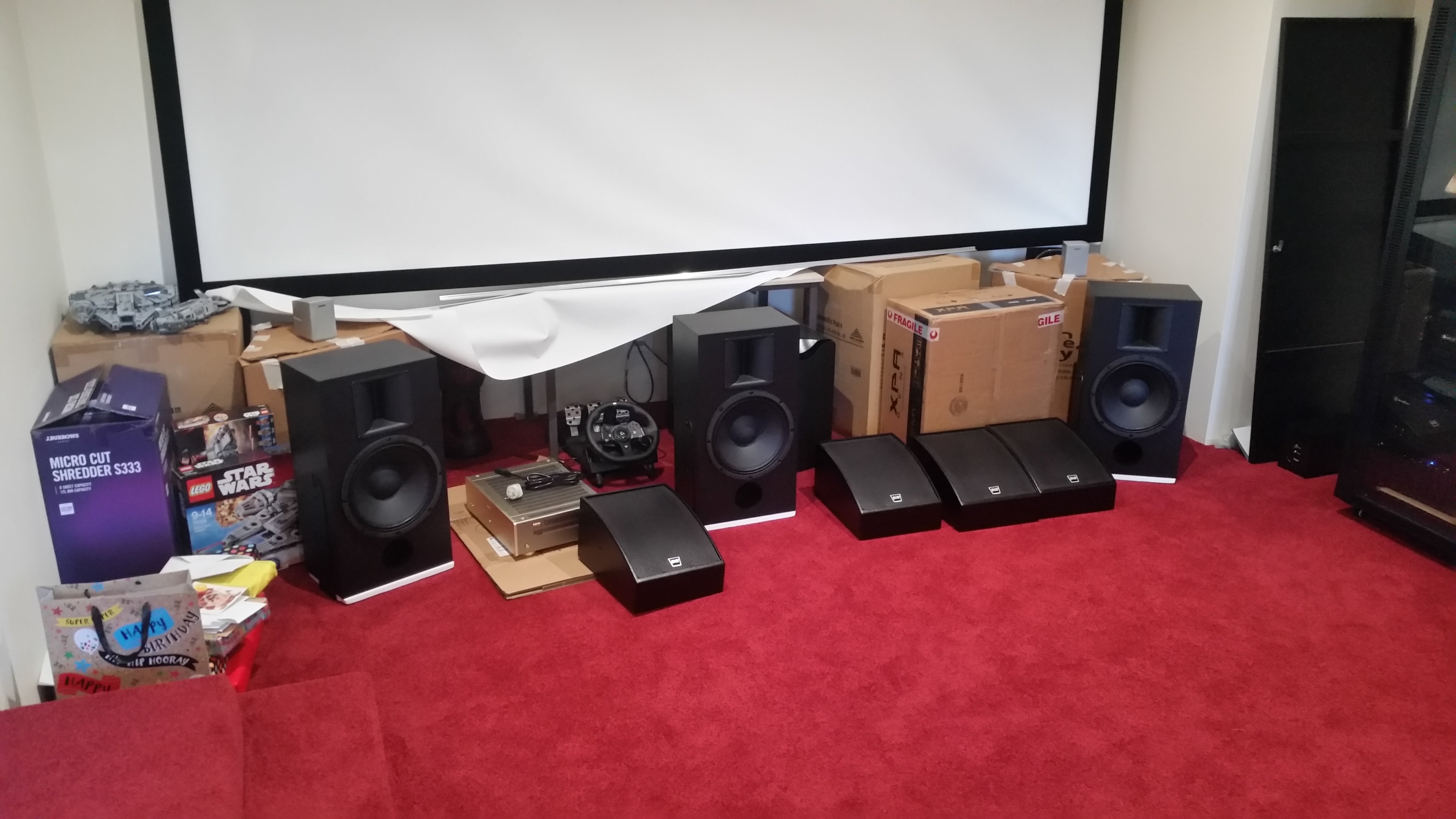

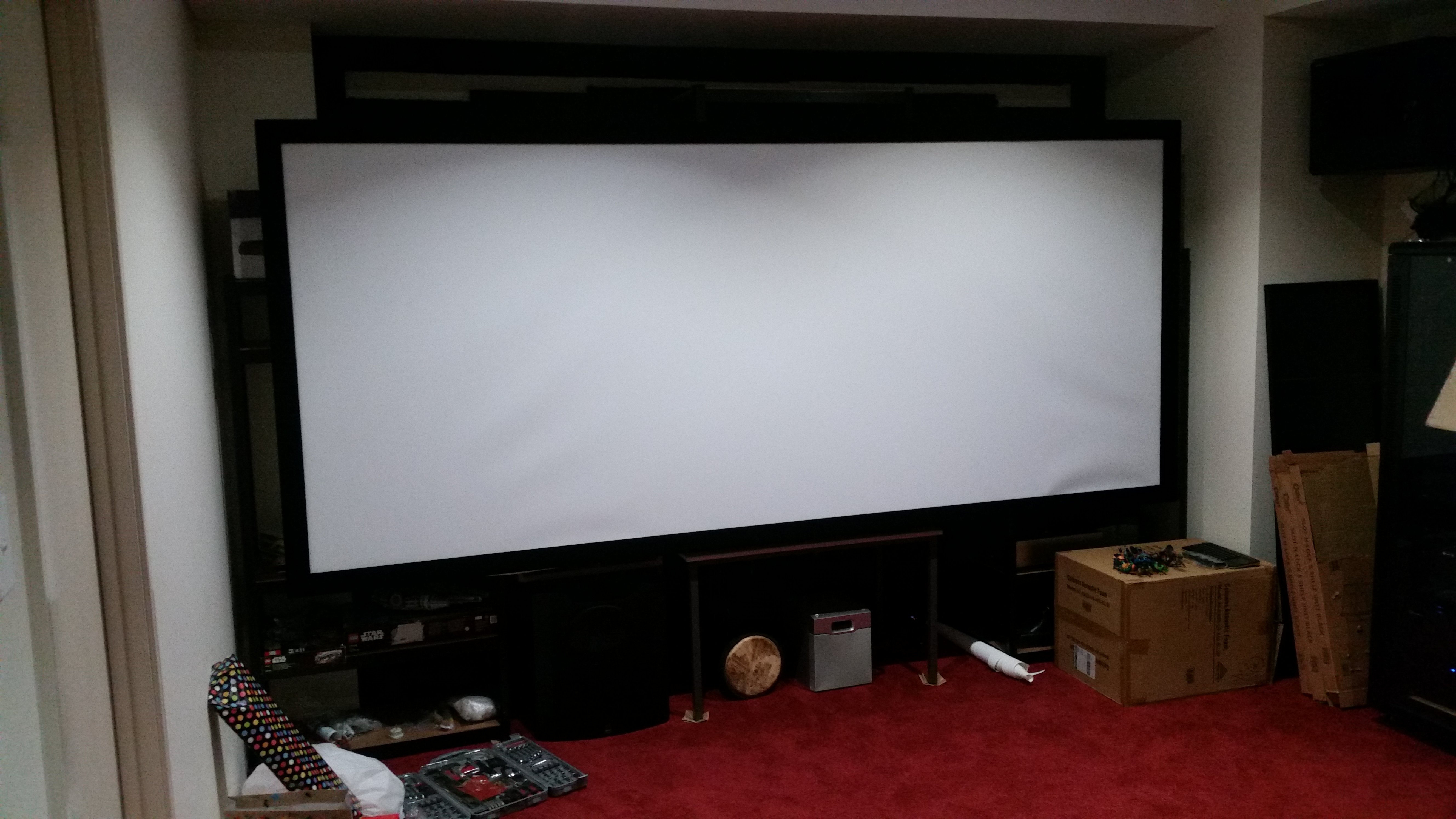

Speakers and screen in temporary setup.

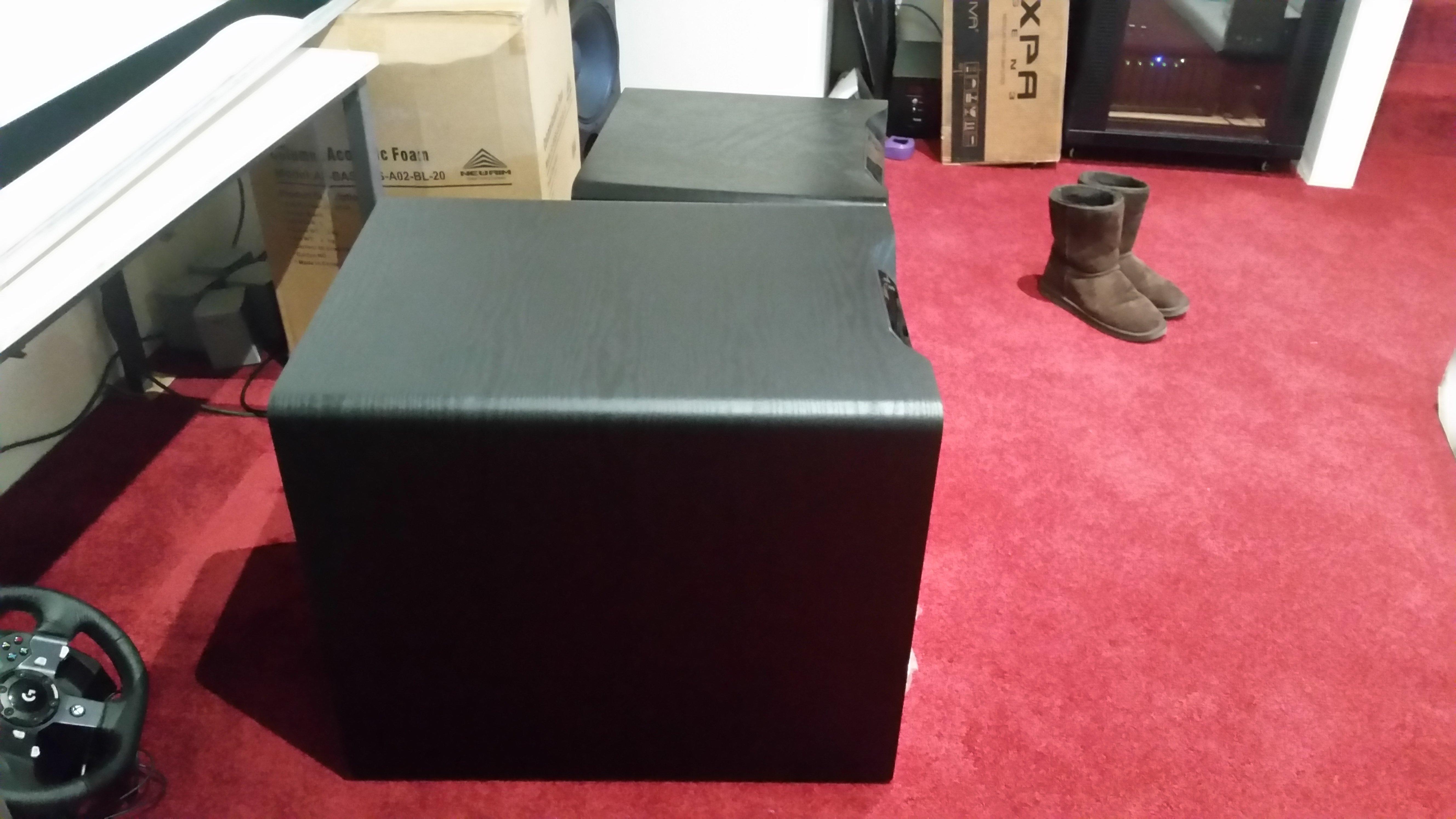

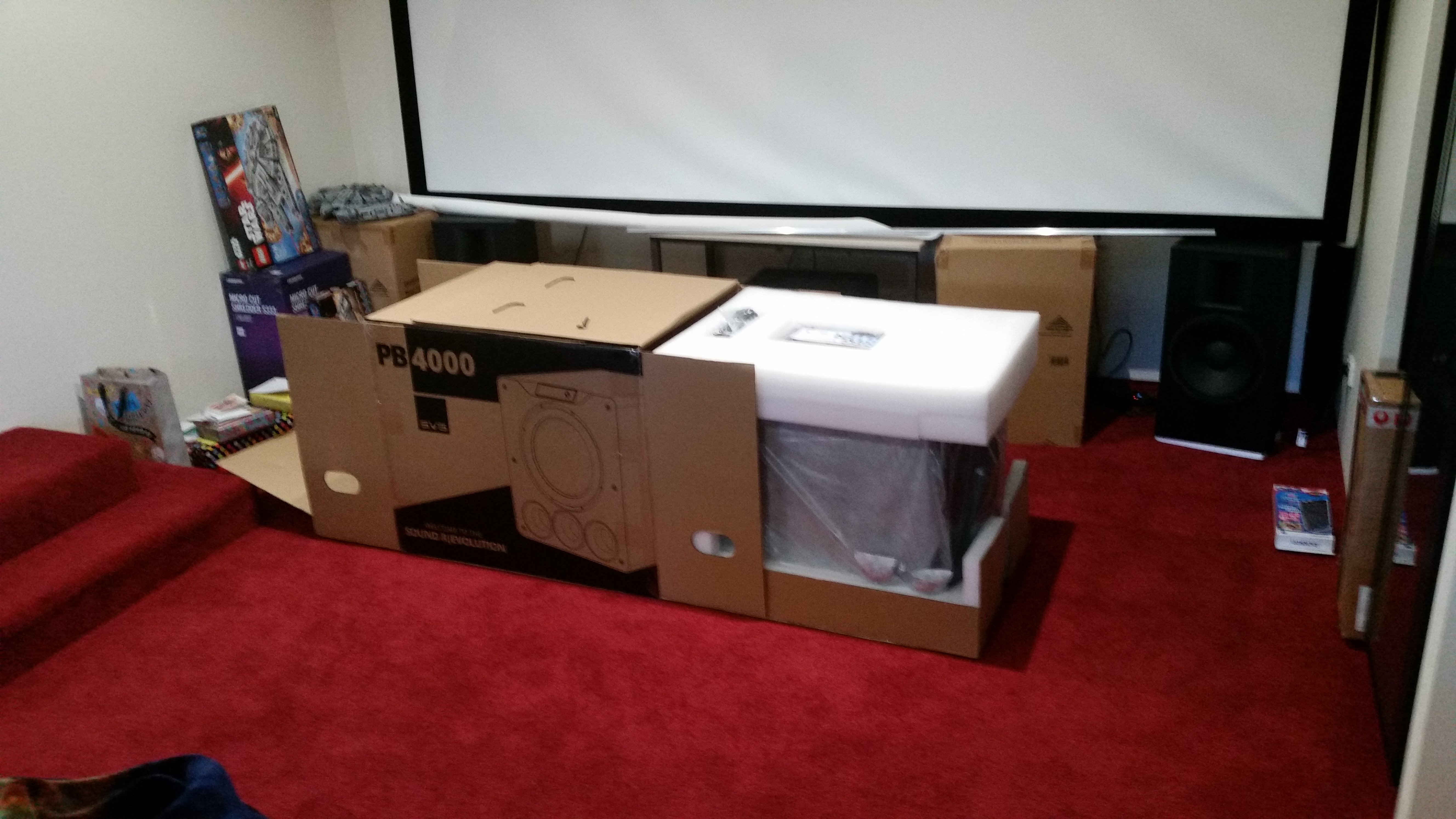

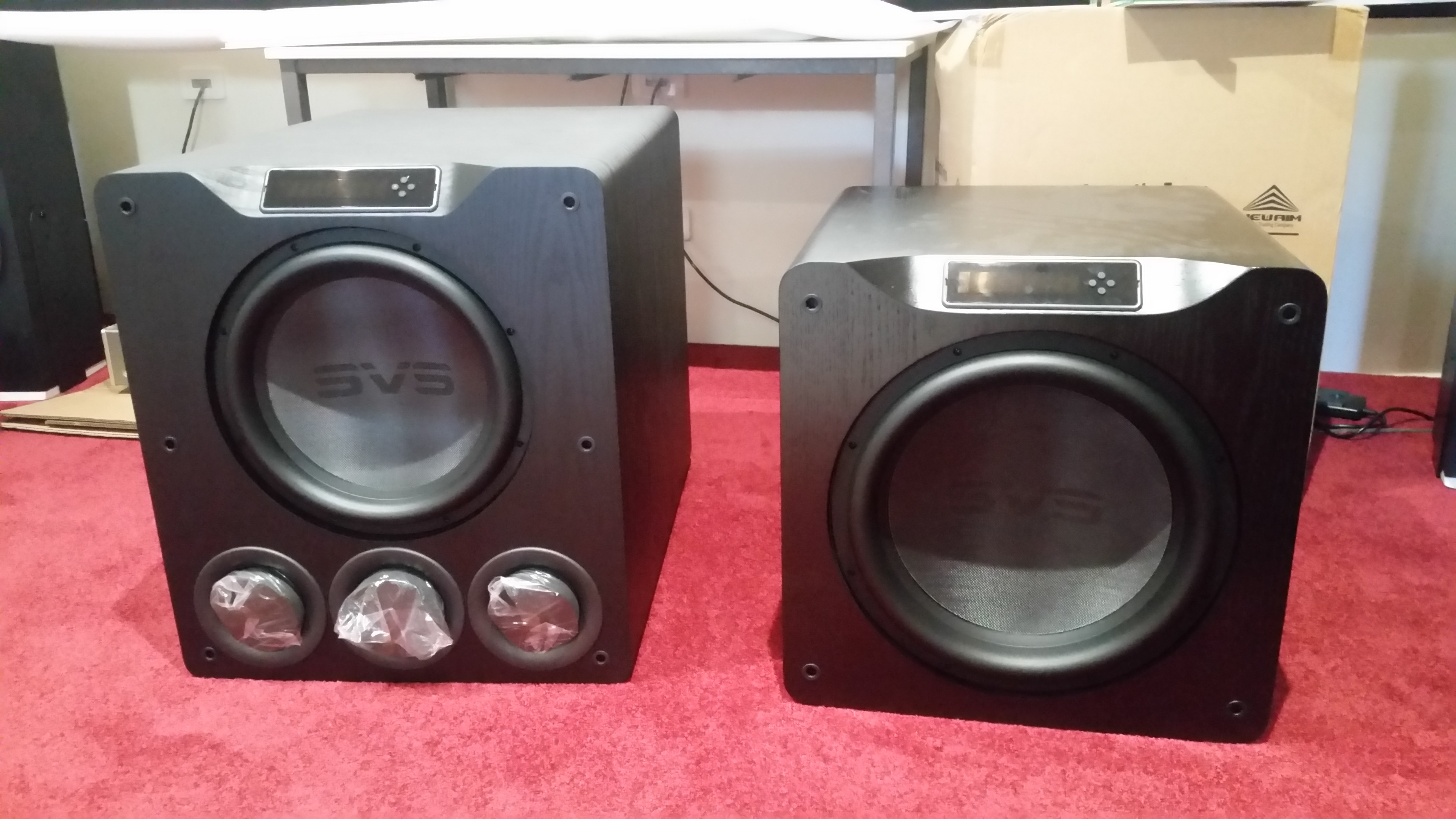

Unboxing SVS sub. I had a bit of trouble but I managed to wrangle this thing by myself into the room. The carpet helped.

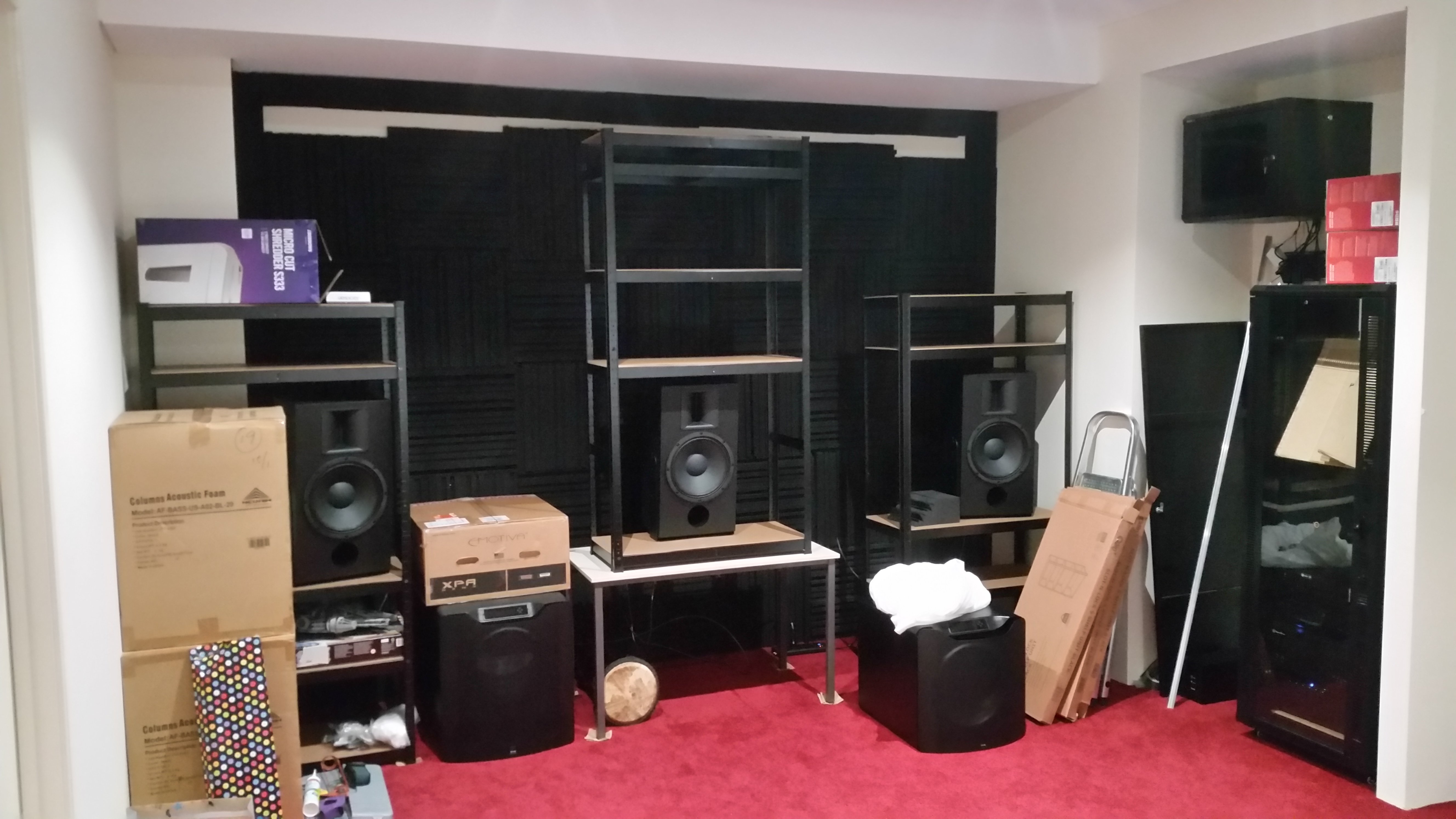

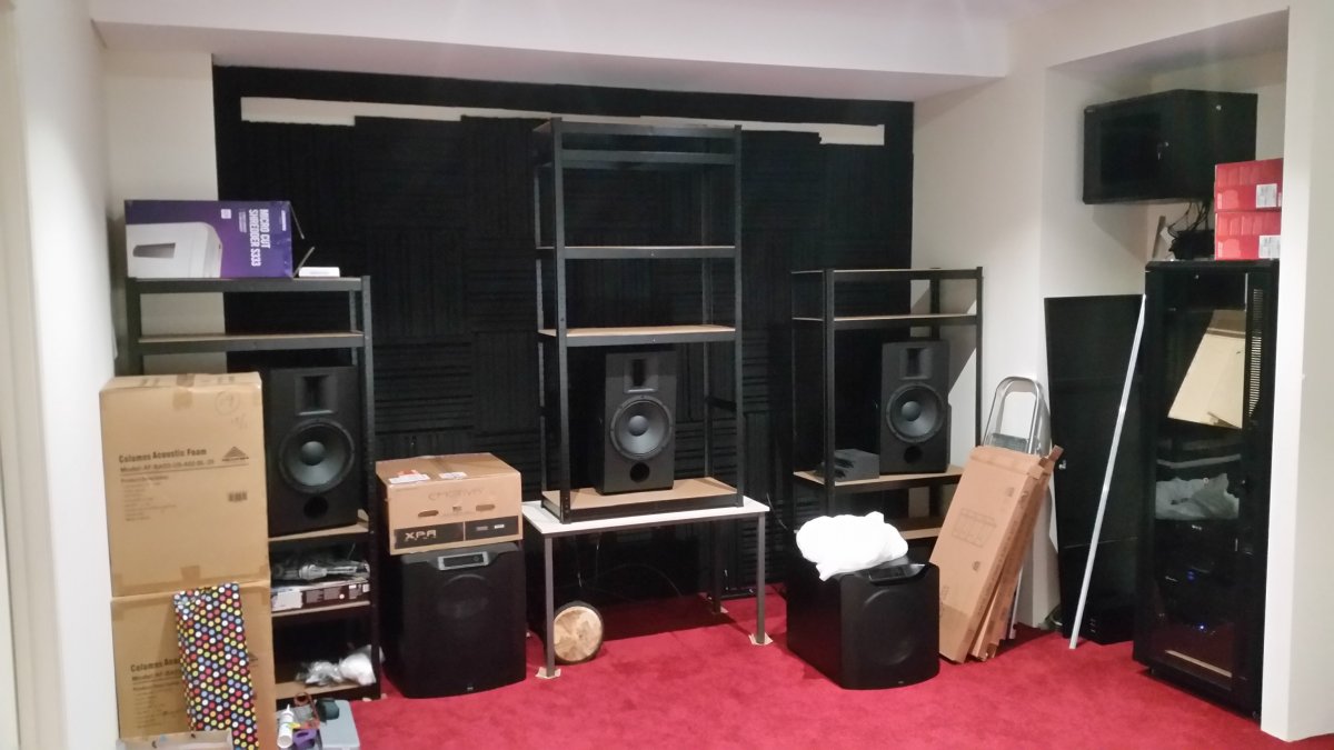

DIY front wall treated with elchepo 'acoustic foam'. Speakers elevated with elcheapo stands.

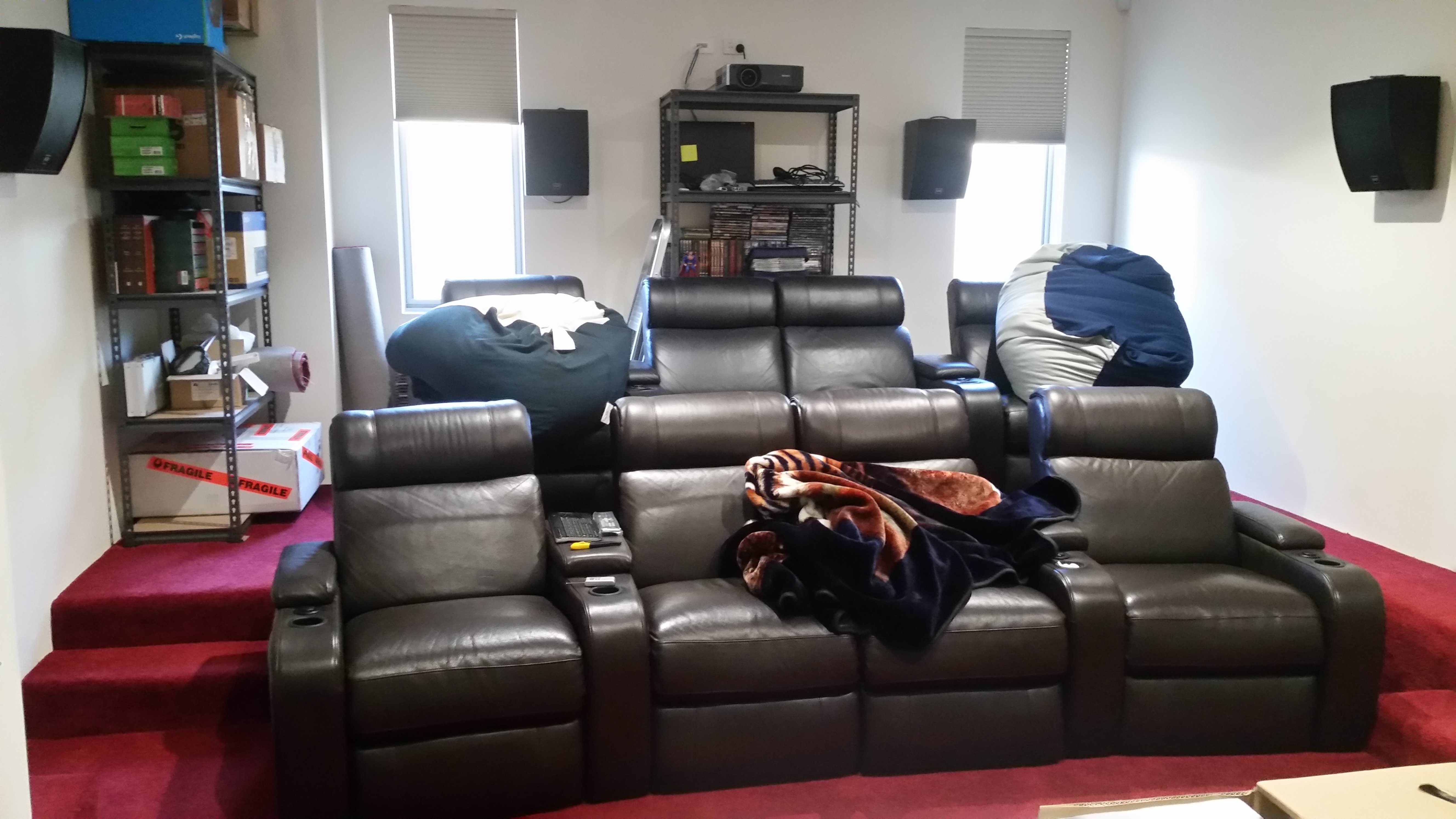

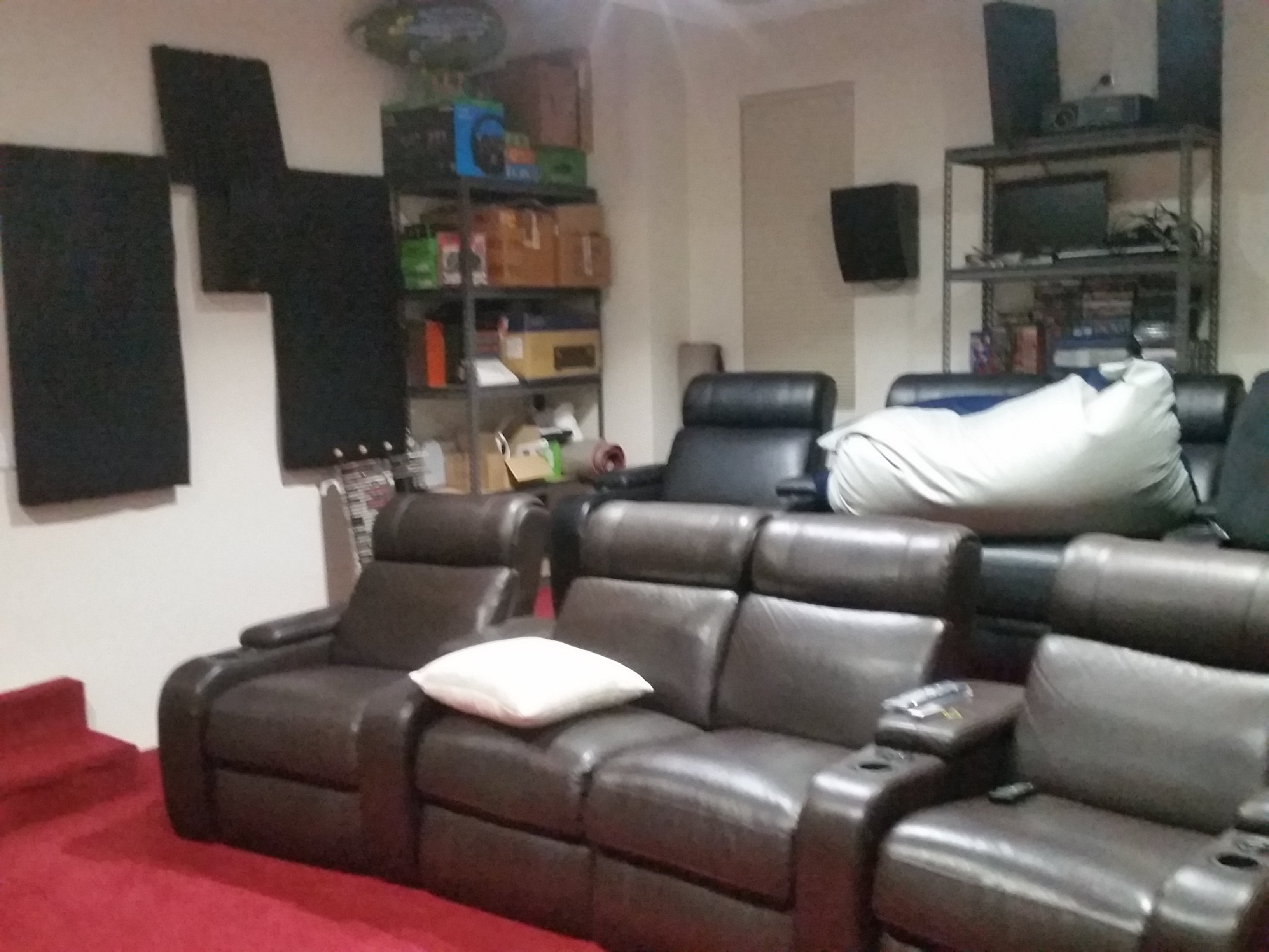

Rear shot showing 8 seats and rear stand for projector.

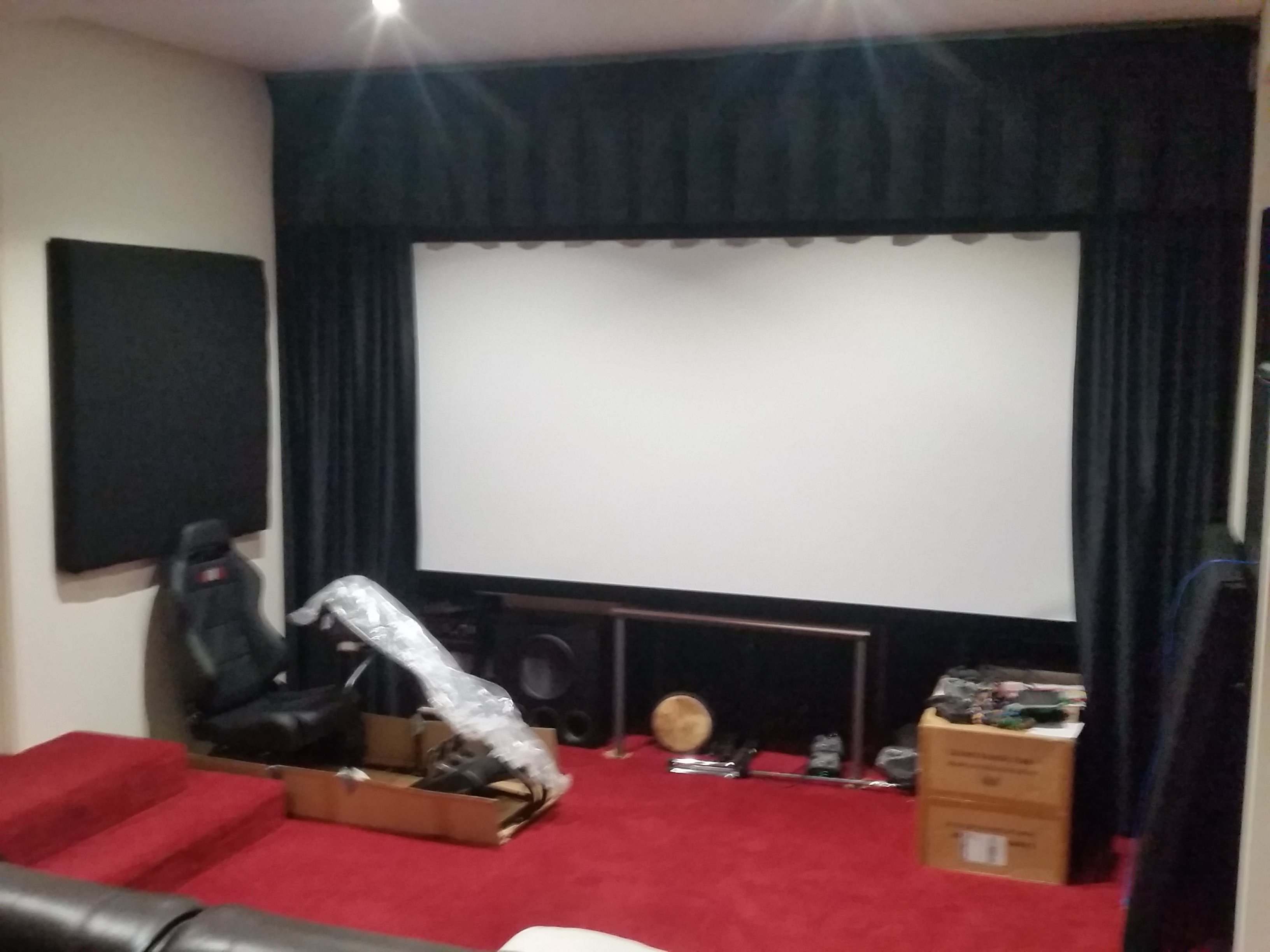

Screen back up

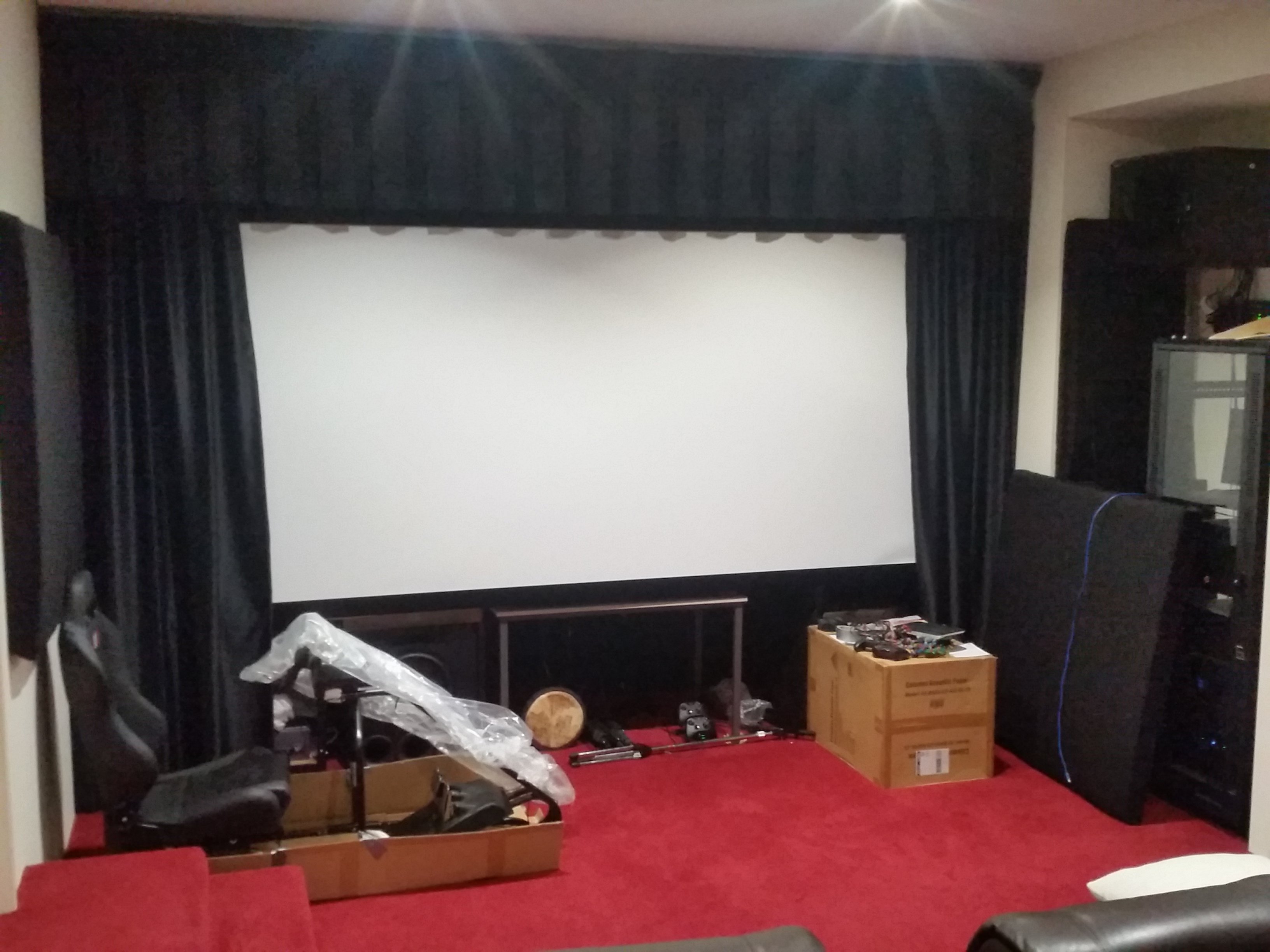

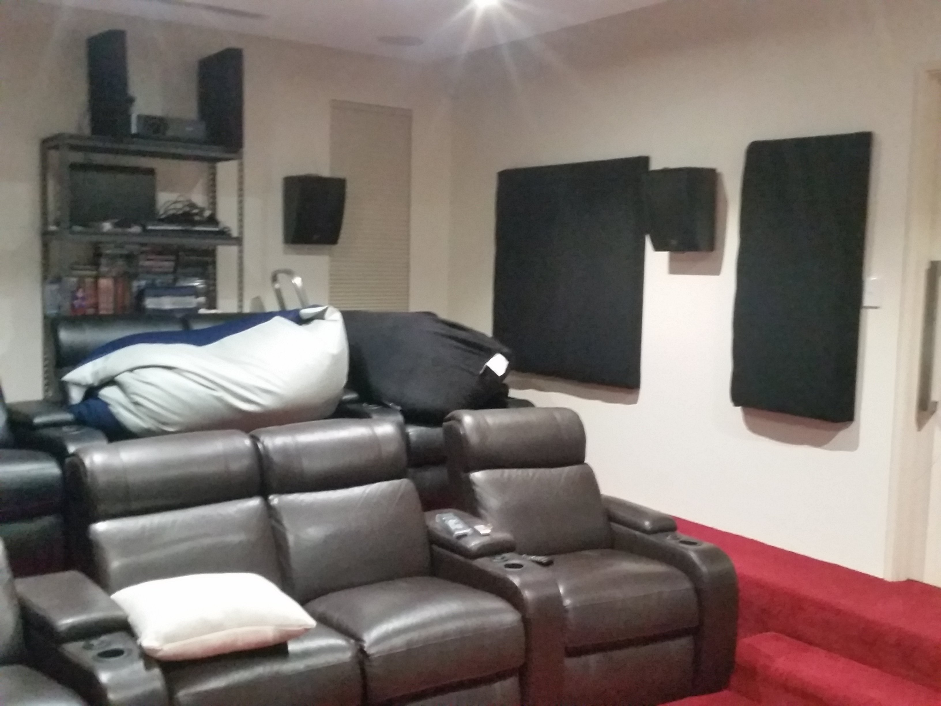

Curtains up. Made up some DIY acoustic wall panels with Polymax 50mm sheets. Doubled them over and wrapped them in black cotton.
In-ceilings

It's a good idea to drop floor level below ground level, the problem is that the part of a external wall that is below ground level needs to be treated as a retaining wall. Unfortunately most builders don't pay enough attention to retaining walls.

Yes - that was my main concern, plus settlement cracks along the joining wall/floor perimeter. Builder did apply the bitumastic sealant around and applied the termite mesh treatment so all good.

The plan was always for at least two subs.
After house construction I was keen to understand the room response and did not want to over commit on 2 x large subs (or more), thus opted to take incremental steps and bought the sealed 16" to start. I did some basic positioning and measurement checks, then settled on the best position for the single sealed unit. The 16" was dialled in at around -16dB to suit the room at that stage. It was tight and punchy and gave the wham but didn't extend much below 22Hz in room. I took a judgement call and opted for a 'smaller' sub - the 13" but ported. The key things I thought at that time:
  • I didn't need to get another 16" as power was plenty already and it hit hard enough for what I was measuring and feeling, extra headroom was there. Spending on another 16" only to dial that to -22dB does not make sense.
  • The second sub should get more even distribution through more listening positions but I was aware of the low end <20Hz deficit. The SVS published frequency data was believable based on checking the 16" so I trusted the 13" data on the published low extension.
  • The ported unit gave more flexibility in configuration compared to another sealed unit, and if needed I could plug all the ports to act as a sealed unit. However, I did find a big difference in capability between the 16" sealed vs the 13" ported in 'sealed' mode. 13" was good but could not catch the dedicated sealed unit in tightness and 'breadth'. I would not consider the ported unit 'musically' inclined. The POWER in the 16" is effortless.
  • I picked up the 16" on a good sale before pricing went up. I bought the ported unit about 8 months after pricing went up (by alot). It was a value consideration at that time for smaller subs or 2 x smaller subs but in the end I realised I wanted needed the onboard DSP without having to go to external DSP. Internal sub DSP at the time was only available on the 13" units and up.
Long and short of it I was careful in my consideration and allowed time for tweaking, gave me the flexibility of room tuning. I got a hold of the MSO program and that made the biggest difference and it was 'free'. Free in the sense it didn't cost $ but it does cost time. If you don't have the care and patience don't expect to get the results, or you pay a professional to do it for you.

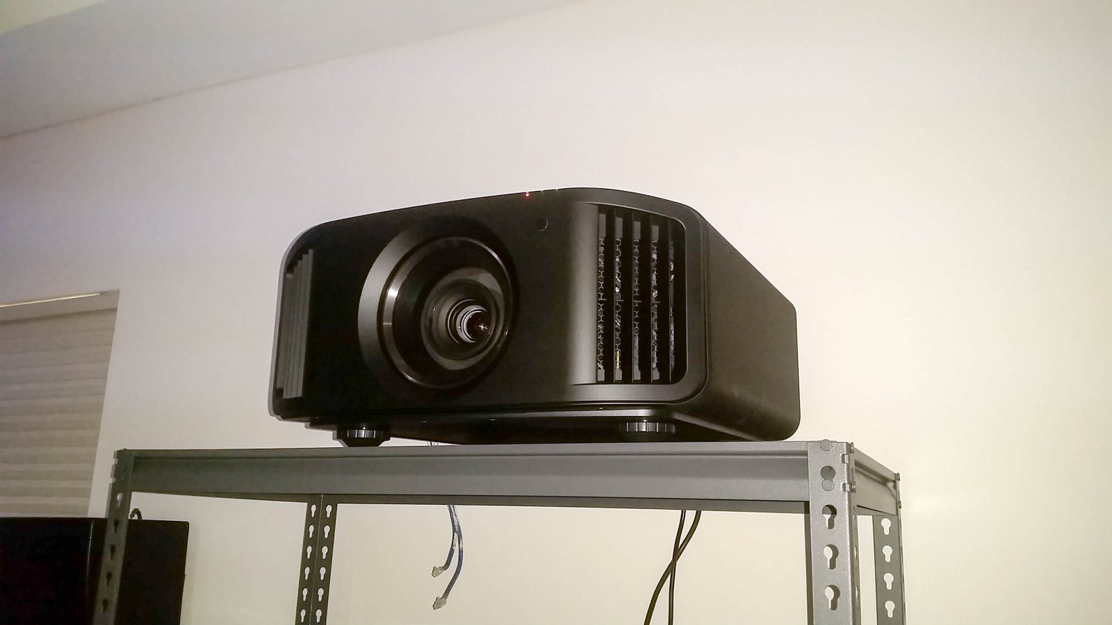

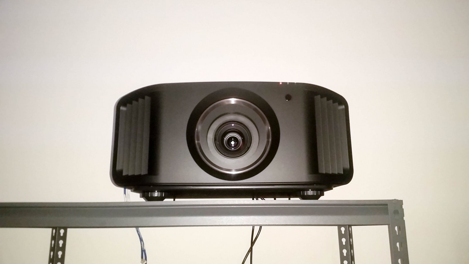

Time for a new toy. Jumping from 720p to 4K. The difference is huge to say the least.

It's a big jump in detail and colour that's for sure. Each to their own but at 150" scope screen I needed as much light and detail as I could get.
The biggest difference seems to be on quality source material, so if you watch mixed media (FTA TV, DVD, 1080BR) 1080i/p the gains are marginal.
  • 3 years later...
  • Author
Equipment updates in bold
2 x Eve Audio SC4070 Active Studio Monitors (Left, Right)
Decommissioned 2 x SLS Audio CS50 (previous L, R speaker - looking to repurpose as front heights, need 13.2 processor)
1 x SLS Audio (Dolby) CS50 LCR speaker (Center)
4 x SLS Audio (Dolby) CS850S Surround speakers
4 x Klipsch CDT-3800 II in-ceiling speakers
1 x SVS SB-16 Subwoofer
1 x SVS PB-4000 Subwoofer
Denon 6300H AVR
Emotiva XPA-7 amplifier
Minix UH-9 with remote
Xbox One X
Decommissioned HTPC
JVC N7 Projector
