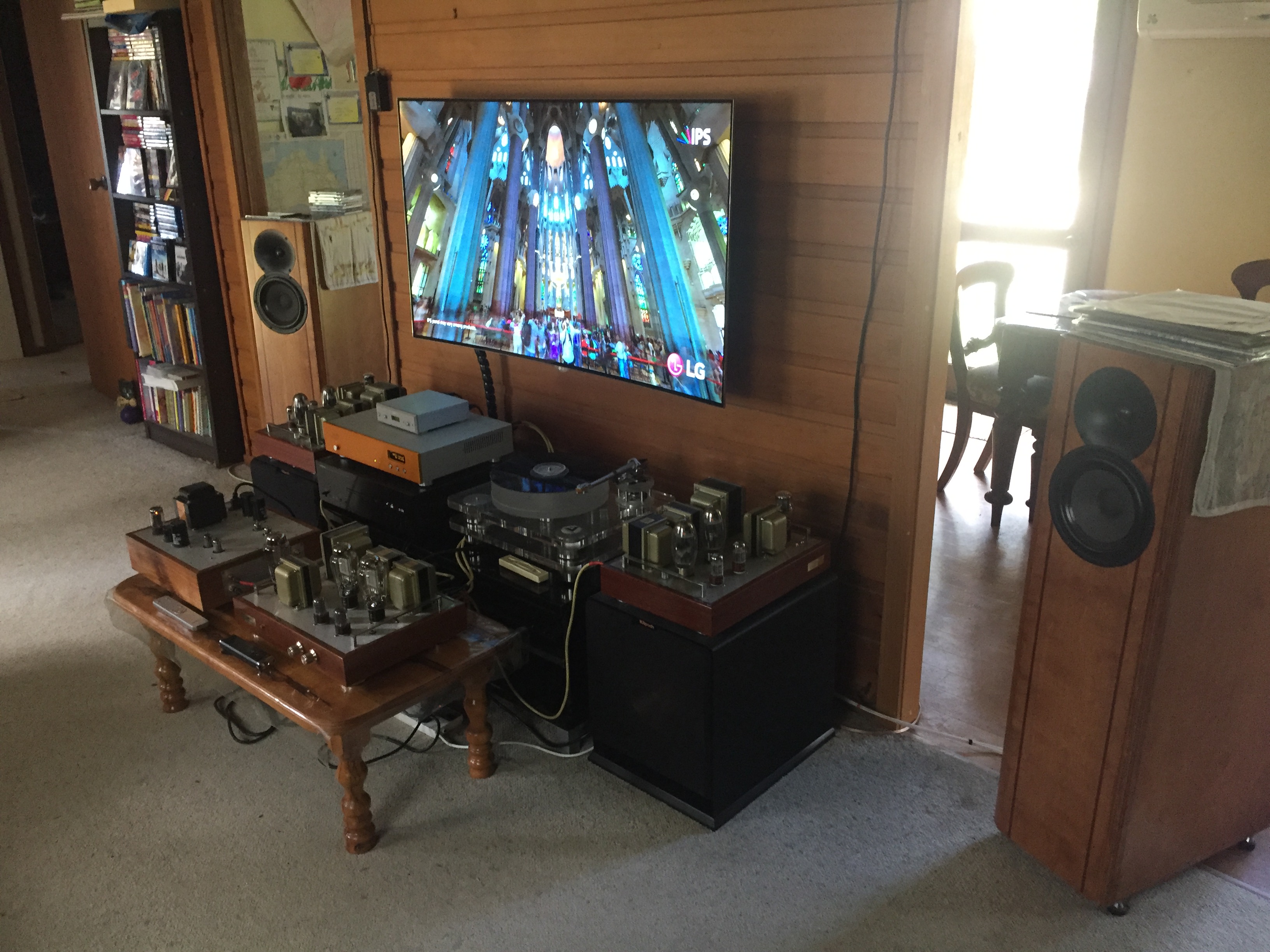

darth vader Posted October 22, 2017 Posted October 22, 2017 (edited) I've been kicking this can around the carpark for a while now. I think I have worked up the gumption to make a move on it. My DTQWT MkII have JA8008 and Audax TW034 along with the twin 10" eminence woofers. Some of you may have seen Troels has now offered what he calls a DTQWT-mkIII-flat. I am of the view that the Mk-III might be sonically great, but it looks like a box of busted hammers. The MkIII flat still keeps the sleek look and could be a good thing. The Mk-III-flat requires a few crossover changes and the JA8008-HMQ driver. I managed to buy a pr of Seas T35's and spare wave guides. These need no xover change to install into the MkII if I read things right. So I'm set to go for a tweeter swap, and with the MkIII flat kit I should be able to swap the older JA8008 for the JA8008-HMQ. Happy days...the DTQWT MkII is now a MkIII. (sounds so simple doesn't it...lol) Ok, so after the cost and graft, that job is done and I'm in MkIII land, with angels weeping out of my new improved speakers... So, left over is 2 JA8008's and 2 Audax TW034. Back to kicking the can around the car park again, me thinks to self... Buy one SEAS MCA12RC 4" and xover kit from Jantzen, use JA8008's and one Audax TW034, and got the makings of an 8008 centre. Troels tells me to make older JA8008/Audax work in the centre, order old kit from Jantzen (specs supplied). Seems can kicking made a goal. Looking like it could work out. My Mk-II cabinets were made by Arronmar Acoustics and are impeccable. I could not make cabs as good as them in my dreams. I contacted them about making an 8008 cab. It appears they can make matching cabinet to Troels specs with MDF baffle for reasonable cost and can also make matching baffle from Birtch ply. I'm curious as to if anyone else may be interested in this kind of project. It wont be pocket change but also wont cost a sheep station. The goal is to end up with a DTQWT MkIII flat and an 8008 centre for a reasonable outlay from a MkII DTQWT. I'm happy to go it alone, but I'd be really happy to find someone that has also thought of this and maybe work together. I'm pretty nieve at this kind of thing. Some help would be appreciated. Edited October 22, 2017 by darth vader 2
