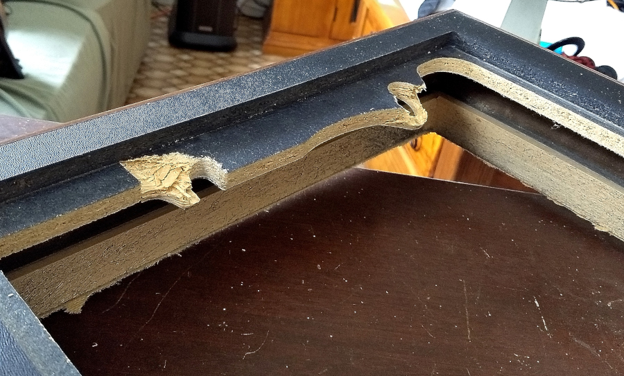

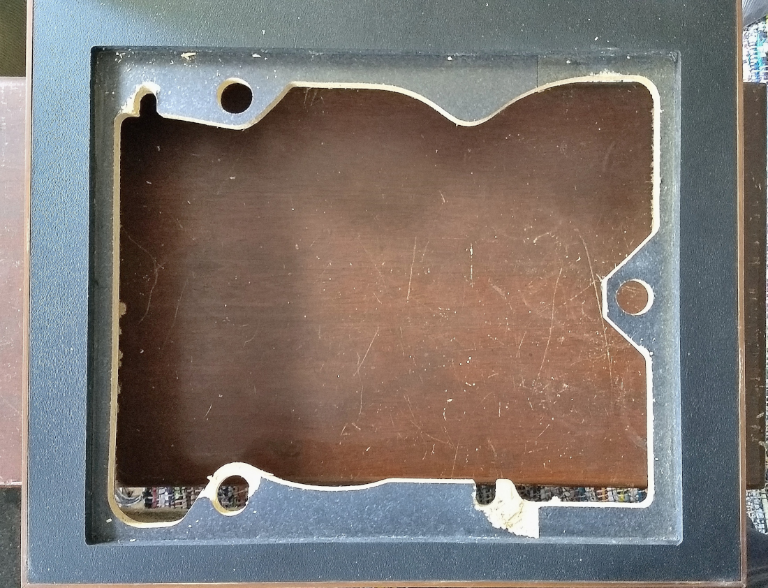

redeye1964 Posted October 14, 2017 Share Posted October 14, 2017 I recently received a Dual 1216 turntable, unfortunately it was sent without the transport screws wound out and the plinth is damaged around the base spring holes. Are there any suppliers of plinths where i could purchase one - not too worried about appearance, more structural integrity Link to comment Share on other sites More sharing options...
EV Cali Posted October 14, 2017 Share Posted October 14, 2017 Could you post a couple of pictures of the damage . It could be an easy repair. Link to comment Share on other sites More sharing options...

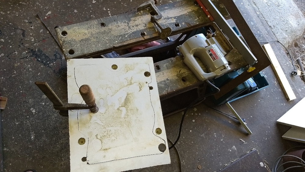

redeye1964 Posted October 15, 2017 Author Share Posted October 15, 2017 I'm considering trying to make a new piece out of thick perspex using the broken piece as a template - will be tricky getting the holes exactly centred.....if l can't get a replacement plinth Link to comment Share on other sites More sharing options...
EV Cali Posted October 15, 2017 Share Posted October 15, 2017 I do not think you are likely to find a replacement plinth in Australia. Although there appears to be some cheap on the American ebay site, post would probaly make them too expensive. It could be repaired by cutting out the damaged parts and replacing with new material but it would probably be just as easy to replace the whole piece with plywood , not Perspex. Once you have a rectangle the same size as the existing piece you can draw round the original and then cut it out with an electric jigsaw. Centering the holes and then cutting them out with a small hole saw would not be a problem. If you are not handy there is probably a small Joinery works near you that could do the job. Link to comment Share on other sites More sharing options...
redeye1964 Posted October 15, 2017 Author Share Posted October 15, 2017 Cheers mate. I've got the tools for the job and have some 3/4" mdf that will do the job Link to comment Share on other sites More sharing options...
EV Cali Posted October 15, 2017 Share Posted October 15, 2017 Yes it would be better than the original chipboard. Link to comment Share on other sites More sharing options...

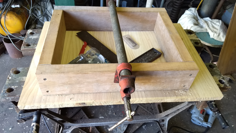

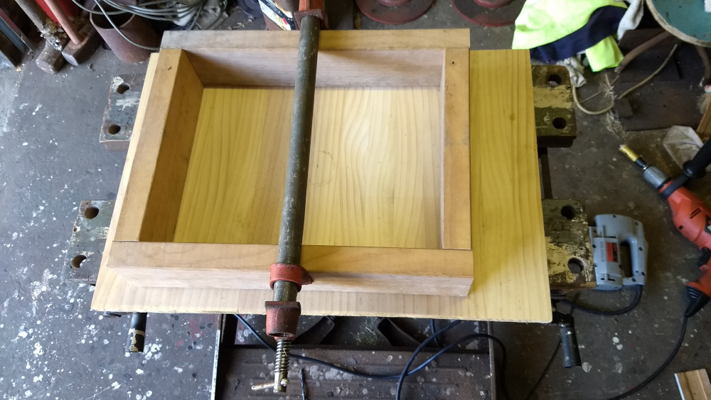

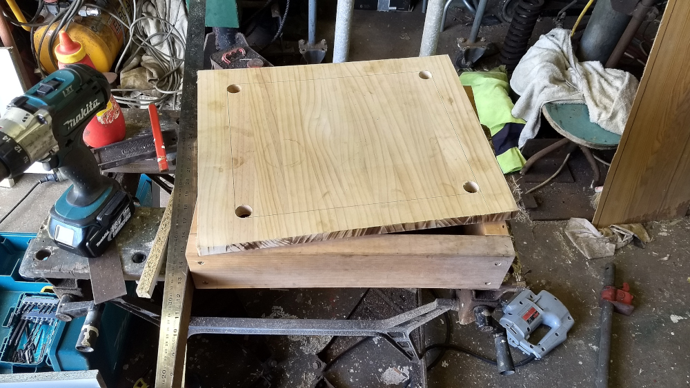

redeye1964 Posted October 21, 2017 Author Share Posted October 21, 2017 (edited) l've built a new one - 4"x2" with a 3/4" top (pine) and 5/8" inset that the tt sits in. lt's very solid, glued & screwed....plenty of mass. Haven't decided on a finish but probably just sand it and spray paint it black Photos here Edited October 21, 2017 by redeye1964 Link to comment Share on other sites More sharing options...
redeye1964 Posted October 21, 2017 Author Share Posted October 21, 2017 Quote 1 Link to comment Share on other sites More sharing options...
EV Cali Posted October 21, 2017 Share Posted October 21, 2017 Love it. Will do the job and look good when filled and painted. 1 Link to comment Share on other sites More sharing options...
