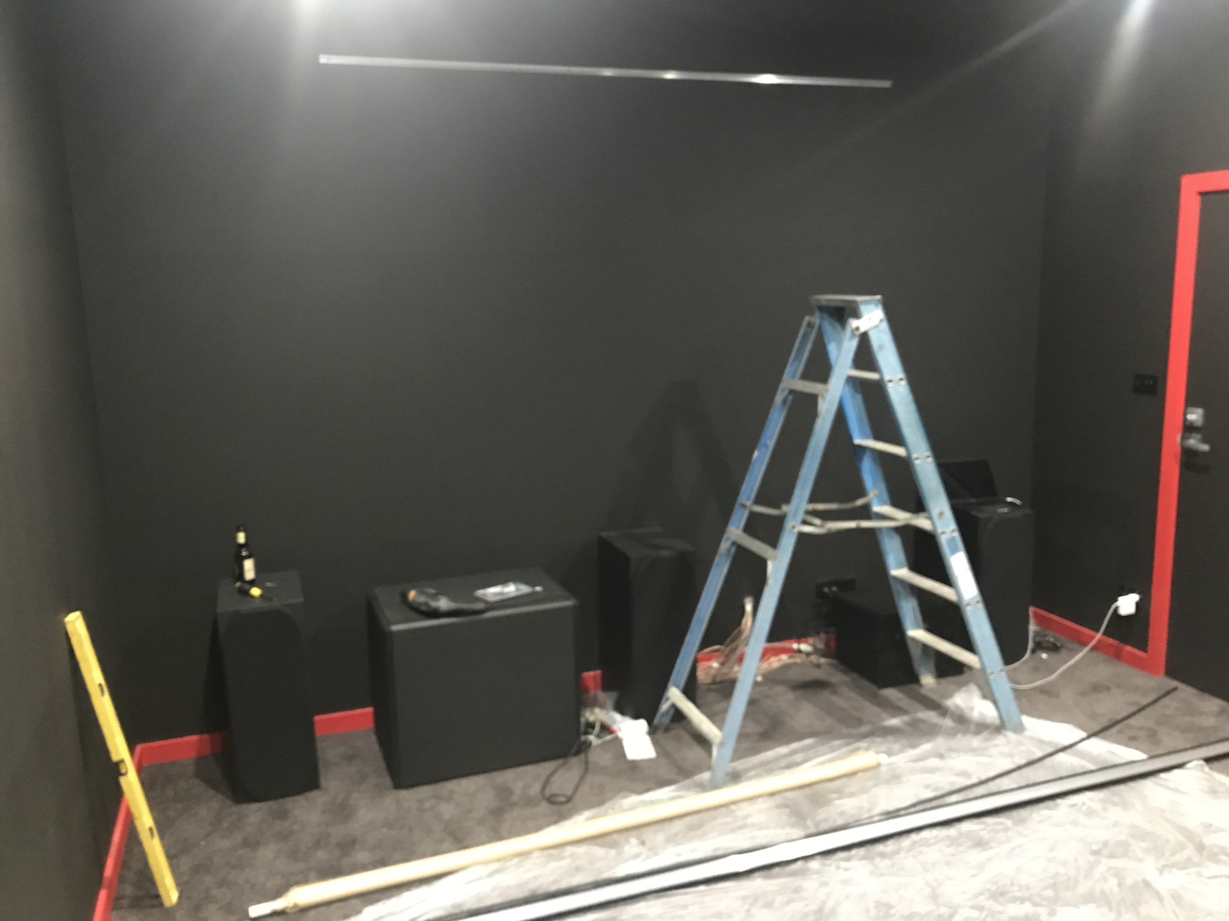

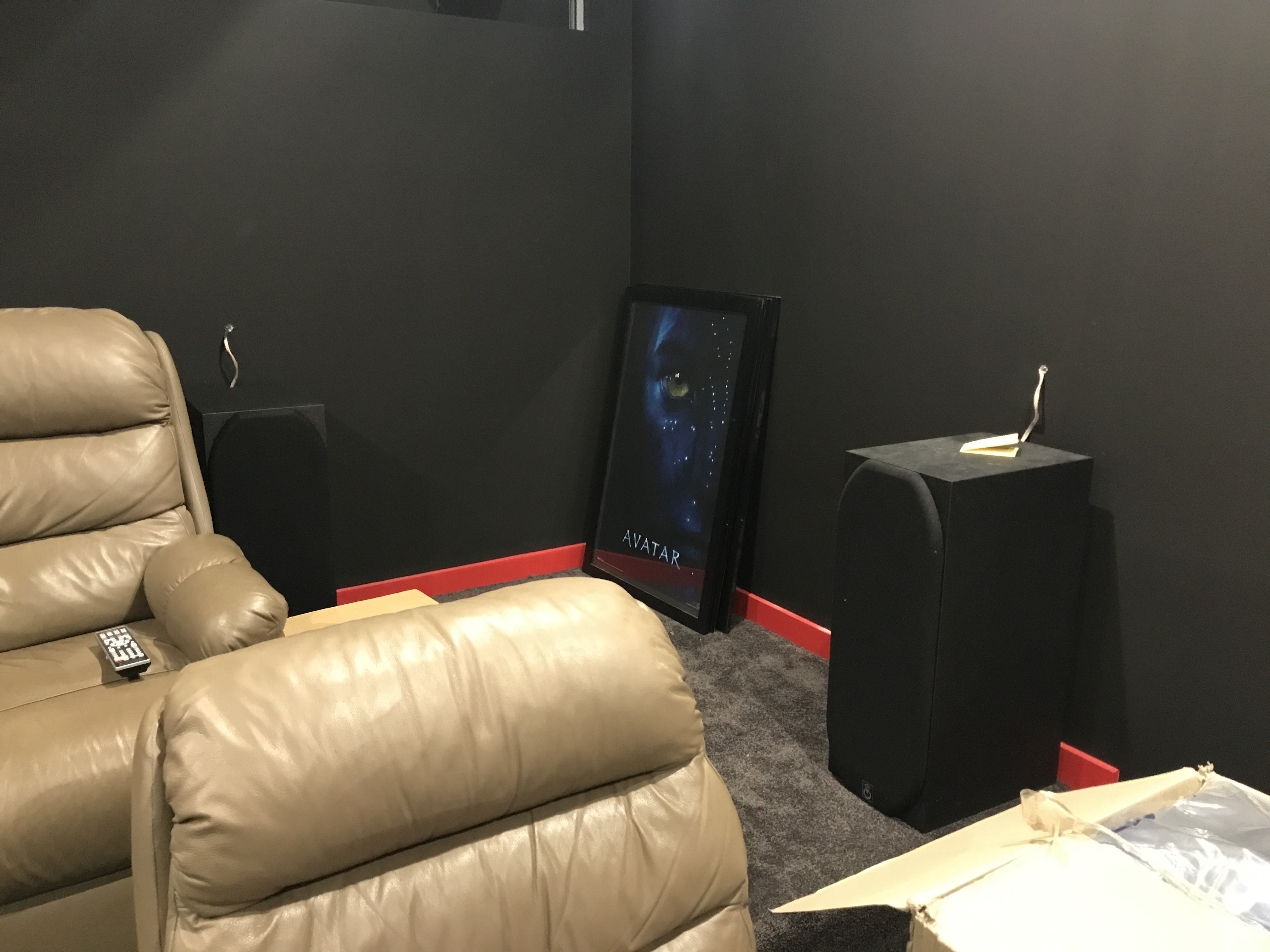

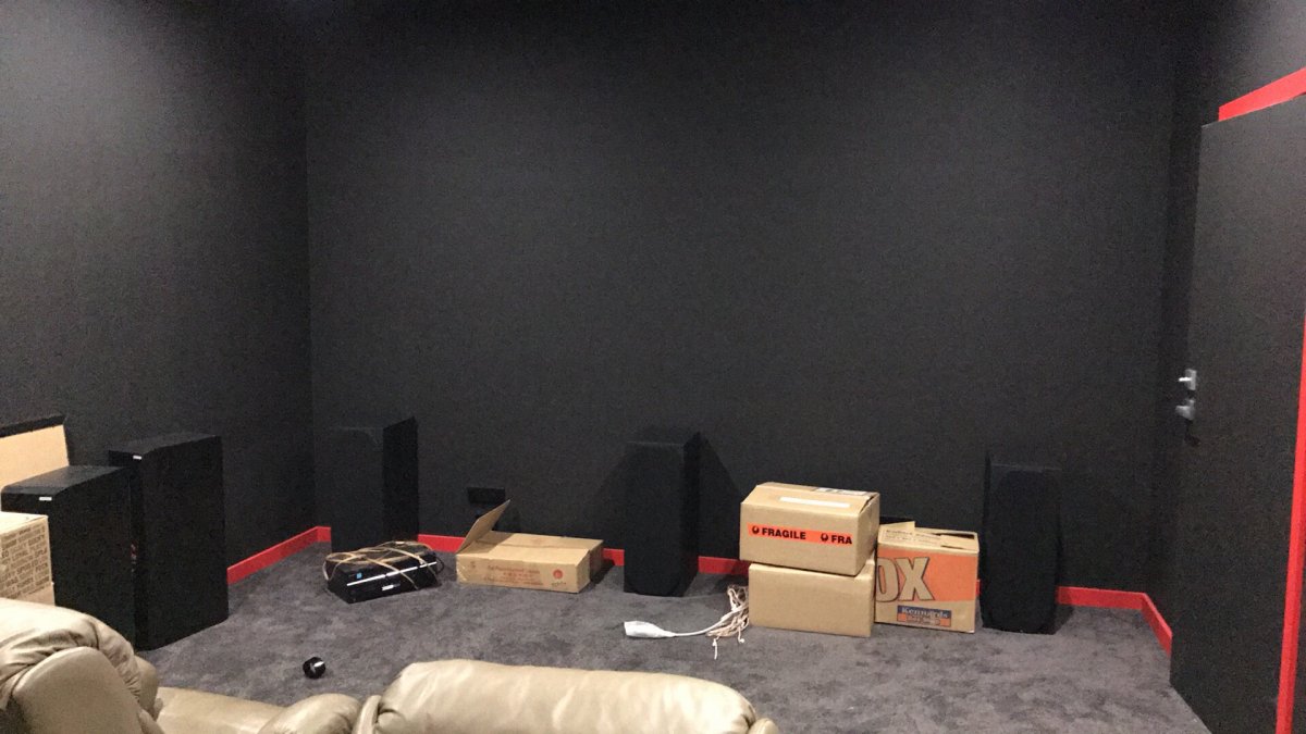

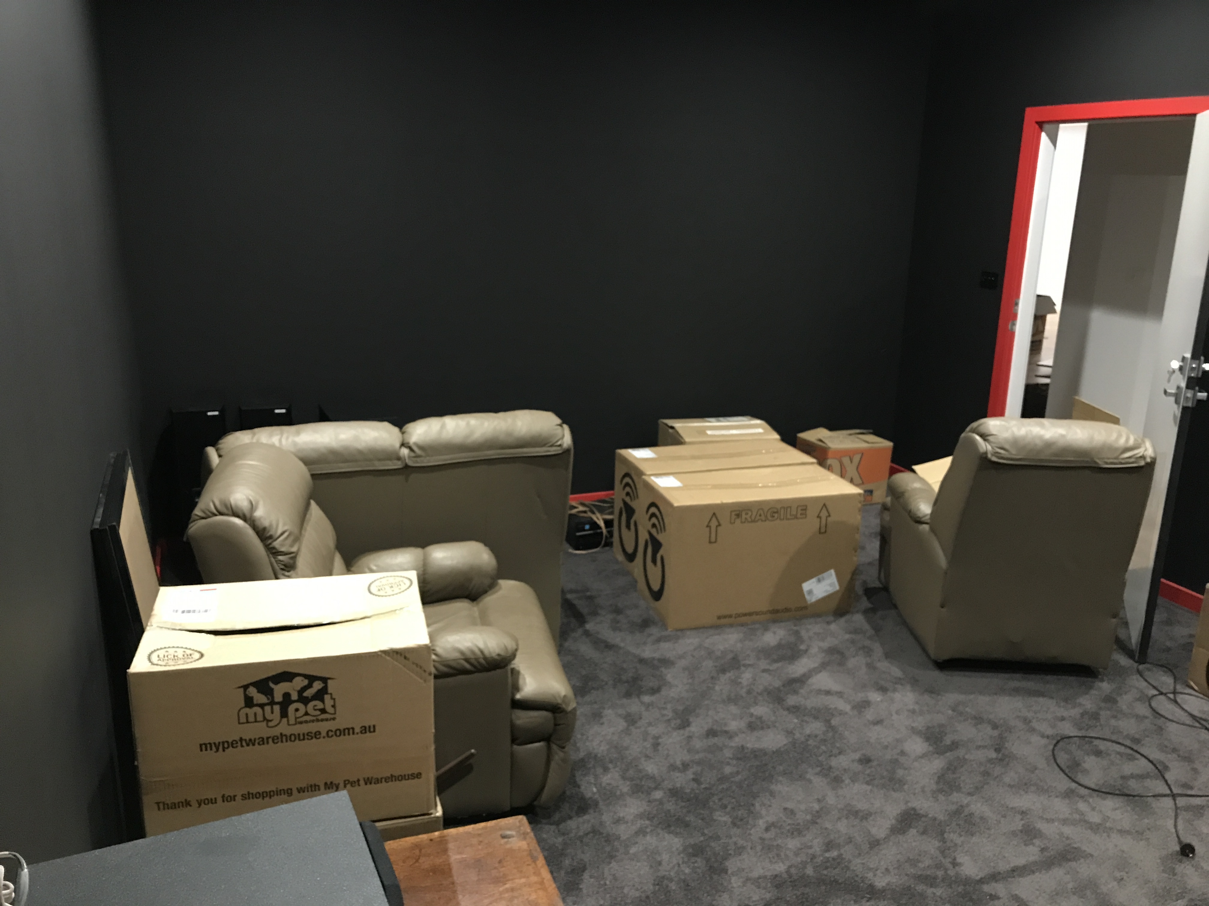

Moving in day today. I'm pretty buggered since we moved ourselves instead of using a remivalist.
But I got some progress on the room for you to see :) it's all still a mess but coming along.

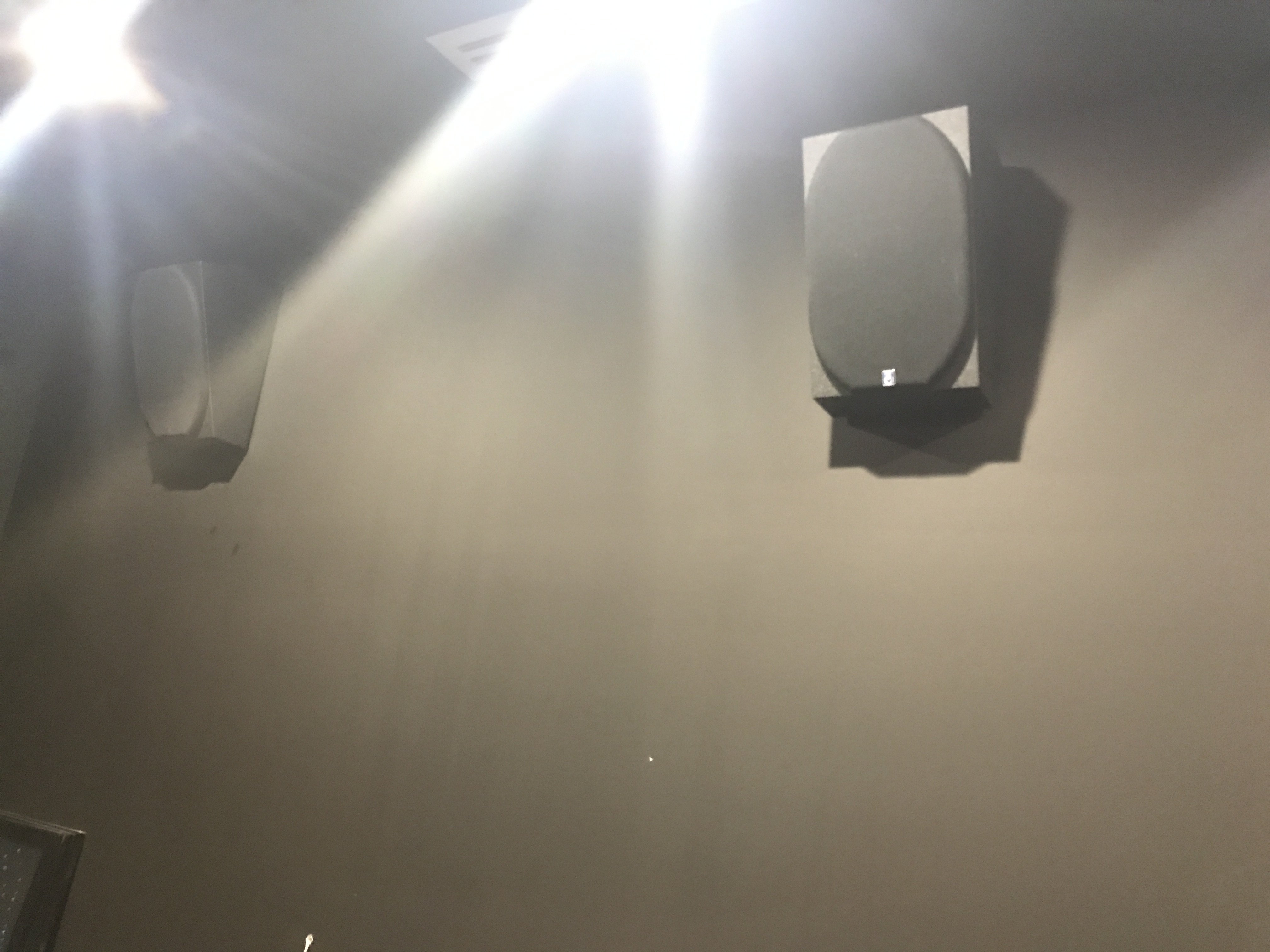

Need to work out the best height and method for lifting my two back and surround channels. Probably just some solid MDF sandwiched "stands" for them to sit on?

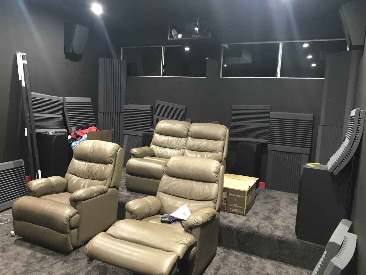

Actually those seats are all from my old setup in my previous house with theatre room. The recliners are great but the two seater isn't the best. Sinks in the middle.
In answer to your question, yes I will be placing a table between the two front seats. That is until I end up replacing all the seats with better, more cinema-esque seating. I'd like to run two rows of three black seats with red trim to match the decor. Or even red with black trim. Don't want to get anything too expensive, probably max. budget would be $6k for all six.
I have finally moved the sub and scope screen into the room. Will unbox over the next few days. The screen in the box only fits in the room if its laid diagonally as it's about 3cm too wide for the room hahah. Unboxed I'm sure it will be fine however.
I have also removed all the boxes and foam from inside the PSA boxes. There was tons! Thankfully gave both the boxes and the foam away today so that cleared up some space.
Still can't test the system out as I have no AV processor still... That should be rectified within the next week or so!
More pics and updates soon! Can't wait to finally hang the screen and fire up the projector.

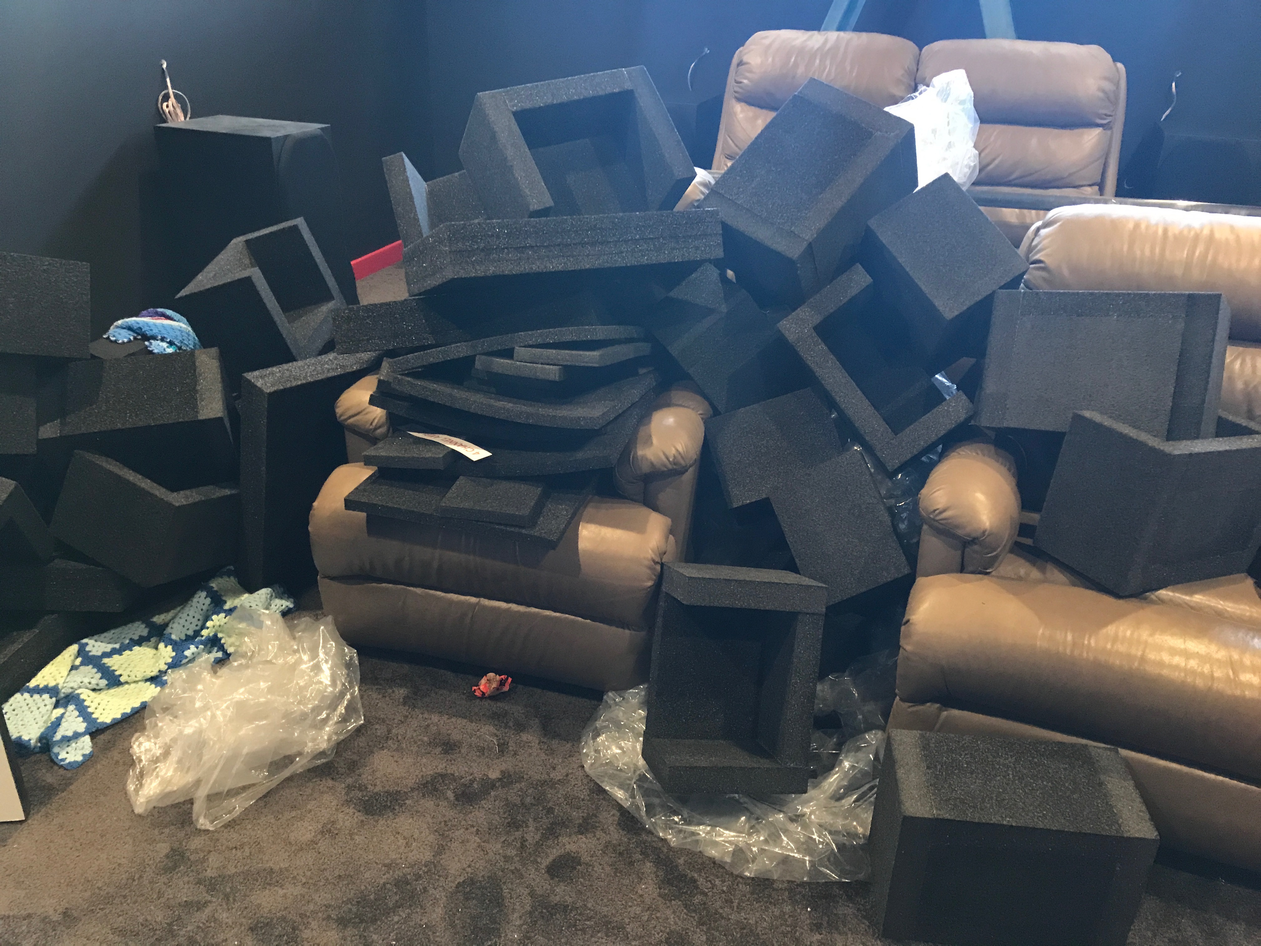

Oh, here's a funny pic I took after unboxing all my PSA speakers and being left with all the foam! (which I gave away).
That's one crazy pic! I feel so "un-green".

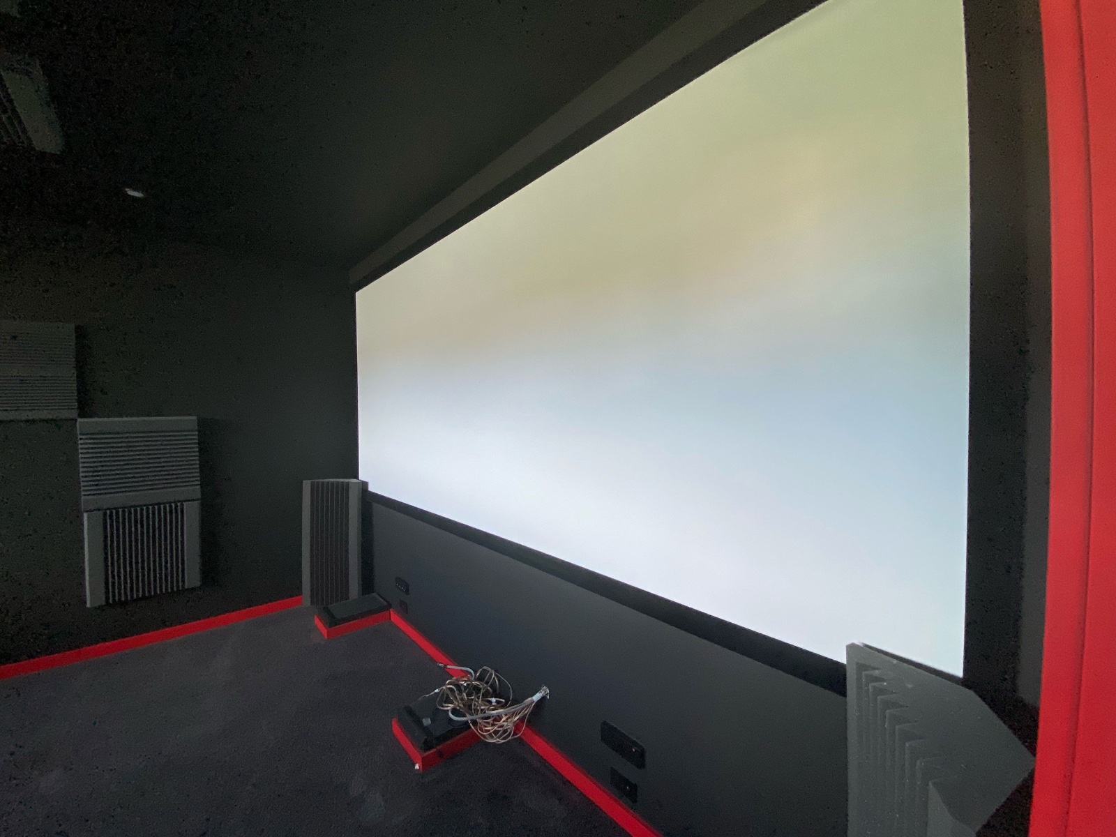

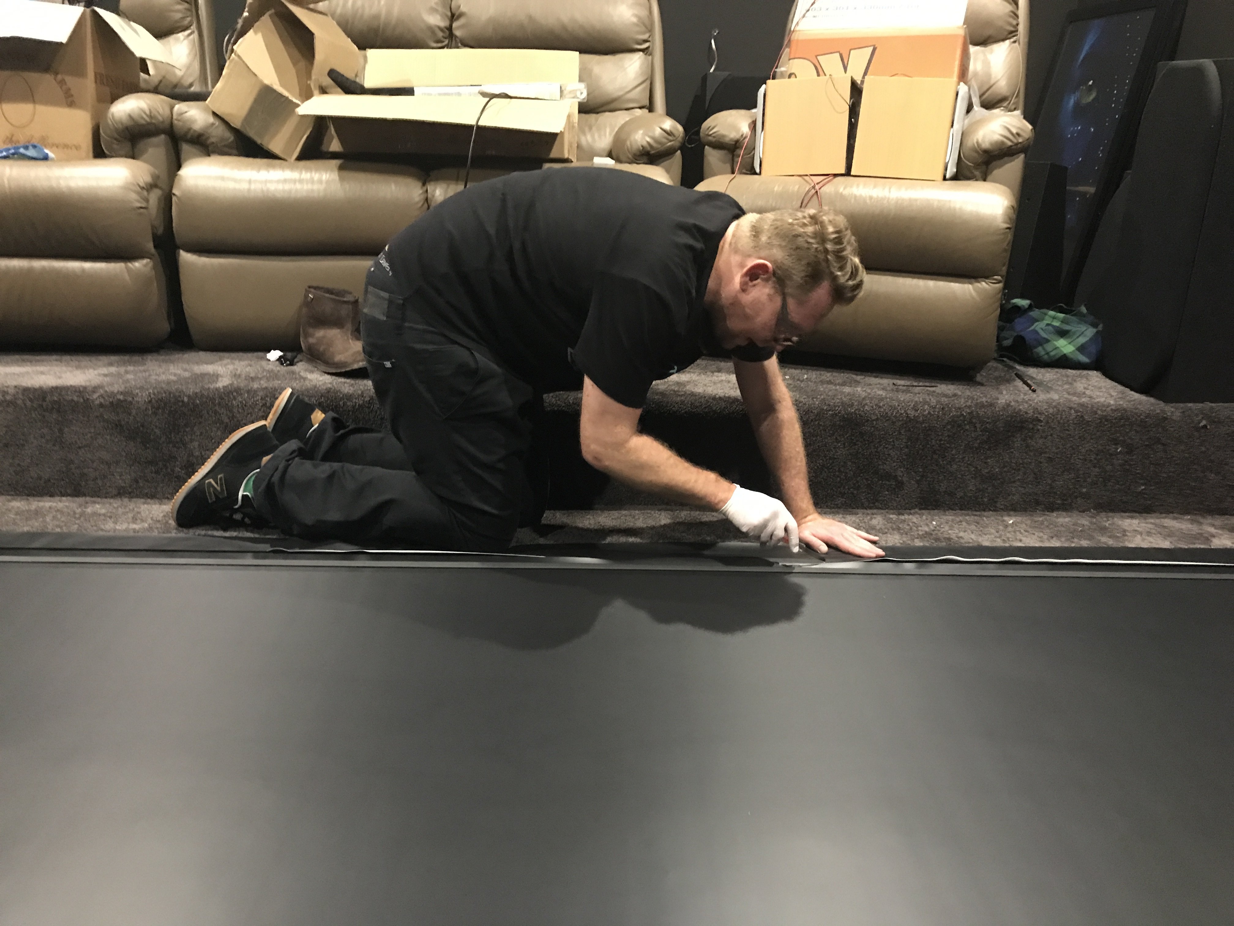

Got the screen up!! My mate and I had some fun over the weekend. The 165" screen is so big that my mate and I were stuck on either end of the room once we started framing it up!
thabkfully it all went smoothly and it looks phenomenal.
I still need to lift my projector up a little to compensate for the extra height required by the lens and motor system for anamorphic. Hoping to do that tonight with some blocks of wood.
Heres some more pics...

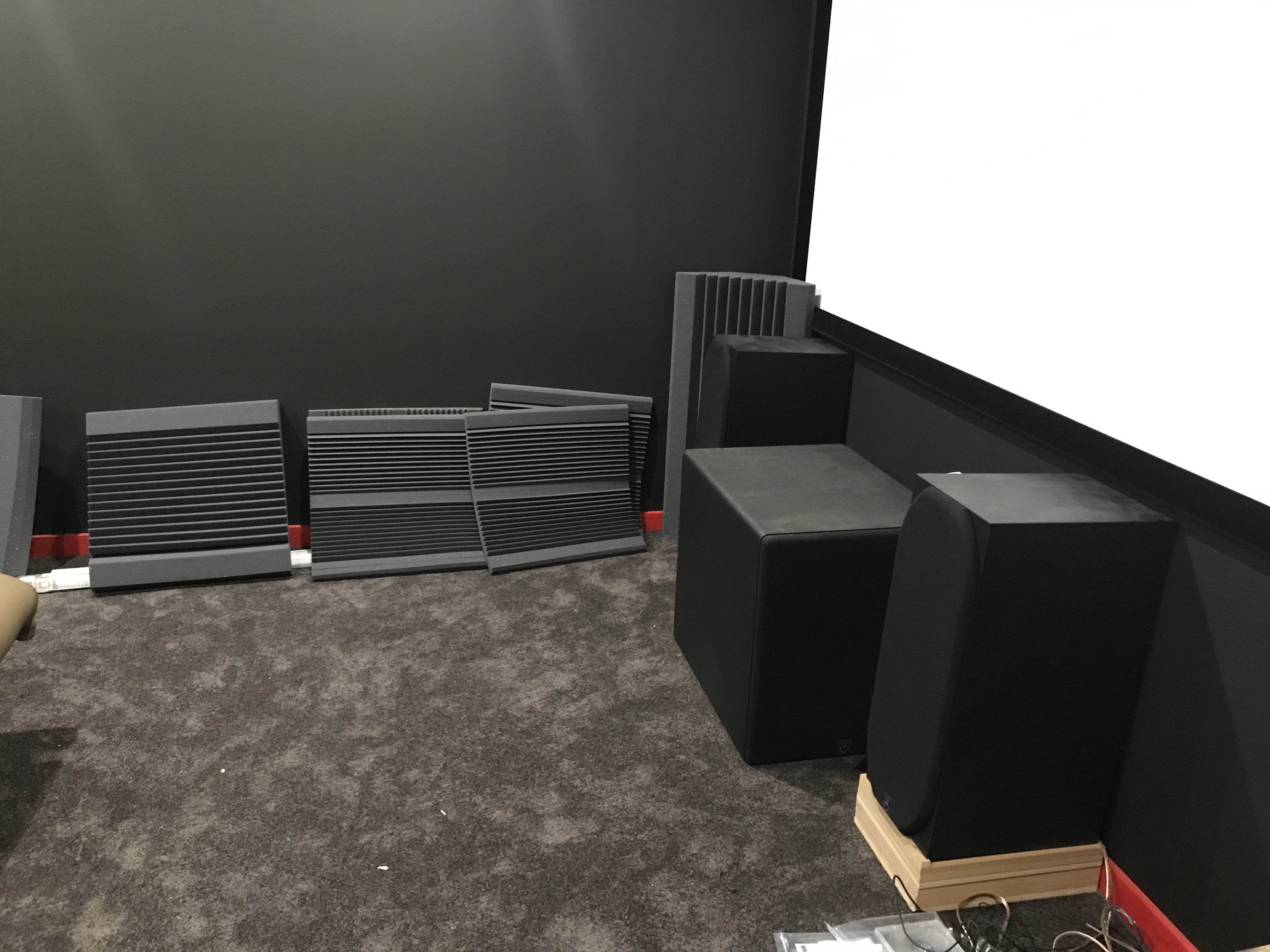

Am am yet to actually place the tiles in their final position on the walls, however I imagine it will be done before the week is out.
I have 12 x wideband diffusers, 10 x mid-high band diffusers and 6 x bass traps. Should have a huge impact on the room.

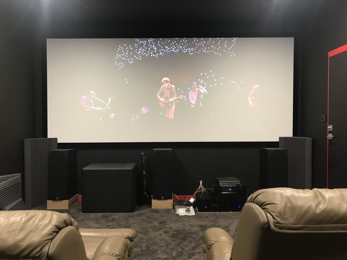

as you can see I have also propped my front three mains up on DIY stands. Not finished yet but they are sandwiched MDF which will be sanded and painted black. Then I will skirt around them with red skirt to match the room. Then I will do similar under the surrounds although those four will need to be about triple the height or more.
Early impressions of the 8802a are super positive. Audyssey did a great job in my room although I have some questions which I will get to.

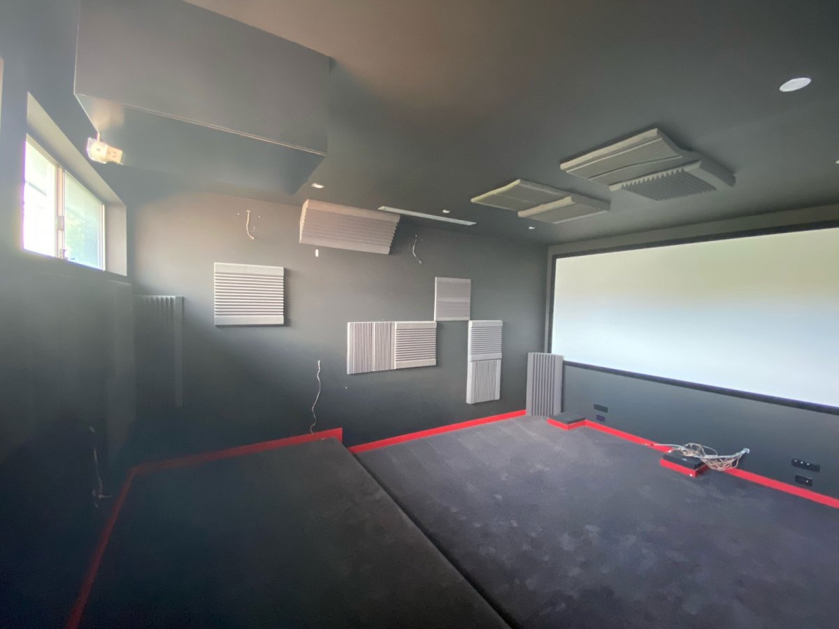

It is my goal to fully complete this room, and make it feel 'finished'. Currently my acoustic tiles look like a patchwork quilt stapled to the walls, which sounded fantastic, but looked average at best. So my goal is to cover the walls with panels that cover up the acoustic panels with black/grey cloth that is transparent enough for the sound to travel through so that the acoustic panels can still do their jobs (advice on which would be most welcomed). I'm considering some wood paneling with LED lighting to sit along the bottom 20% of the walls to create some visual accents.
One thing I DID consider, was building a false wall at the front and aligning the screen with the front baffle of the speakers, OR, potentially replacing the screen with an acoustically transparent one and raising the speakers up to sit behind it as many of you do. This would allow me to also sit the sub up higher and get a 2nd to match it behind the screen. To achieve this and retain the screen size may be tricky. I'd have to move the projector right to the back of the room.

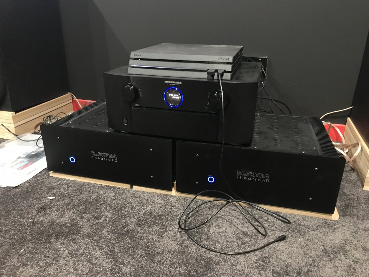

And so it has begun. My Marantz 8805 processor, motorised lens slide, and lens have all arrived! Awaiting arrival of my two 7ch Elektra amps next.

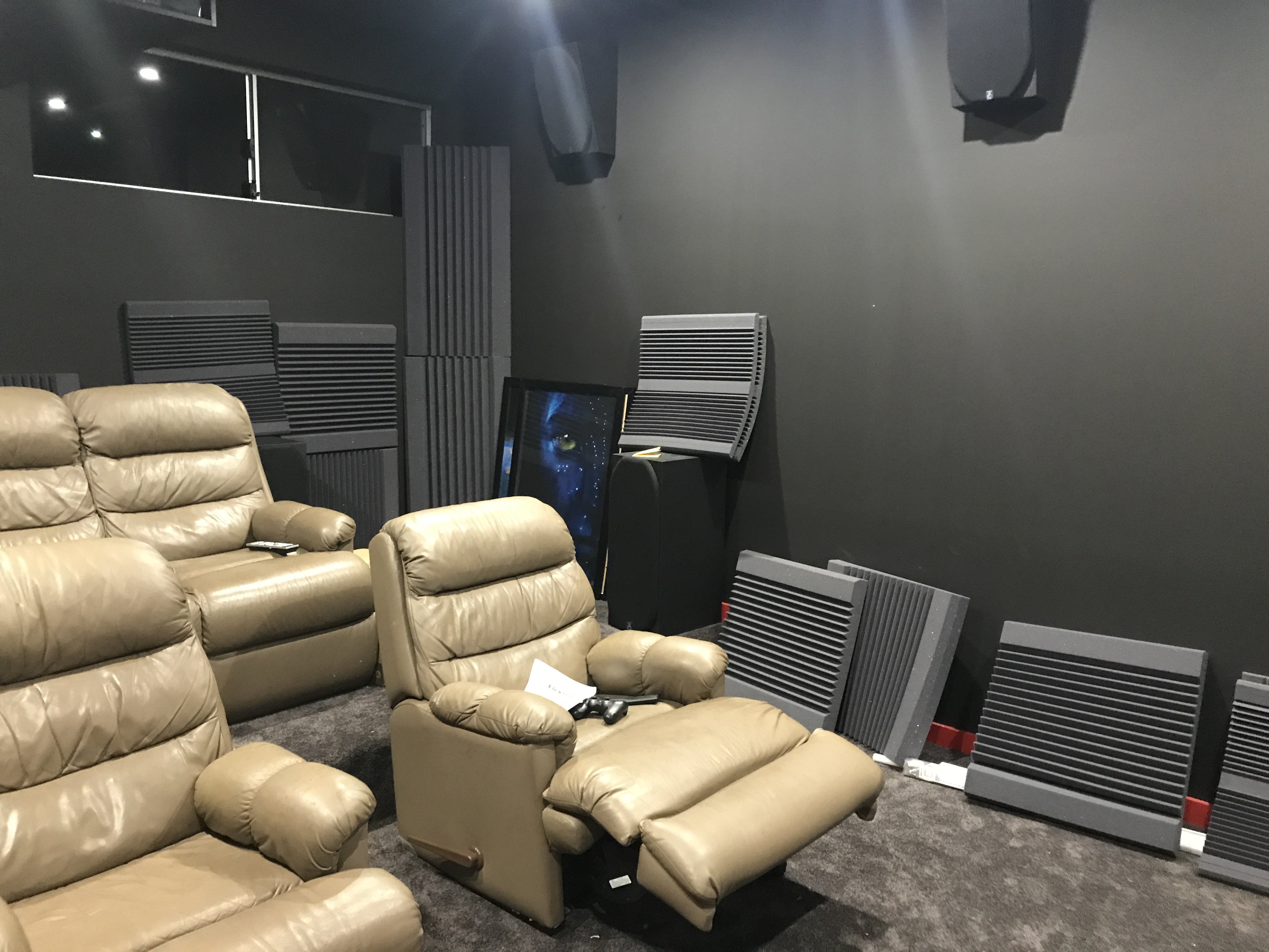

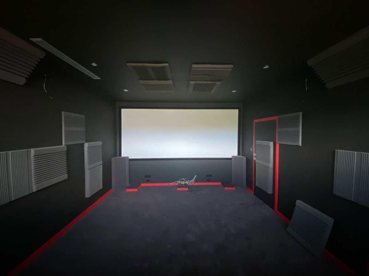

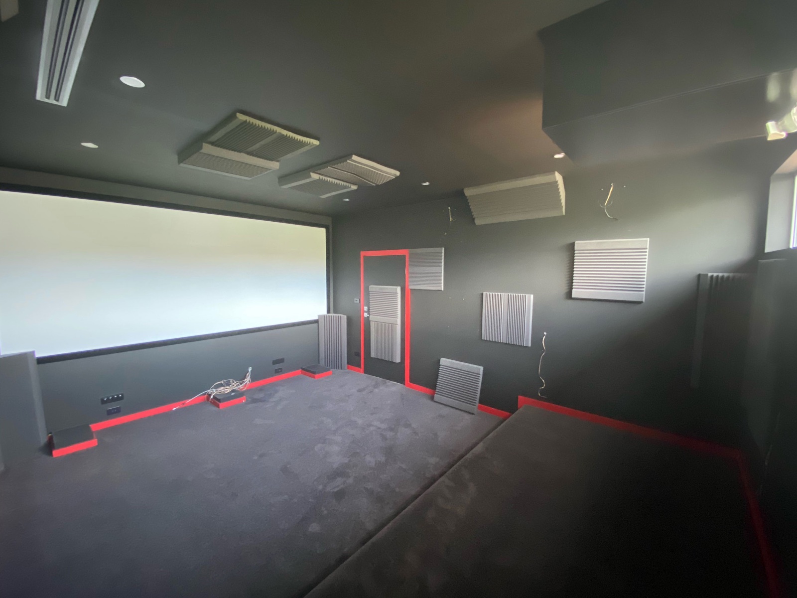

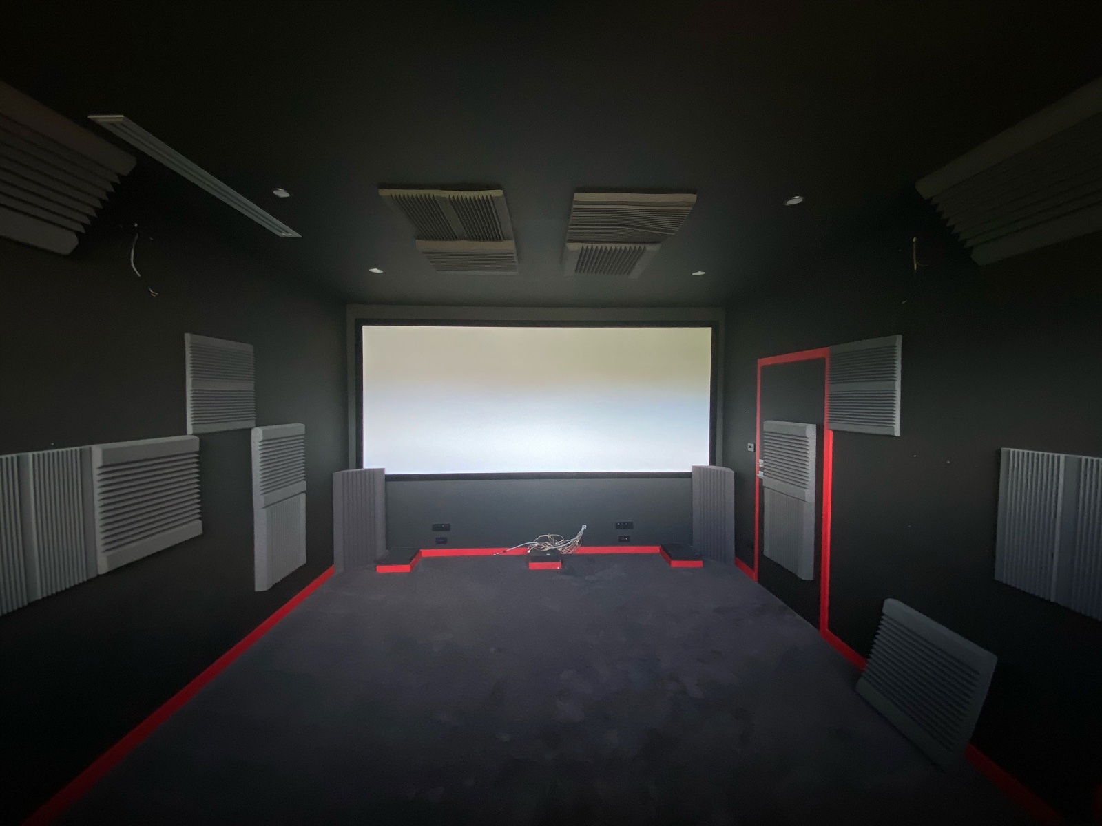

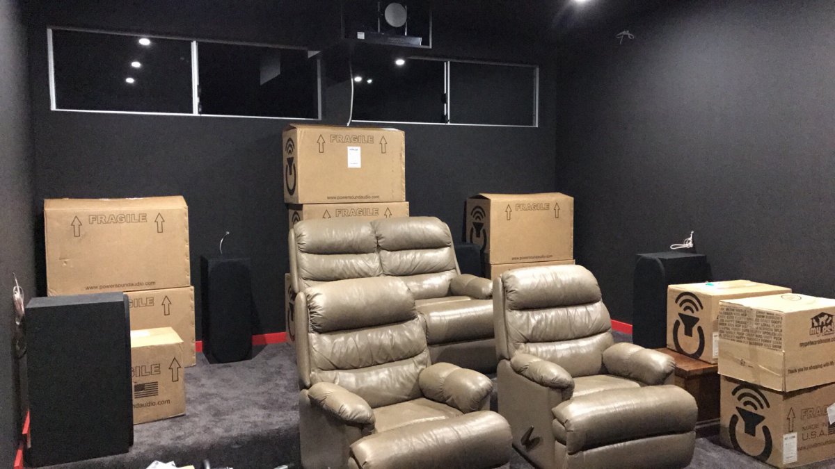

And so the time has come. We're moving back in this weekend and so here's some photos of the state of the room. Screen and acoustic panels still in place.
The acoustic panels made the room sound better, and I'm very happy with the overall acoustics, but absolutely not happy with aesthetics. I'll be building some floor to ceiling panels that contain these acoustic tiles inside them, with some sort of material covering that still allows the acoustic tiles to achieve their goal - looking for advice on that actually! Then Im going to build the columns into the wall to hold the side and rear surrounds.
IMG_4477.thumb.jpg.5634806d446bc8bfdb84aad193fd9021.jpgIMG_4479.thumb.jpg.3b3ea6506f0e97bb5e830f4c28df50fb.jpgIMG_4474.thumb.jpg.588afc5b6fccaa4f6049fad8be41c919.jpg
Great progress, I'm also interested in seeing how you go containing those acoustic tiles.
I was actually wondering today if aluminium frames with fabric skins would be the answer? Can be printed or solid colours, not sure how they would go acoustically though.

Elektra amps should arrive in a week or so!
Nice work Scottie and I bet you can't wait to fire up the JVC N7 in there.  In regards to your acoustic foam tiles, you could consider framing them with timber (sides and back) then wrapping with black speaker grill cloth.  I'd also consider building a screen wall and putting your LCR speakers behind an acoustically transparent screen (if your budget and space allows!)  This will give your room a much neater appearance as your front speakers and acoustic treatments (e.g. bass traps) will also be hidden.
  • Author
Absolutely. That framing technique was what I was going to do. I may end up ordering some MORE tiles and making it look more uniform for now. Sound acoustics make some nice coloured panels in the same size so I might get some red ones to match the decor.
And YES, the plan IS to frame the front and build a false wall and fill it with my LCRs, sub, another sub when I get it, and lots of insulation. I’ll take that opportunity to lower the screen by about a foot.
My only concern is throw distance. I think I can only move the projector back about 25cm. And it’s currently at max zoom for its location. So I need to be careful. I may need a smaller screen ?
Also, be careful not to 'overtreat' your room with foam tiles - these things can really sap the life out of your speakers!  I made this mistake with my room and in the end I had to add thin balsa wood panels over some of the foam tiles (at my room's first reflection point) to get some 'life' back into the front soundstage.
