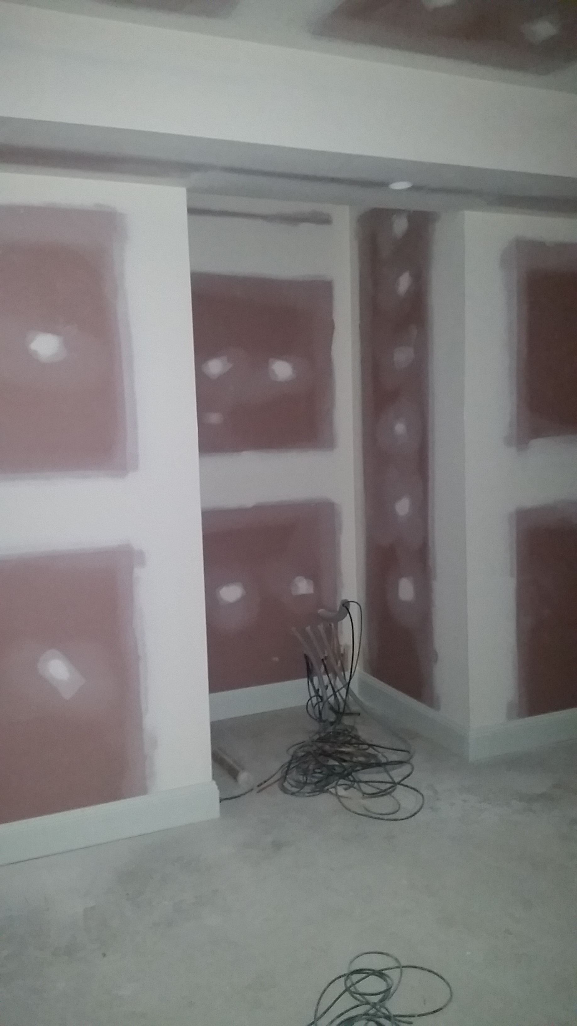

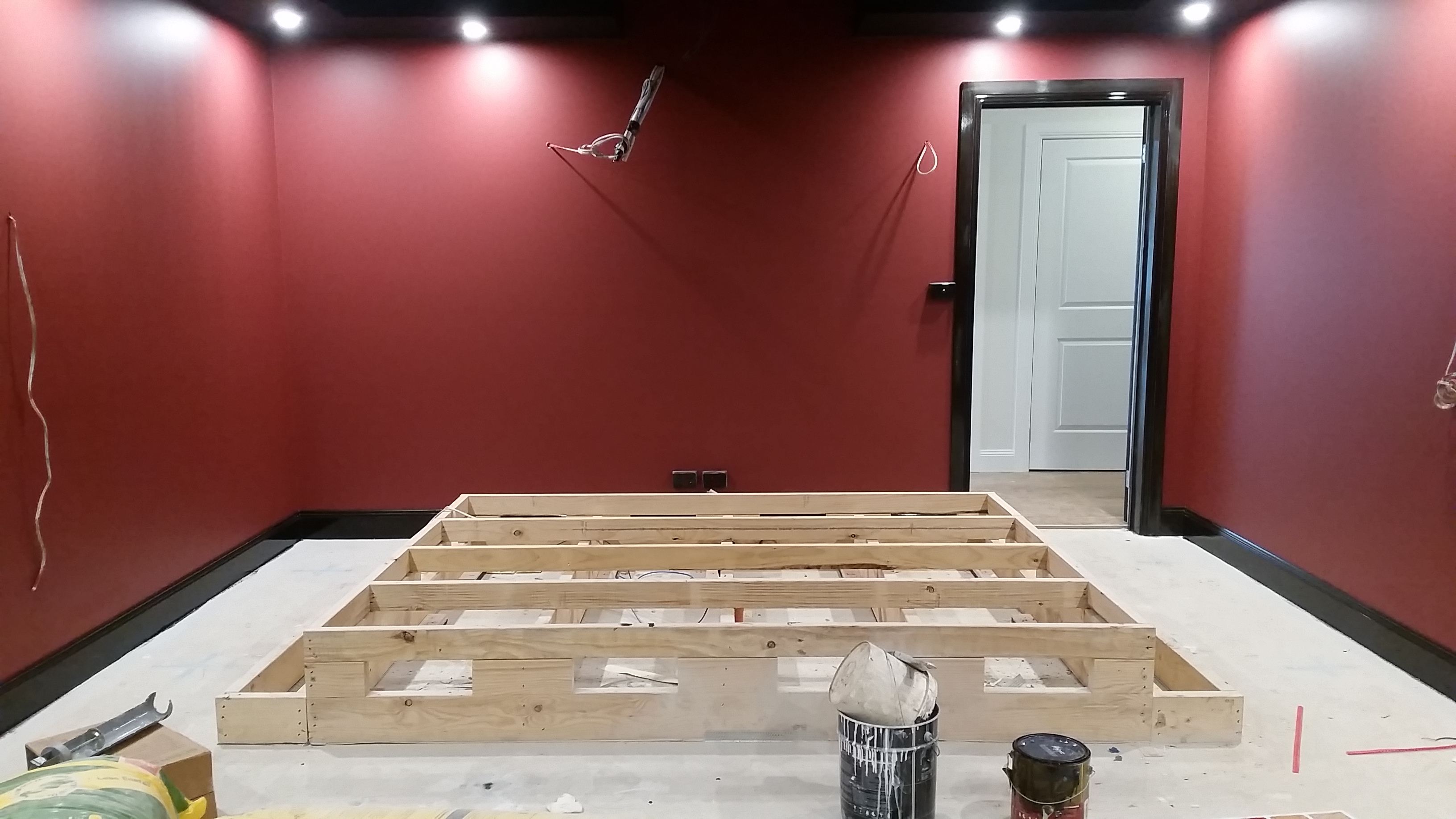

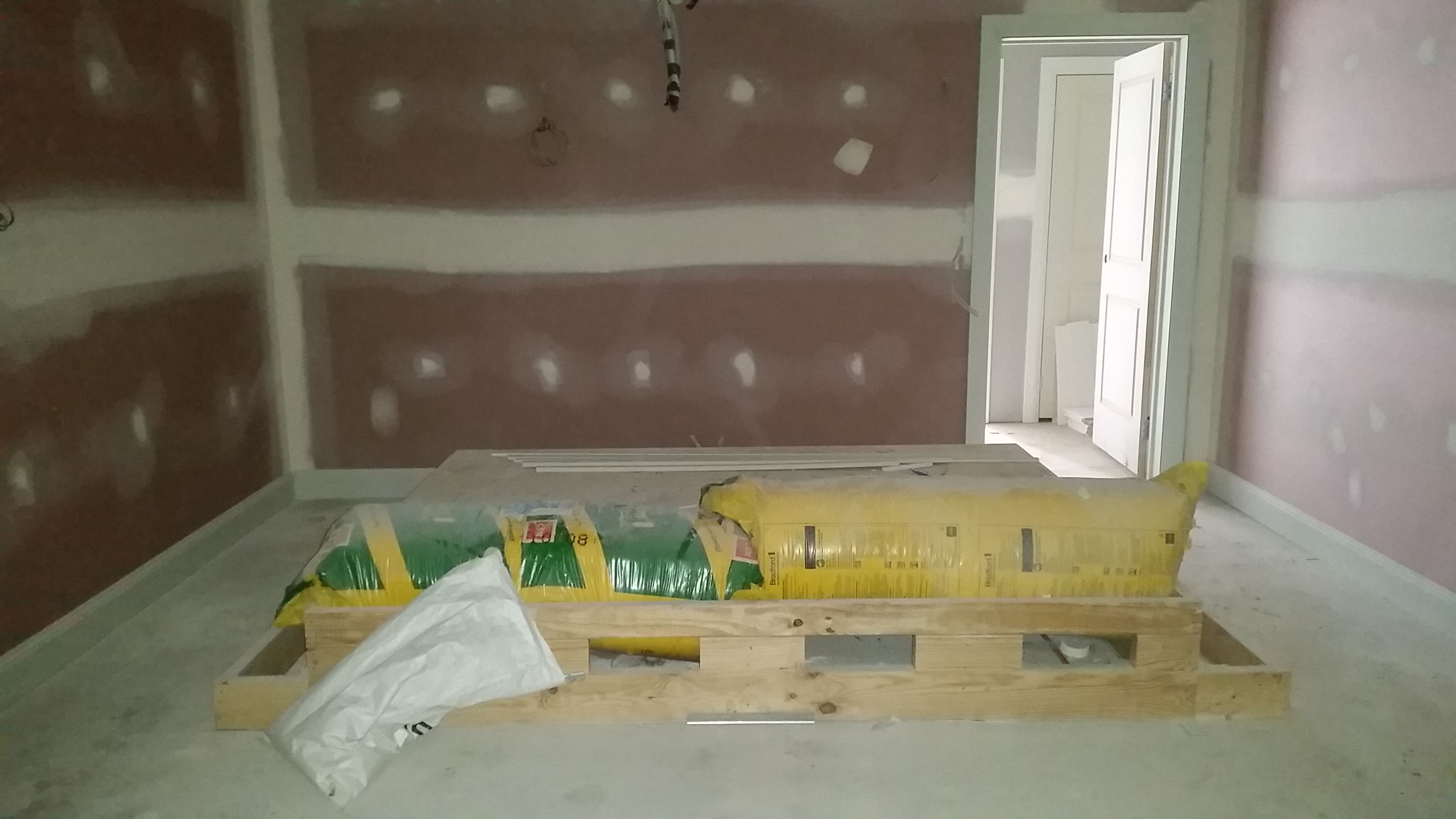

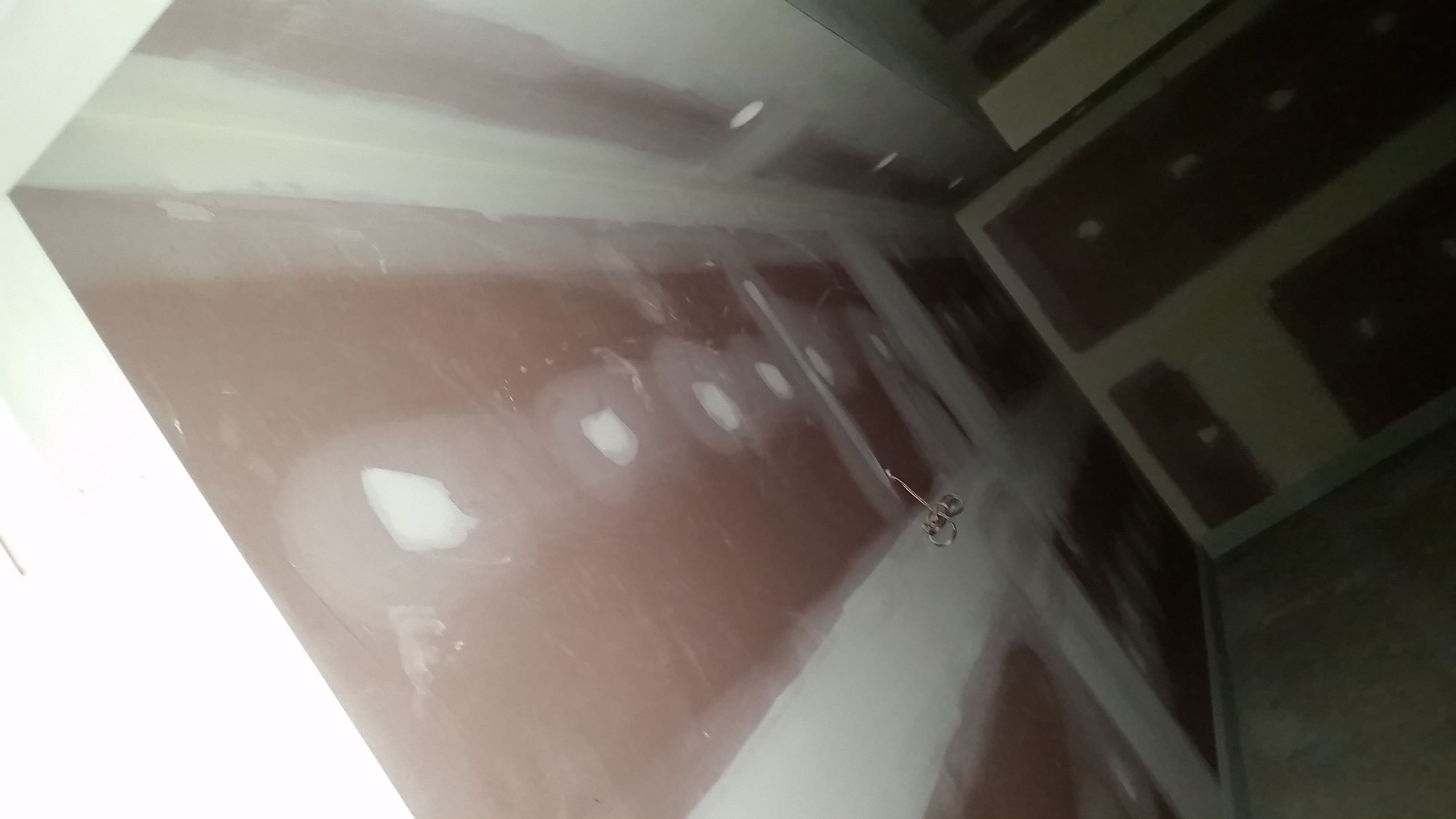

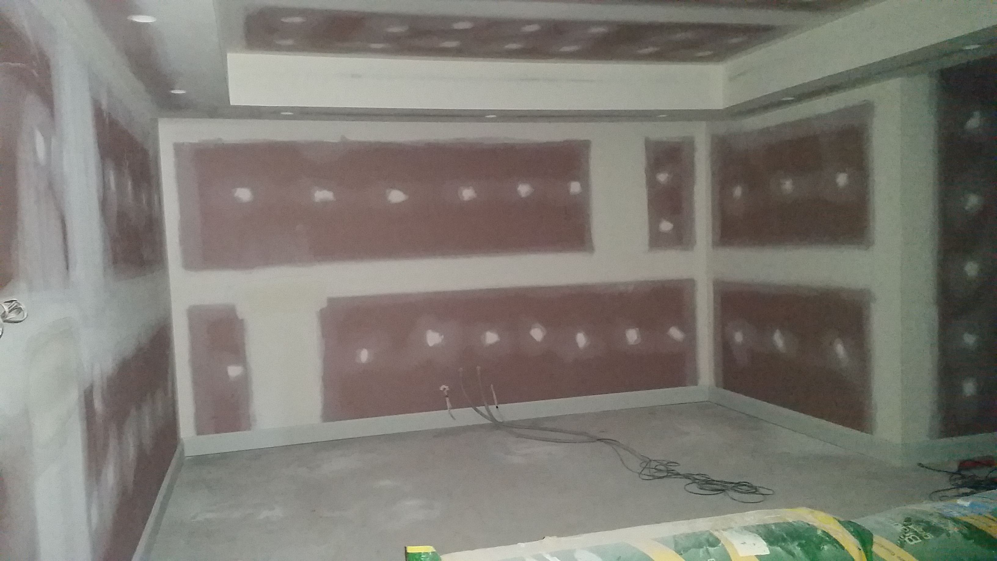

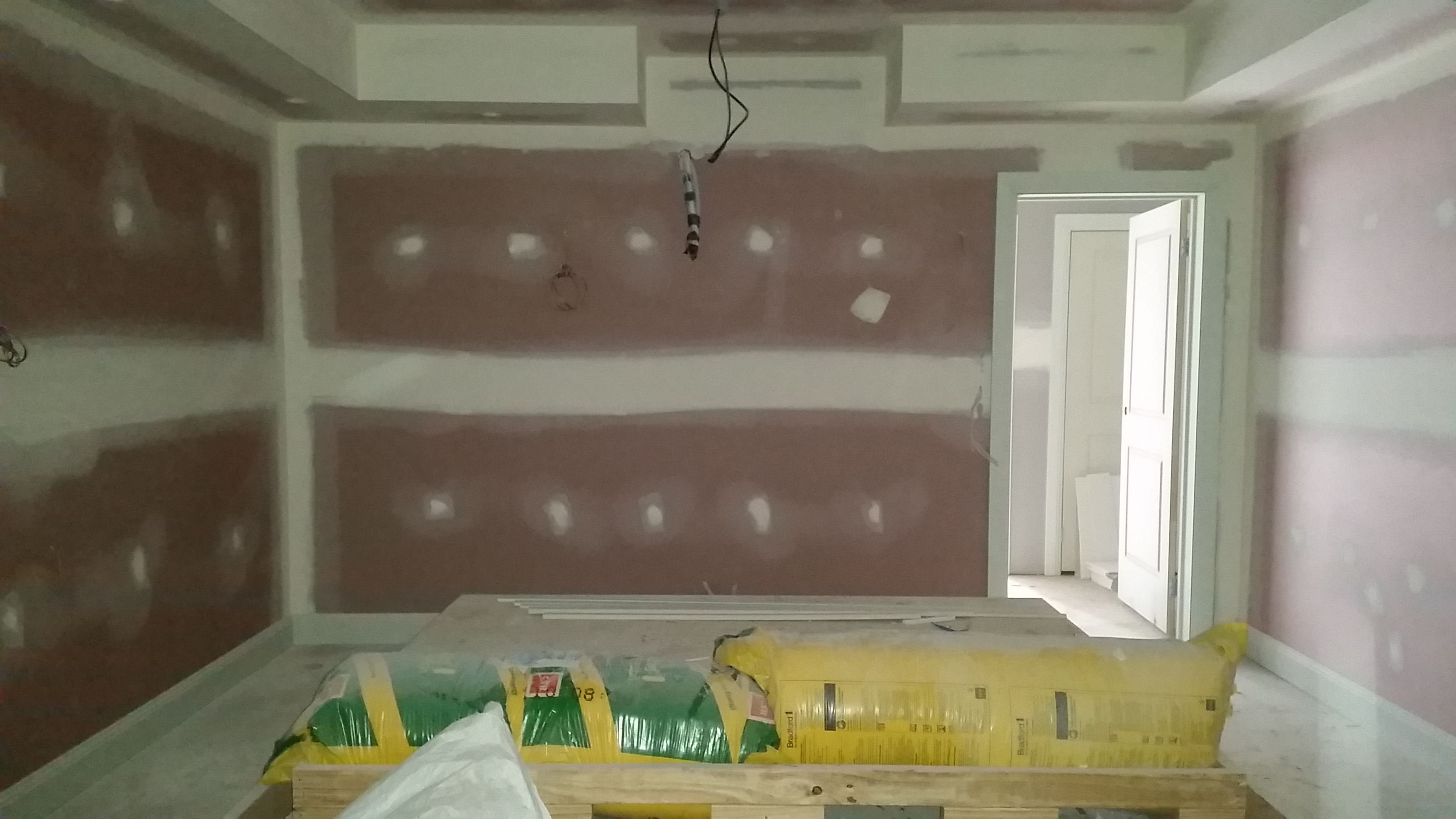

Drywall is all up!. I use Isomax resilient clips with channels with 19mm Plywood as first layer which doubles as a mounting substrate. Green glue was then applied onto 1st layer and 2nd layer was 16mm Fyrchek plasterboard. The wall is pretty damn stiff.
  • Author

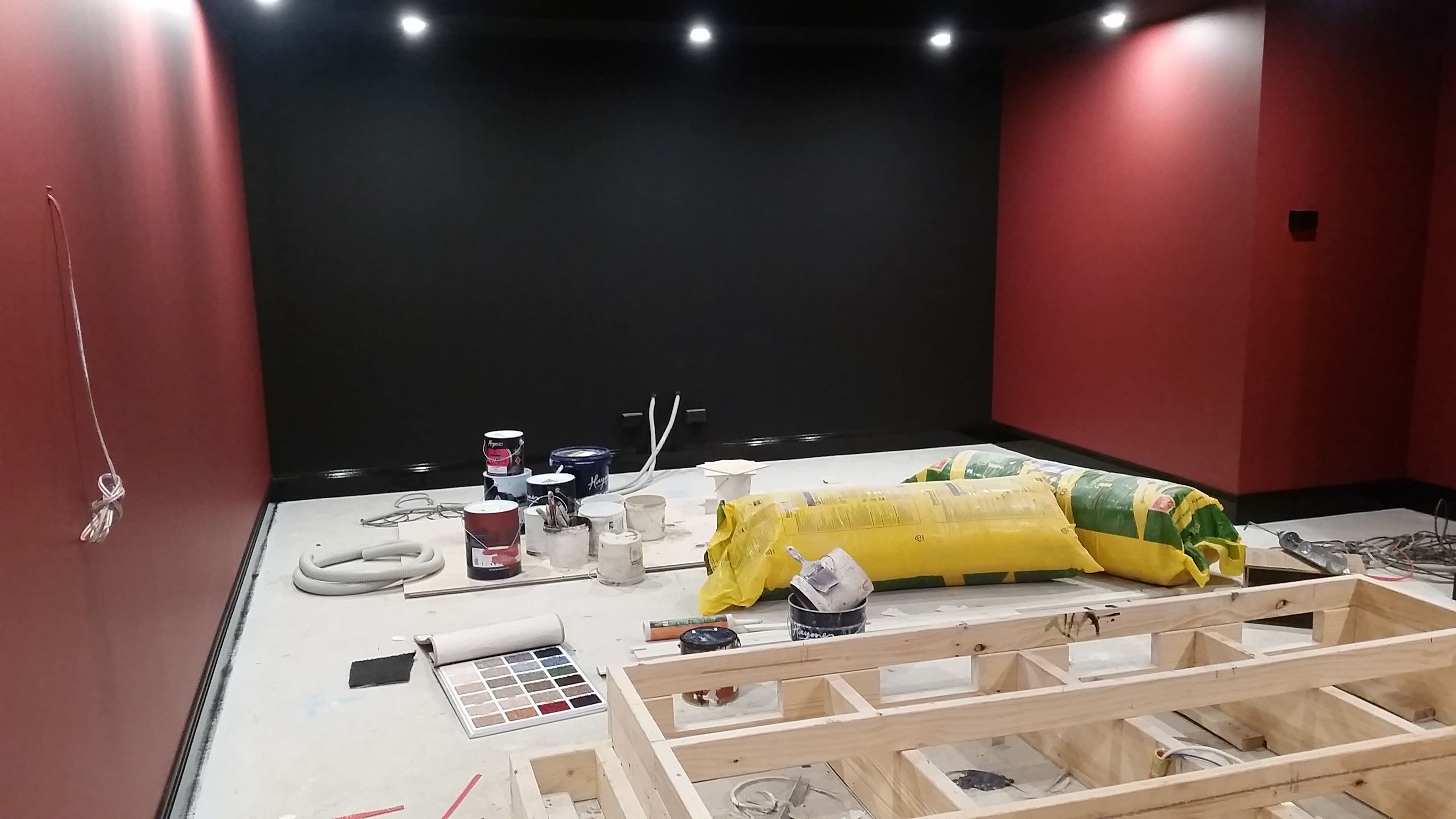

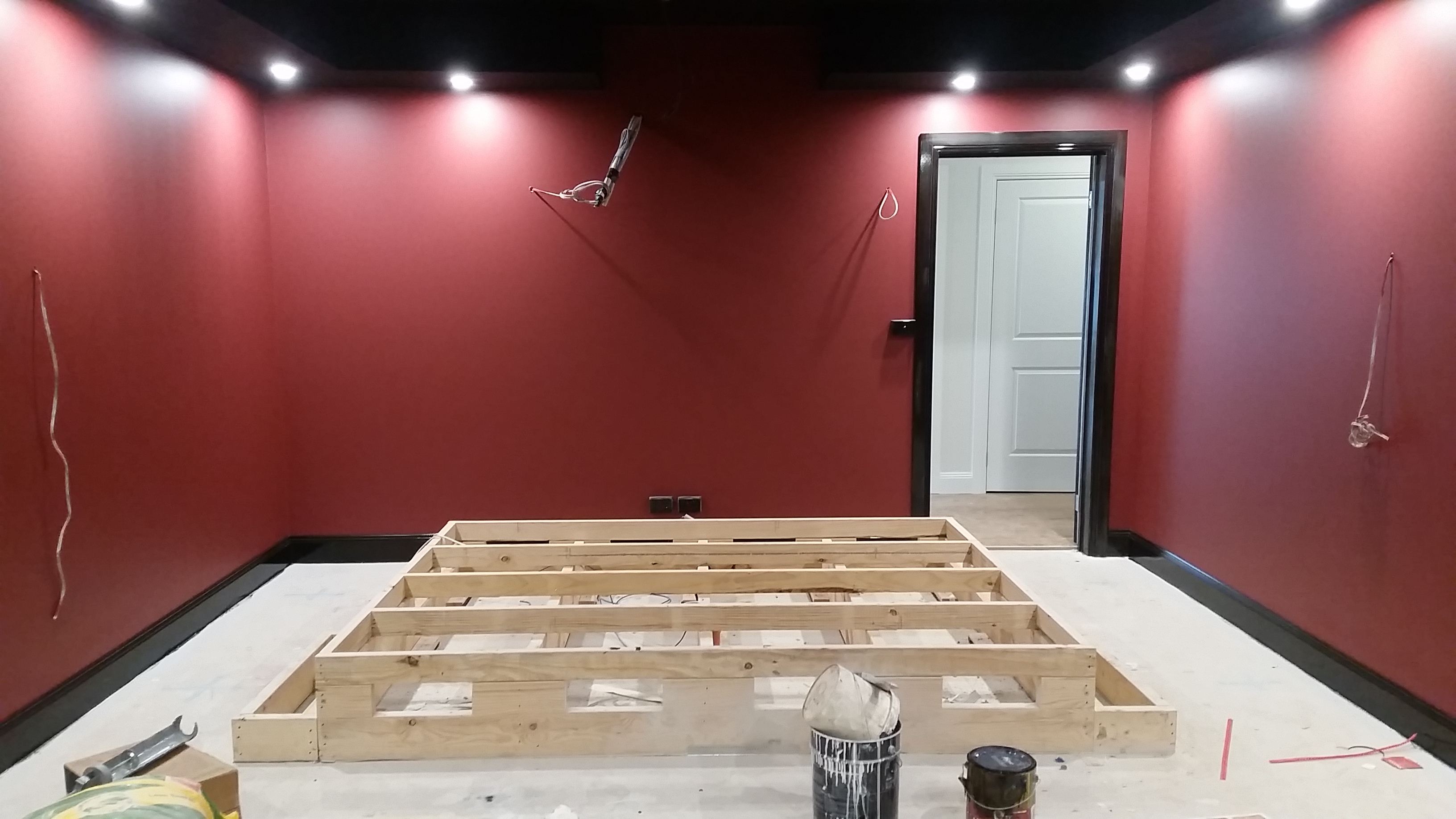

Painting and downlights installed.

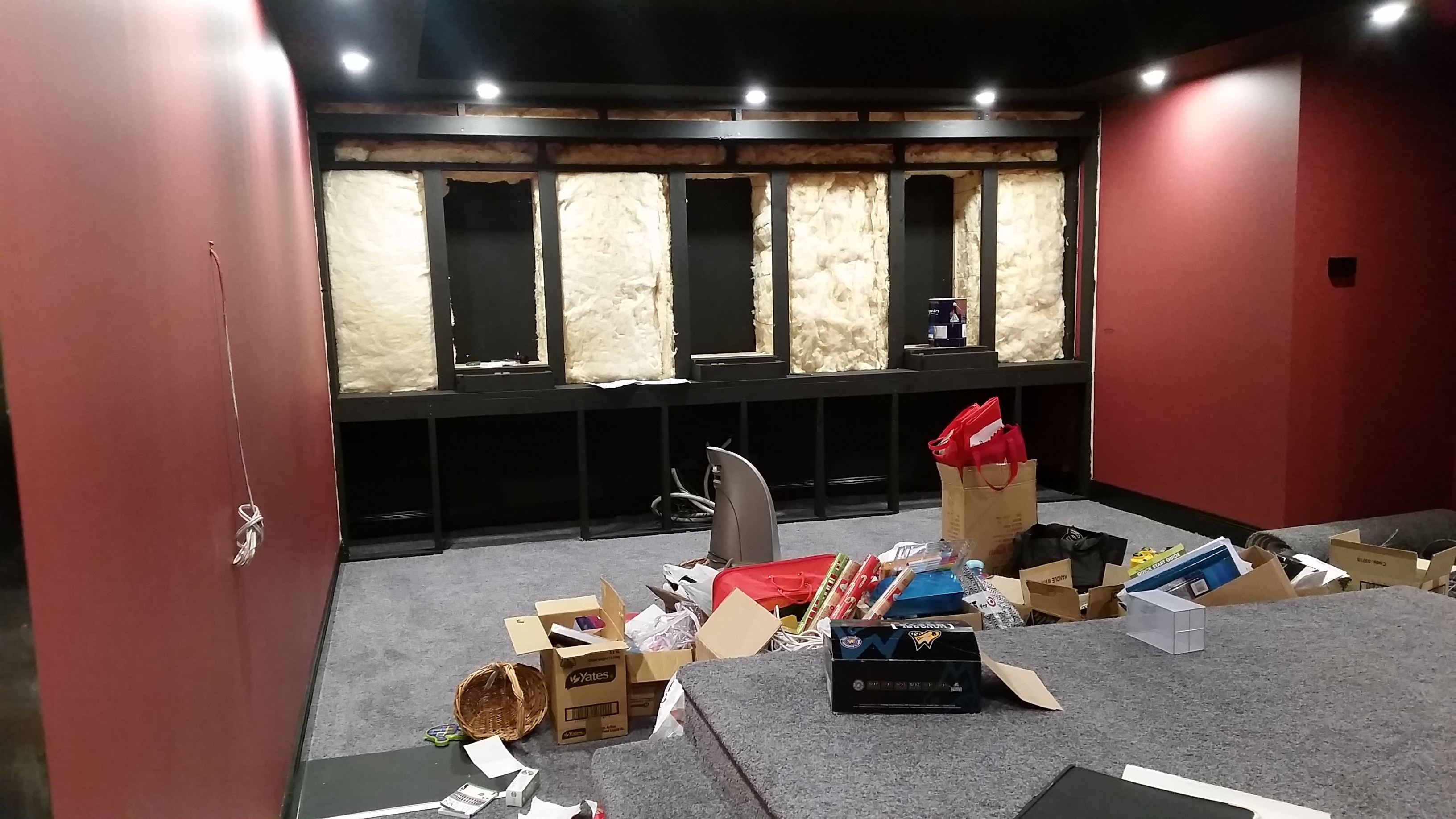

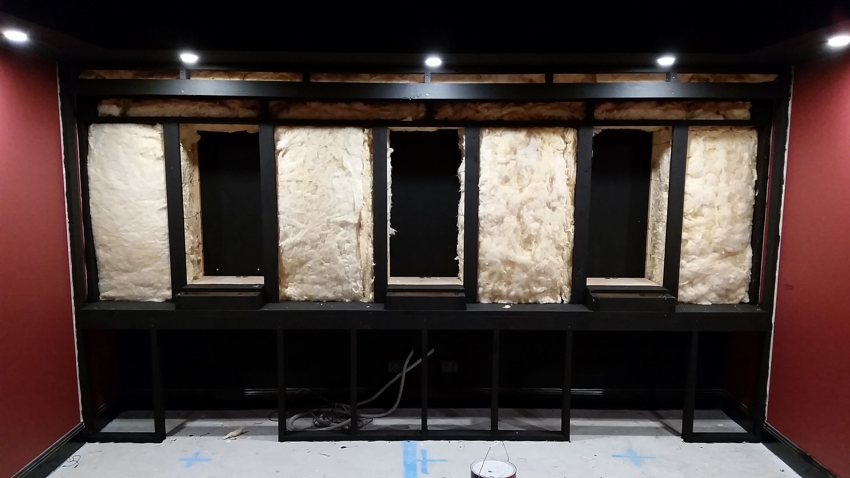

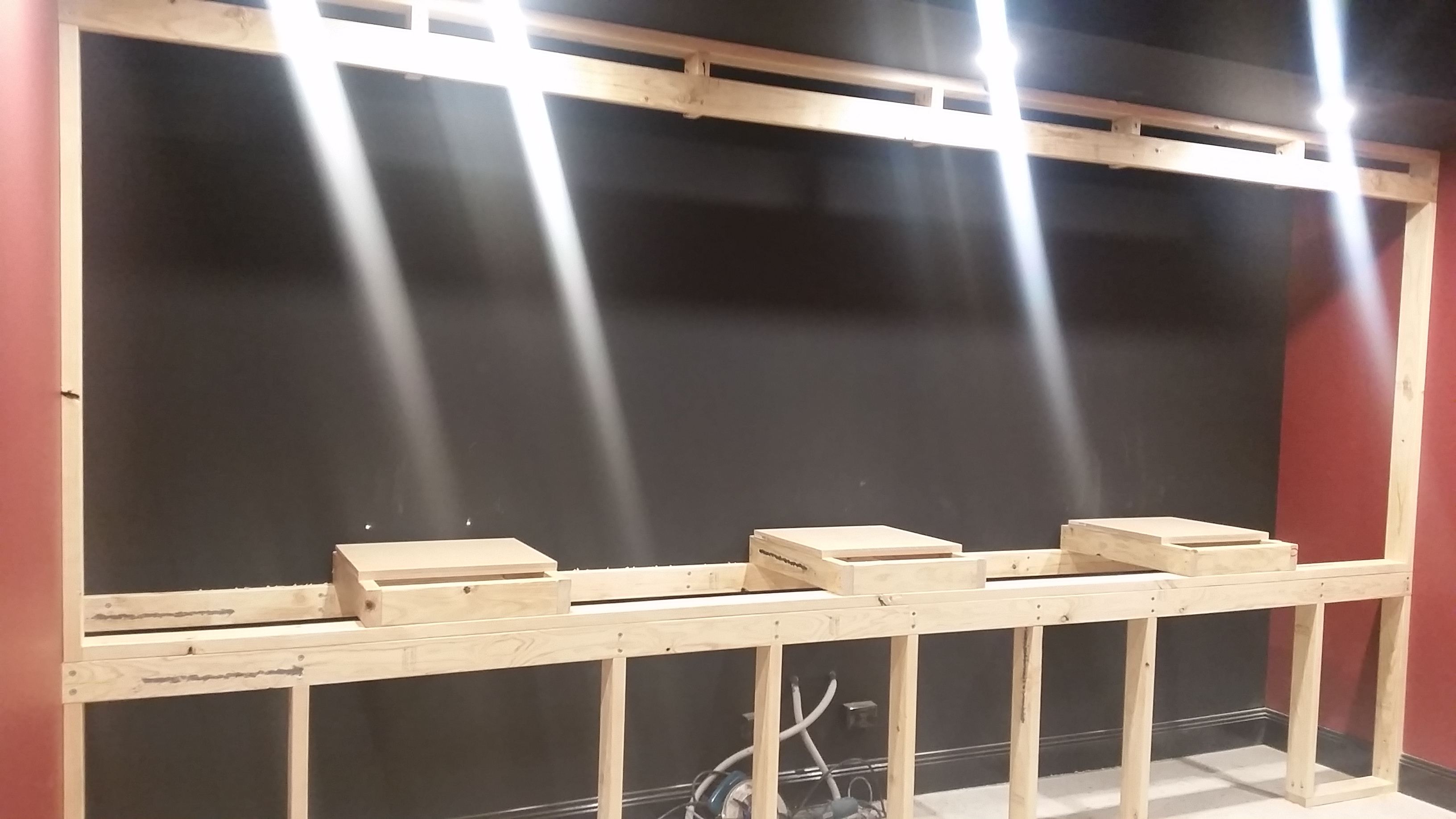

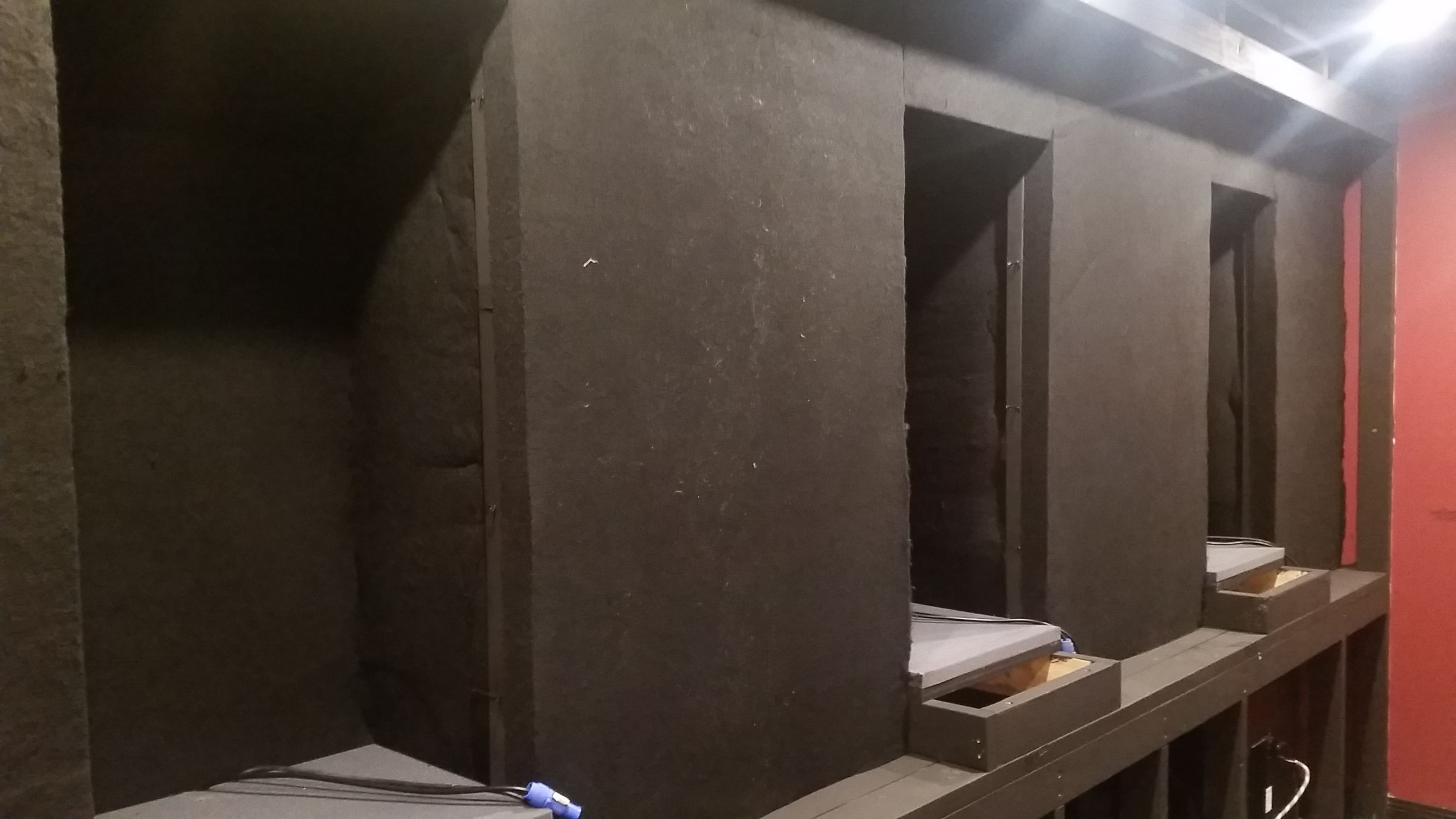

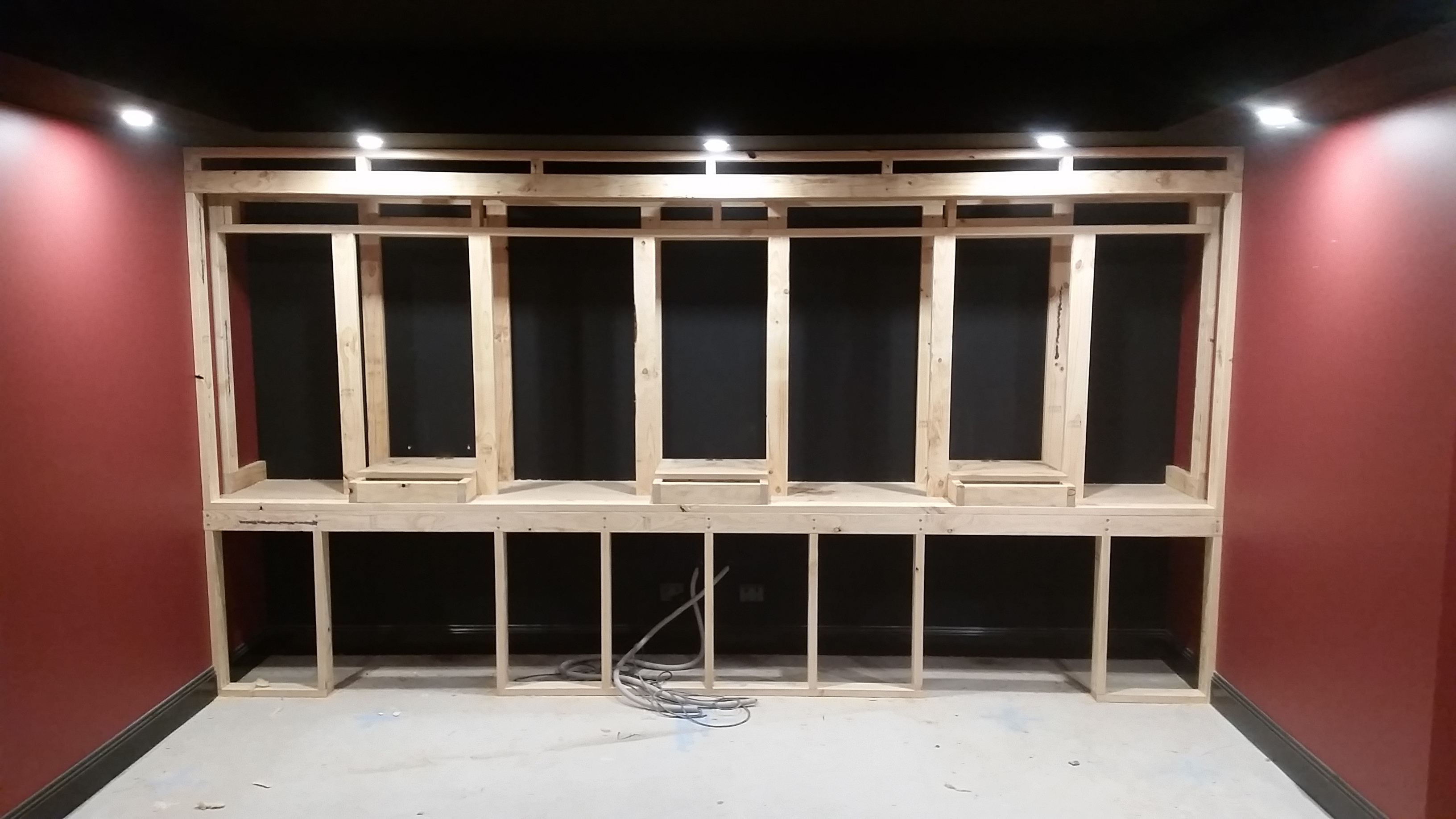

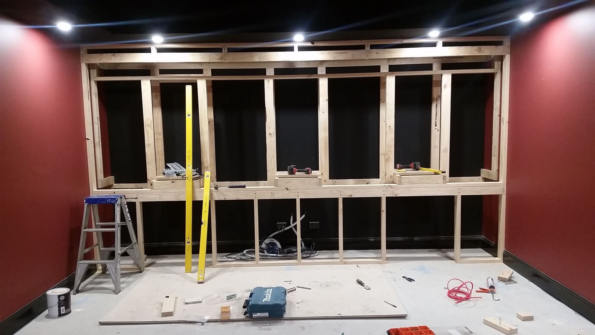

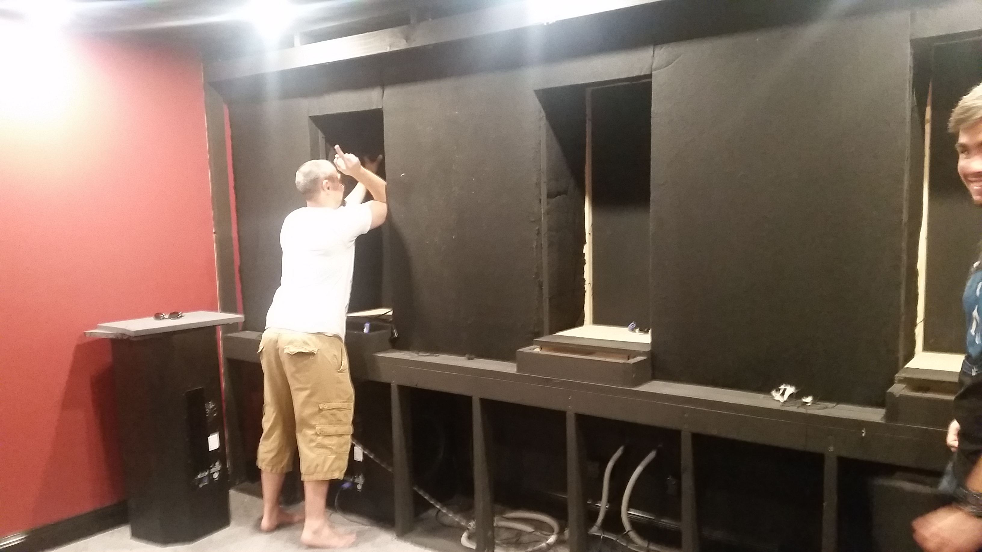

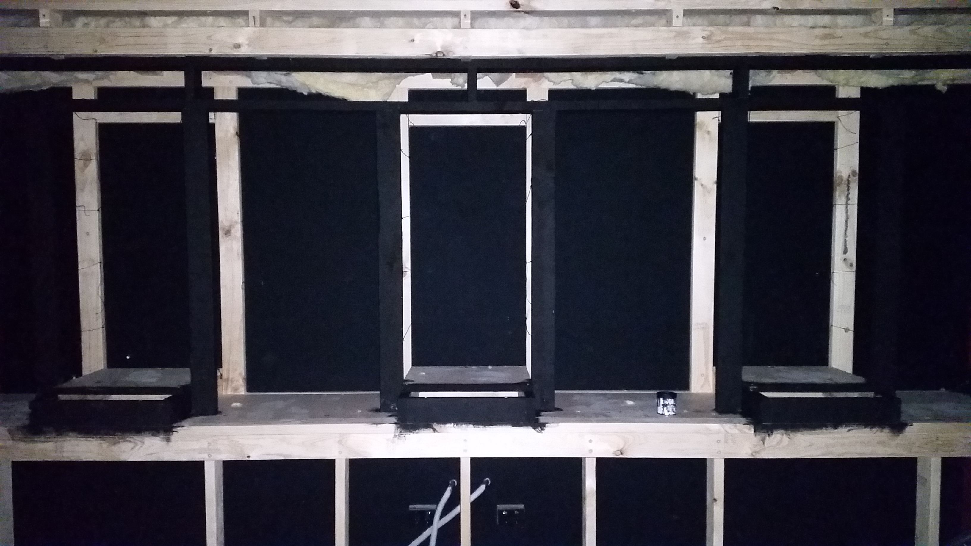

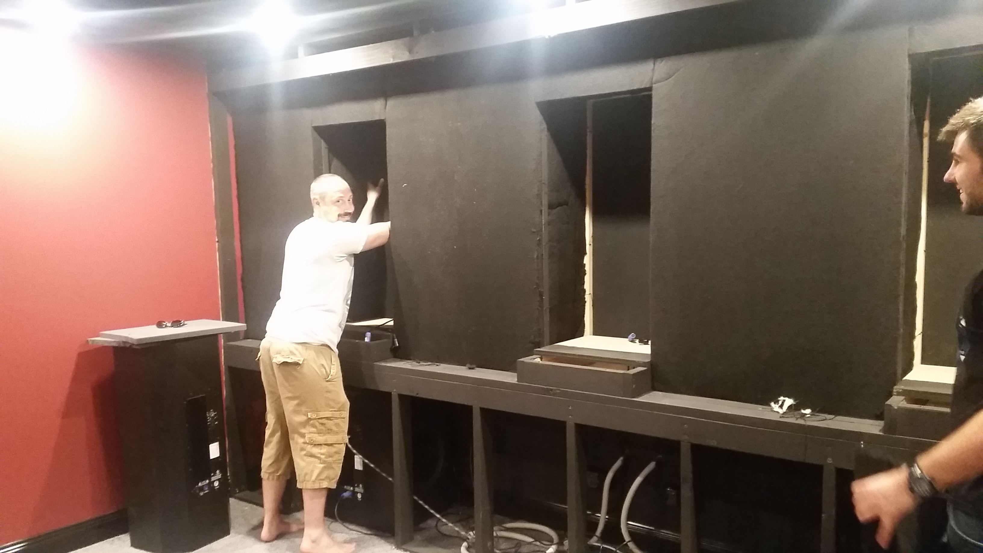

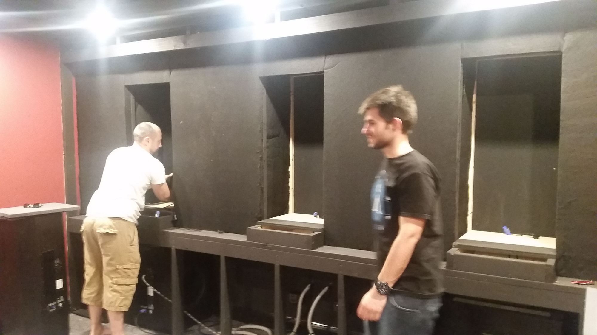

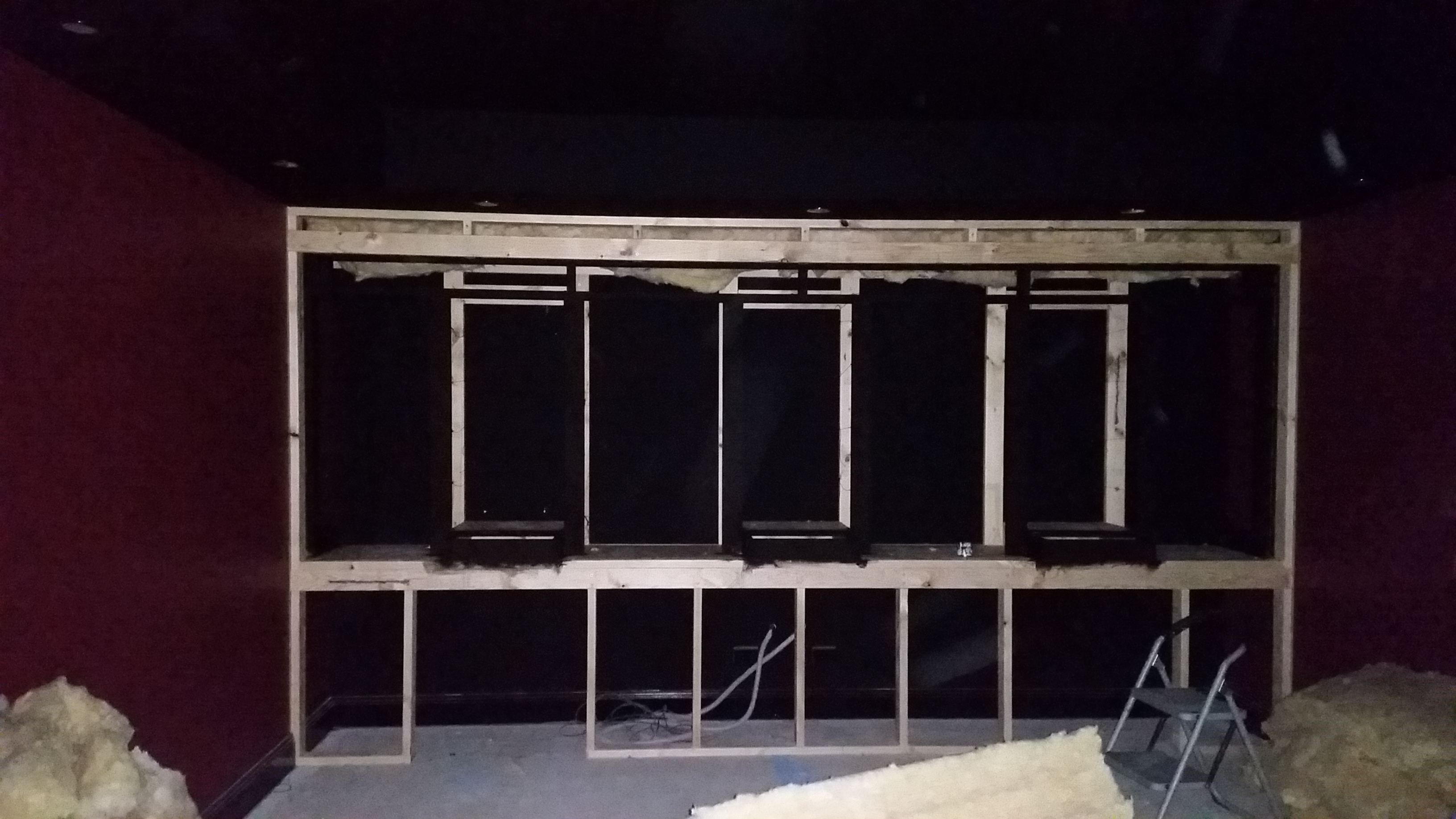

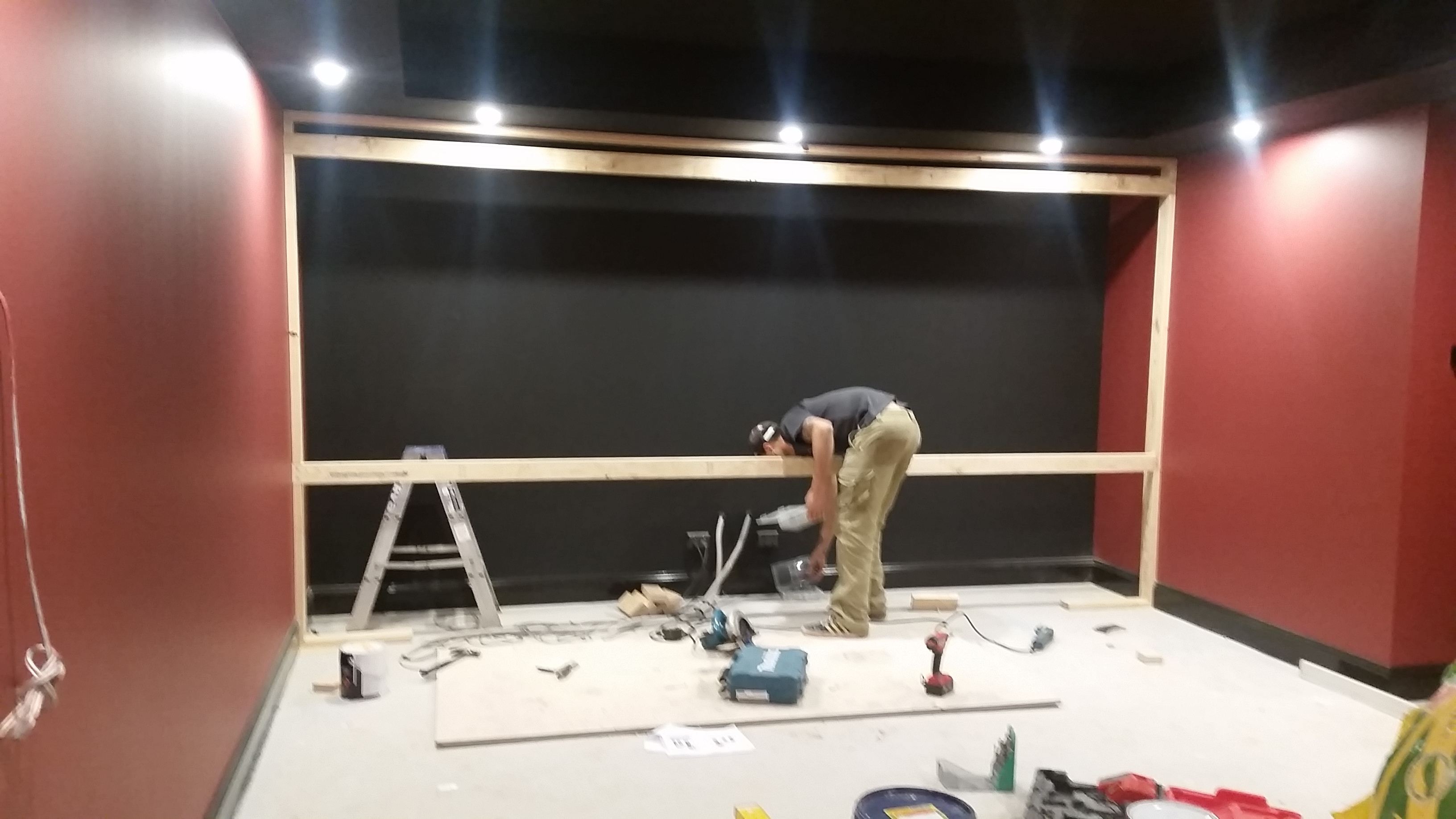

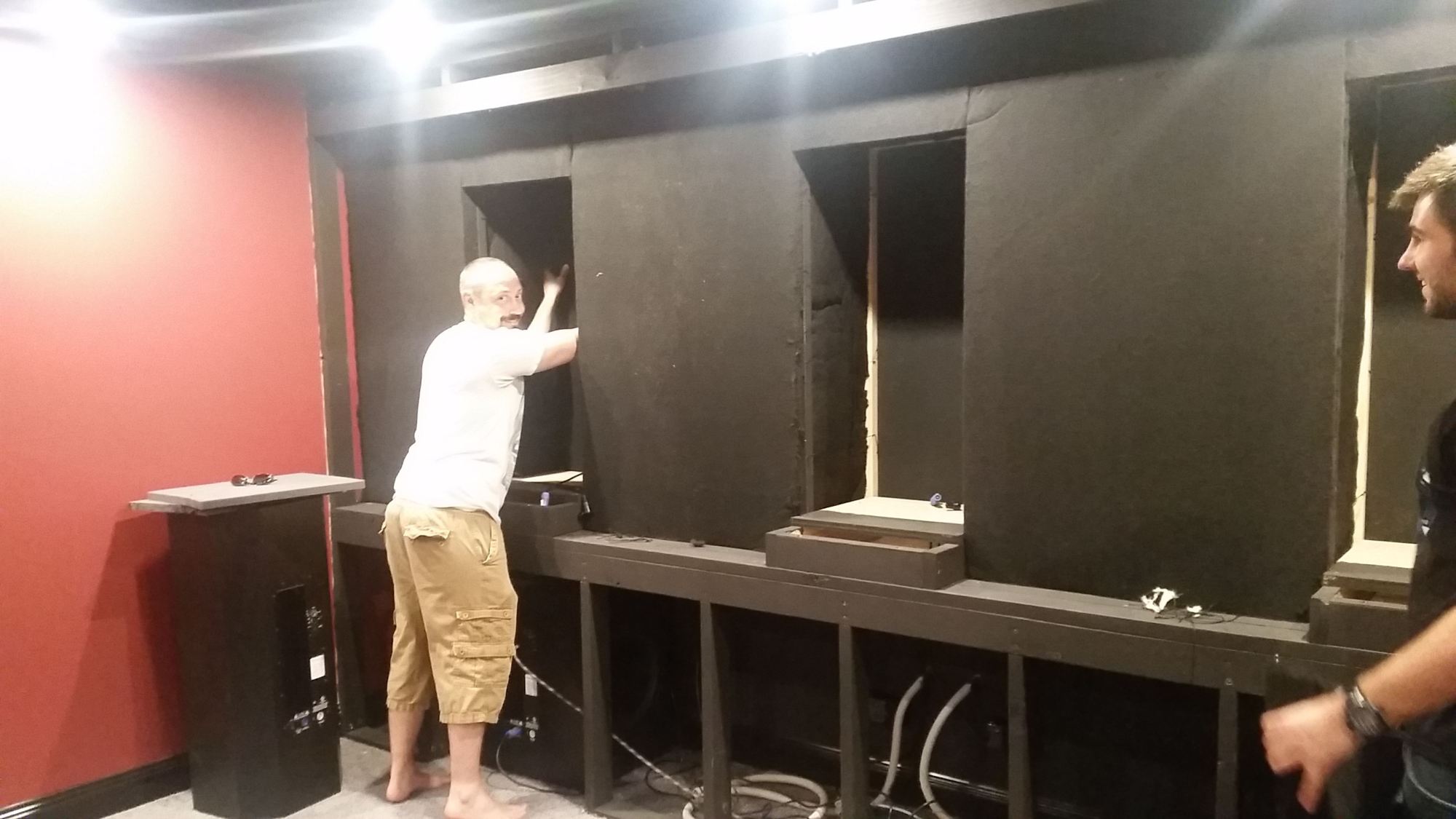

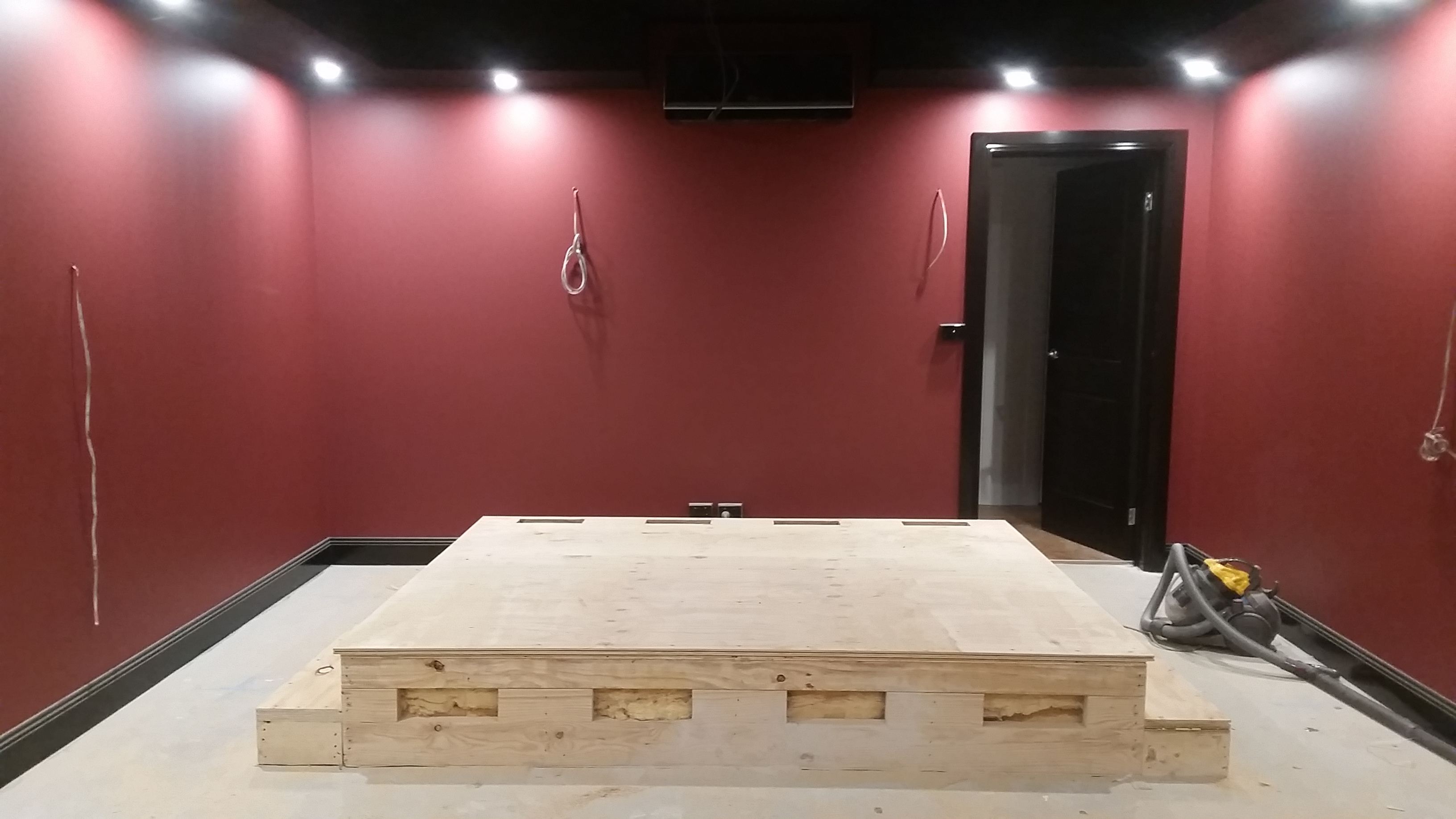

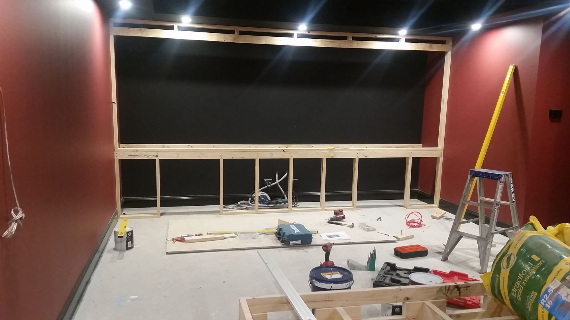

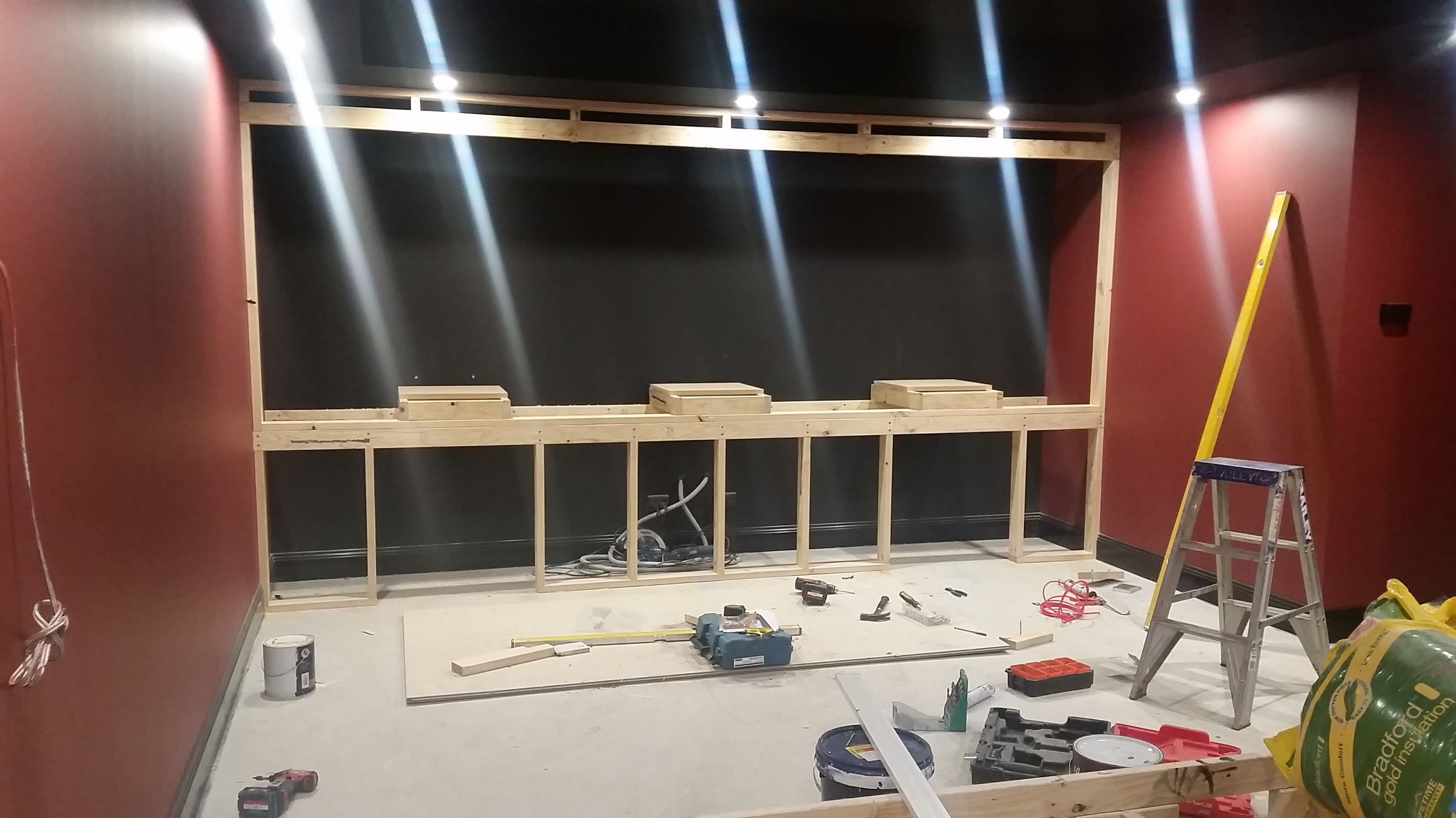

Baffle wall being built by our carpenter.

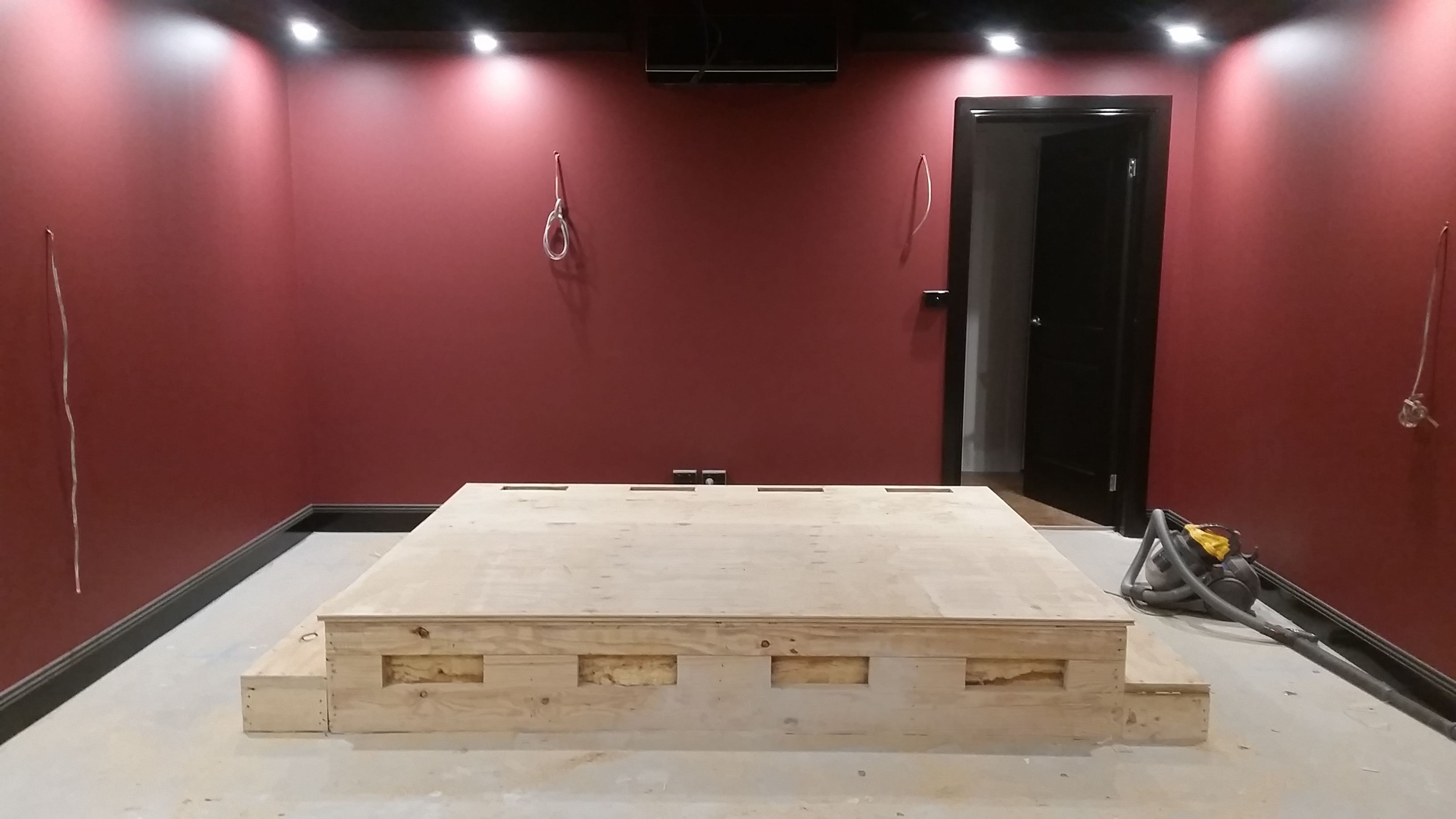

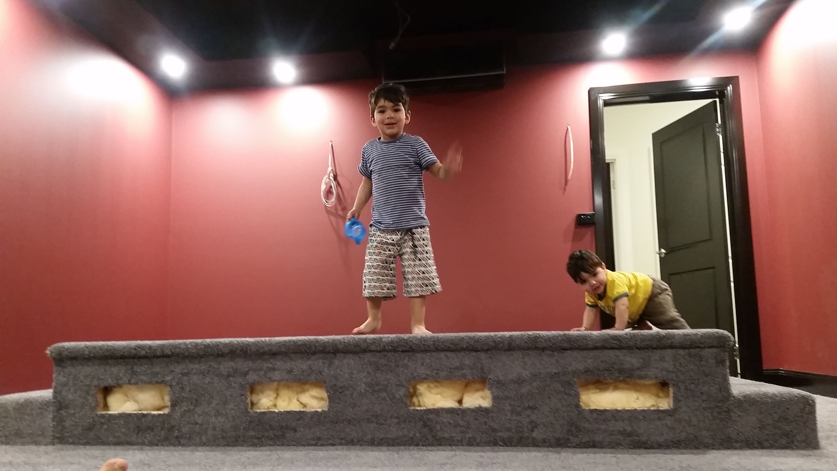

Riser was also finished and filled with Bradford insulation as specced by Nyal Mellor from Acoustic Frontiers in the US.
Nyal ended up doing all my speaker positions/Baffle wall/Bass trap riser construction plans and also did all the acoustic treatment plans as well.
  • Author

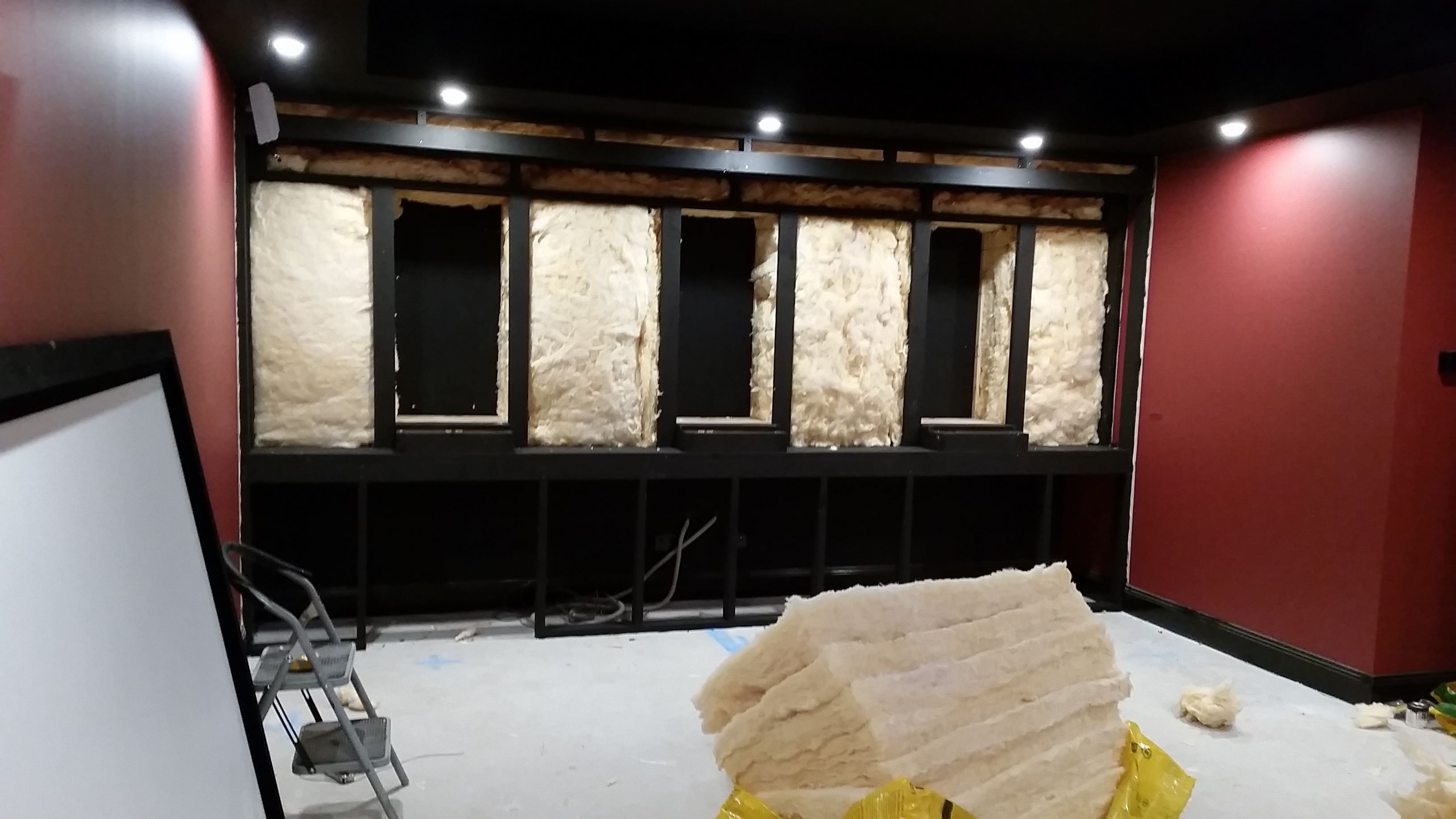

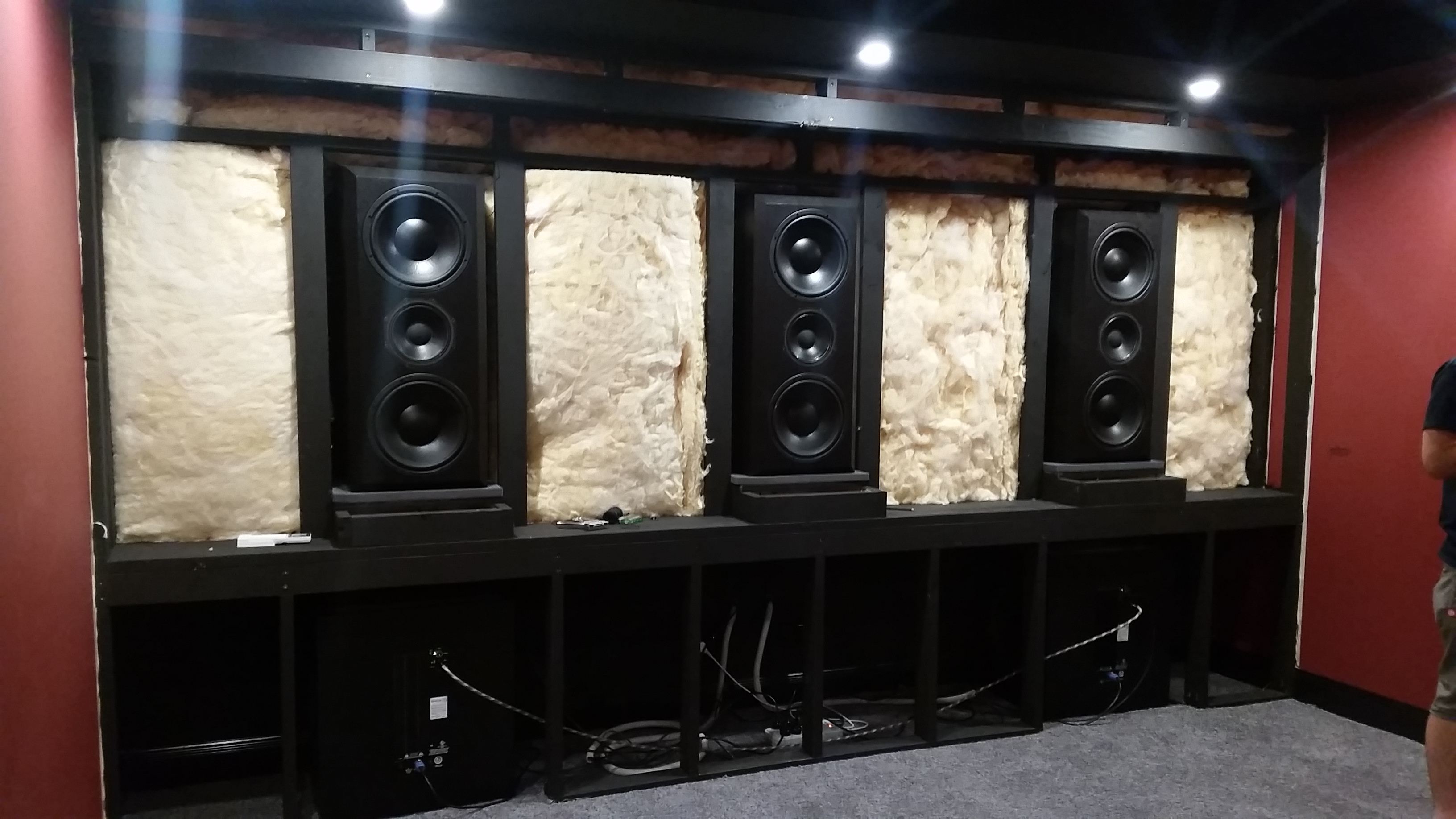

Baffle wall is being filled with Bradford insulation as well and then once all filled it will be all lined with 75mm CSR Martini panels to hide all the yellow insulation.

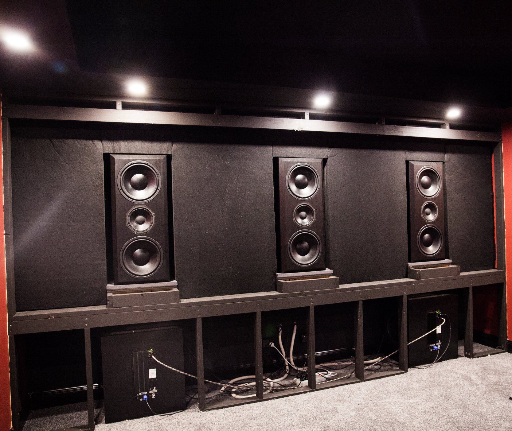

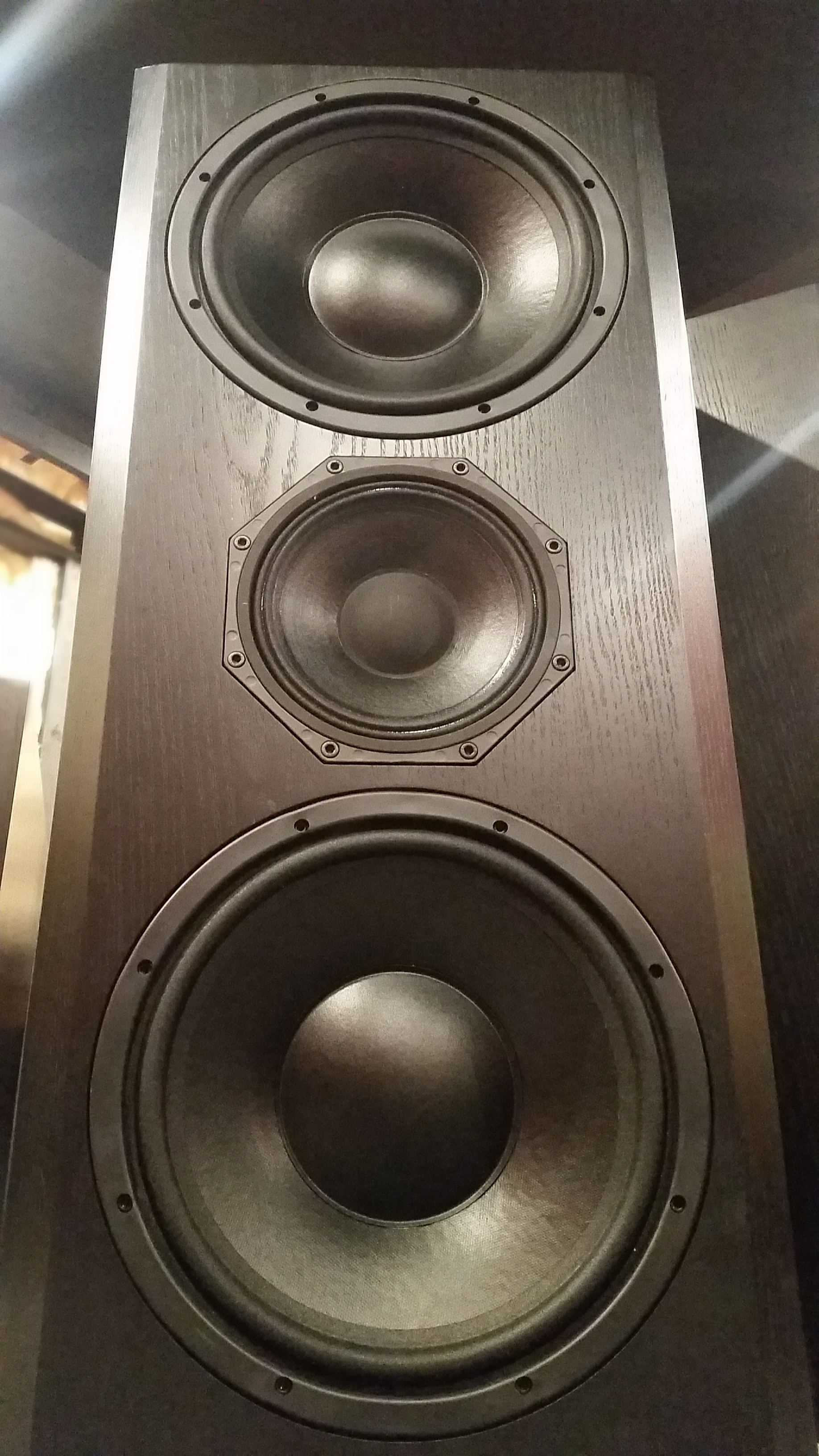

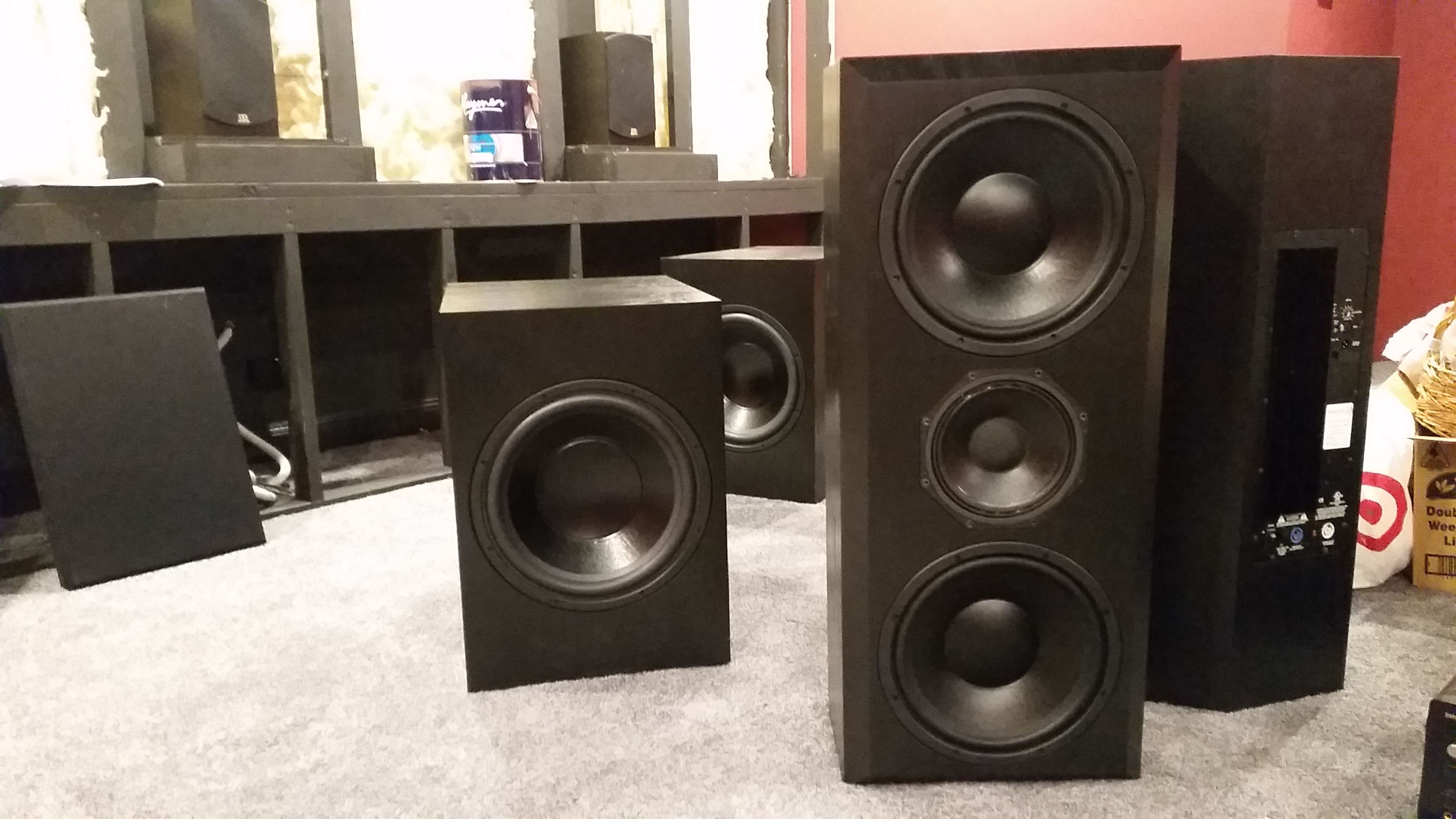

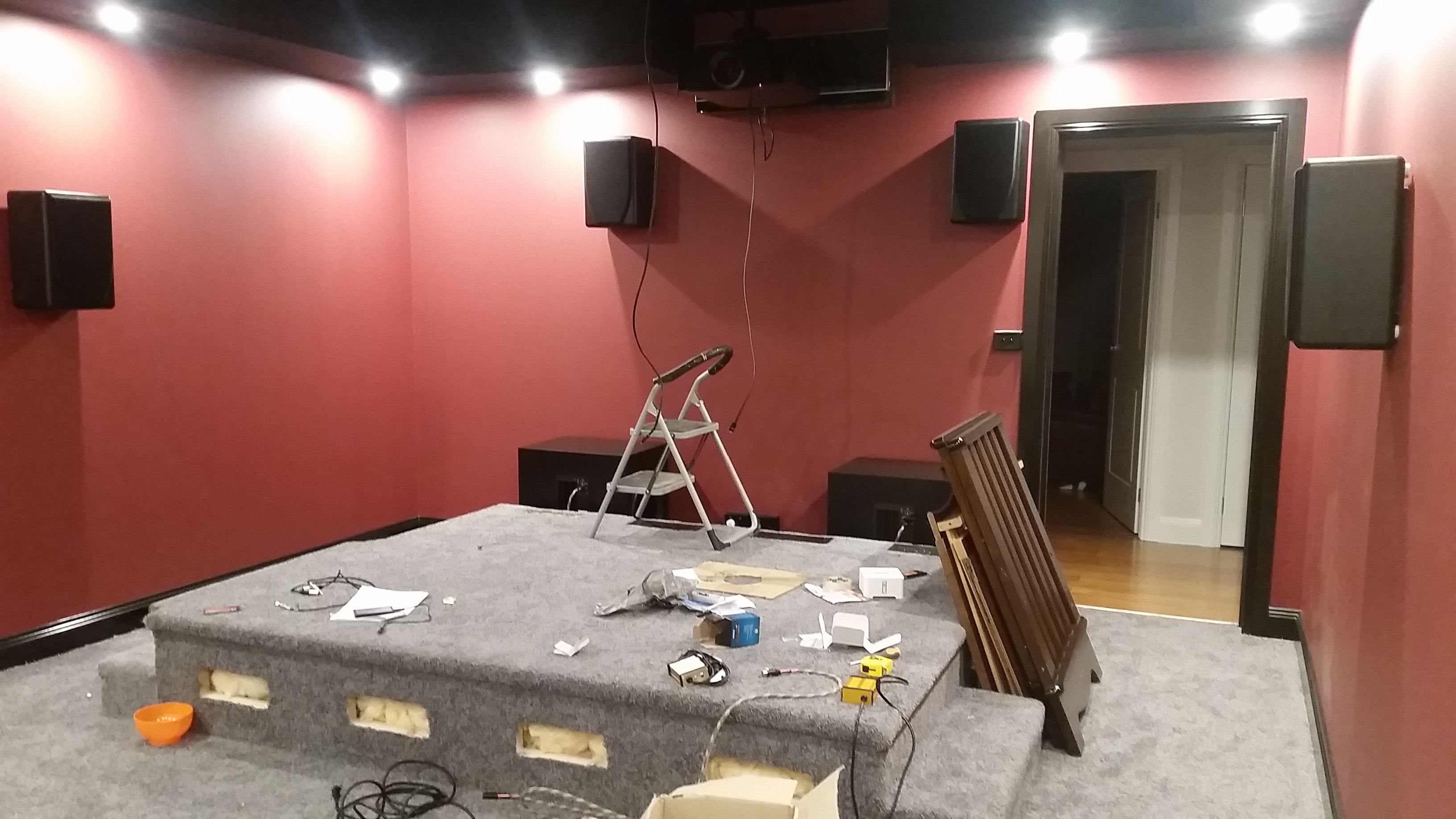

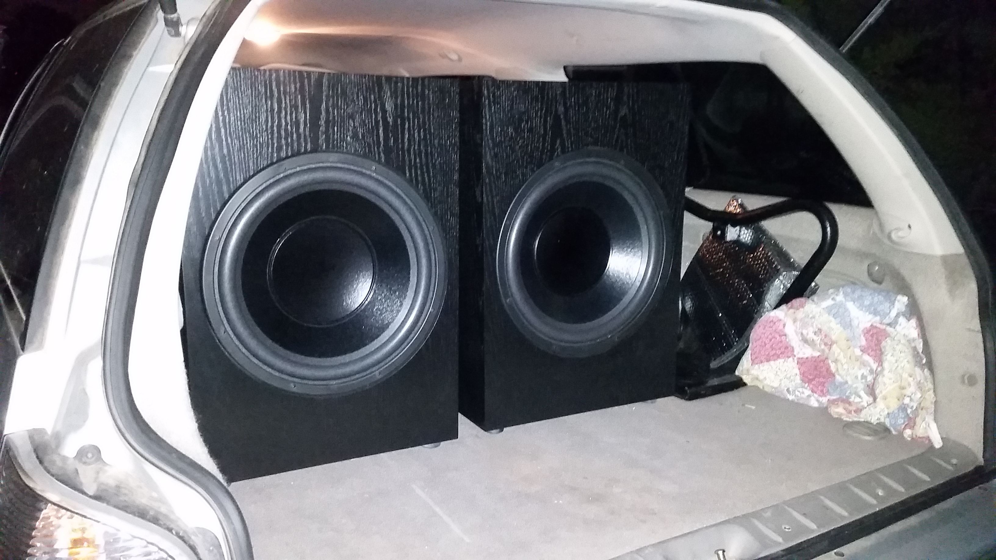

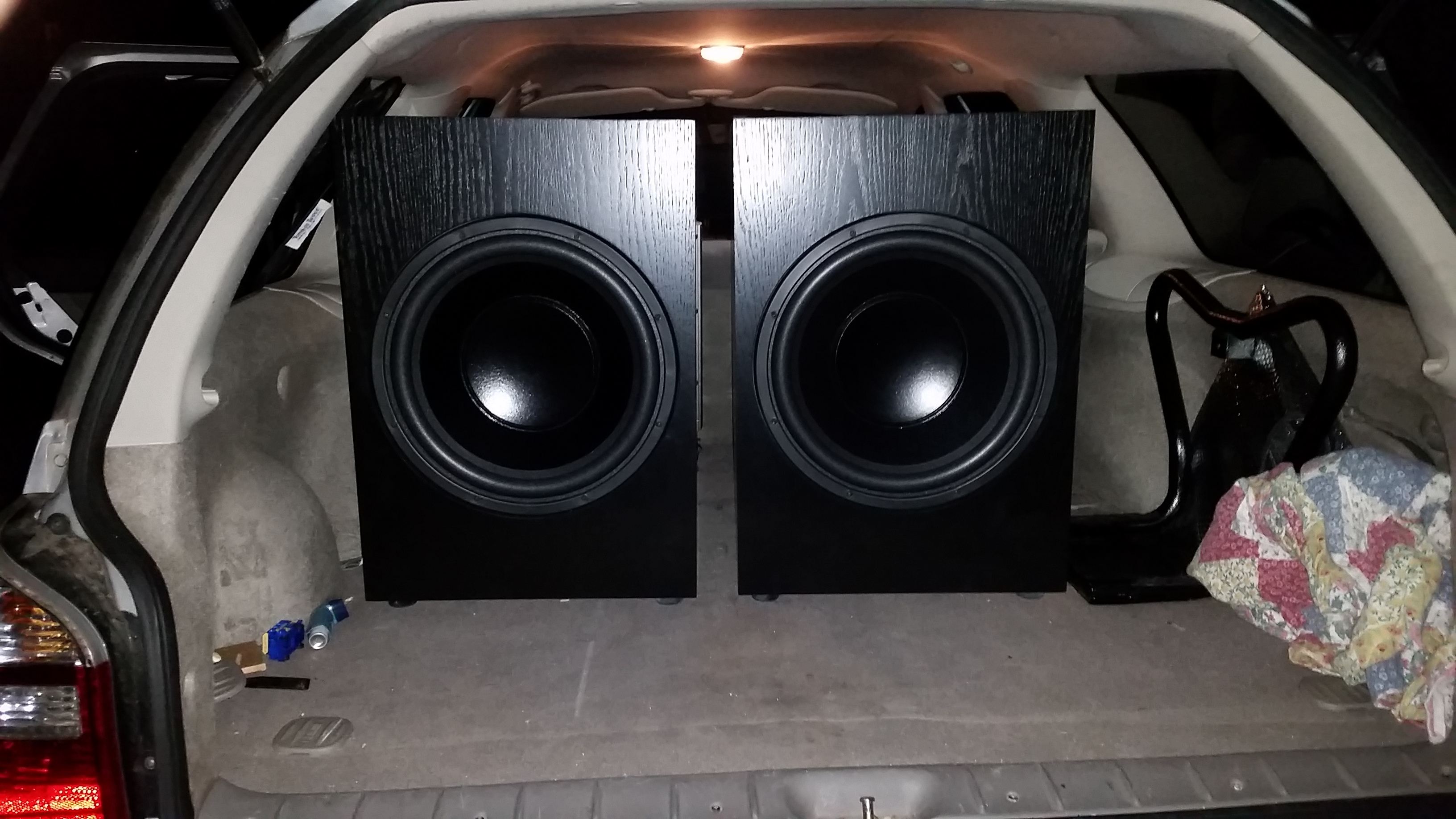

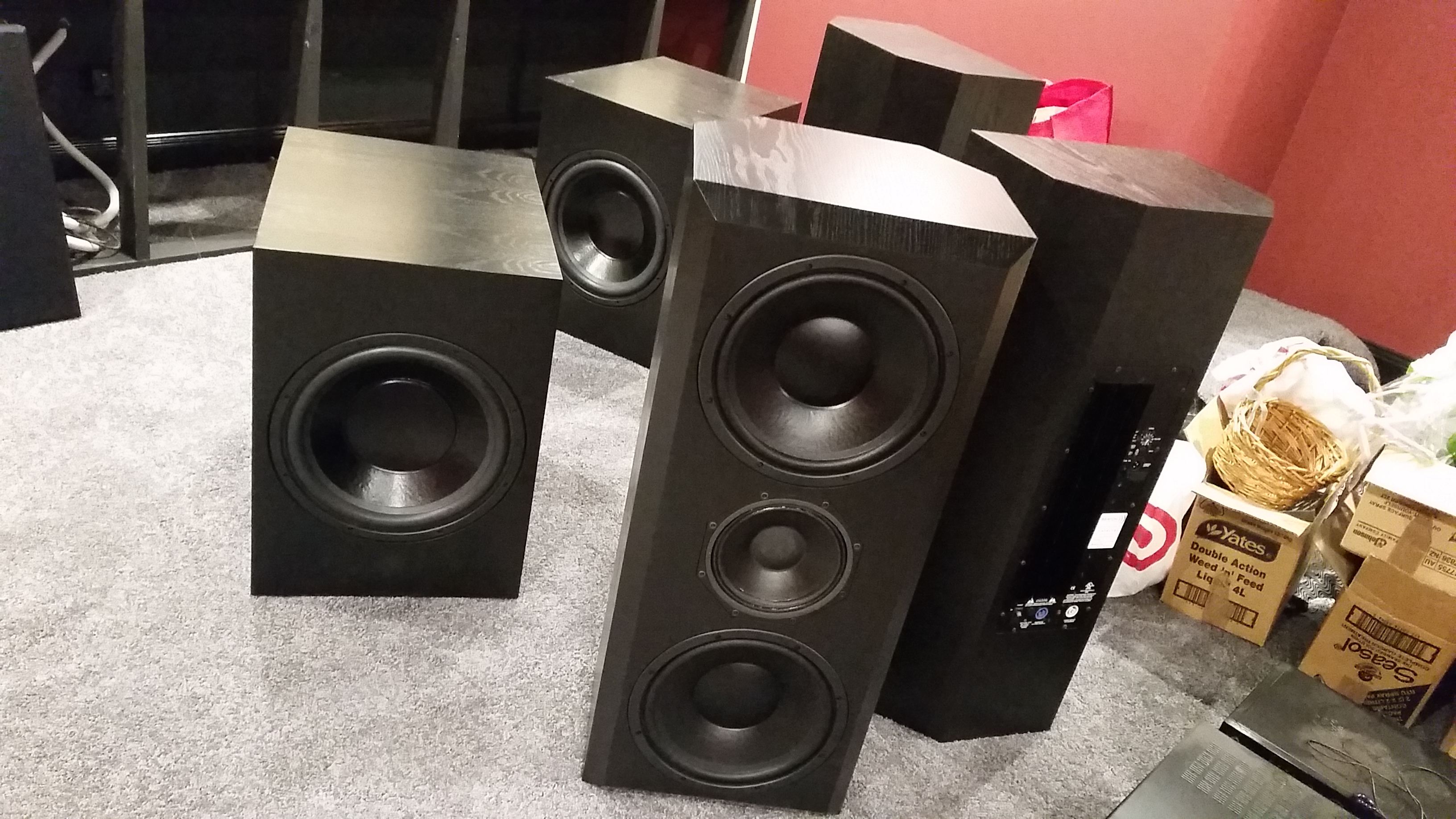

Transporting all my speakers in my wagon to thier new home :D
3 x Seaton Sound Catalyst 12C's Active DSP LCR's
4 x Seaton Sound Submersives w/ 6000w SpeakerPower amps
I had to see how they looked in the baffle wall....and I have to say, they look cool :P  hahaha
  • Author

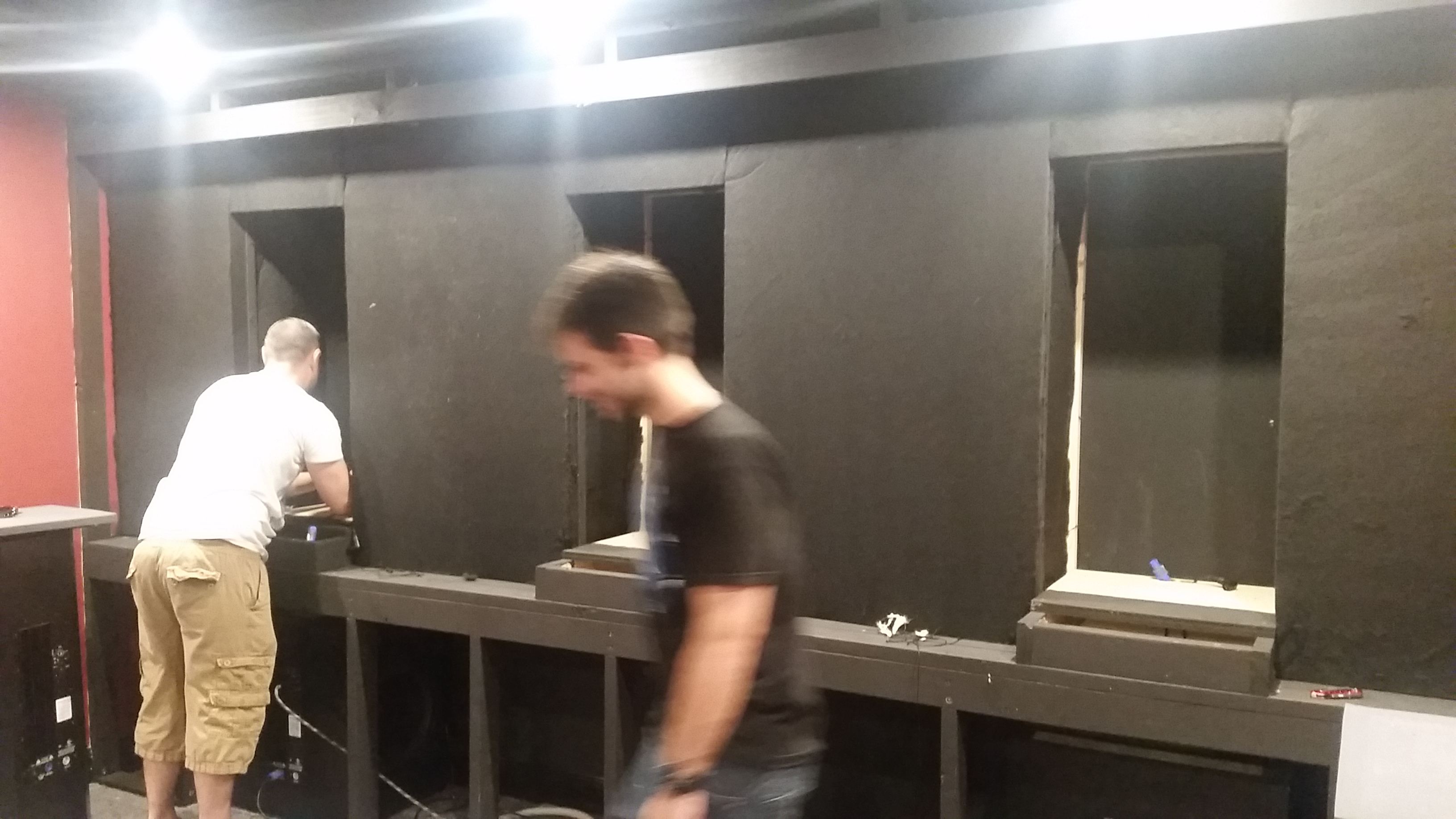

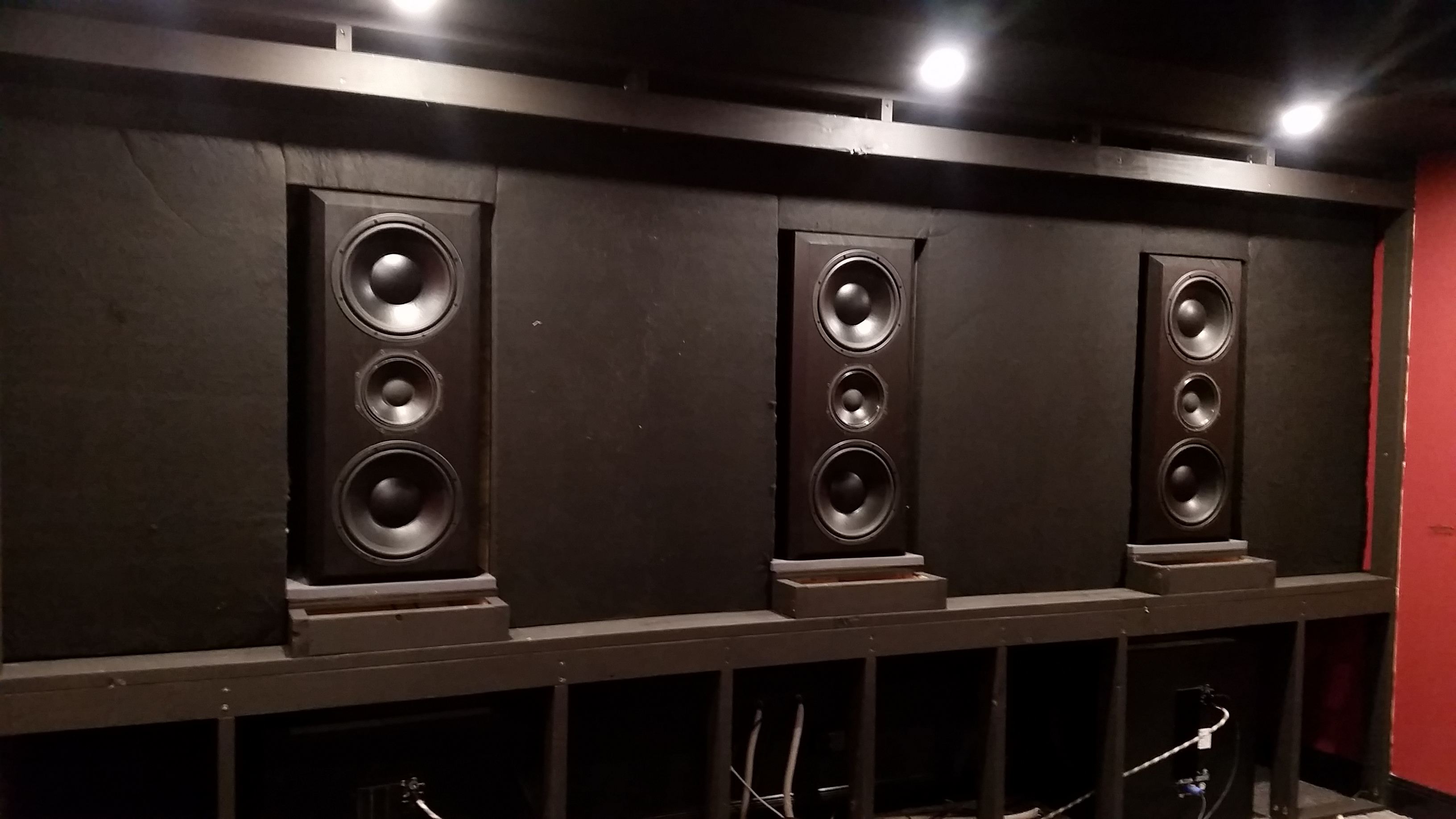

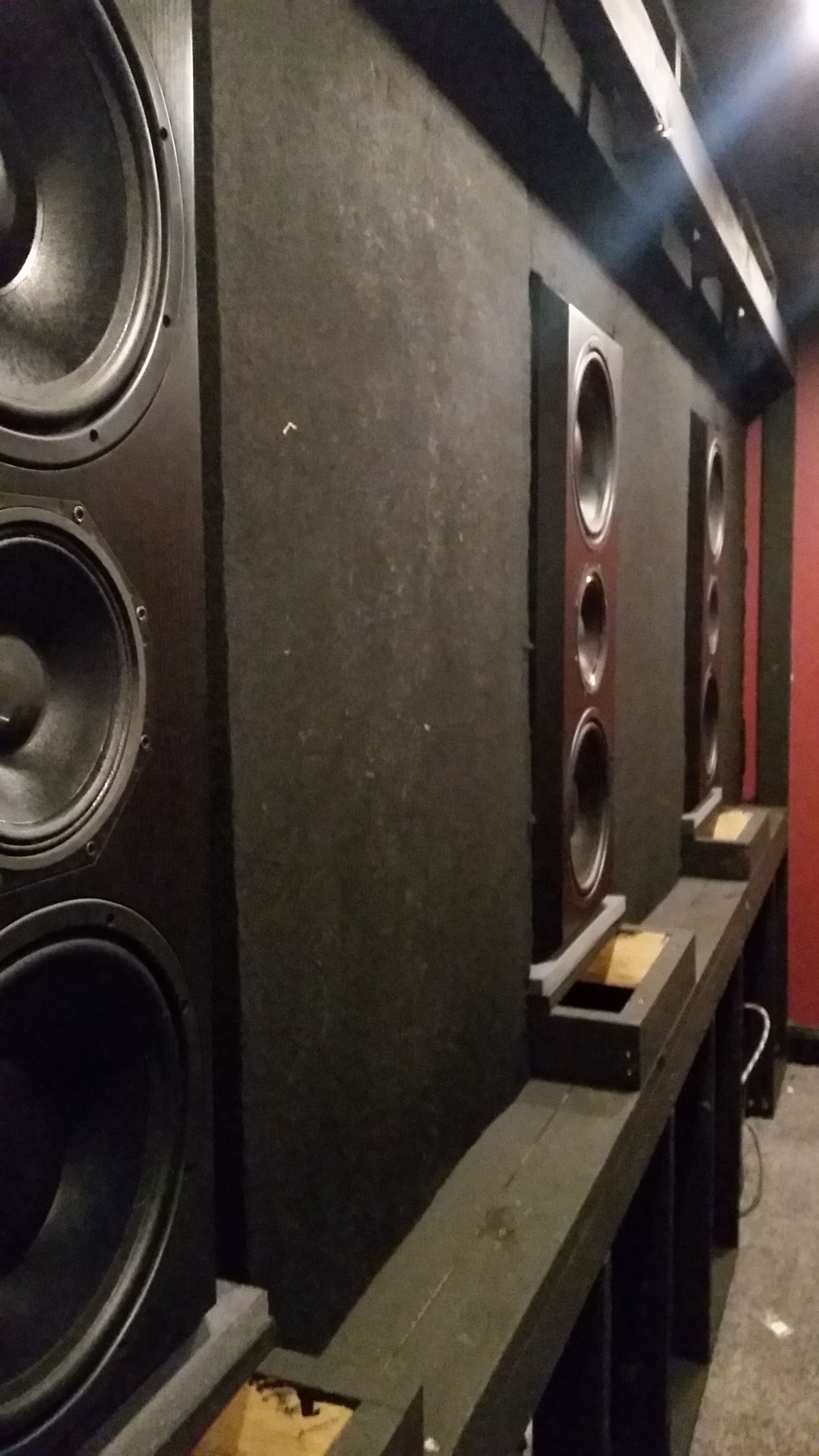

Had my friend who i met through this forum back in 2010 , MACCA350 and his cousin help me finish all the baffle wall with the CSR Martini panels.

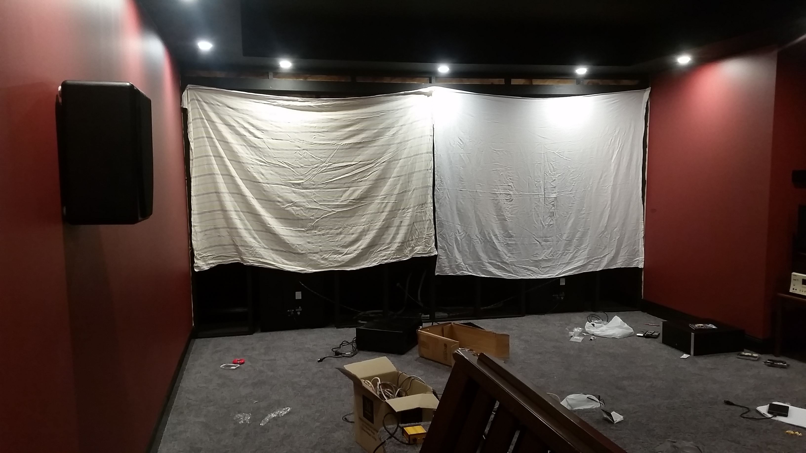

Rear surrounds are custom made by Paul Spencer from Red Spade audio who designed these speakers to specifically match and keep up with my 12C Catalyst speakers in the dynamics and still maintain clarity. They are simply brilliant speakers and he is such a knowledgable guy!.
Projector also went up - JVC X55 with a temporary sheet screen setup  LOL!

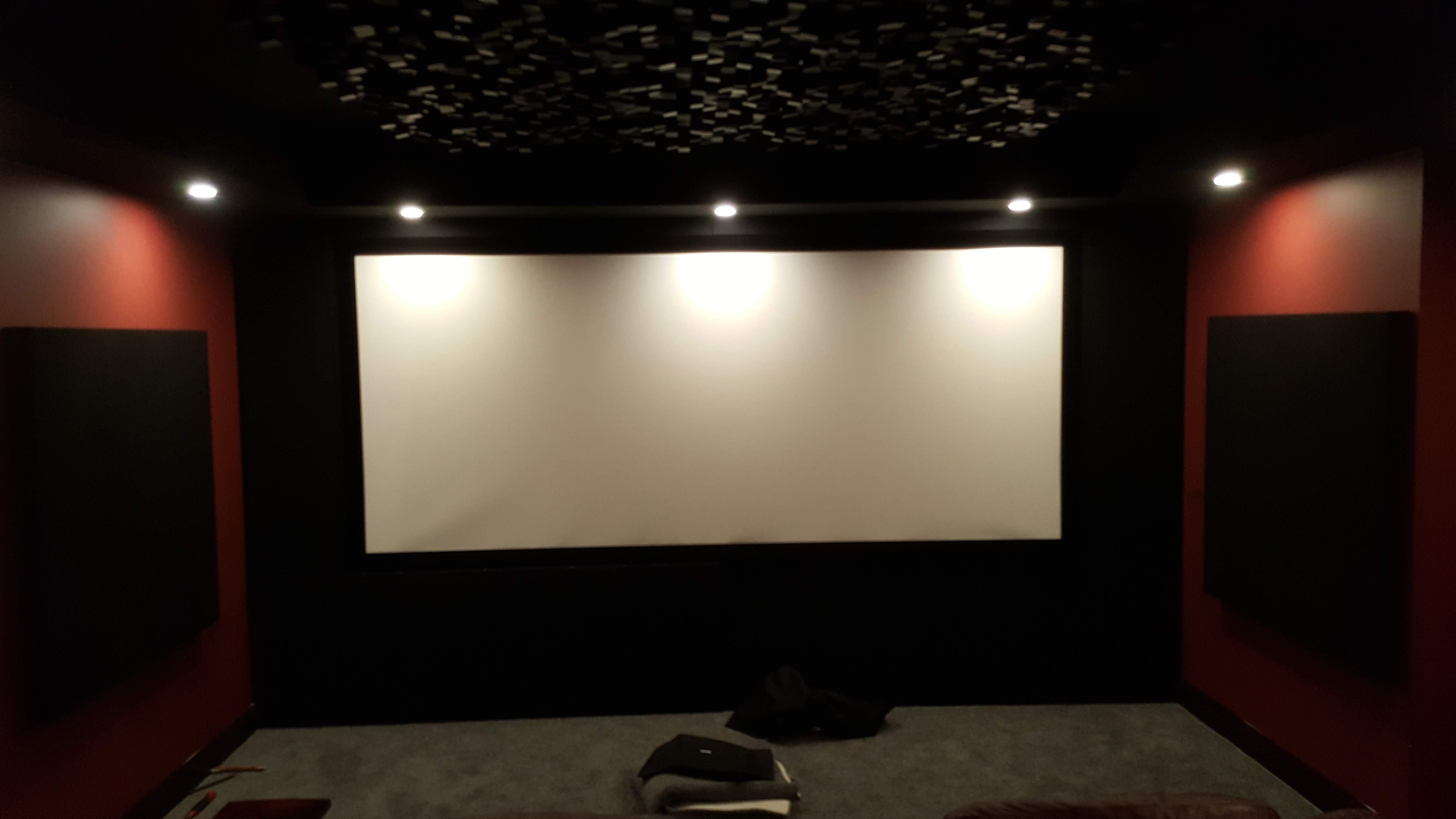

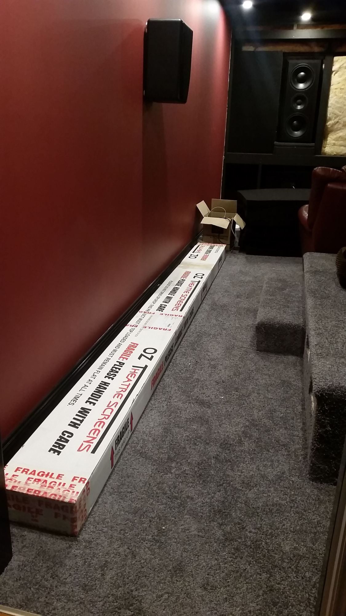

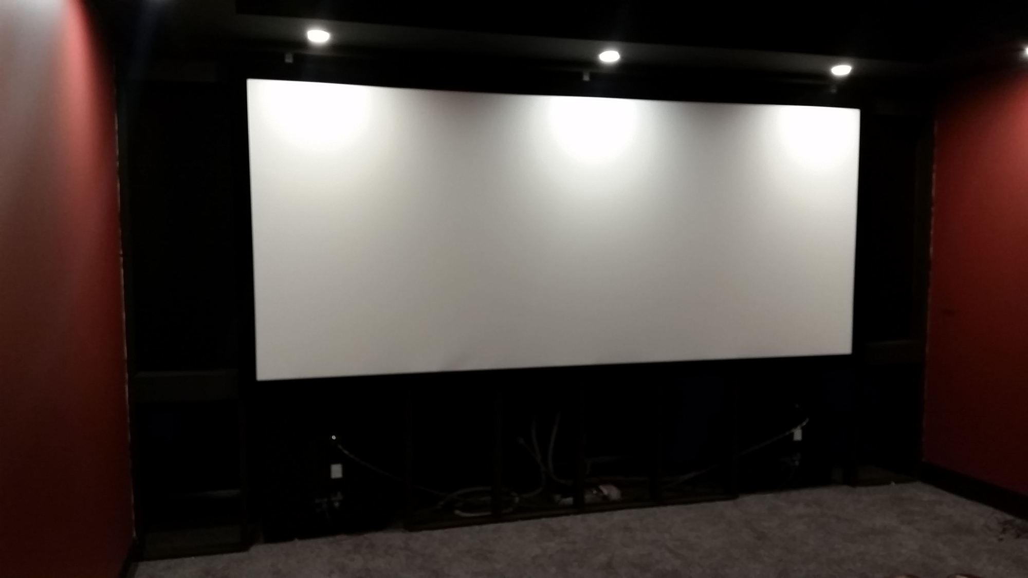

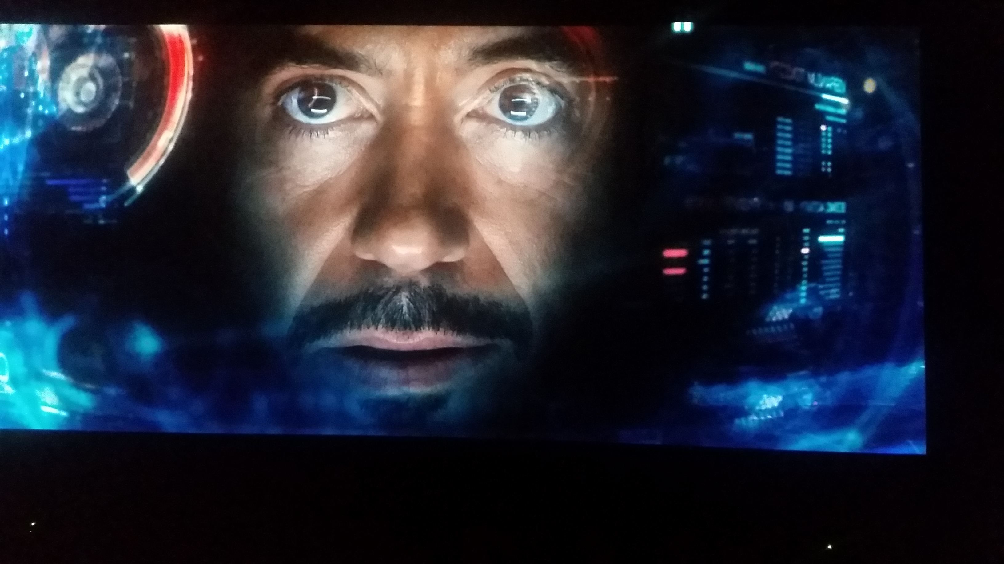

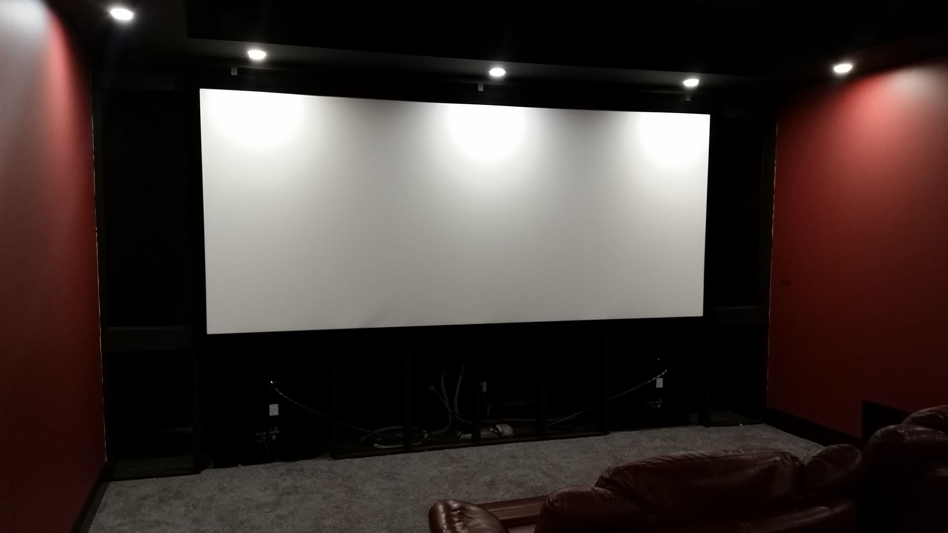

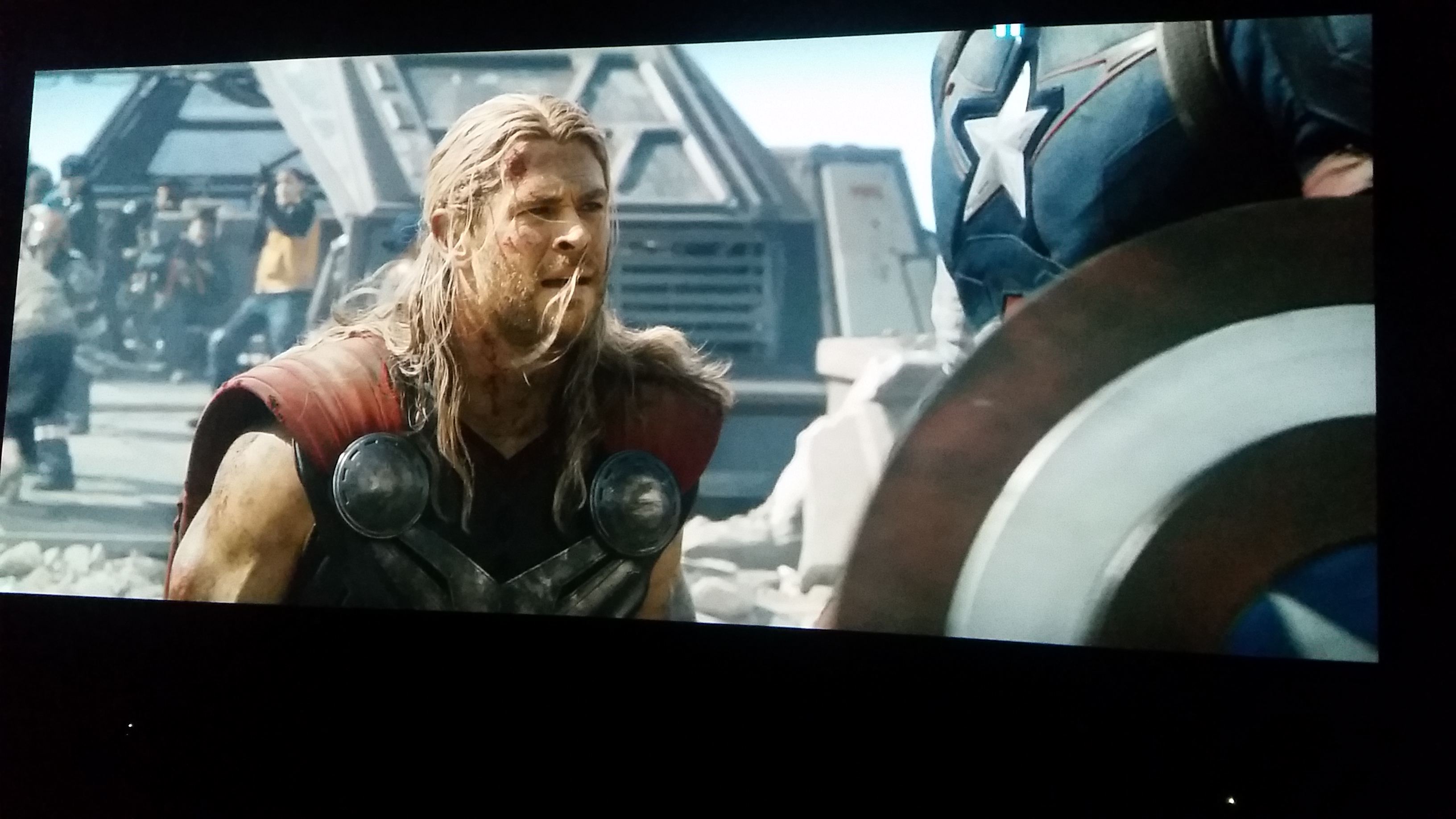

New screen day arrived OZTS 140" cinemascope screen ordered from Rich, an absolute legend of a bloke......every time i spoke to him he always answered any questions and looked after me on the price!.
  • Author

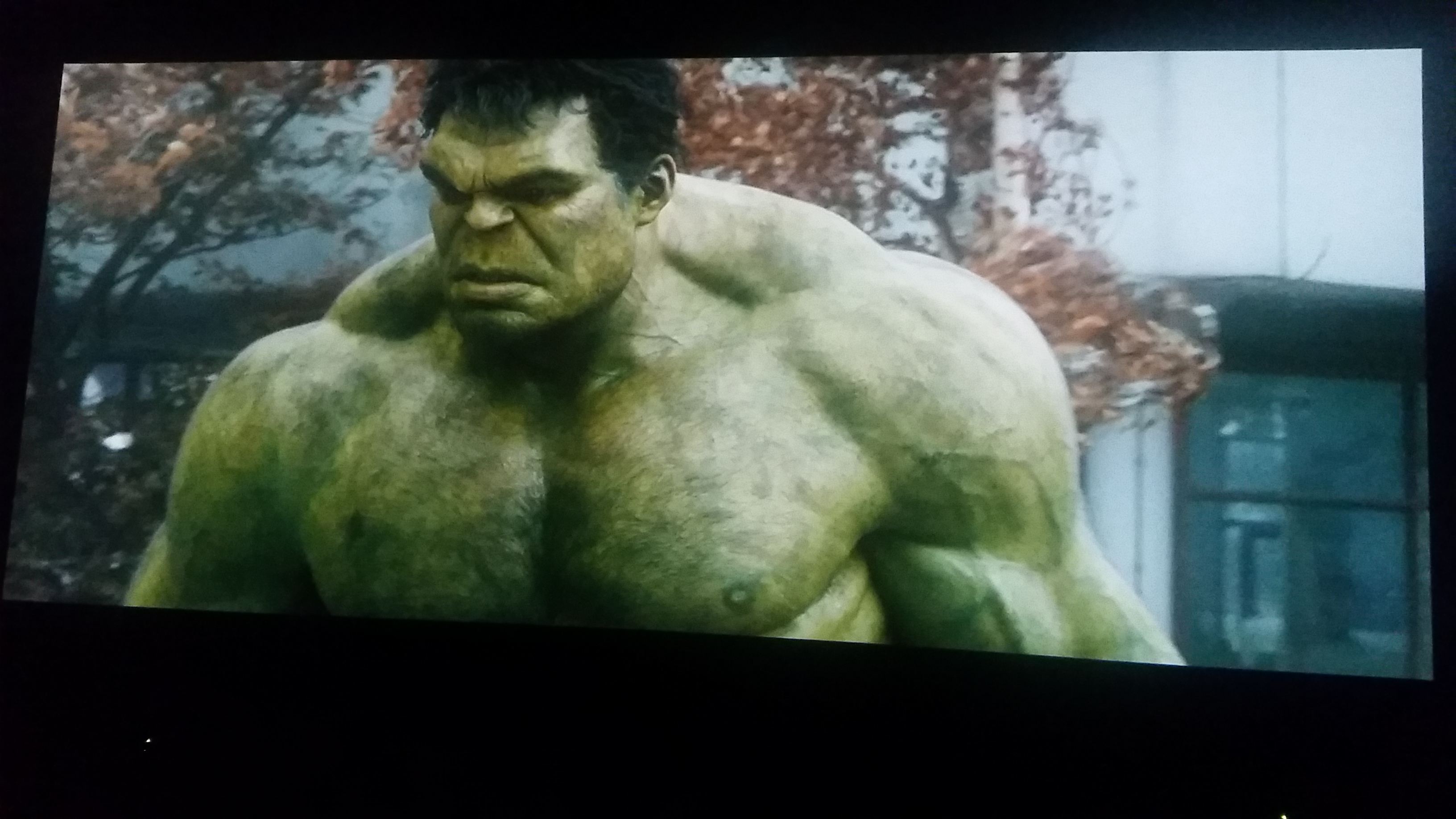

Here's some pics of the projector and 140" cinemascope screen in action!

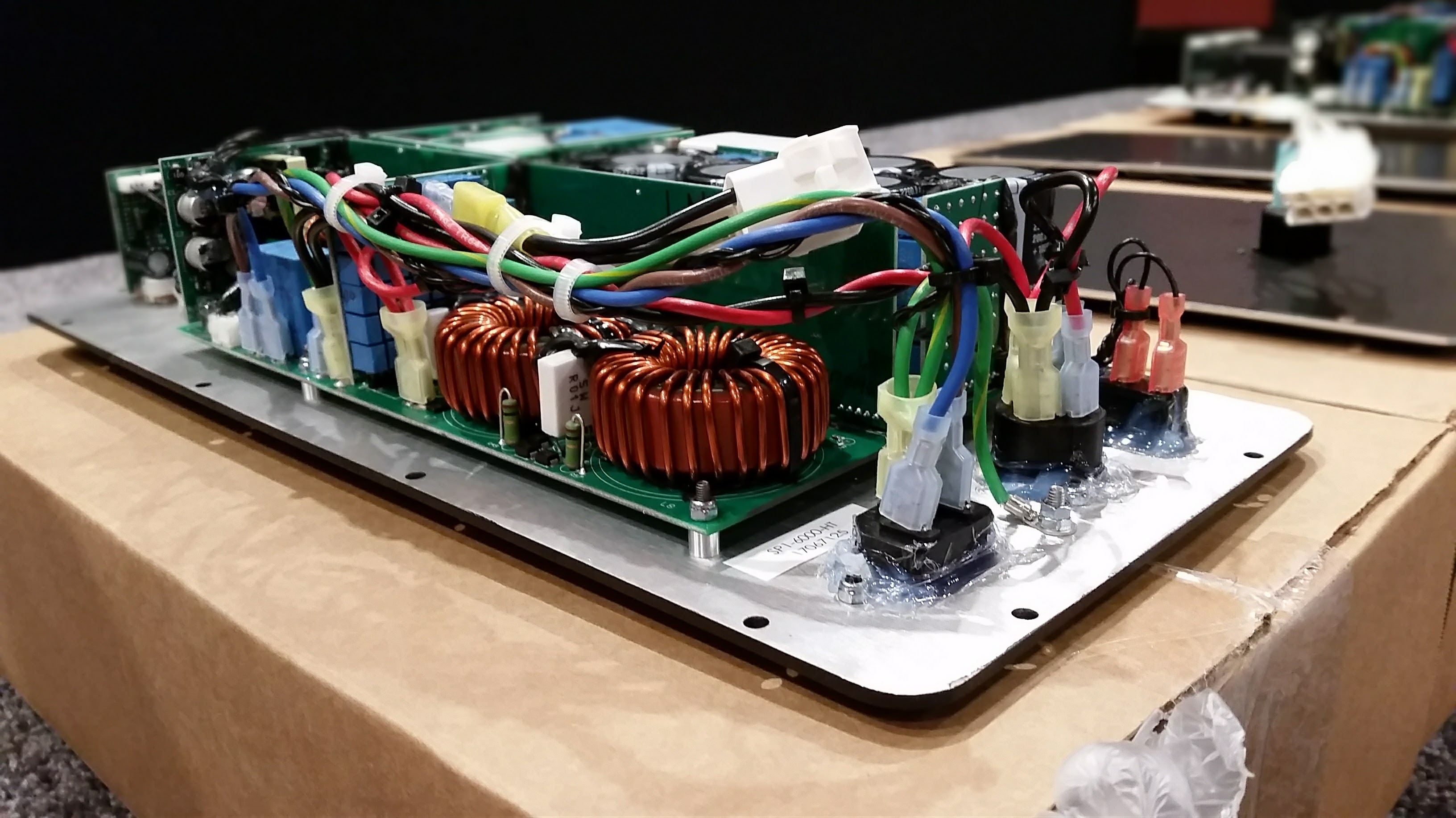

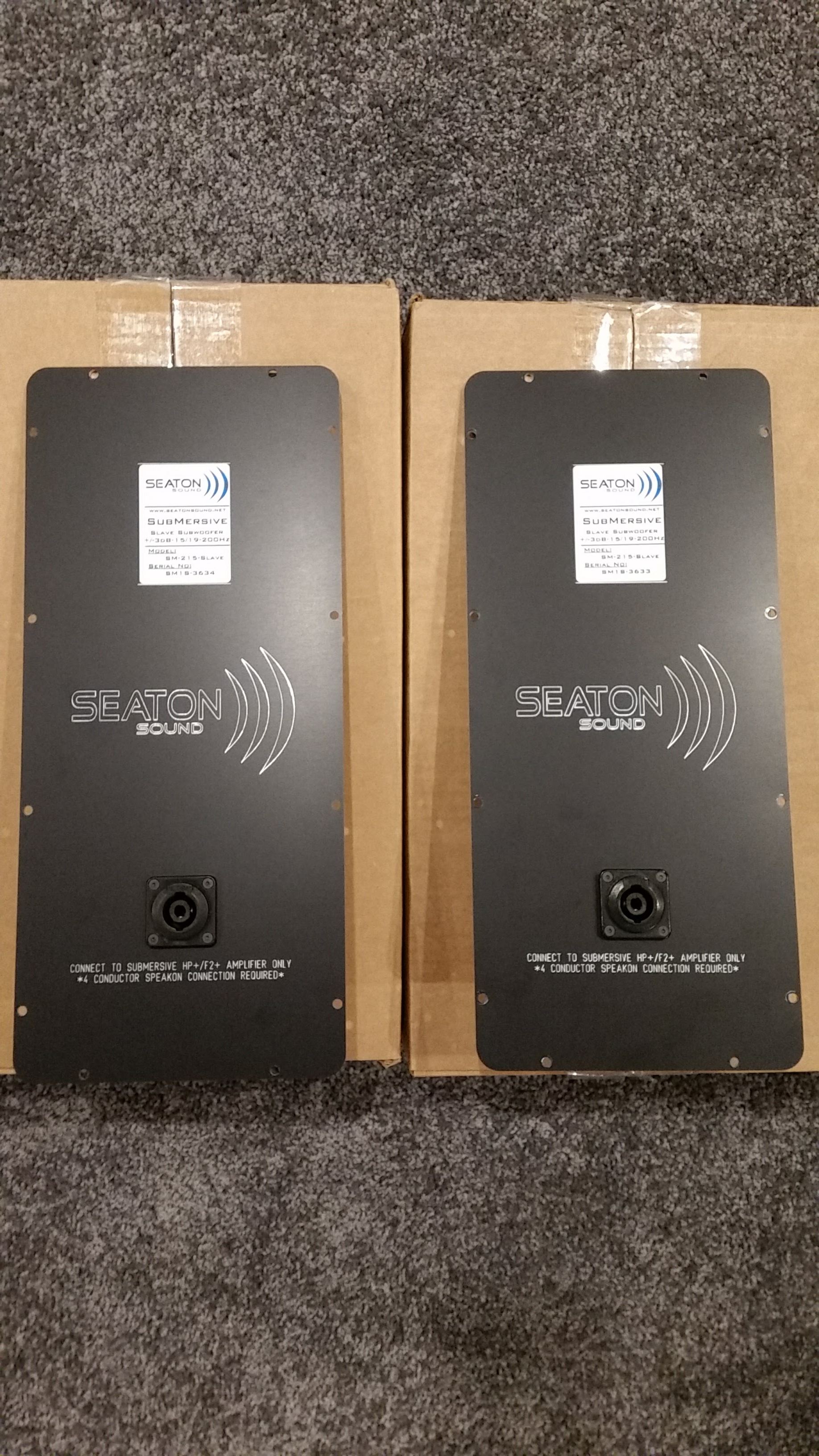

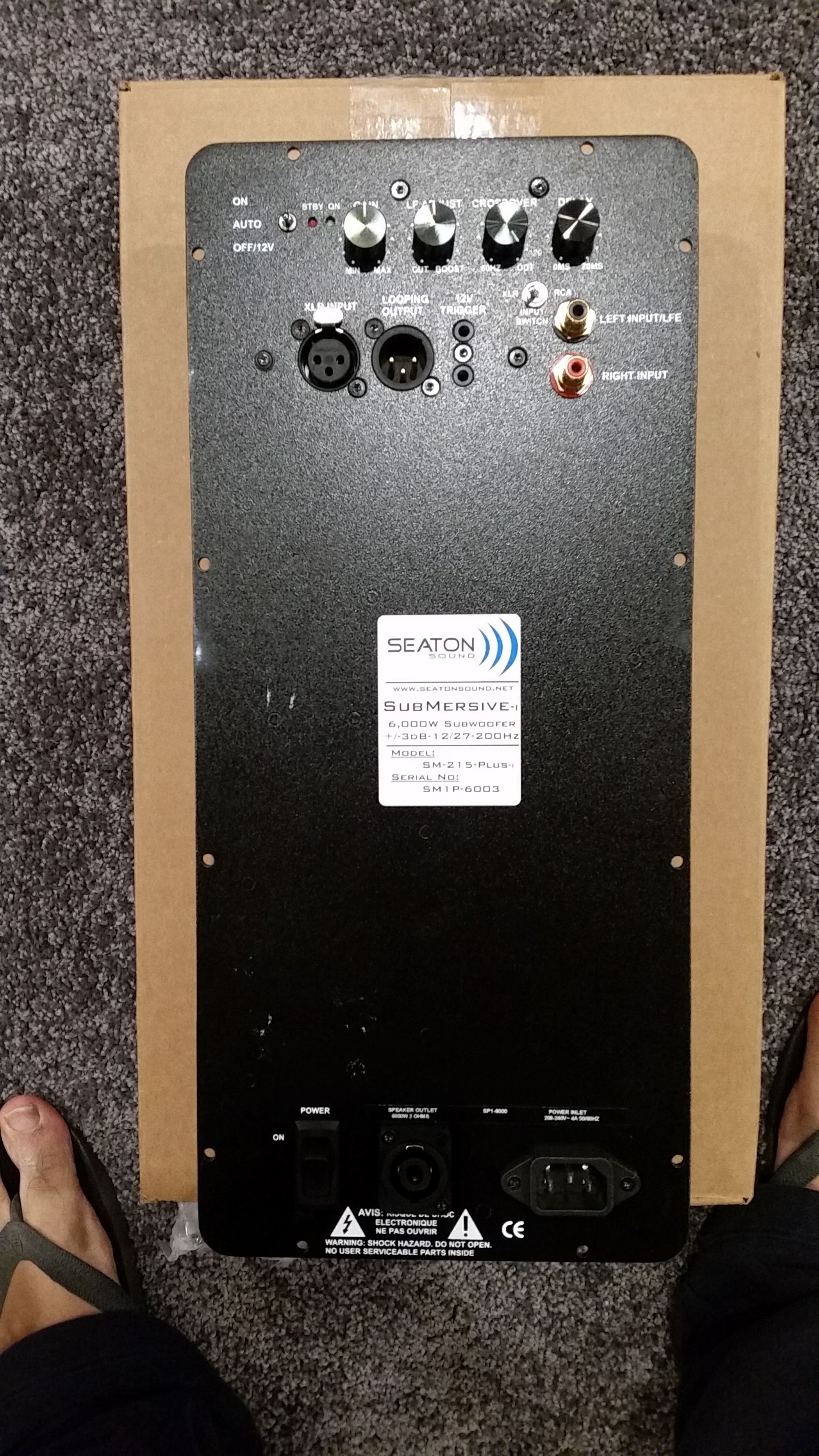

I upgraded all 4 of my Submersives from the standard 1kw sub amps to the new 6kw Amp+ slave combo.
Total of 12,000watts of power for all 4 subs. It was an absolute night and day difference compared to the old amps where I would run into some light clipping on some scenes......not with these bad boys lol.
They really changed the dynamics of the subs and how they perform................a bloody worthwhile upgrade!.

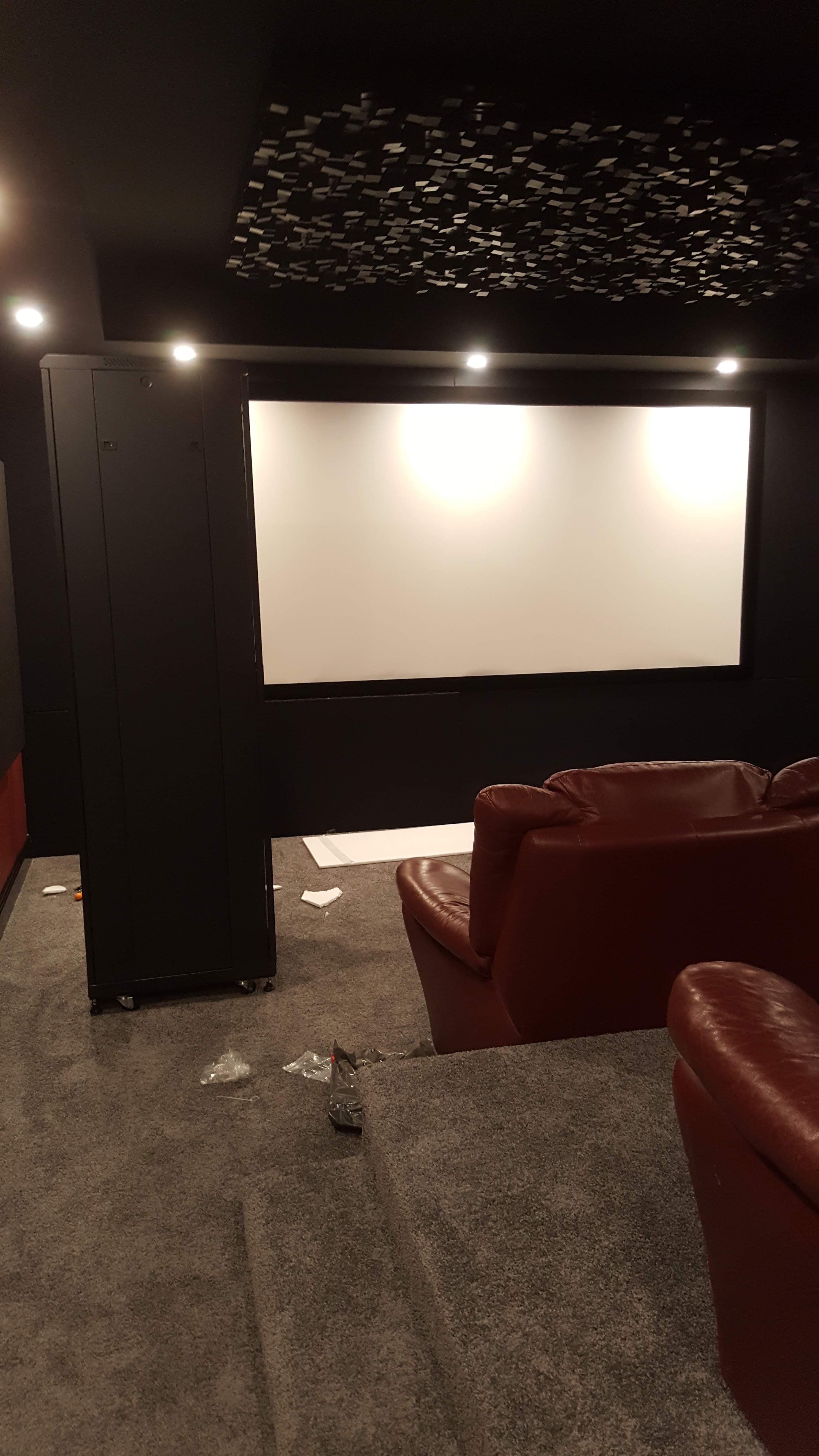

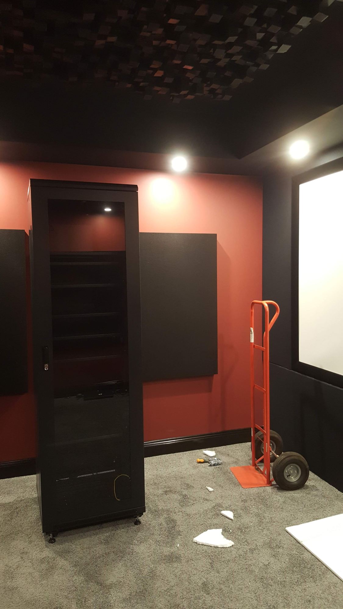

42RU Titan AV rack came in :)........an absolute heavy bastard lol.

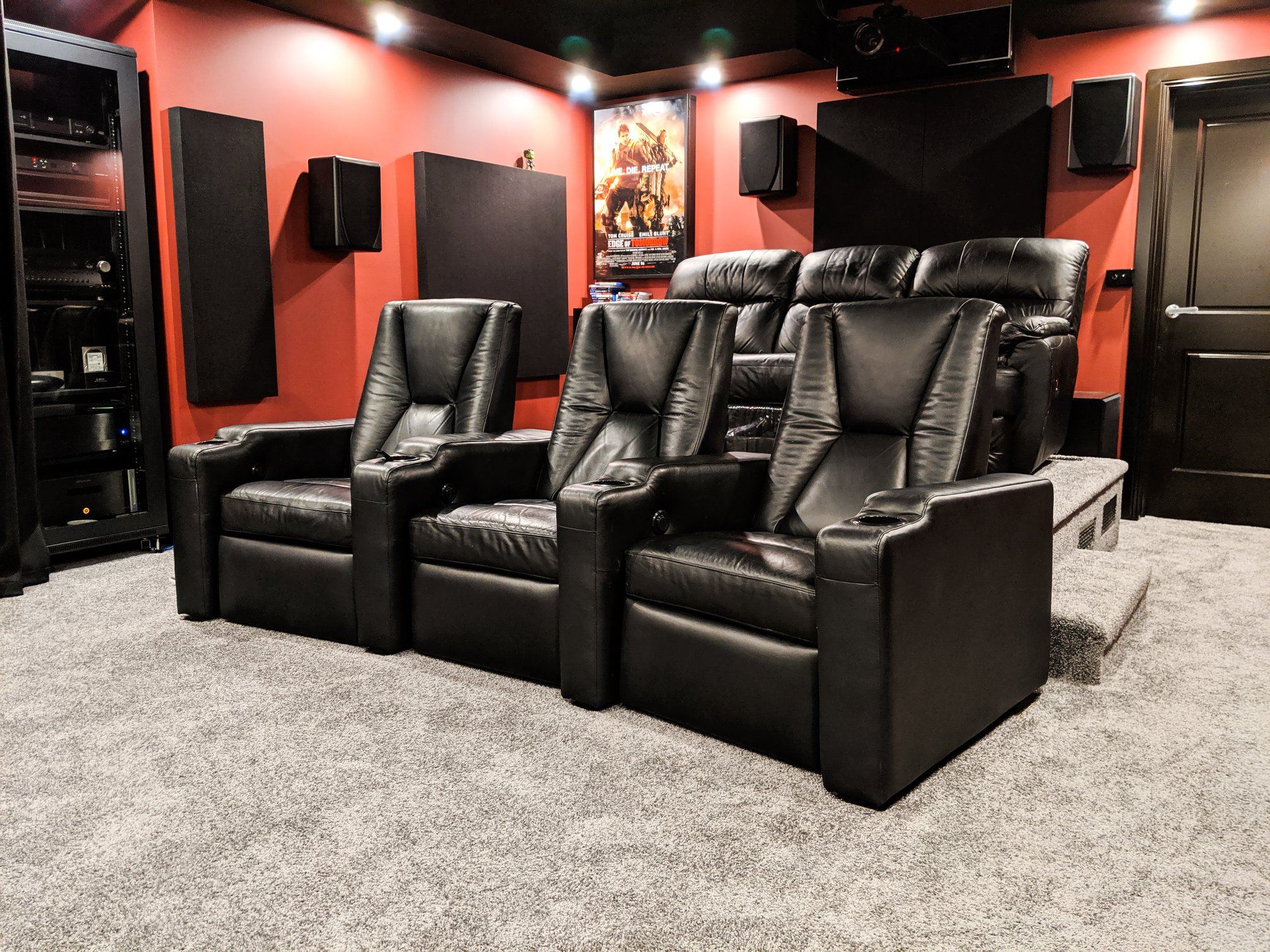

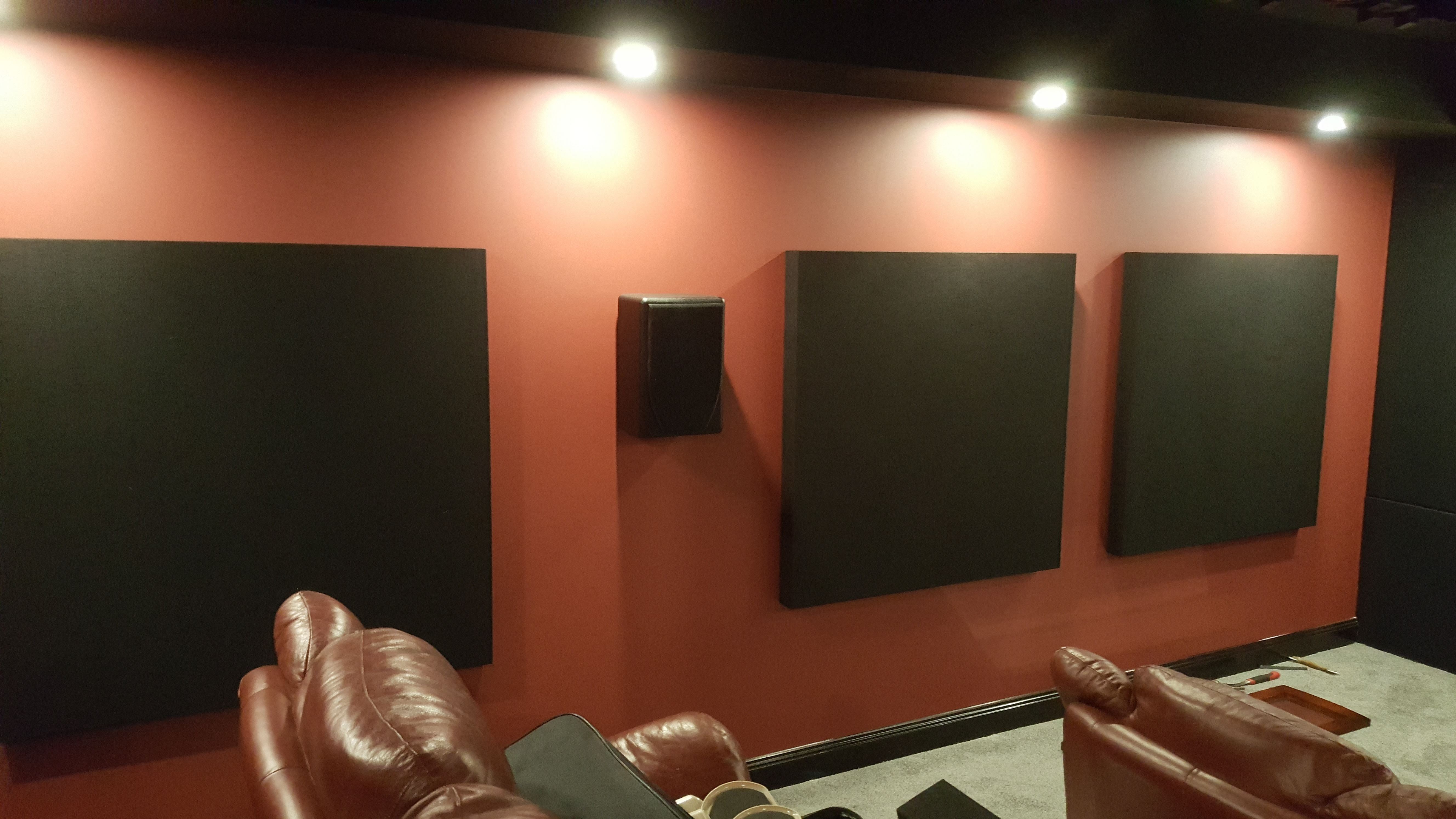

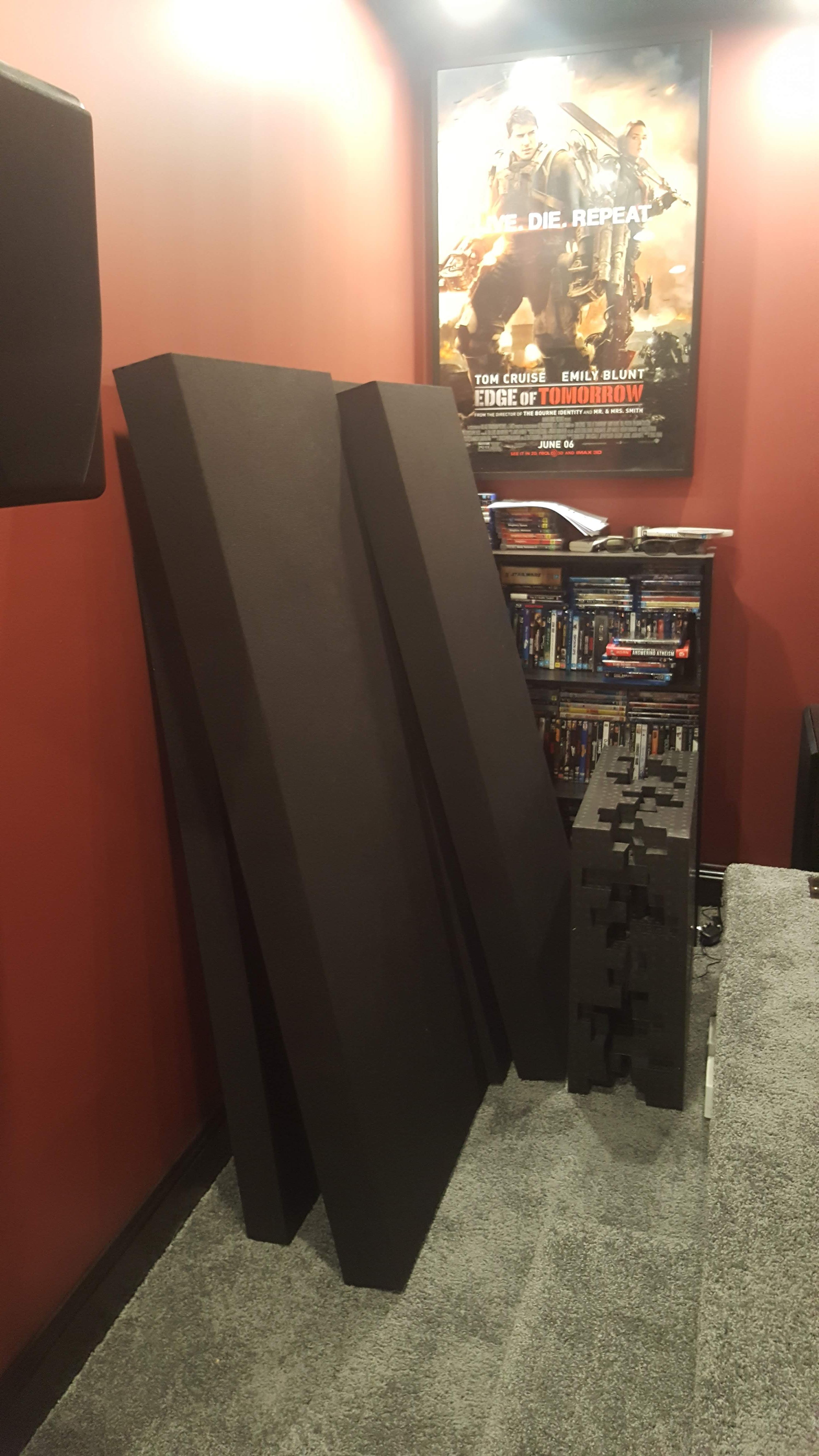

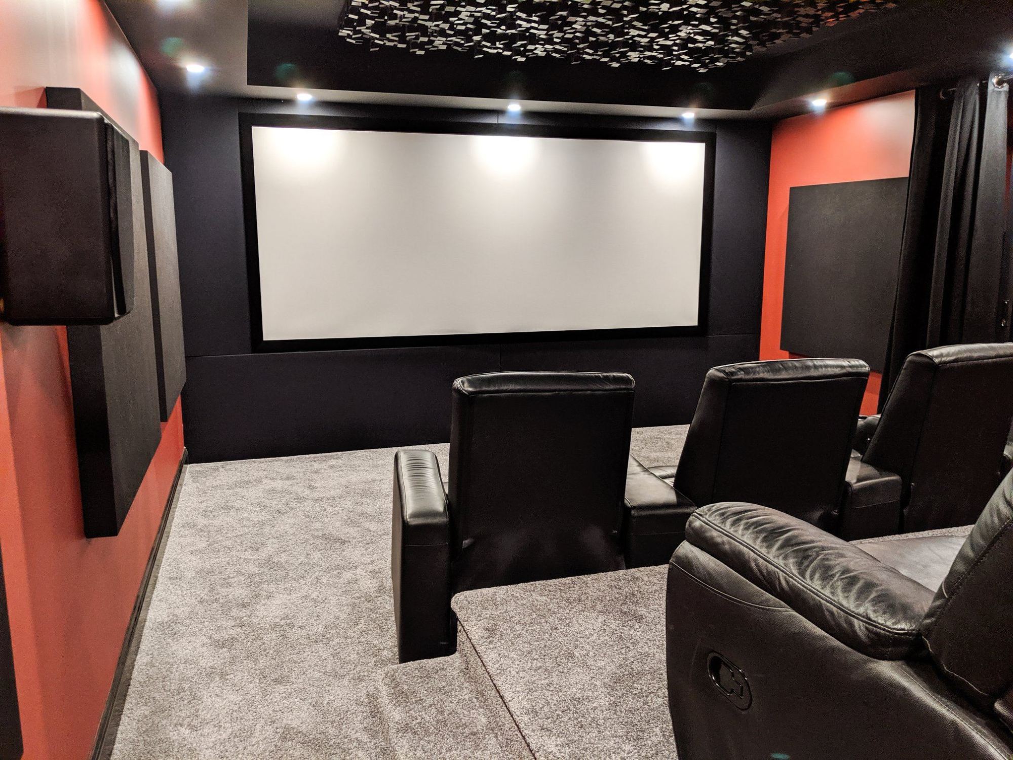

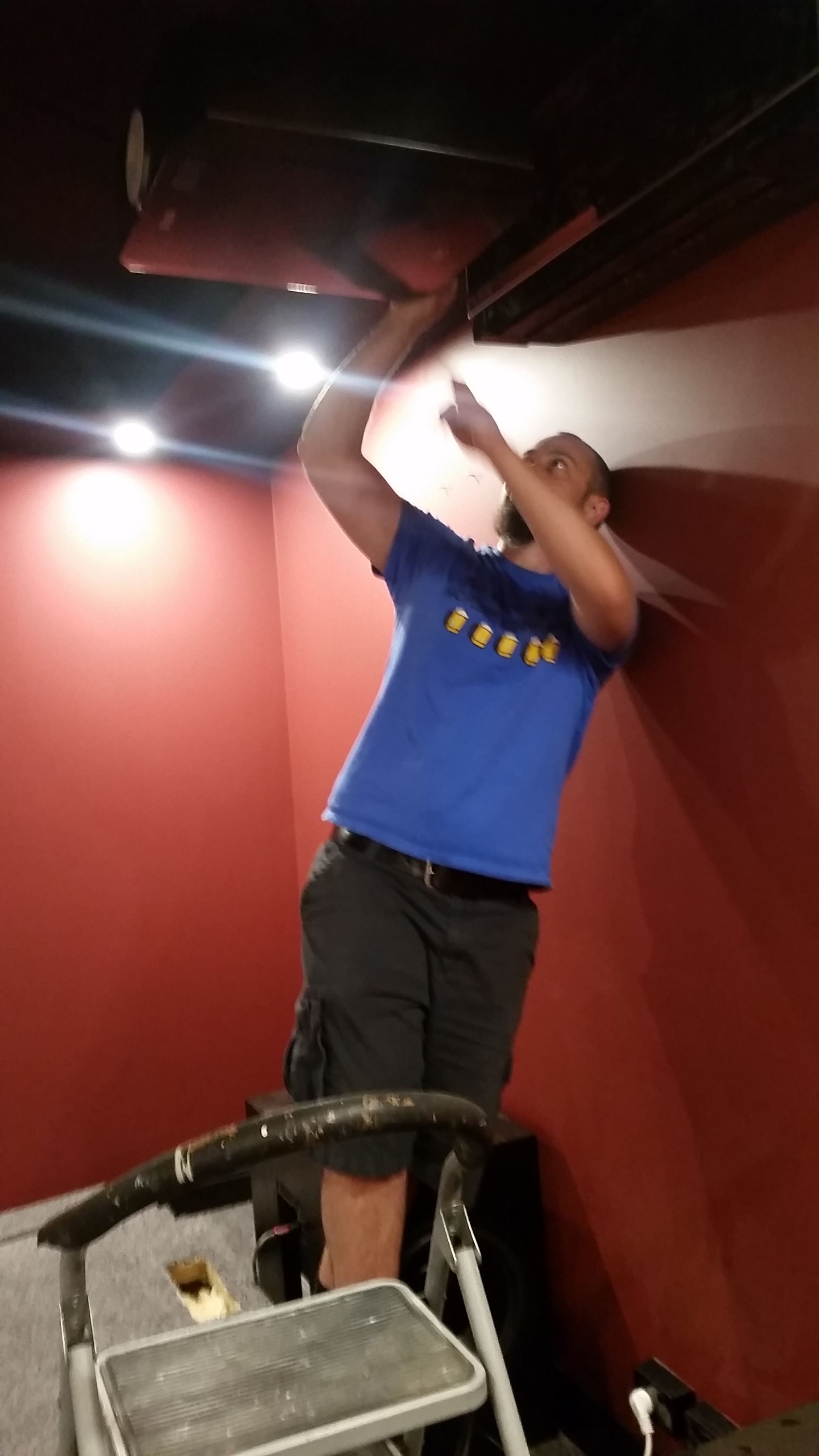

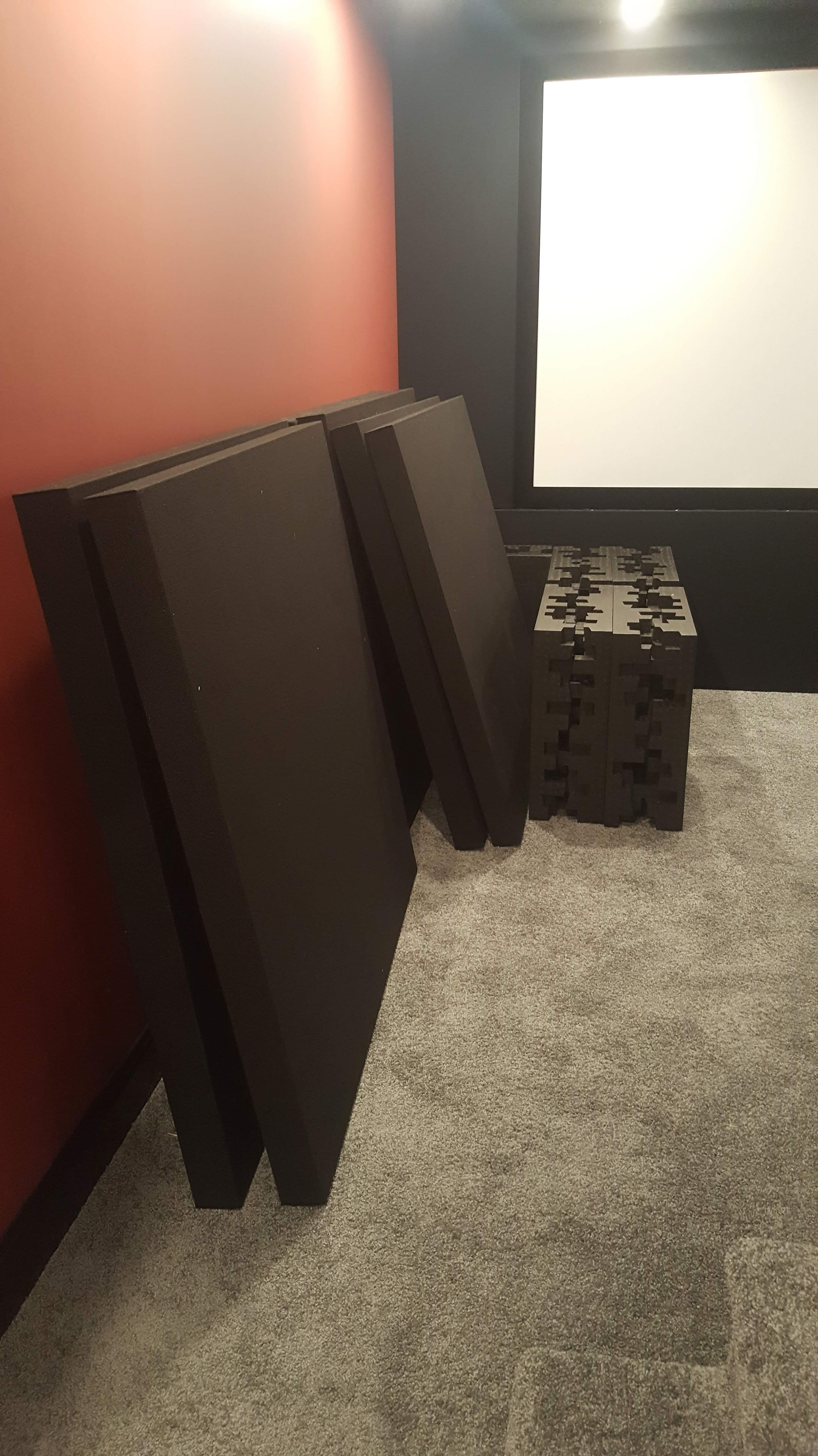

So according to Nyal, he spec'd me an acoustic plan.
So i reached out to Gordon Rosario from Acoustic Vision and he recommended me a mix of panels from Quest AI, RPG BAD panels and Vicoustic DC2 diffusers.
I ended up getting  -
5 Quest AI Q-Fractor Hybrid panels - Absorption/Diffusion and Reflection.
2 RPG BAD Panels - Absorption/Diffusion
Vicoustic DC2 Diffusors.
I was absolutely GOBSMACKED! at the difference it made to the sound. Clarity was increased by a ton!, channel separation was insane!.....I could hear sounds coming from places where there are no speakers!!! LOL.
One of the biggest differences i noticed was how big the soundstage became....it felt like the walls were removed and room just sounded waaaaaay bigger. Ive always heard great things about Quest panels from AVS Forum as they are very popular there and I remember Dennis Erskine would mainly use thieir panels for all thier builds. Overall i  was absolutely wrapped with how it sounded.....and it was definetly one of the biggest upgrades I have made to date.

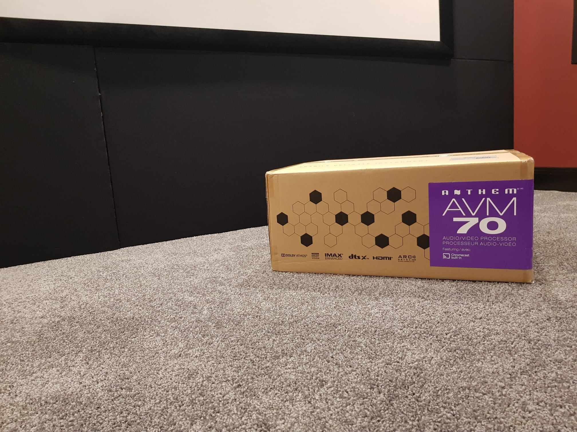

Upgraded from the Integra 80.3 processor to the Anthem AVM70 back in April 2021
Pretty substantial upgrade in overall sound from this upgrade! 🙂
ARC is awesome and so much better than Audyssey!.

Final pics of the theater 🙂

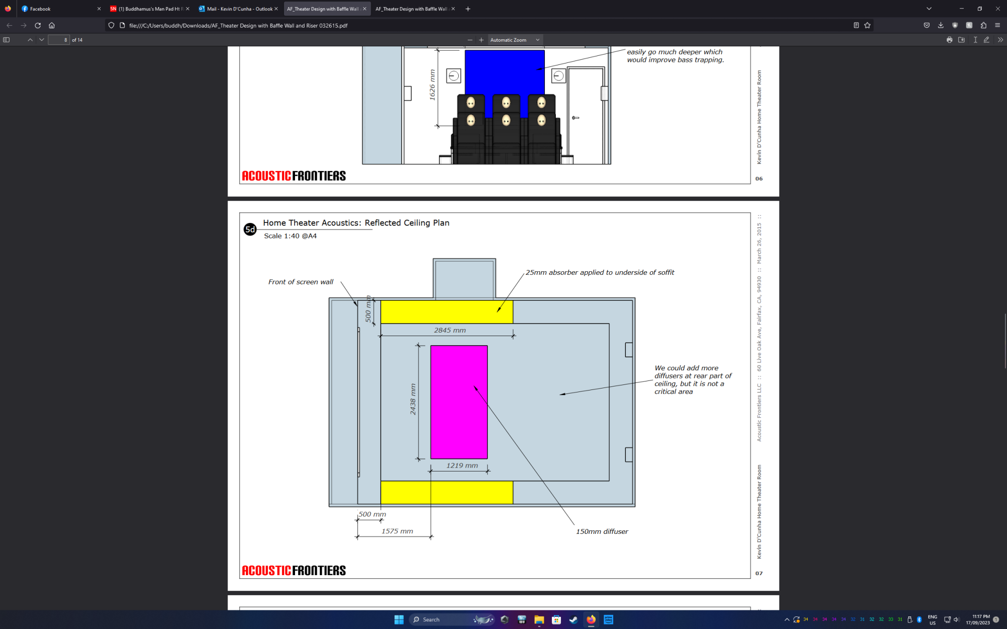

Great thread!
just wondering what the layout of the treatment is?

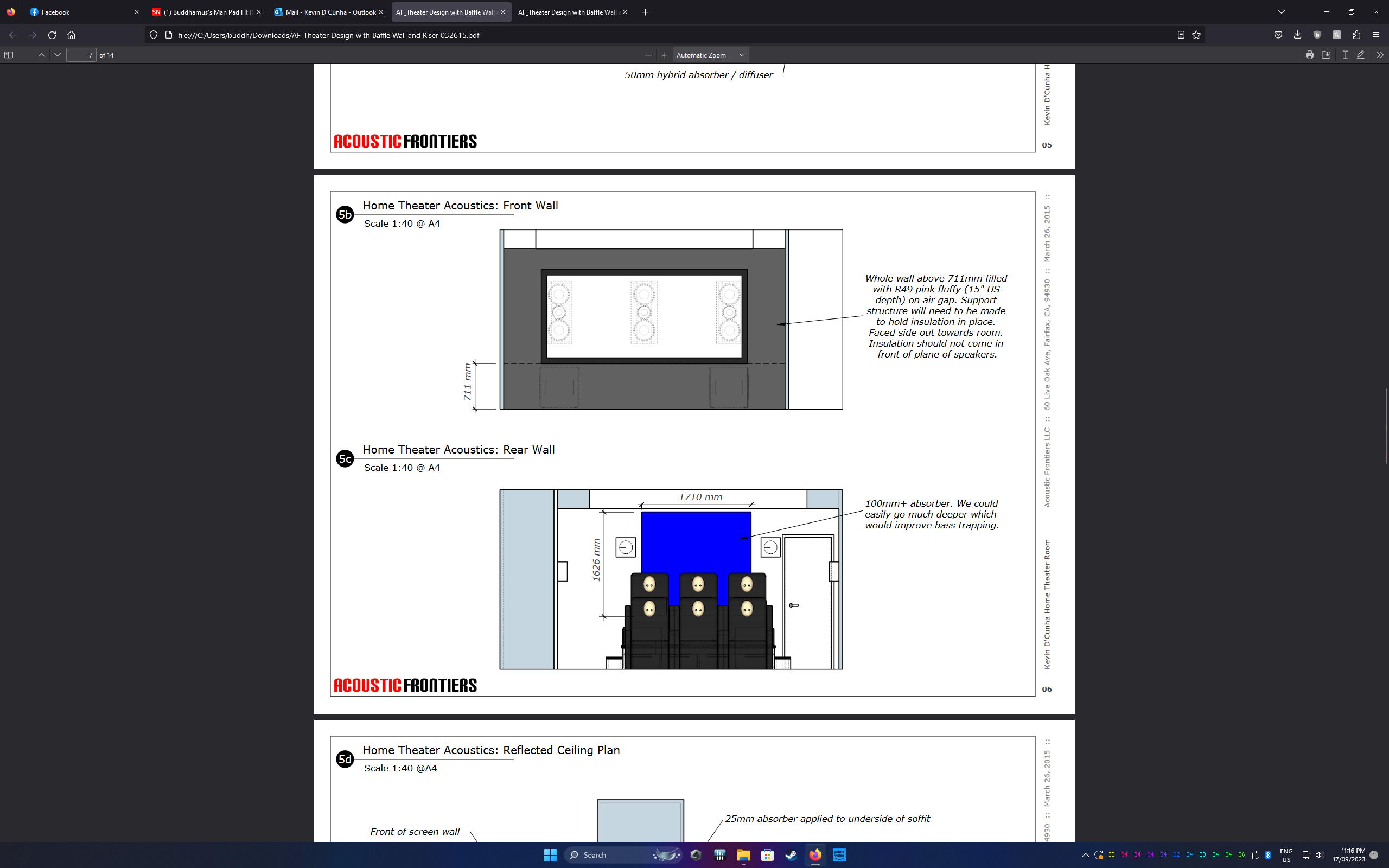

2 minutes ago, frednork said:
Great thread!
Hey Fred,
Thanks mate.........ive been very lazy updating this thread but never the less the HT has always been a work in progress over the years.
Ill see if I can get some pics of Nyals plan and will load them up here for you 🙂

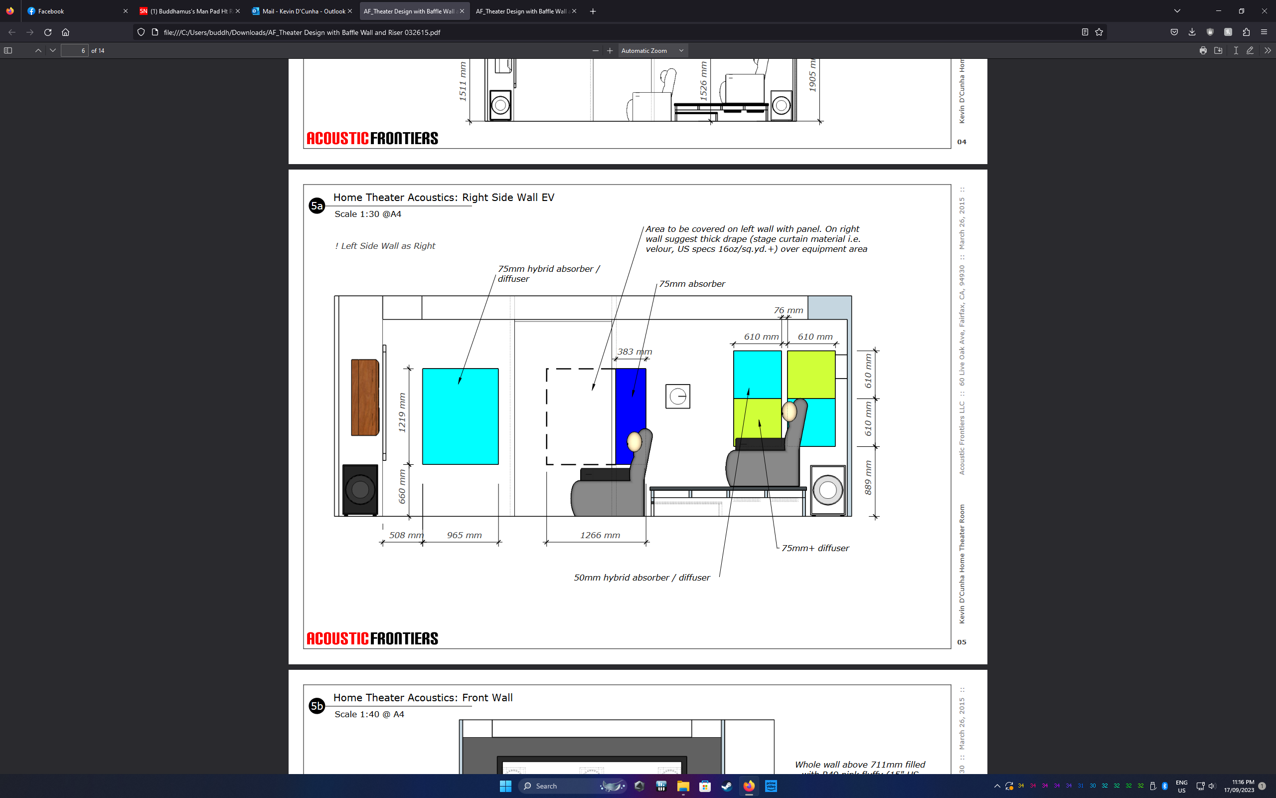

  • Author
Here are some of the acoustic plans which were the older version. No idea where the new version is atm.....ill have to dig through my files.
Anywhere where it said aborber only (ippsilateral points/rear point of the rooms............we eventually changed them to the Hybrid panels.
Edited by buddhamus
forgot to link files
Thanks for that, so BAD's are on the sides nearest the screen?
