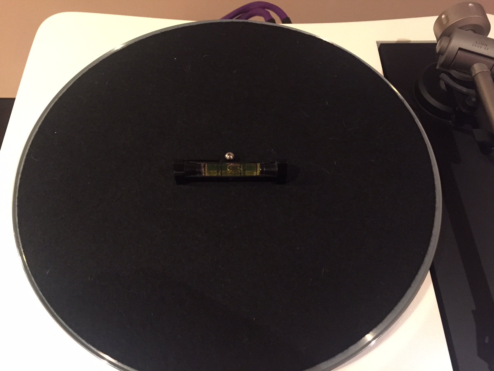

charlie_bird Posted April 26, 2017 Author Share Posted April 26, 2017 5 hours ago, Bilbo said: @andyr I have a few of those but they all suffer the same problem - none of them are accurate. A builder friend of mine has a super duper level with bubble and digital displays that is calibrated. He used it to set levels on our stone kitchen bench tops so I thought I'd take the opportunity to check the spirit levels I have using his as a reference. Unfortunately not one of my levels was accurate and the little ones I was using for TT setup were the worst! I might have to take note of that. Link to comment Share on other sites More sharing options...
Hergest Posted April 26, 2017 Share Posted April 26, 2017 5 hours ago, Bilbo said: @andyr I have a few of those but they all suffer the same problem - none of them are accurate. A builder friend of mine has a super duper level with bubble and digital displays that is calibrated. He used it to set levels on our stone kitchen bench tops so I thought I'd take the opportunity to check the spirit levels I have using his as a reference. Unfortunately not one of my levels was accurate and the little ones I was using for TT setup were the worst! Small (torpedo) levels of the type sold at Bunnings serve no purpose whatsoever as they are hopelessly inaccurate. A good 10 inch Stabila though is accurate to 0.5mm over 1 metre so comes in handy if you have enough room to use it. http://www.stabila.com/products/levels/type-81s Link to comment Share on other sites More sharing options...

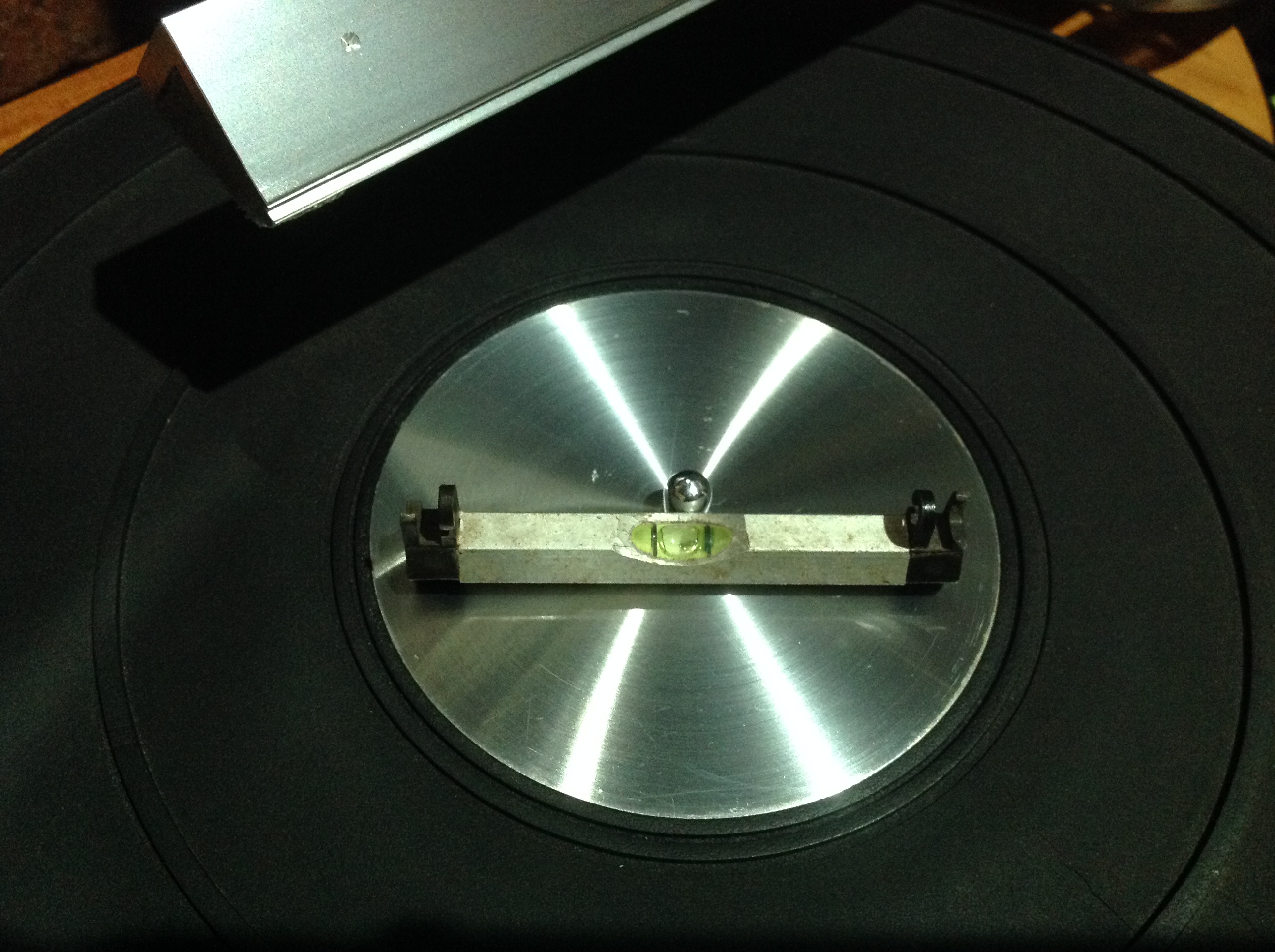

Tasebass Posted April 26, 2017 Share Posted April 26, 2017 1 hour ago, Bilbo said: @Hergest Yes I've seen them at Bunnings and they look good however they are a bit big and heavy at 235g. That's the problem with a level that you can't place over the spindle or is too heavy - they tilt the Linn's suspension. prey tell.....whats wrong with this.... been using this little gem for years as a final inspection and I keep it handy to check when needed...good job i did as i need to do some adjusting... great for setting up a sondek IMO Tase Link to comment Share on other sites More sharing options...
Full Range Posted April 26, 2017 Share Posted April 26, 2017 2 minutes ago, Tasebass said: prey tell.....whats wrong with this.... been using this little gem for years as a final inspection and I keep it handy to check when needed...good job i did as i need to do some adjusting... I have one of those and use it myself Its known as a string line level Did not come to mind until it was mentioned Link to comment Share on other sites More sharing options...

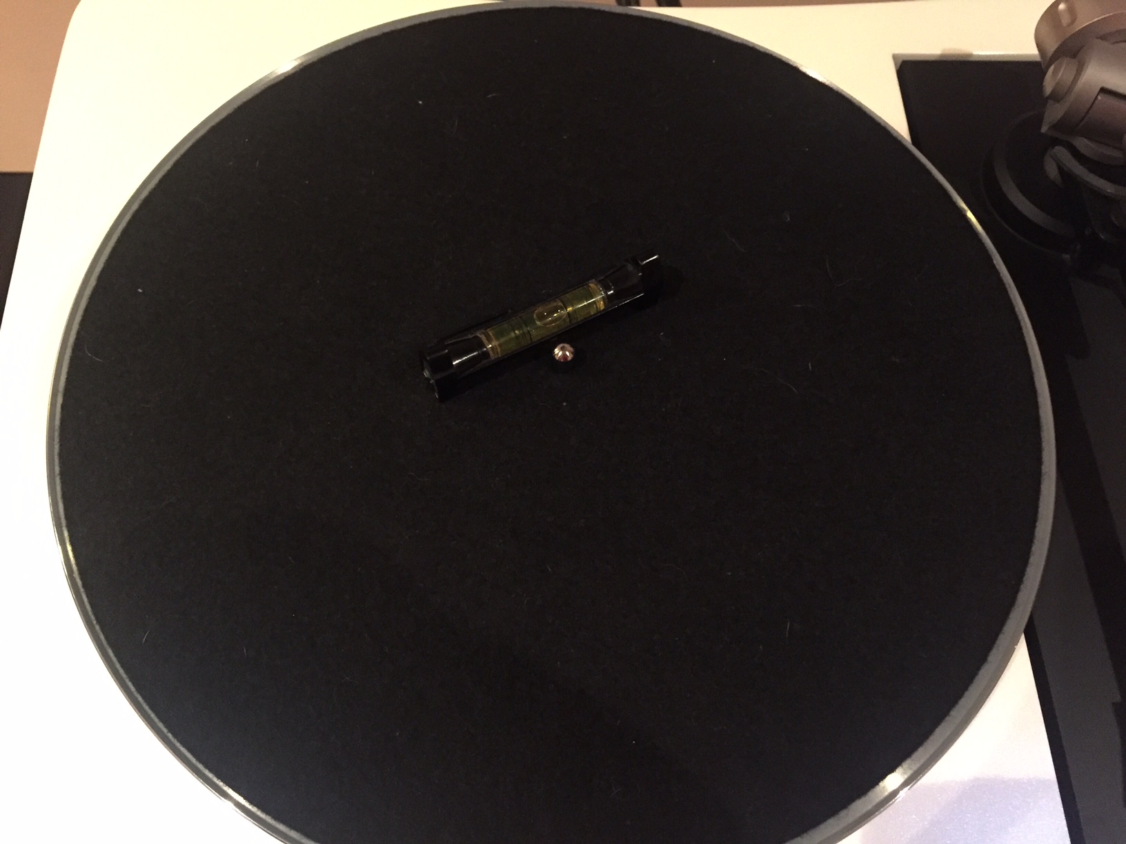

muriwai Posted April 26, 2017 Share Posted April 26, 2017 Sometimes they are a bit inaccurate so always turn 180 degrees and check again the bubble is still in the middle [emoji106] 2 Link to comment Share on other sites More sharing options...
Tasebass Posted April 26, 2017 Share Posted April 26, 2017 (edited) thats what i do...including spinning the platter with the belt off.. On a Sondek the plinth can be level but the inner/outer platter assembly slightly off as I have shown.. and visa versa Edited April 26, 2017 by Tasebass 1 Link to comment Share on other sites More sharing options...
Hergest Posted April 26, 2017 Share Posted April 26, 2017 44 minutes ago, Tasebass said: prey tell.....whats wrong with this.... been using this little gem for years as a final inspection and I keep it handy to check when needed...good job i did as i need to do some adjusting... Nothing wrong with it at all as long as it is accurate. If you want to go really minimalist and lightweight then there's always the option of just the replacement bubble as long as you've got a perfectly level surface to make sure the bubble is centred. This is handy for checking azimuth and VTA too due to it being so light. My laptop clearly needs a wedge under the right side..... Link to comment Share on other sites More sharing options...
Bilbo Posted April 26, 2017 Share Posted April 26, 2017 31 minutes ago, Hergest said: Nothing wrong with it at all as long as it is accurate. If you want to go really minimalist and lightweight then there's always the option of just the replacement bubble as long as you've got a perfectly level surface to make sure the bubble is centred. This is handy for checking azimuth and VTA too due to it being so light. That's the point - it has to be accurate. I actually have 4 of them. None of them are accurate. I have tried sanding down the plastic casing to adjust them but it does not help. When flipped 180 degrees they are still out. I therefore suspect the glass vial itself is not perfectly cylindrical. Link to comment Share on other sites More sharing options...
