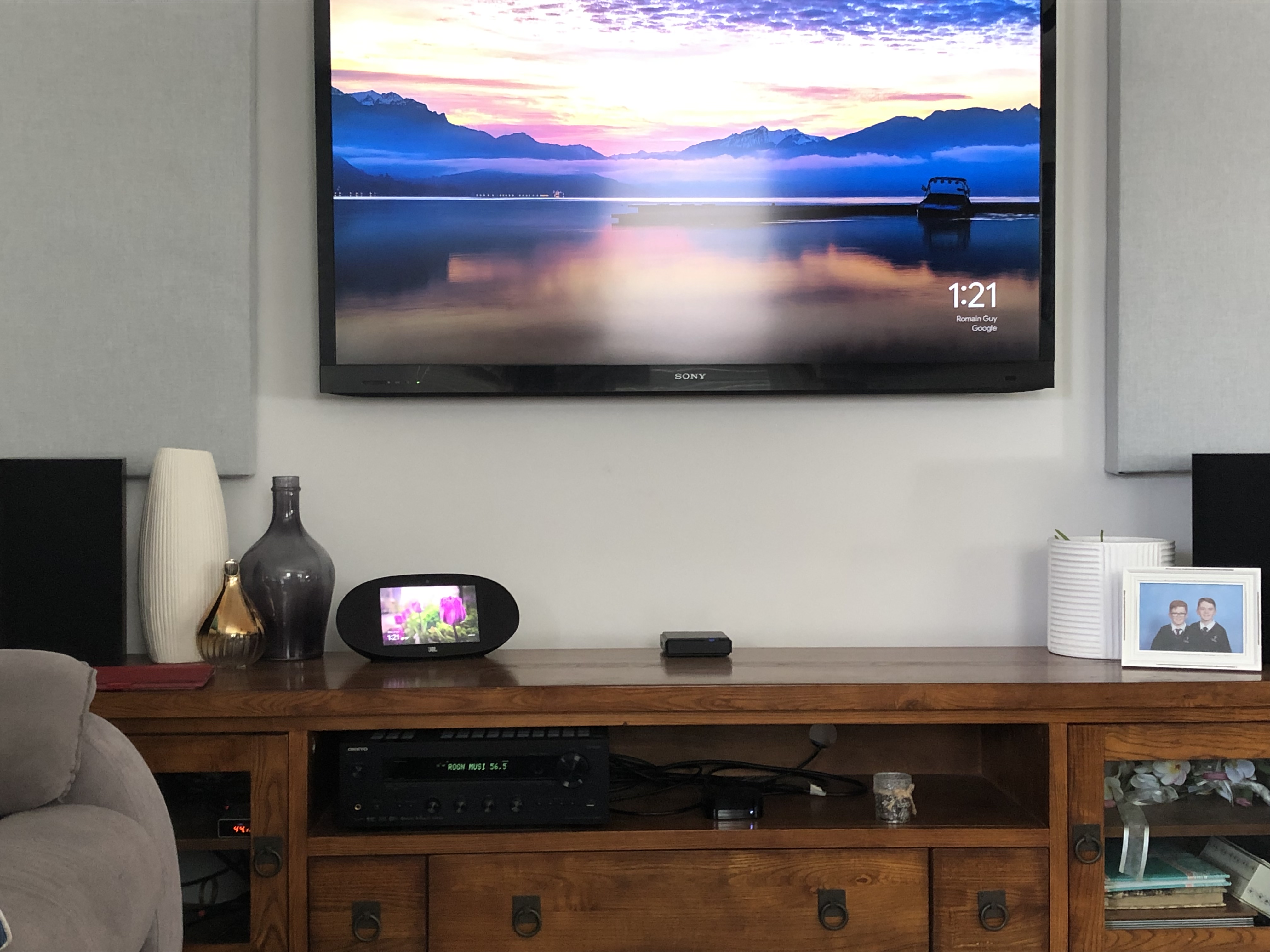

  • Author
I’ve got Dirac working beautifully for multichannel sources, multichannel music played via Roon is breathtaking.
I’ve given up on 2 channel and resolved by moving 2 channel equipment to lounge room. Can’t beat a Roon streamer into a dac and into an integrated amp.
I blame the Integra for the poor 2 channels performance and not Dirac.
It still amazes me and intrigues me on how complex multichannel music is to get and play but to me is still easier to get incredible sound over 2 channel.D2C46D81-75B6-4C90-87B0-C099A1449140.thumb.jpeg.3c87ed71c33b0db4e56f82989c9a2e5a.jpeg

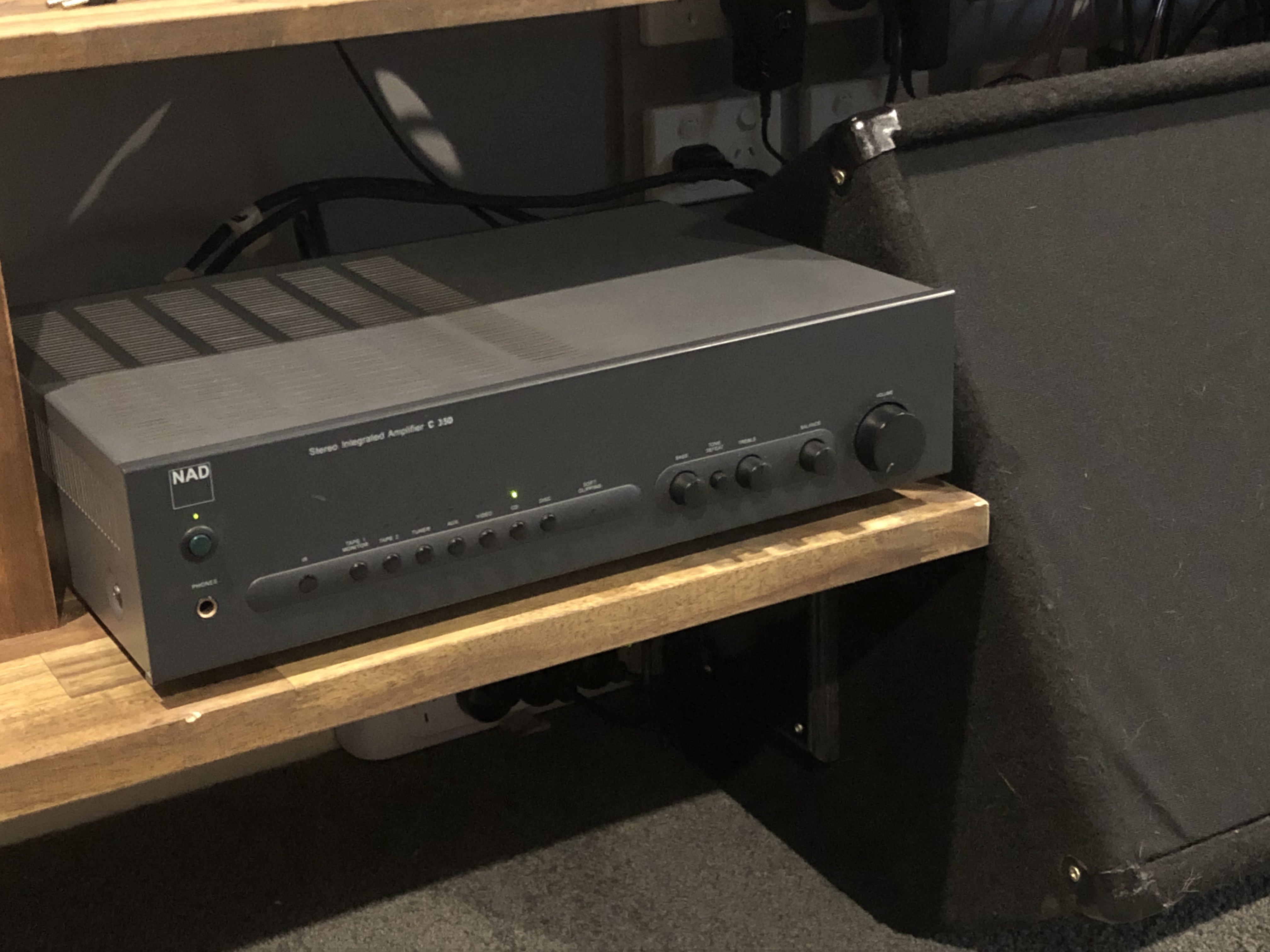

  • Author
This has resolved everything. A NAD C 350 for $250 used as a power amp so I have pre out L/R from avr into Main In on NAD. Had to lower the front levels on the front speaker avrs speaker level settings dramatically so NO more distortion noise.
Since I have the link out on the nad for the main to preamp can I connect a y cable so I can connect the avr to main but still have a connection from main to pre amp of the nad ?464459D8-6509-4348-9732-ECD2F4FDB0E3.thumb.jpeg.0a5788a52791f48c92a2acee23989480.jpeg
  • Author
Forget the y cable thing, I tried using as an integrated amp but sounded ok, no subs connected and would mean too much work and extra cables to do it.
Connected my dac and roon back into avr, took links back out if Nad and connected back to main in and Wow, this Nad is a great power amp, of course it’s now benefiting from the INTEGRA 3.4, dual subs and Dirac and that’s pretty damn fine.
