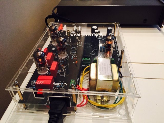

Have just ordered LB T10 with the Toroidal trans.  (Whatever difference that makes).  Going to put it in the 2nd system initially since it has MMs and no separate phono stage (yet).
(Reply delayed cos I was not 'notified' of your quote).
  • Author
I hope you have a good experience with the T-10 like I have so far :). I'm looking at tube rolling mine to see what kind of different sound I can get out of it. Just to experiment a little. I haven't had any experience with NAD, do you rate them?
  • 3 weeks later...
I rate NAD as the best I could afford that I had access to way back when, and the story is still similar.  Built down to a price can be a problem.
Back to the bear.  It had some hum so I did the 'first tube foil mod' as on VinylEngine so now I have a buzz but higher than listening level on that system.  I drilled a hole in the top plate so I could access the change Gain switch easily.
Besides that it's a bloody revelation and if this is tubes then it should be a bloody religion.

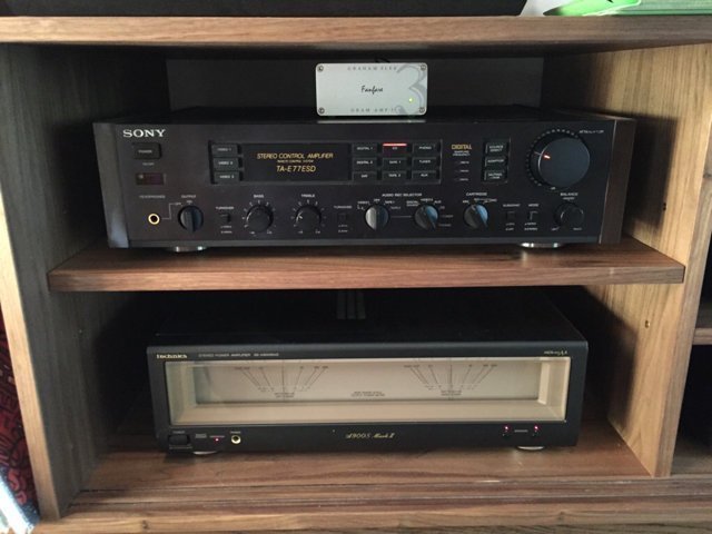

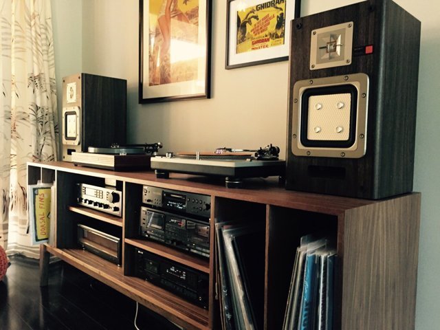

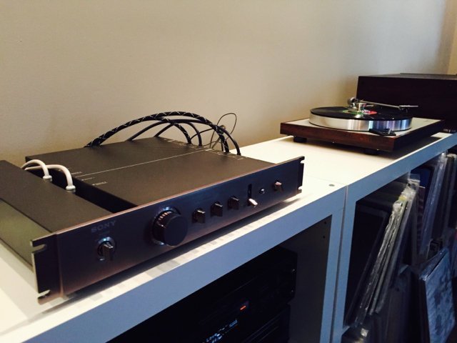

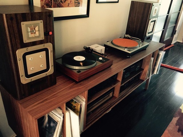

Finally back in Oz. Some quick snaps of the finished lounge set up. When I say finished I mean "for now" :).
Lookin good :)
  • Author
Cheers mate :)
Stuck the LB Phono with my MC setup.  Just turned the Gain to High and it worked fine.  If you get the chance I'd be interested in how that compares to using their Stepup T8.

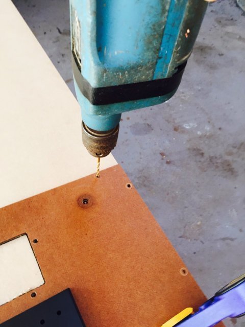

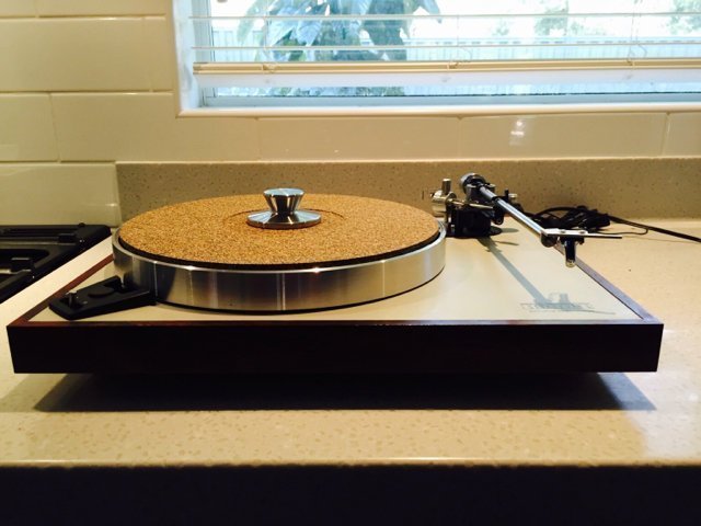

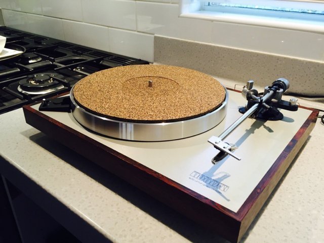

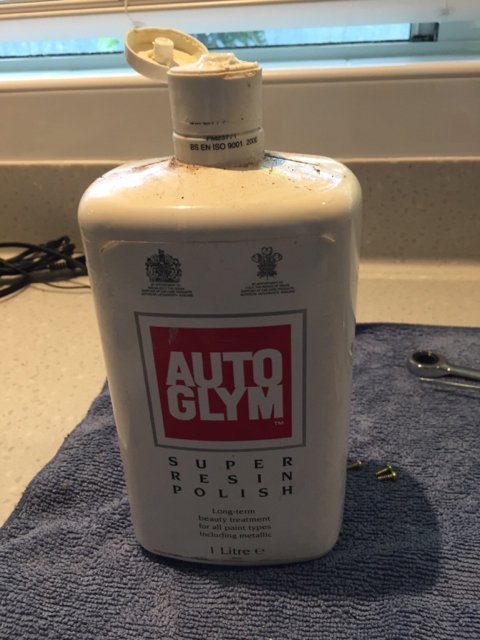

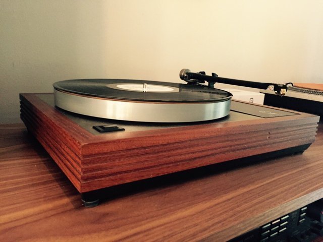

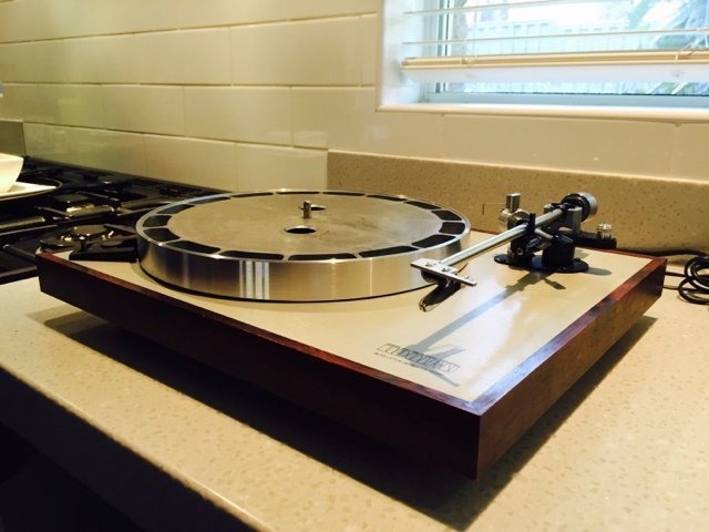

Been busy today.. Time to give the Luxman a birthday :)

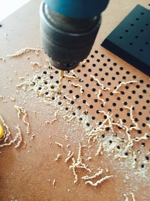

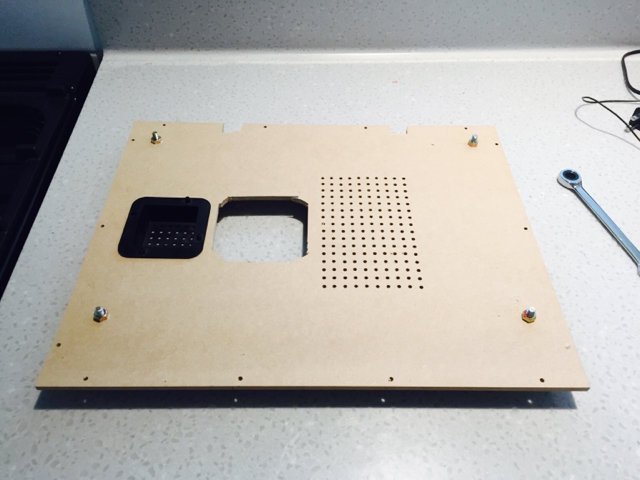

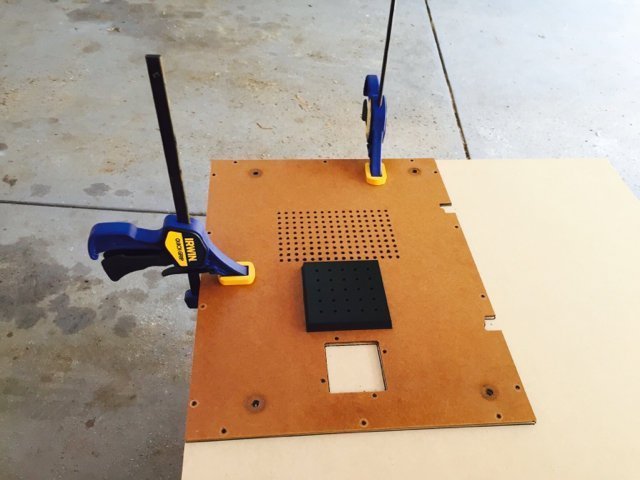

Pulled the flimsy base off and used as template.
Drilled the holes through the old base to keep everything straight
Used a jigsaw to cut out the 6mm MDF
Re-installed the feet. I will probably install some chrome spikes soon.
Polished the platter and plinth with Auto Glym high resin polish

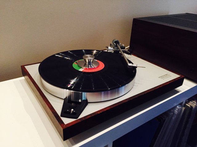

And here is the final result
  • Author
Time for a test run... There is definitely less brightness coming from the speakers. It sounds much warmer through the T-10 too. Much more middle end presence

Ah, the Little Bear MM stage, it should sound pretty good, the circuit is a copy of the EAR MM circuit from what I have read.

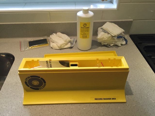

Okey dokey, time for my promised report on the spin clean I bought a few months back. I finally had a little time to unbox and check her out
I actually read the instructions

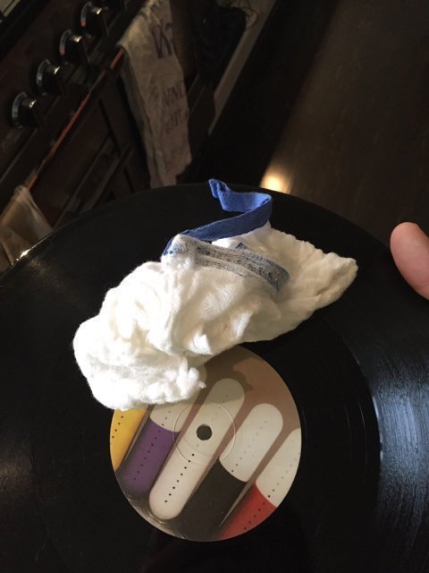

Pre cleaned the drying cloths, then made a start on a few records. Set up is super easy.

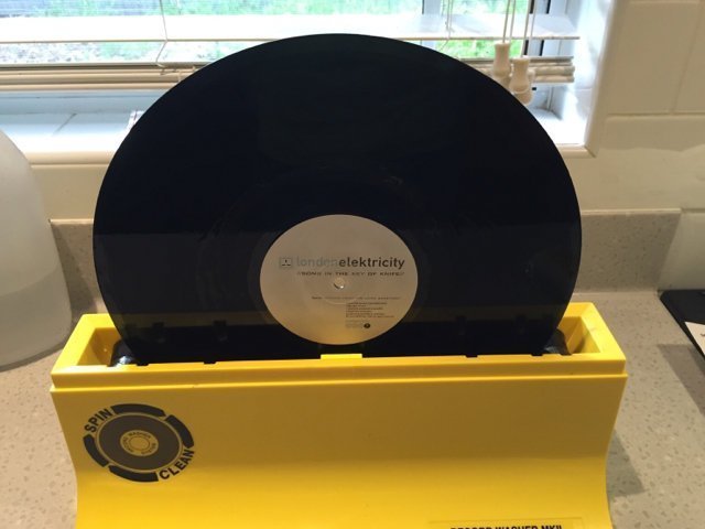

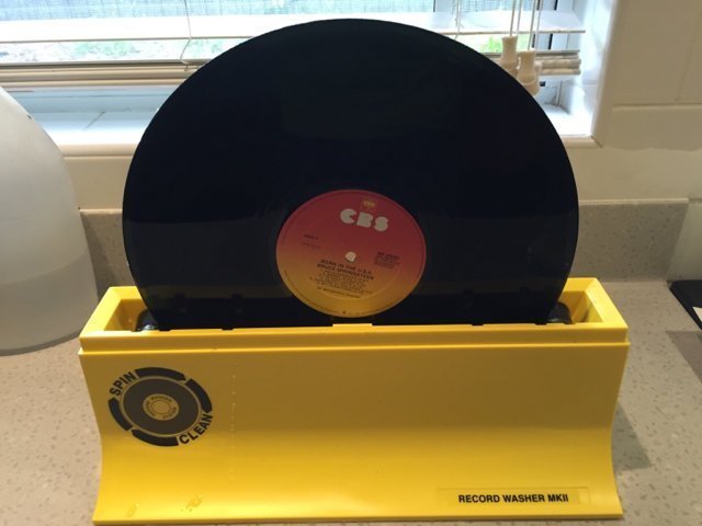

1st up I have a couple of records donated to me from a friend who picks up crates of wax at auctions. There were two Bruce Springsteen LP's in terrible shape. I had previously hand cleaned and attempted playing with no success. The records sounded terrible with heaps of Echo and scratchy ness. Anyway, I slotted "The River" into the spin clean and gave it a "spin", removed, dried and popped it on one of my SL1200's.
As I let "The Boss" play I moved on to some old 12" singles which have had a hard life on DJ sets
Meanwhile The Springsteen record played through from start to end clear and without echo. Very encouraging... :).
I ran about 15 of my crappiest 12"s through the machine. The instructions say that 20-50 records per solution is ok, but after 15 of these records the water was filthy with lots of particulates.
I emptied the mixture, cleaned the pads and unit. Refilled and recommenced cleaning. With records in better condition 20 per solution was no problem. I wouldn't go more just due to the amount of particulates floating around in the water.
I have to say that every record I cleaned and played sounded much much better post cleansing. Definitely worth the money spent
