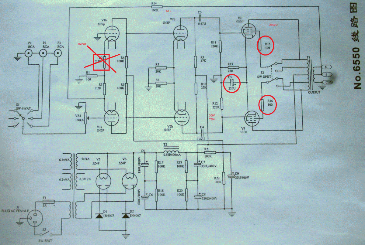

Equaliser Posted March 14, 2015 Posted March 14, 2015 (edited) Here's a direct link to Lukaz's lampizator website which already includes his posted pictures of internal shots and corrected schematics. I've repaired, rebuilt two of these (one with better parts which kept going on fire and the other was to test different biasing methods as it's using an electrolytic to fix the bias - not ideal) and so far the 300B and KT88 Bewitches I've come across, heard and seen power transformers not within spec blowing up with open windings after any of the tubes short to ground or go arcy sparky. First thing I would do is pop off the bottom panel and see what the damage is, observation is key here, could be anything. Could also be a faulty or failing tube that just gave up. Edited March 14, 2015 by DefQon

Equaliser Posted March 14, 2015 Posted March 14, 2015 (edited) Ops forgot to post link: http://lampizator.eu/AMPLIFIERS/CHINA/bewitch%206550/Bewitch.html Thought so. Only two reasons why a tube would fail, failed resistors around the tube area (for many reasons too) or a faulty tube. The damage doesn't seem that bad, just simply replace parts with same value but higher wattage rated and that's it. When I did my rebuilds, the stacked el cheapo ceramic 5watt 750ohm resistors (the white ones that have imploded in your picture but your values look to be 560 ohms?) should always be a minimum 15watt chassis mount resistor as these get very hot. If you're replacing it with wirewound or ceramic avoid Mills resistors, they are craptastic with there ratings and fail earlier then the spec'd power heat dissipation factor. Briefly looking at the schematics, the burnt 2watt resistor you marked 3 should be 2.2kohm, cap 5 is a 220uf/50-63v rated low ESR cap which is part the fixed bias circuit, replace these with 63v rated 220uf non audiophile caps, i.e no Nichicon muse or Elna Silmic's as they will be useless here just go for some Panasonic NHG's or Rubycon ZL's (both for there ripple ESL and ESR characteristics). Depending on where you are located I may be able to fix/test the amp for you free of charge and I've had experience rebuilding these buggers to "proper spec" and not the weird circuit schematics the amp designer made manufactured these amp's on. Edited March 14, 2015 by DefQon 3
lovetube Posted March 14, 2015 Posted March 14, 2015 Hi David. look like cathode resistor have fail . 5 watts resistor is too small for the cathode of the KT88 in the first place . so issue look like around the output stage only good luck getting it fix Duc
Equaliser Posted March 14, 2015 Posted March 14, 2015 Speaking of failed cathode resistor for the input tubes, what tubes are you running in the amp?
lovetube Posted March 14, 2015 Posted March 14, 2015 (edited) On 14/03/2015 at 11:26 AM, DefQon said: Speaking of failed cathode resistor for the input tubes, what tubes are you running in the amp? I was refer to the output valves cathode resistors have failed and what i can see is the two parallel resistors to get the value they want to bias the output valves . even two in parallel is still too small wattage to bias the two KT88 or 6550 . also there is other small resistor that fail which i can read but it might be in the output valves grid leak . if it haven't took the output transformer with it then this seem quite easy fix and won't cost an earth . Duc Edited March 14, 2015 by lovetube
Equaliser Posted March 14, 2015 Posted March 14, 2015 Now that've looked at your post and the schematic it makes more sense. From a glimpse looks the resistors have failed on the input driver side for the 6n9p's.
Prana69 Posted March 14, 2015 Author Posted March 14, 2015 On 14/03/2015 at 11:18 AM, lovetube said: Hi David. look like cathode resistor have fail . 5 watts resistor is too small for the cathode of the KT88 in the first place . so issue look like around the output stage only good luck getting it fix Duc I noticed that the resistors in my KT-88 are "560" whereas in Lampizator's they are "750". I assumed that was just due to AU v EU voltage differences. On 14/03/2015 at 11:08 AM, DefQon said: Depending on where you are located I may be able to fix/test the amp for you free of charge and I've had experience rebuilding these buggers to "proper spec" and not the weird circuit schematics the amp designer made manufactured these amp's on. I am located in Mordialloc. I love this amp and am prepared to travel to get it fixed, and properly set-up. I am happy to pay a fair price to have it fixed. I don;t expect anyone to work for free. On 14/03/2015 at 11:26 AM, DefQon said: Speaking of failed cathode resistor for the input tubes, what tubes are you running in the amp? I bought this from another SNA member a couple of months back. I believe he upgraded the tubes. Here is the link to the advert which identifies the tubes: http://www.stereo.net.au/forums/index.php?/topic/77157-bewitch-kt-88-integrated-valve-amplifier/?hl=bewitch And just let me say, the seller was brilliant and I do not in any way want to imply that he sold me a dodgy unit. It has worked flawlessly from when I got it and he was very helpful in the initial set up. Thanks David

Prana69 Posted March 15, 2015 Author Posted March 15, 2015 On 14/03/2015 at 11:02 PM, ehtcom said: Here's how I see it. The output tube(s) has failed and become partial internal short circuit between the plates. (the sparks) This then has created a direct path from HT supply voltage through the output transformer, partially shorted output tube, cathode bias resistor(s) to ground. The cathode bias resistor has failed due to excessive voltage/current (overheated then fused). As HT voltage was present across the cathode resistor, the bypass capacitor has also failed (bulging cap). Also exessive current was drawn through screen grid two burning out the 100 ohm resistor near the switch (arrow 3). Bin all the output tubes and replace them with Russian built KT88/6550 (Tungsol 6550 are very good). All KT88 tubes out of China are rubbish and have a 30% chance of failure. (Edit. The early Russian built Gold Lion KT88 had a few issues too) There is a chance that the output transformer may have been damaged. It needs to be checked and measured. The good news is it was still conducting when the resistor fused, but it may have developed shorts between the windings due to insulation meltdown. It needs to be measured for resistance at high voltage. (using a megger), impedance, and frequency response. Mods that need to be done. Whilst it's okay for 6V6, EL84 and EL34 tubes to use a common cathode bias resistor, this should never be done with KT66 or KT88 type tubes. (Yes, it is a design fault) The circuit needs to be modified so each output tube has it's own resistor and bypass capacitor. 560 ohm 10 watt to 25 watt with 100uf to 220uf 100V bypass cap for each will do. The power transformer needs to be checked as well as the rectifier tubes. They too were stressed during the meltdown. I'm happy to do the work, but must stress that I'm super busy and will take at least 3 to 4 weeks to get around to repairing it. Cheers, Earle. Hi Earle Thanks for the offer. Given this amp really needs a major over-haul, I will definitely be coming to see you. 3-4 week turnaround is fine. I will PM you to get your shop details. I'm in Mordialloc so a cruise down the P link will be easy. Thanks everyone for your feedback, troubleshooting and insights. David 2
Guest Muon Posted March 16, 2015 Posted March 16, 2015 Must say, I have never seen a single resistor shared for cathode bias use :blink: Maybe In just don't look hard enough
Equaliser Posted March 16, 2015 Posted March 16, 2015 The circuit isn't optimized. It's a weird one with some omissions that can easily be fixed but at least the amp isn't the typical Chinese SRPP.
