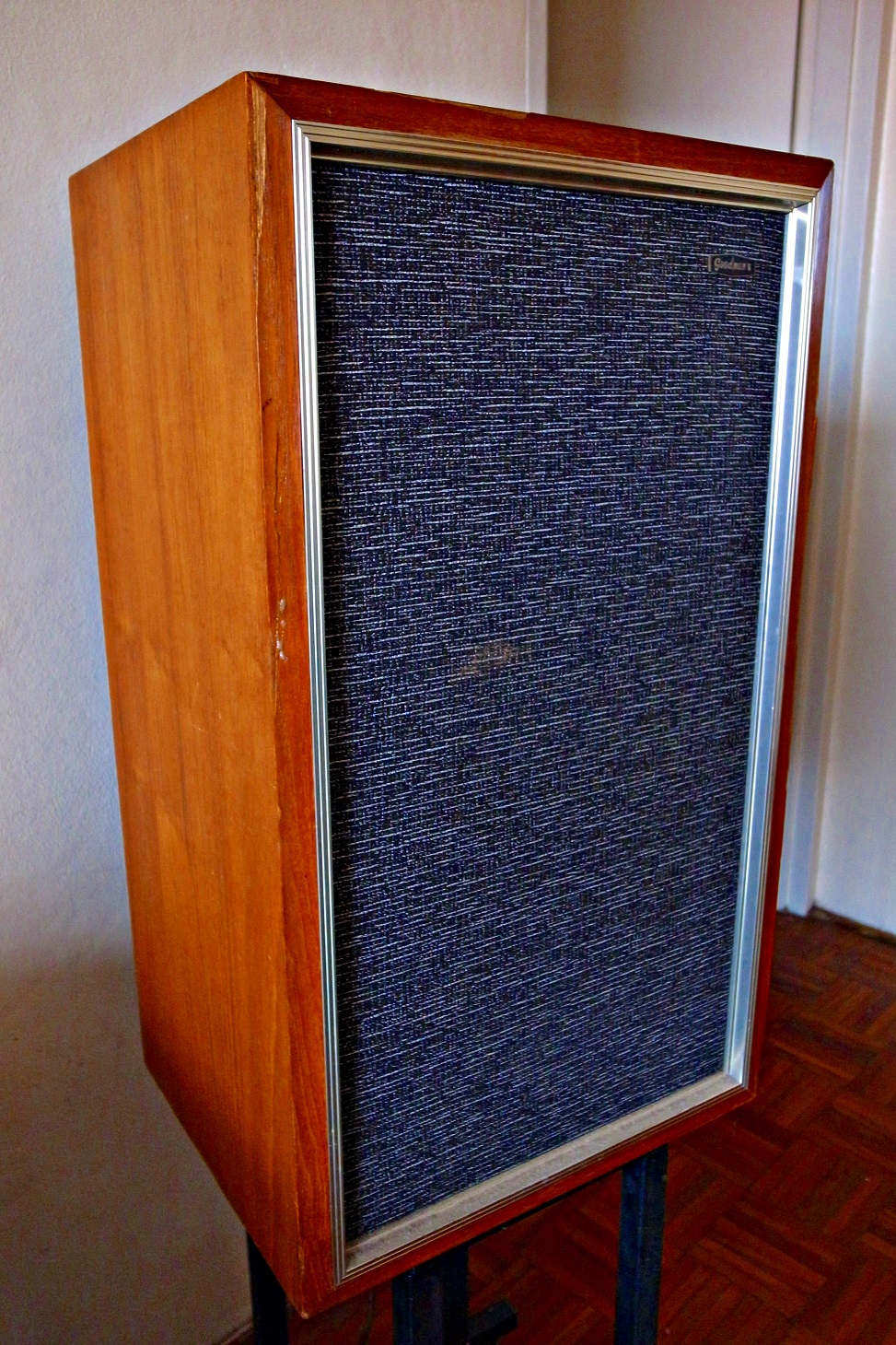

In some ways, this review begins not with the amplifier but with my old Goodmans loudspeakers. About 18 months ago I bought a pair of rare old Sony APM 77w loudspeakers , and for the first time in some 15 years, returned to solid state (my SNA review of those speakers is available here: http://www.stereo.net.au/forums/index.php?/topic/54752-sony-apm-77w-vintage-review/).
My change of direction made me wonder what I was going to do with my old loudspeakers -  a  pair of 50 year old Goodmans Axiom 301 “full range†drivers, and Goodmans DLM compression horn tweeters - which I had paired with a little EL84 based single ended amp. For those who are not familiar with the Goodmans 301, they are massively sensitive 12 inch 60s loudspeaker which, at least to my ears, are capable of an amazingly enjoyable, “fast,†warm, albeit coloured sound. The DLM 2 tweeters are a bit more of an unknown quantity to me – there is very little information available around on these. But, according to the specification, they stretch out to 35khz, which seems amazing for such an old design, and they certainly add some zing and detail to the somewhat ragged and limited treble of the 301s. These drivers were mounted in what looked like an original 60s cabinet, but arranged quite differently from the traditional Goodmans specification, which usually mandates a large cabinet paired to a Goodmans Acoustic Resistance Unit. Against this usual arrangement, my Goodmans are mounted in a relatively “small†infinite baffle enclosure (approx 65cm x 35cm x 30 cm). While there is predictably a lack of low bass, the bass is dry and taut, which is my preference. And they still run off a handful of watts, despite the infinite baffle design.  Importantly, the Goodmans have a talent for playing jazz and acoustic music in a way like few others I have heard before – with a fatigue free authenticity that makes things believable, even if you are always aware of their limits. Its a sound that I have found hard to live without – hence why I have had these Goodmans for over 10 years.

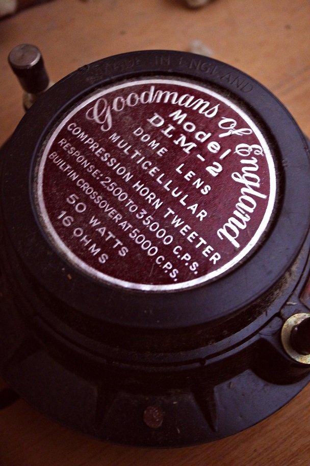

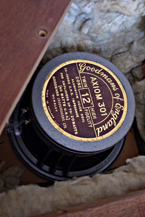

There are a few reviews on SNA of Australian built McChanson valve amplifiers, but none on the 6AS7 model. As such I thought I would write this short review on my experience with this amplifier, which I have now owned for a year.

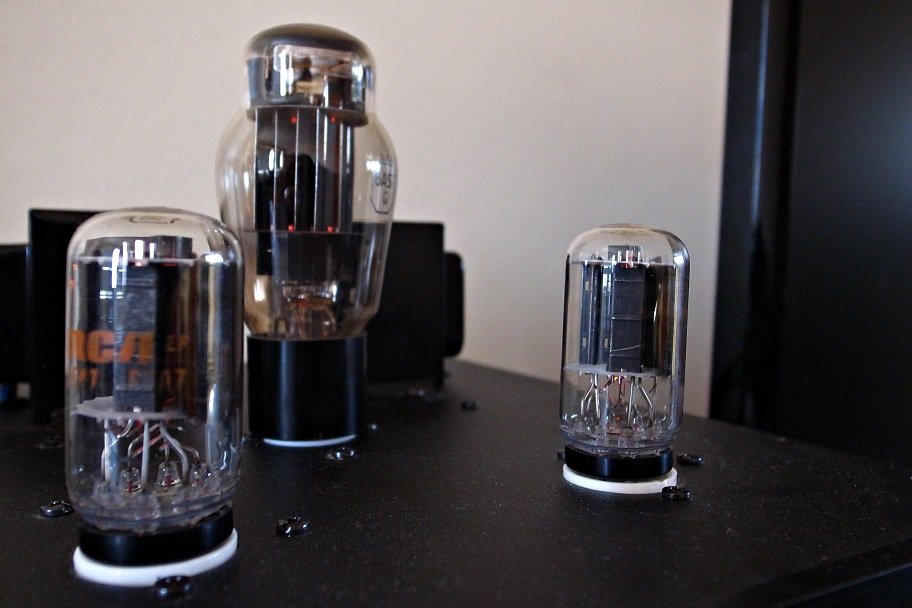

I had become curious about triodes. I had been aware of the Sydney built McChanson amplifiers for a few years, in part because I came across Eric’s guitar amplifiers before, which I had considered (I play in a baaad garage band on weekends). In an ideal world, I would set aside $5000 or more to buy a 2A3 (or similar) amplifier, which would be specified with high end components. But I don’t have that sort of money to spend on an amplifier at the moment. I was aware that McChanson amplifiers were built to budget; however there was a no frills honesty about Eric’s designs that I found appealing, an honesty I should stress was reinforced in my own dealings with Eric when I purchased this amp. (Like other users, I barraged poor Eric with many questions before I committed to buy, all of which he painstakingly took the time to respond to in his modest and careful way). I had originally been interested in asking Eric to construct a 2A3 based amplifier for me, however this 6AS7 design really intrigued me, and Eric kindly offered me a free demonstration.
The amplifier features two 6EM7 as a two stage driver tube (this is direct coupled between stages). A single 6AS7 is used for both channels of the output stage, with a plate choke and Russian paper in oil coupling capacitor. The amplifier’s power supply is rectified with a 5Z4P. The amplifier uses McChanson’s “timE†output transformers. (It can be specified with the higher end “marzE†output transformers at higher cost). My amplifier has been fitted with a stepped attenuator, rather than the standard ALPs pot that comes with Eric’s other amps. The amplifier is a little unusual compared to other triode designs, although not without precedent; the Fi 421a uses a very similar sort of configuration (see http://www.6moons.com/audioreviews/fi6/421A.html) although that is, of course, a much higher end device. The McChanson 6AS7 SET is still available for under $1000 AUD via ebay.
The appeal of this amplifier to me was the ability to roll tubes at low cost. Both 6EM7 and 6AS7 tubes are cheap and plentiful, and even the special variants of the 6AS7 type – with the exception of the Western Electric 421A – are still reasonably accessible. Having a single valve for the output stage significantly reduces the cost of experimentation. Its been a real blast to scour ebay for 6AS7 / 6080 types, knowing that I only need to order one tube. This is certainly a much cheaper route than a 2A3 /300B / 45 triode amplifier, where at least two power tubes are required, and usually tubes come at high prices. Indeed, in terms of tube rolling fun, this 6AS7 amplifier seems to be a cheaper route than other SET options, such as a triode strapped EL84, which I was also considering.

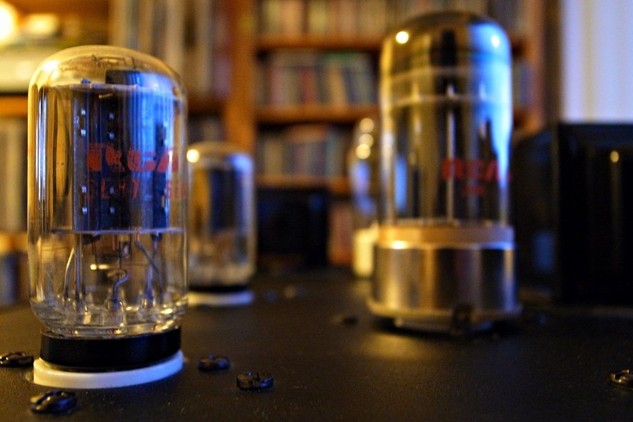

Valve rolling has been, as predicted, amazingly fun. The “Winged C†6AS7 the amplifier came with actually sounded wonderful – open, with a slightly dark sound. The RCA 6AS7 is even darker, although it does something magic to some records, particularly voices. The amplifier will also use 5998 types, which sound different again. I am not sure if I will ever try a WE421a in this amplifier, although I have used a Tung Sol 5998, which is very detailed, although a touch bright. My favourite tube so far has been the GE 5998a, which seems to work perfectly with the Goodmans. I have tried some different 6EM7 tubes (eg RCA, Sylvania), but the differences seem less pronounced.
