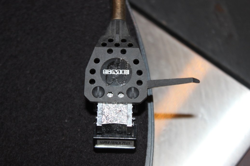

Ruffy Posted May 6, 2014 Posted May 6, 2014 Hi Gurus, I had a bit of a win today (I think) and have ended up with a Linn Sondek LP12 Export. I haven't tried to powered it up yet so have no idea if it works or not. I have no vinyl whatsoever (all digital) and don't know if I will keep it yet, I guess if I get it running and have a listen I will rethink my want to keep it. So, I have a few questions. - I know they can be readily upgraded so I am wondering if what I have is original? - What is different about the export model? - Is this an MM or MC cartridge. I have a Brio-R, will its phono stage work for me? - I see it has a non-australian plug, is this model 240V (no stickers on it at all)? Is there any reason I can't take it apart and wire in a decent power cable? - I have read they can be a pig to set up, does anyone have an instruction manual they can scan or a website they can direct me to which has step by step details on this? And lastly, any info you can share or anything I should be aware of would be greatly appreciated! As I said, this is my first foray into vinyl whatsoever and it may be very short lived if this doesn't work. For now I am staring at this thing in awe (us younger kids know records are cool) with no real idea of how to get the best out of it. Cheers, Andrew
Sir Triode Posted May 6, 2014 Posted May 6, 2014 (edited) Did you test it when you bought it? Was it purchased from a local who can vouch that it was used in Australia? Looks like an SME 3009 MKIII arm with a Shure V15 Type three MM cartridge. If your Brio has an MM phonostage - then it would work. Check out vinylengine.com for manuals for all three items. http://www.vinylengine.com/library/linn/lp-12-sondek.shtml http://www.vinylengine.com/library/sme/series-iii.shtml http://www.vinylengine.com/library/shure/v15.shtml Edited May 6, 2014 by Sir Triode
oldrose Posted May 6, 2014 Posted May 6, 2014 From memory the Export model was originally meant for the US market, the picture of your plug looks like a US plug so I would assume it is a 110V model. It's an early model and it seems in original condition except for the missing plastic lid holder that fits into the slot on the plinth. The cartridge is a Shure Moving Magnet and will work on your Brio-R. The SME arm was very nice in its day. You can of course upgrade the entire deck to current standards at significant $$$

ophool Posted May 6, 2014 Posted May 6, 2014 Apart from the deck itself, the cartridge/stylus needs to be checked - at least visually, before trying to play a record with it. 1
progladyte Posted May 6, 2014 Posted May 6, 2014 As Ophool has just said the cartridge needs to be checked. My initial look at those photos showed some "crusting" on the head shell which may lead to problems / erratic connections. I don't know if the damage is permanent or if will even affect you but to be sure, I'd factor in some costs in getting the cartridge rewired to the head-shell. I spent $40 on having my cart rewired on an old Thorens 166 and the hi fi guy said it sounded better than the LP12 he had in his shop. Go figure!

Sir Triode Posted May 6, 2014 Posted May 6, 2014 (edited) http://www.ebay.co.uk/itm/LINN-SONDEK-LP12-TURNTABLE-MOTOR-/321394839720?pt=UK_AudioTVElectronics_HomeAudioHiFi_Turntables&hash=item4ad4a010a8 http://www.ebay.co.uk/itm/Linn-Sondek-LP12-Motor-/291137528205?pt=Turntable_Parts_Accessories&hash=item43c926218d Pretty Cheap! Check and compare the sticker on the ones in the ads with the motor in yours first. You may have a 240V model motor in it already. Edited May 6, 2014 by Sir Triode
