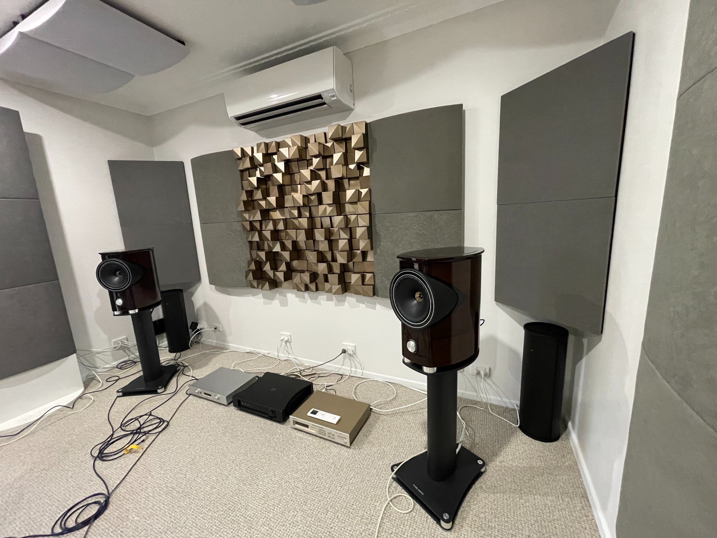

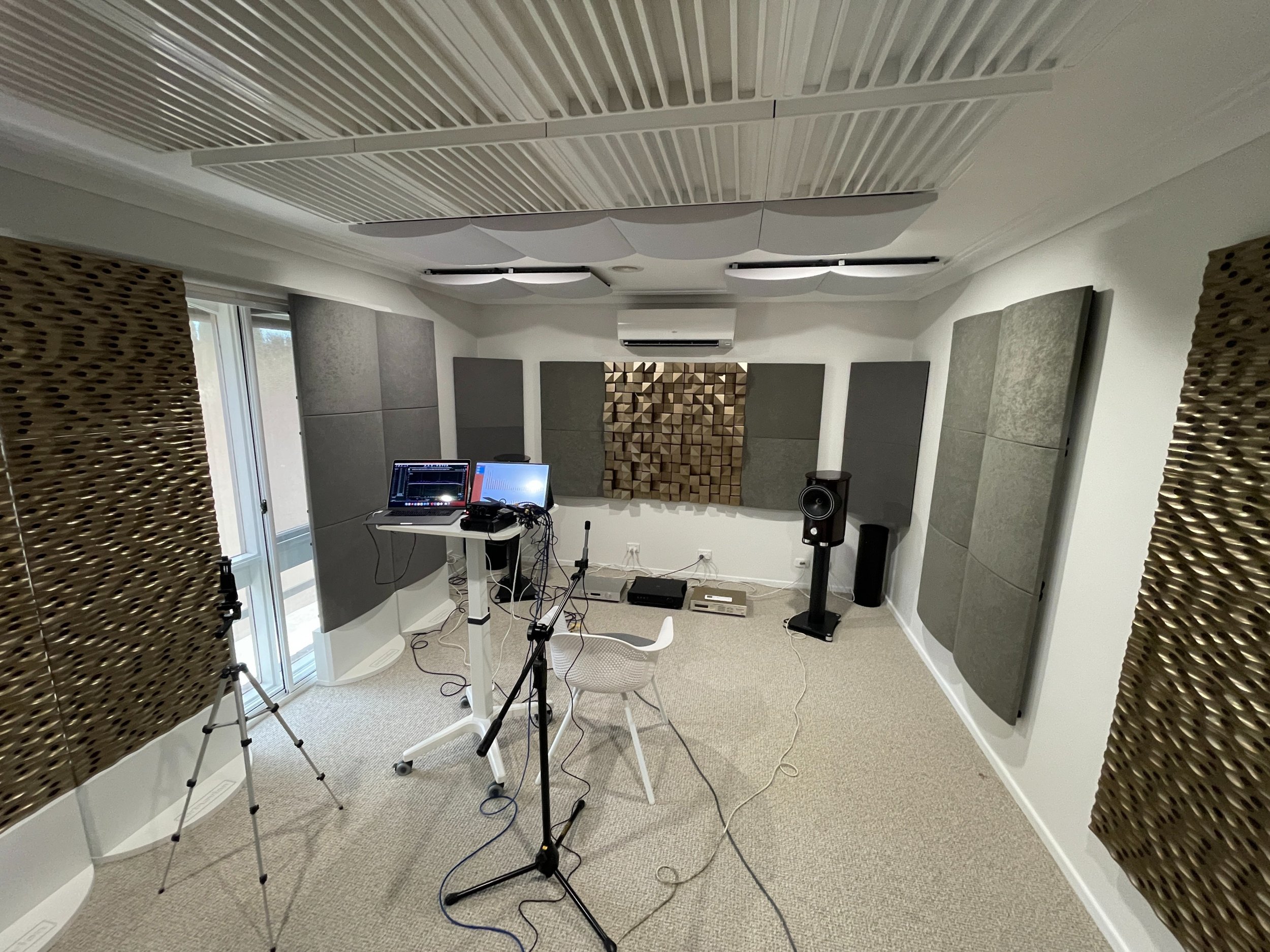

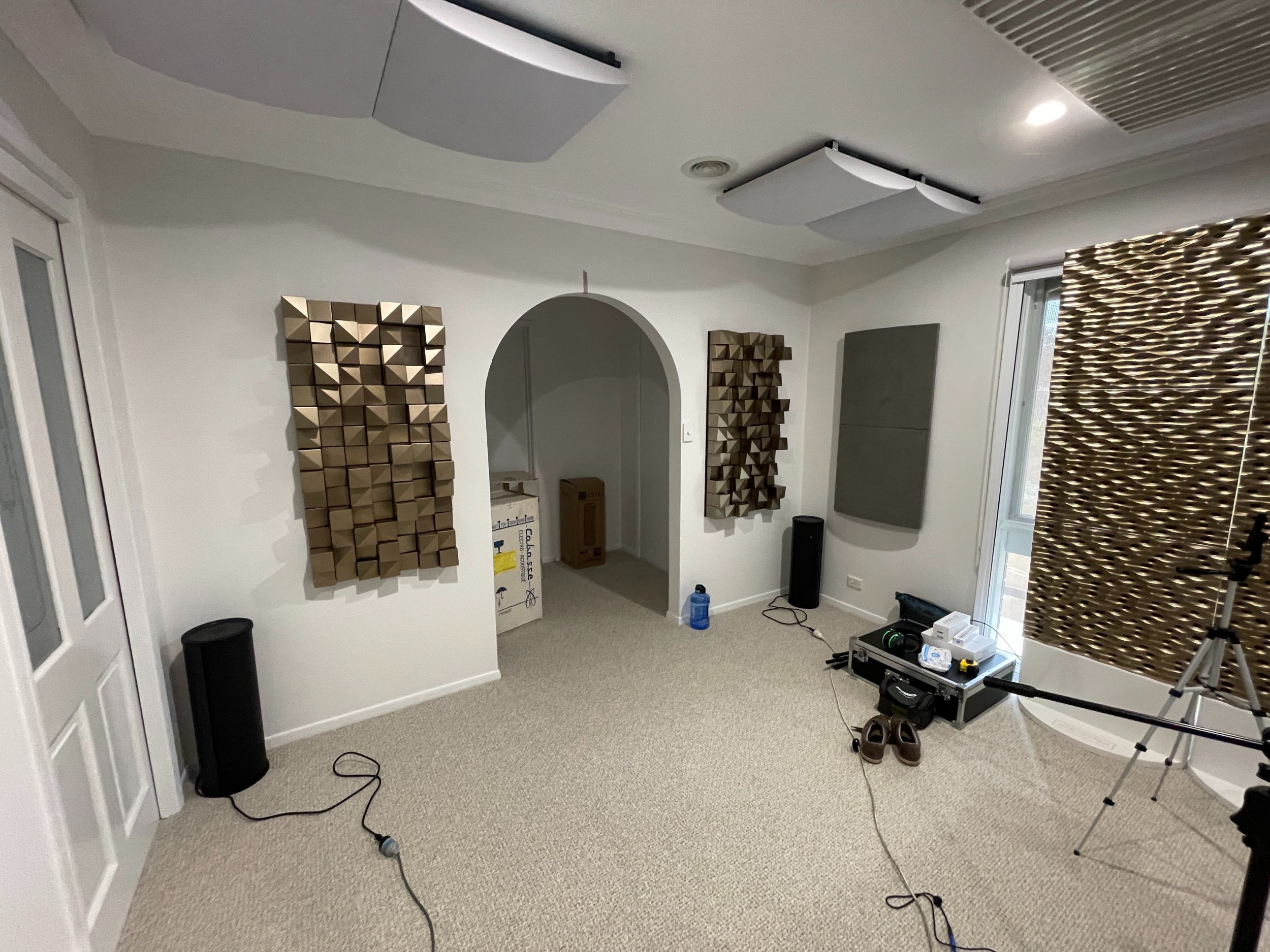

To tackle low-frequency anomalies, we strategically positioned four PSI Audio AVAA C214 units in the room’s high-pressure zones. These active bass absorbers operate between 15 Hz and 160 Hz, effectively reducing standing waves and room modes without the need for extensive passive treatments. Their compact design offers an absorption efficiency equivalent to much larger passive absorbers, making them ideal for spaces where aesthetics and performance are priorities.
IMG_3556.thumb.JPG.7432f9abc91a4a7162a5193238e240b0.JPGIMG_3557.thumb.JPG.747355594575fbfffede5e62c832e228.JPG
Strategic placement of PSI Audio AVAA C214 units in the front wall corners and rear corners of the room. This configuration ensures optimal low-frequency absorption, reducing room modes and enhancing overall clarity in the listening space.

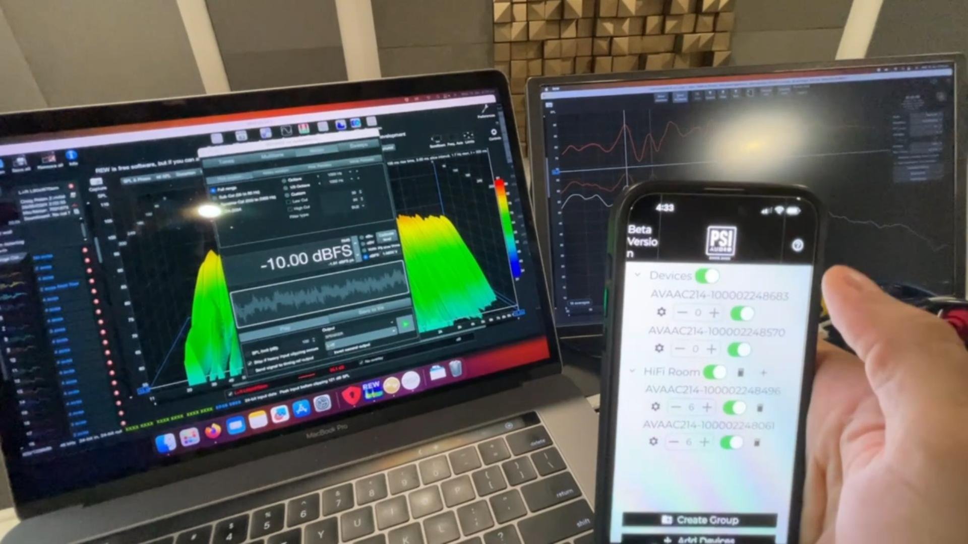

We conducted a series of tests using four AVAA C214 units to evaluate their impact:

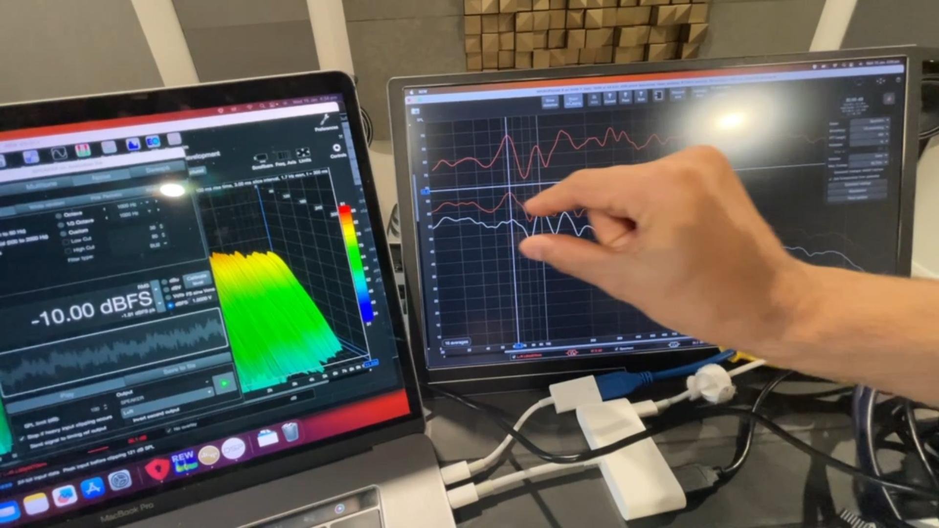

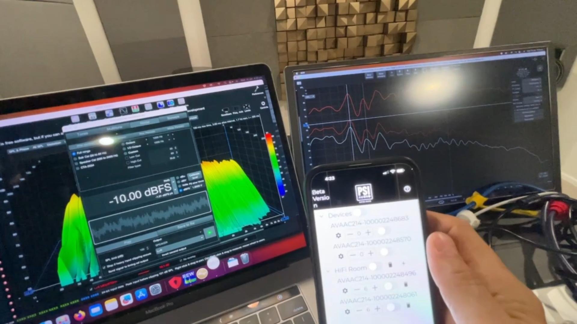

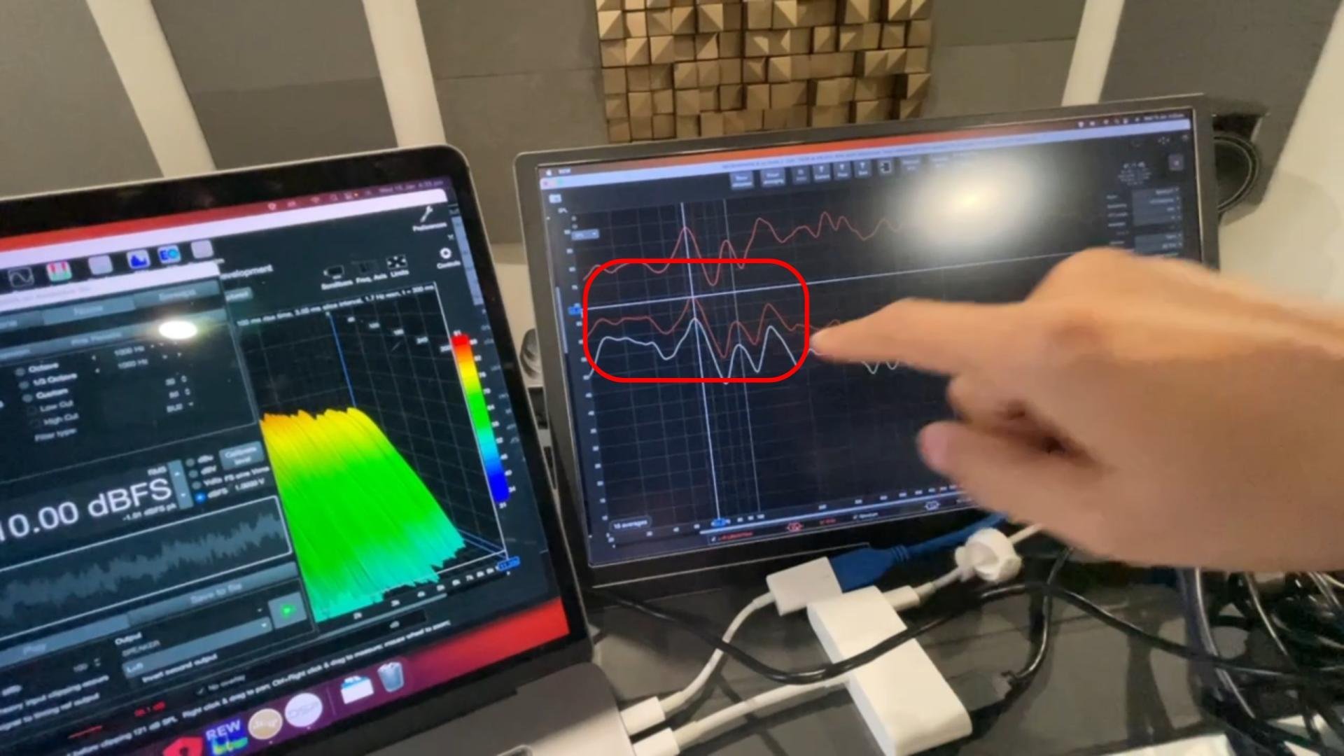

1️⃣ Pink Noise Analysis – By toggling the four AVAA C214 units on and off during pink noise playback, we observed a significant smoothing of the frequency response, confirming their ability to mitigate room-induced low-frequency issues.
AVAA performance frequency range 15-160Hz

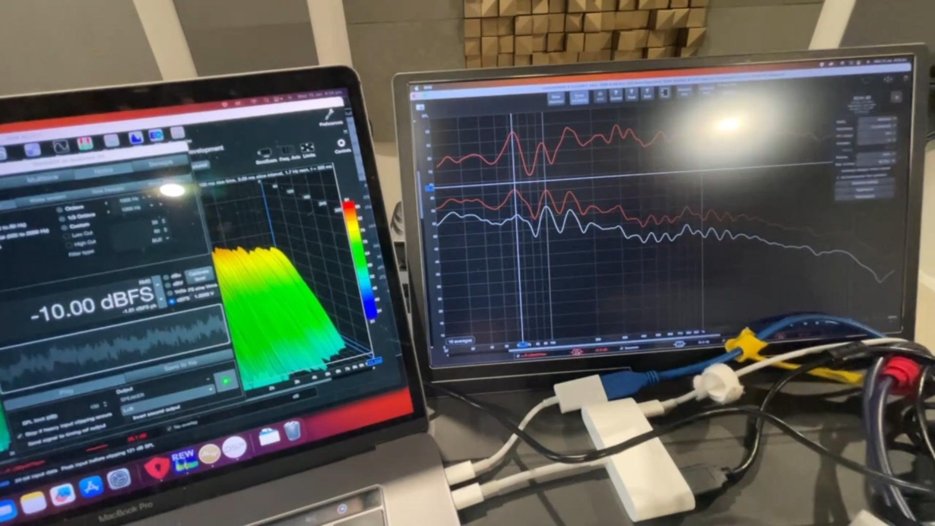

AVAA in off position

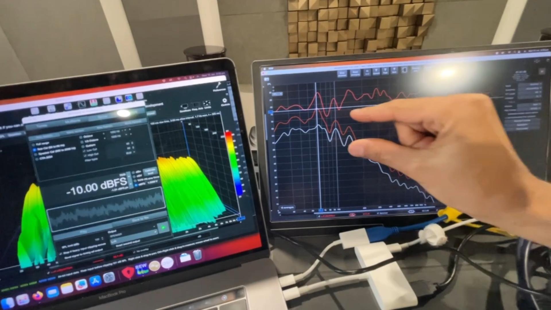

AVAA in on position
Notice the reduction in spatial variance between the loudest and lowest points
Smoother frequency response after 4 x AVAA C214

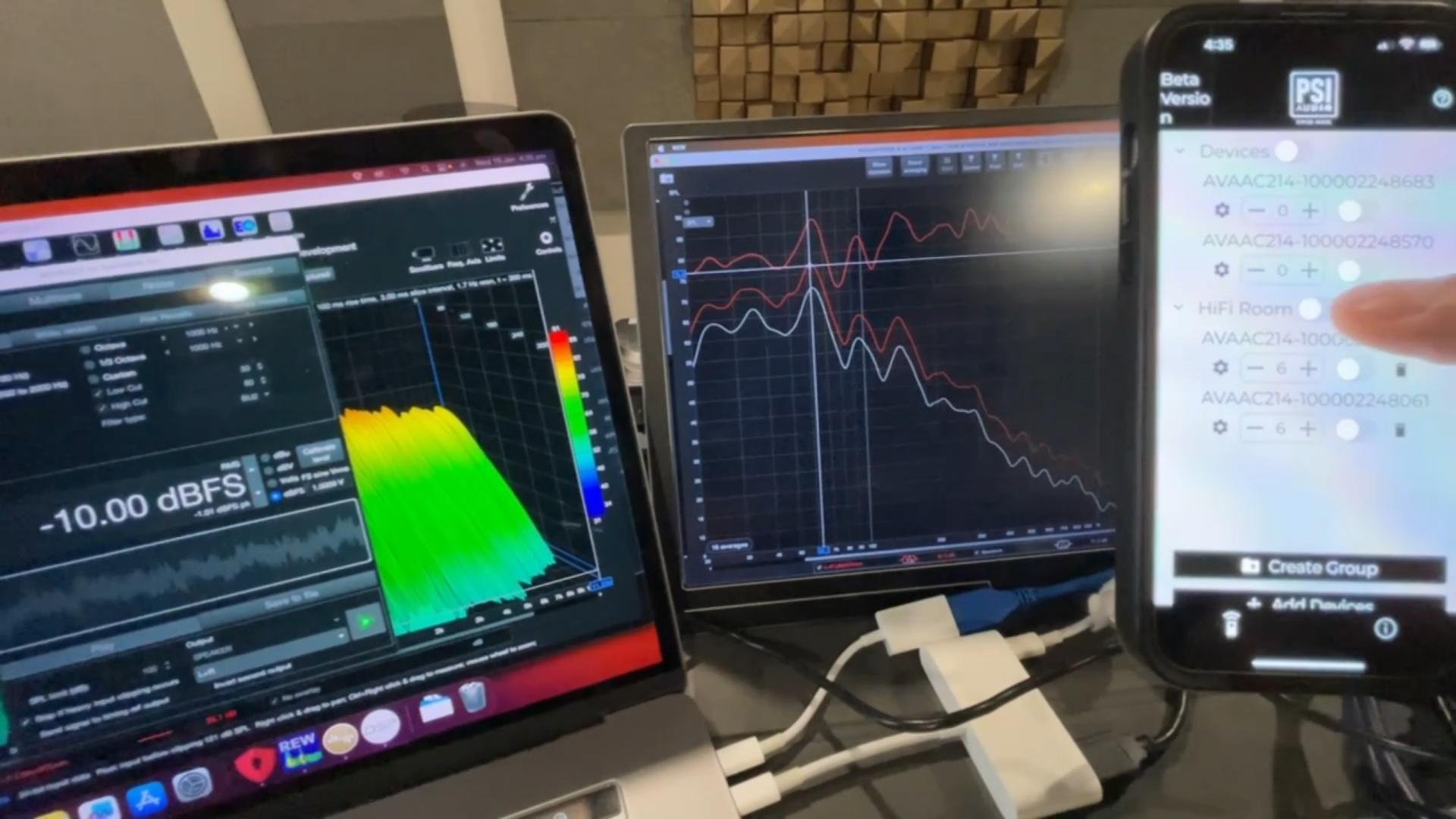

3️⃣ Sub Cal Frequency 30-80Hz Pink Noise Analysis Test
AVAAs off
AVAAs on
