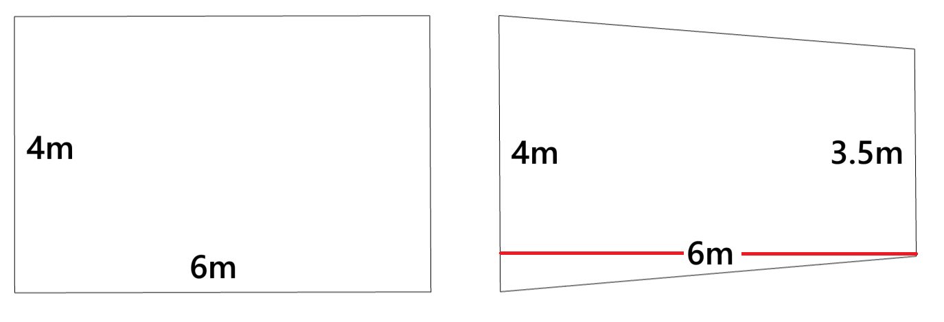

@Grizaudio if you still have your EASE license, would you be able to throw up a quick simulation of these two rooms? Just model the high frequency reflections only, not room modes. Assume that the speaker is placed on the shortest wall in both cases.
I have thought about designing a listening room similar to the trapezoid on the right. Theoretically the reflections should go away from the listening position, which will increase the path length and delay the reflections even more.
Maybe i'll spend a bit of time in Sketchup and see what I get.

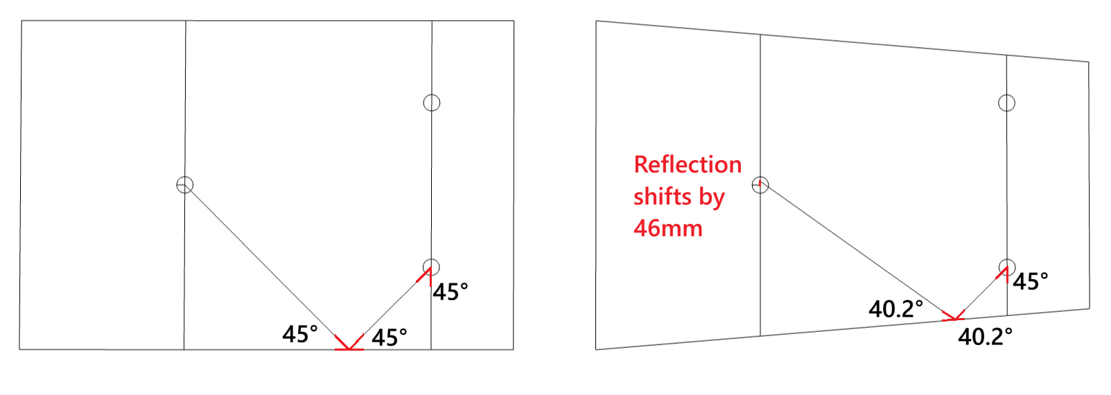

  • Author
I just drew it up on Sketchup. If we angle the walls as shown, the reflection is shifted by 46mm. For there to be significant delays in path length, the trapezoid would have to be far more aggressive than what I have drawn. Oh well.

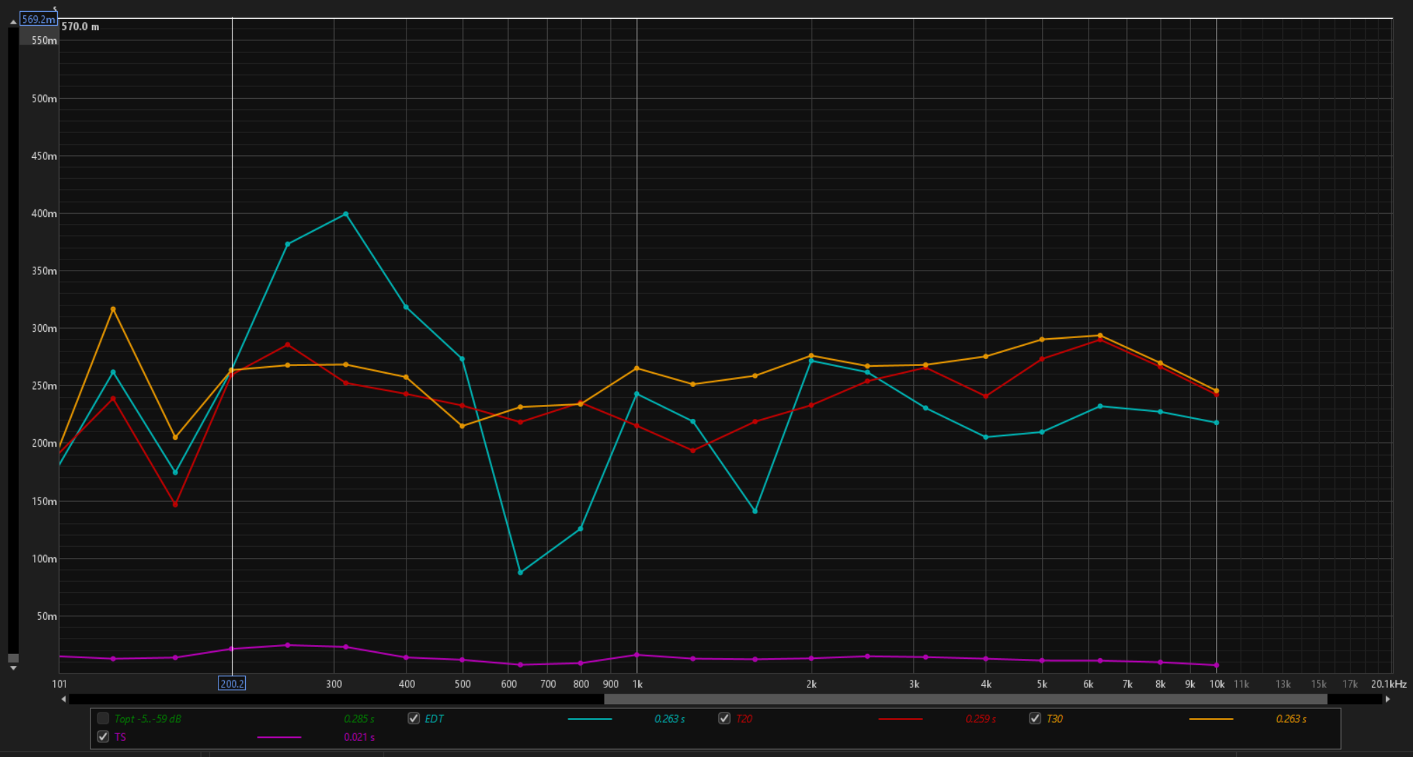

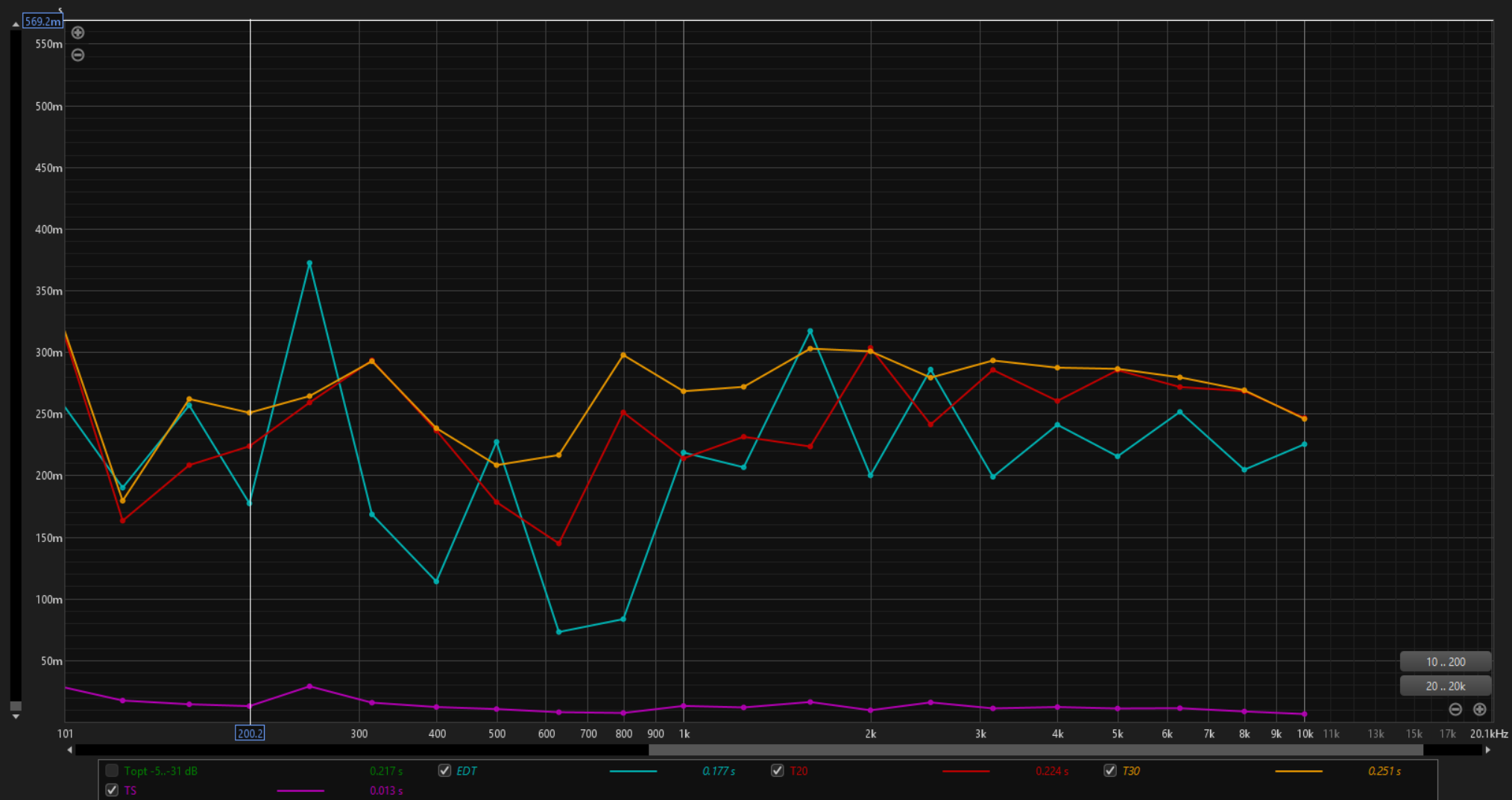

Typically, I enjoy a studio level RT60, which aims to maximise direct field energy and absorb primary reflected energy.
Somewhere around 200-300ms for everything above Schroder. I think somewhere around 300ms is about ideal.
Additionally, achieving a low RT60 is easier in a small room, and cheaper v's large.. Combine this approach with a nearfield seated position and you can easily maximise a direct to reflected energy ratio.
For me, I enjoy the improvements in clarity, and feeling of immediate presence to the music.
I don't typically like hearing the room, which is essentially just another form of distortion.
This was my left channel RT60
RT60 right
As you can imagine the spectrogram is clean [No DSP applied]...
Impulse becomes very clean

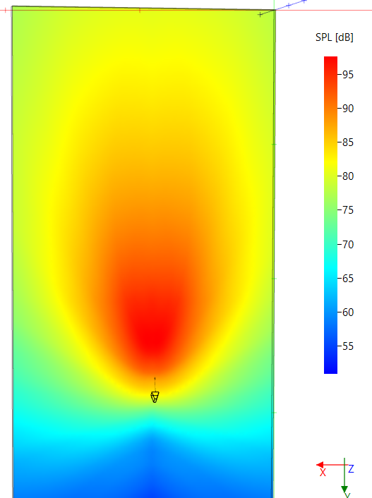

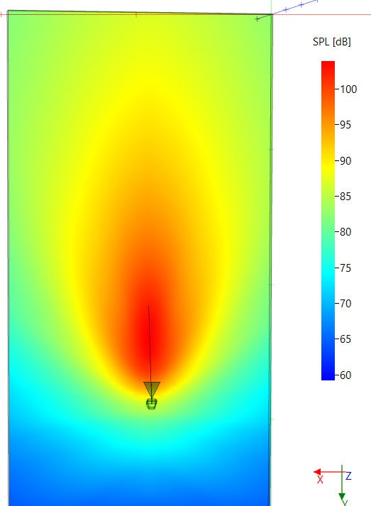

My opinion...
What is the point of designing a space, without modelling the actual speaker/subs in model?
The directivity, bandwidth, position, etc of 'your' speaker setup will dictate in room energy / behaviour.
Take directivity for instance, directivity will dictate where side/ceiling/floor primary reflections occur, and how much energy is being reflected.
Without considering the speaker, you can't accurately predict, location, intensity, or timing of primary reflections.
Edit.... Here's a basic example of two speakers which have varying directivity, covering the same area.
They are both going to interact with the space - very differently.
Speaker A - direct field in room - Speaker uses dual drivers and waveguide for directivity control
High frequency 1/3 octave 8khz
63hz 1/3 Octave

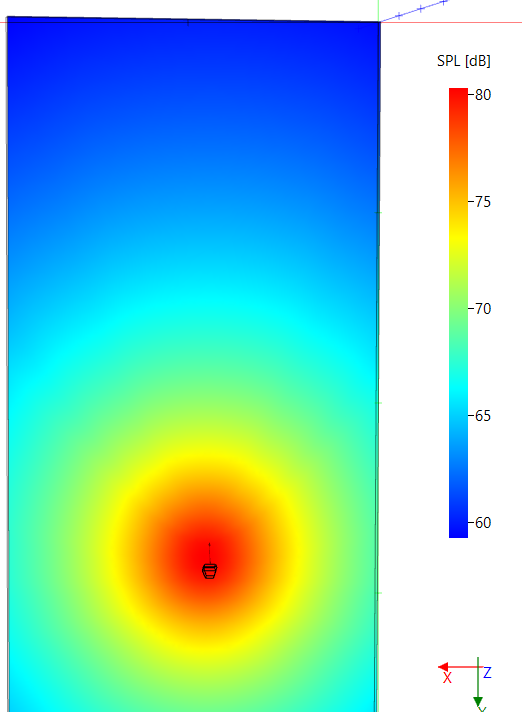

Speaker B same space - direct energy.
63hz 1/3 octave

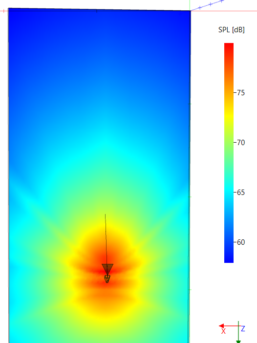

Thanks for those sims, but both of them are free-field sims. Would you be able to put the speaker closer to the wall and model the reflections? And specify the dimensions of the room?
Not so easy buddy.
you need to build the room, surfaces etc…
The point I was trying to make is the speaker matters

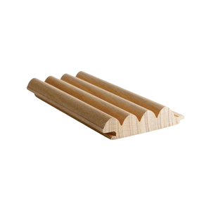

In the early 90’s I got a small recording studio built within a rehearsal  complex ,a friend of a friend did the mixing room , he said at the end ,it’s very neat but partly because of enchantment medication the angles were not good ,but would help with acoustics ,which it did ,
I think any relatively small deviation would be better than none , if practical ,to modify after a build may be cheaper , there are so many products out now , it is easy to cover a wall to reflect haphazardly like a diffuser ,maybe not perfect but   pleasing to the eye , like this product below
Knock yourself out.
