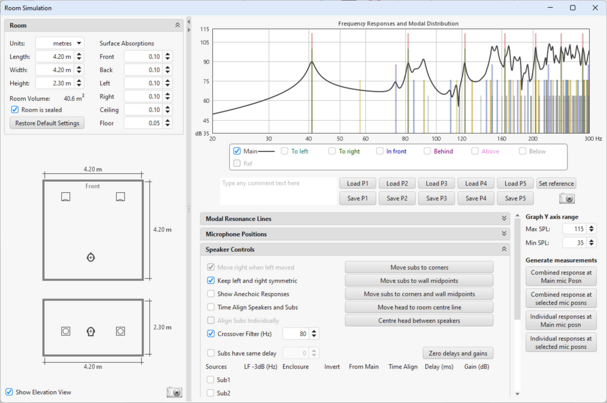

Anyway, room modes for a room dimension of 4.2m is 40.8Hz, 81.6Hz, 122.4Hz, etc. For the 2.4m ceiling height, it is 71.5Hz, 143Hz, etc. It actually does not look too bad when you plug the dimension's into REW's room sim:
I would consider rotating the speaker/listening position 90 degrees so that the window is behind you. That way, you can open up the window and get a "bigger" room. It also reduces room asymmetry.
Interesting, thanks. I’ll give the 90 deg rotation a go, but as the window is also a door that may not last!
