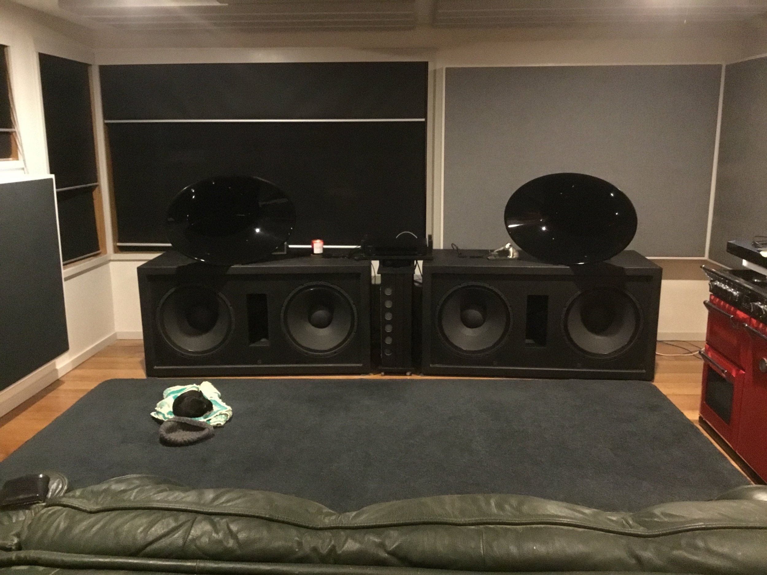

I'm at the point of, this morning after last evening  watching The Fifth Element, she comment, "I could hear sounds coming from everywhere, was really good, love what you have done" I quietly in my mind, cheered loudly, as, it's probably the nicest thing anyone has said about the "thing" I've built.
Edited by playdough
  • Author
7 hours ago, playdough said:
Indeed, yes follow that principal, what can go wrong 😅 ?
Now that is a set of speakers.  You do like large panels
