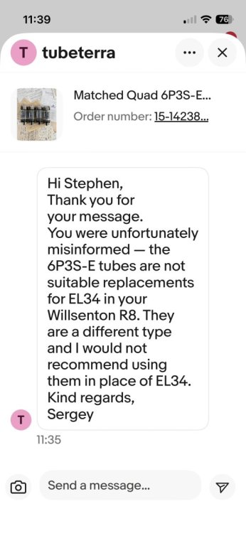

1 hour ago, Treerover said:
This from the supplier of these tubes. I think your recommendation comes with potential disastrous results !
Hi. You just have to set the bias a bit lower. Search this tread and you will see that many people are using them.
@Treerover that advice from seller is wrong. I'm using them on my R8 right now. As @EuroPad stated, search this thread and you will find plenty info of 6P3S-E. I recommend that you stockpile more than one set as the price increases quite a bit, from $50AUD per set to over $120AUD in the last 5 years. Although @120Aud/matched quad, it's still a bargain.
Well that’s good news as I was facing having to send them back . They should be here any week .
How did you set your bias level ?

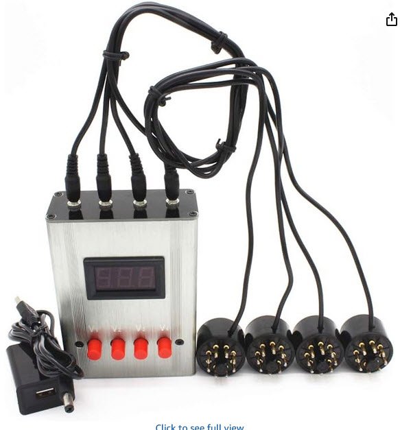

If you've purchased something like the one below you can also measure plate voltage using the same tube socket adapter. When you get it message me and I'll advise how to measure that value as well.
https://amzn.asia/d/0jbIZruZ
I got this one... It's pretty easy to use and is reasonably priced @ $80...
