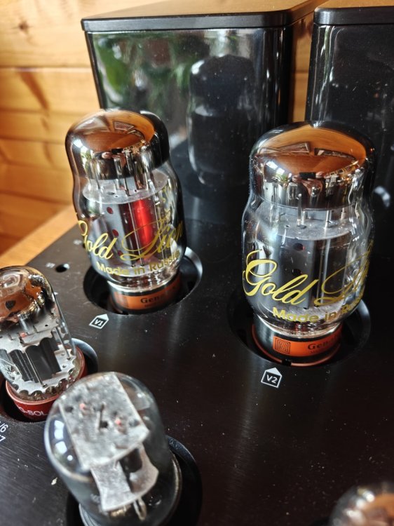

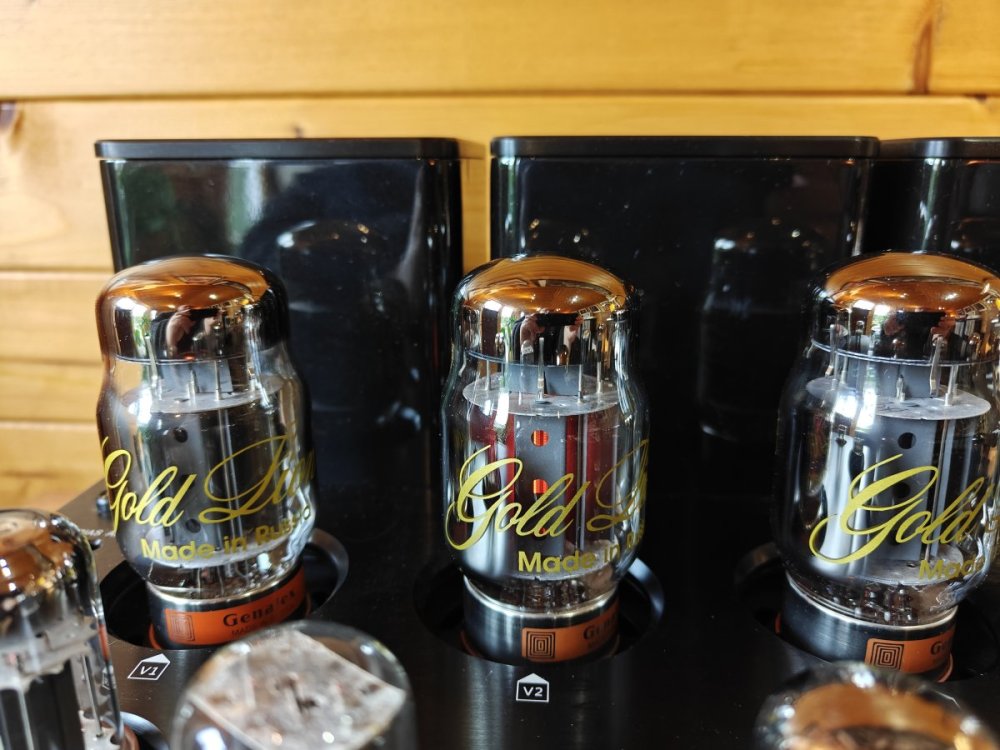

I'd pressed my R8 back into service about a month ago after using a Jadis Orchestra for the last while. I've changed speakers a couple of times over the last year, newest ones being Spendor Classic 2/3, and I had an itch to see what they were like with a bit more juice. So I pulled the R8 out, switched out the Groovetube EL 34 I had in there for the stock KT88, and what do you know, it really suited the Spendors. So naturally I immediately went shopping for new KT88s, and ordered a set of Gold Lions.
They finally arrived today after a three week delay due to restocking, out with the old, in with the new, turned the amp on* and immediately the tube in V2 went red and things smelled a bit burny. Turned it off and let everything cool down, tried it in V1 to check and same again. I've mailed the supplier to ask for a replacement, waiting to hear from them now, so stock tubes will go back in. The joys of it eh?
That a shame, sorry to hear that. Did you turn the bios all the way down before turning on the amp?
Hey, yes I did, everything turned down (I added the * in my post to add that detail at the bottom and then forgot all about it).
I also have the gold lion kt88 tubes, but I don't use them cause I'm happy with the much cheaper option 6P3S-E. Perhaps you should try them out while waiting for this to be resolved
You might want to consider replacing the bias pots on the R8 if you have not done so... The bias pots on Chinese amps are a weak point and are known to fail... One pot failed in my R8 as well as my Muzishare X7, taking out a Gold Lion KT88 as well.

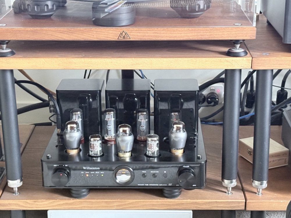

Loving my R8 and tube rolling, just pulled the trigger on the below
Ray Tube KT88's (Select) matched quad - replacing Tung Sol EL34B's
Ray Tube 6SL7's already had these.
Ray Tube 6NL7 (Reserve) got this dirt cheap
I just need to swap out the two 6NL7's Psvane tubes.
Simply loving this amp!
