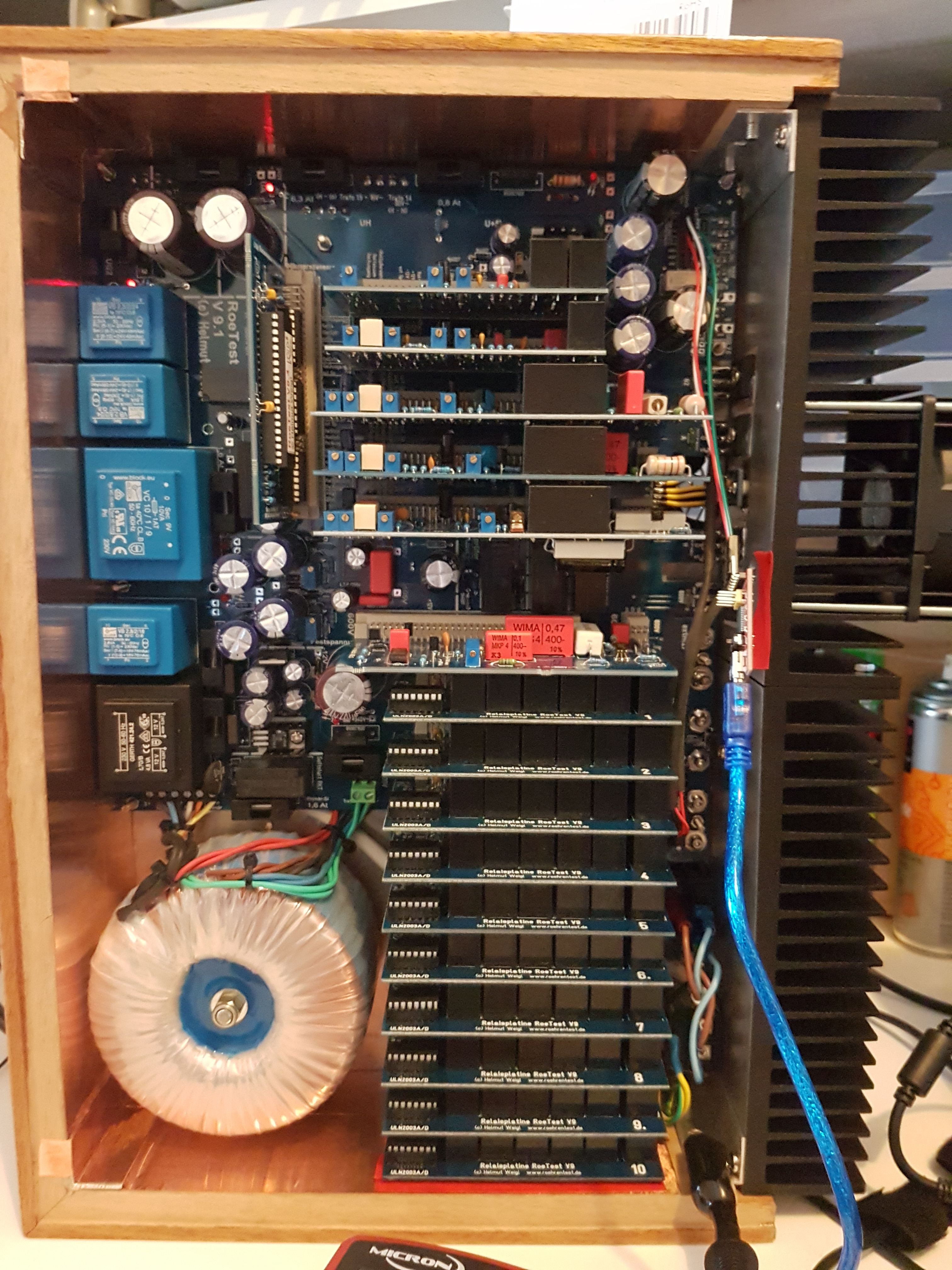

Ihearmusic Posted February 25, 2023 Posted February 25, 2023 +1 for the http://www.roehrentest.de/EnglishInfo.html Might be a bit much for the occasional DIYer though. My unit: 1 1
