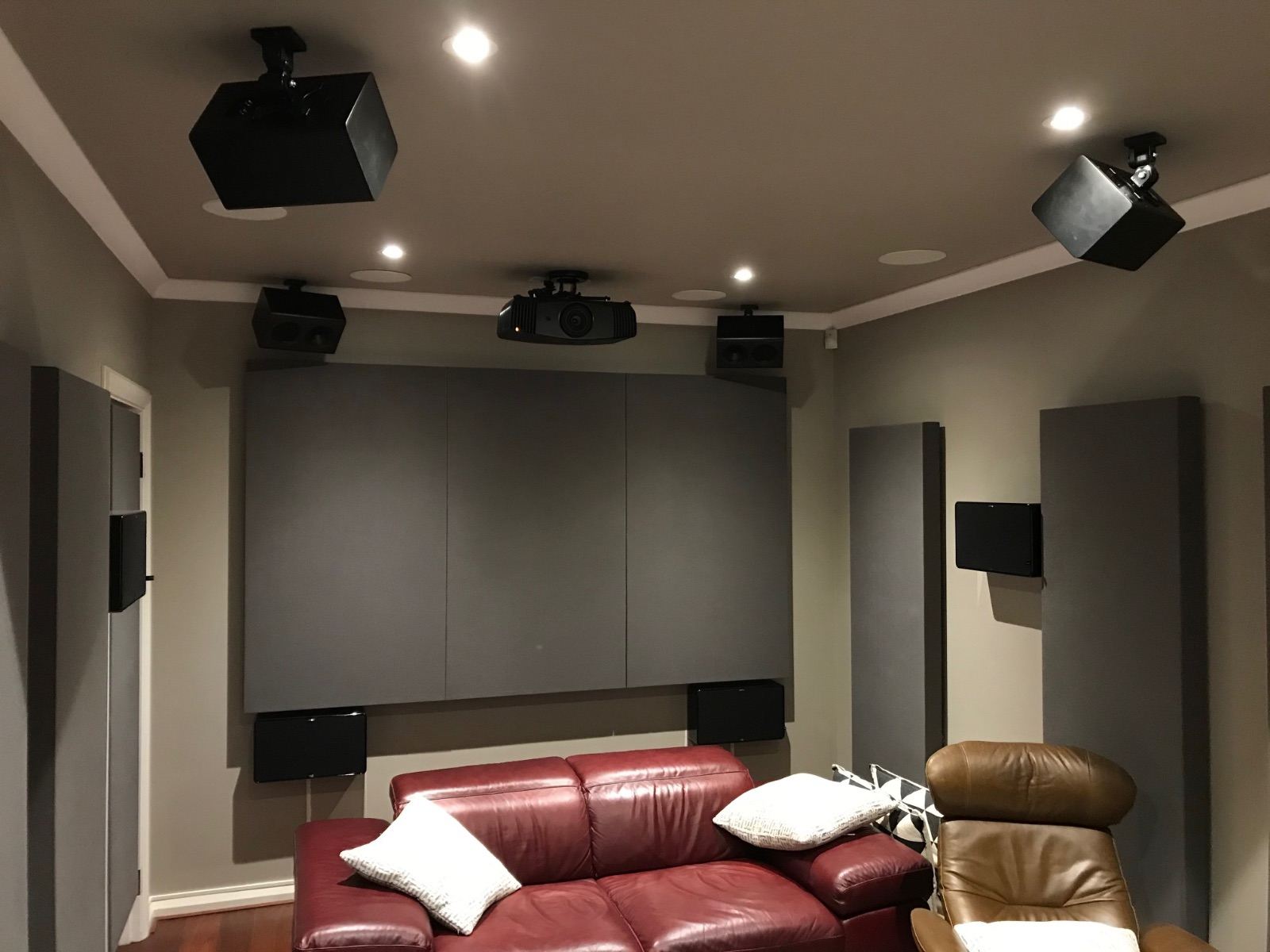

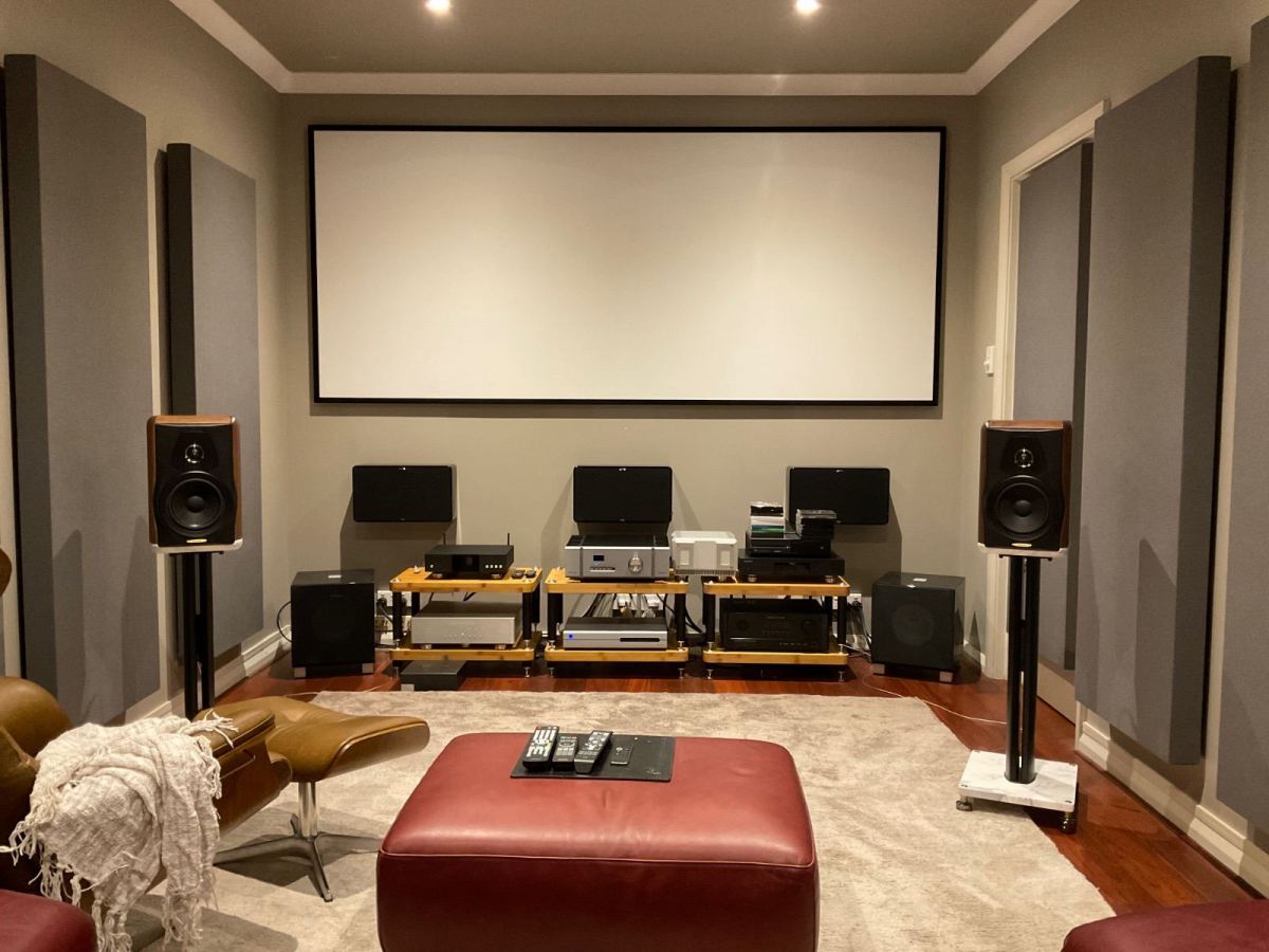

So looking at my room setup, would you suggest replacing the absorption panels at the first reflection point by diffusing pannels? Note that the speakers and pannels positionning were not adjusted when this picture was taken. There is about 30% of the wall surface areas that are covered by panels. It has tamed the room as it was painfully bright. But the soundstage does not extend pass the walls. If swapping for diffusors would expand the soundstage passed the side walls, I’ll definitely try.
The size of the room is not ideal at 3.5m wide by 5.5m long. It’s awesome when listening in near field (incredibly immersive) but I end up having to swap the listening position depending if I am listening to my 2 ch system or my 11.2 system.
6 hours ago, Colonel Sanders said:
That’s very interesting.
You have a fair bit a reasonably good gear, so I am going to assume you don't mind getting the correct products to get a much better result.
I would do the following:
* Move your LCR speakers to centre of the ceiling height to the centre of the speaker & install an acoustically transparent screen over the top - your screen is too high anyway. Put absorption board between the LCR speakers -100mm thick.
* Remove the first & third absorber panels and replace with diffusion like an Artnovion Douro - this is on the assumption that you will leave the stereo speakers forward so that the first reflection point is a diffuser.
* I would put 3D diffusion on the ceiling just above your head position. Artonovion Myrion E would suit.
* If you are up against the rear wall, then put one of your 1st reflection panels horizontal on the rear wall starting approx 900mm off the FFL or above the couch.
* Put 3D diffusion on the side wall in line with the head on the side walls.
* You would also benefit with a row of 1st reflection absorber/Diffusers on the ceiling (approx half way between your front wall and your head - assuming you raised the LCR speakers). Something like Artnovion Verona, which offer 3D diffusion. This partly that your rug is not really thick enough.
Do that and report back. I work a bit with Rogue Home Cinema in Peth, so give them a call. Scott will contact me if he needs to confirm details. He would have everything you need.
Do all of that and both your surround sound and stereo will improve dramatically. I can't understate the difference.

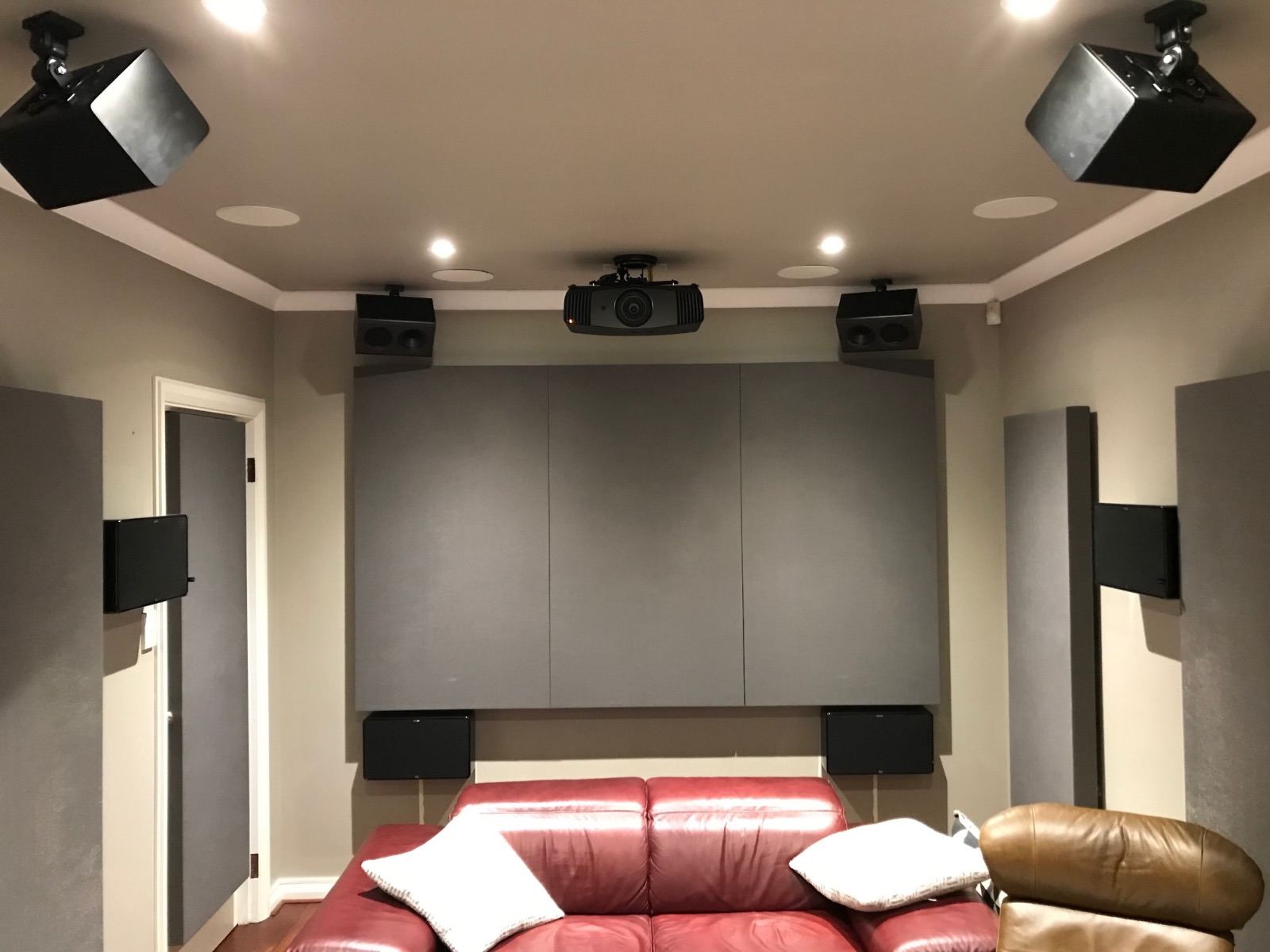

Thanks, this is very interesting!
That’s what the back of the room looks like. I’m not really into the HT setup. I don’t think the room is leading itself to host a decent HT setup, especially for the surround speakers (back and rear). But probably more important than this, I’m not a movie buff and the movies I enjoy watching (mostly french movies) do not have the soundtrack as their main feature of interest. This being said, I’m planning to get an acoustically transparent screen to hide the LCR.
I’m really looking to acoustically “remove” the side walls when I listen to my 2 Ch setup so the soundstage expand in width. Depth is quite nice currently with the speaker about 2 m from the front wall. I’m sitting about 1.5m from the back wall.

Go & have a listen to the setup at Rogue and decide from there. At least you’ll have an idea what a balanced cinema room sounds like for music & movies.
You have way too much absorption in the wrong places, which might not sound overly damped because you have so much slap echo from the floor/ceiling, but it’s still incorrect. Treat the ceiling, especially behind the seat, replace a lot of the absorption with diffusion & correct your surround speaker heights, but work out what you want from the room first. Lot of money on surround sound, if that’s not what you want…

Thanks, I’ll definitely will drop by at Rogue.
I’ve only listened to the rooms at HTE that are strictly HT. Their cost no object room with a Trinov processor was pretty impressive. But as you rightly pointed out, I’ve already over invested in the HT. I tought my daughter would live in the room and watch movies but turns out she only goes in the room to play clarinet…

That’s great. You’ll be able to make a direct comparison of the acoustics. You’ll be surprised when you do.
I think Rogue requires an appointment, so give Scott a call.
