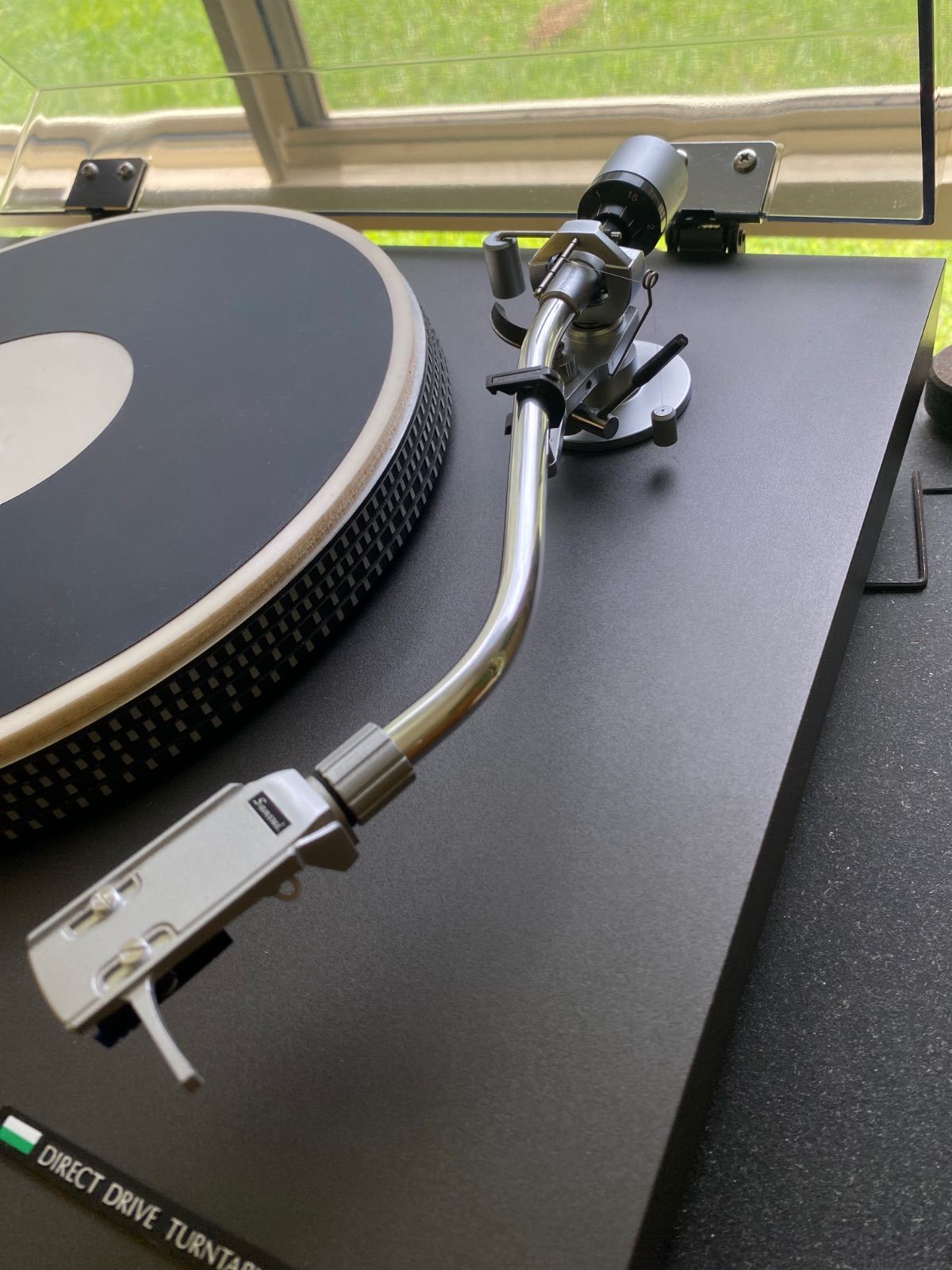

Maynard Posted February 2, 2022 Posted February 2, 2022 (edited) Hey all what would your compliance estimate be for this Cart. DV spec is 12 at 10hz to go on an arm effective weight approximately 16.1-16.5 grams. Plugging it into VE compliance calc I get 7hz, if I estimate compliance to be around 20 (@100hz) would this cart work on an arm such as this? Edited February 2, 2022 by Maynard

Maynard Posted February 3, 2022 Author Posted February 3, 2022 Another thing when someone says “that carts capability would be wasted on an arm like that” or something similar… what specifically are they referring to? I think my arm (sansui 525) sme similar design would be perfectly adequate.
andyr Posted February 3, 2022 Posted February 3, 2022 On 03/02/2022 at 2:12 AM, Maynard said: DV is Japanese right? I thought you had to multiply their figures by 1.5-2 to get a reading that is correct on the VN calculation whereas an ortofon spec would be at 10hz so no multiplication needed Read that somewhere Expand The above conflicts with what you posted first up! Yes, DV is Japanese - so the "12" compliance given on their spec sheet ... is for 100Hz. So, yes, that becomes ~20, for 10Hz. Which, for 16.5gm eff weight puts you into the yellow (at 10gms total weight). So it'll work ... but an arm with a lighter eff. mass would work better. Andy
andyr Posted February 3, 2022 Posted February 3, 2022 (edited) On 03/02/2022 at 2:17 AM, Maynard said: when someone says “that carts capability would be wasted on an arm like that” or something similar… what specifically are they referring to? Expand I suggest they are primarily suggesting the arm's engineering - such as its bearings or its armtube stiffness - is not at the level of which would allow the cart to deliver its best. But ideal matching with the am's effective weight is also a consideration. A similar concern IMV is the loading which your phono stage offers. What does yours offer? Andy Edited February 3, 2022 by andyr

TemaadAudio Posted April 23, 2022 Posted April 23, 2022 Hi, Normally I use the figures of between 1.4 & 1.7 when converting Japanese cart compliance to Euro spec. But your cart should work OK with the arm, but yes with the combination you a stuck at around 7hz, whether that is a problem or not depend on what type of floor & isolation your T/T has. The comment that your arm may not be good enough for the Dyna is correct. Many people make this mistake when new to upgrading. It's a bit like upgrading a car, what do you upgrade for better performance on a race tack? the engine of suspension. Many people go with an engine, but if the suspension (arm) is not up for the job then the extra power is useless. Bit lower end T/T's one thing is certain, the manufacture will be using cheap & cheerful bearings. People even upgrade the bearings in the SME V, at a bearing cost of around $20. So if you had a very good arm & low cost acceptable cart, verses a low cost arm & expensive cart. The good arm, low cost cart will nearly always sound better. As the VG arm is allowing the cart to before at is max performance. Also don't forget the arm's internal wiring, for a cart of the Dyna quality it deserves better. Cheers
