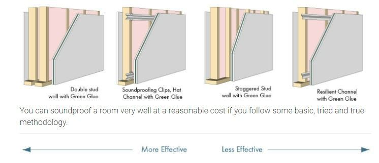

Excellent resource here: https://www.soundproofingcompany.com/soundproofing-101
from this source
Interestingly, from the above diagram, single studs with channel mounted on whisper clips is better than offset/staggered stud for isolation - funny how you read these things lots and pick up additional nuggets each time :)
Many builders don't have much clue about building for sound isolation (although most would have built offset/staggered stud walls and used whisper clips), and fewer would have used Green Glue and 2 layers of Gyprock - you may have to provide guidance/instructions to your builder - and even overcome some pushback - "why do you need to do that??!!" - just remember it's your room!

You have an opportunity with constructing this wall to enhance the "in room" bass response of your room - which you should take advantage off, given the other walls are brick/acoustically rigid hence reflect bass back into the room. which needs to be absorbed for good "in room" bass.
A whole wall absorbing bass is a good thing 👍, with the sound isolation/sound proofing an added benefit.

Ask him for a quote based on the diagram above 2nd from the left, ie from garage side: Gyprock/studs/sound proofing clips/hat channel/Gyprock/Green Glue/Gyprock...with fluffy insulation between the Gyprock layers of garage and room.
A 2-3 x increase in cost over a standard stud wall would be reasonable IMHO - whether your budget can afford that is a completely different question.
