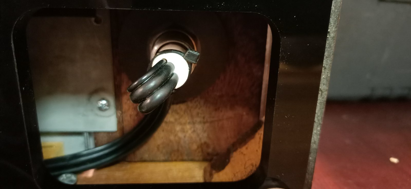

Guest Posted January 15, 2021 Posted January 15, 2021 (edited) Linn turntable gurus used to tie back the Grace cable with a cable-tie and then direct it to a P-clip positioned midway along the rear of the LP12. I imagine the same trick could apply to the TD150. Edited January 15, 2021 by Ian F
southern_tango Posted January 15, 2021 Author Posted January 15, 2021 On 15/01/2021 at 7:24 AM, Ian F said: Linn turntable gurus used to tie back the Grace cable with a cable-tie and then direct it to a P-clip positioned midway along the rear of the LP12. I imagine the same trick could apply to the TD150. Expand Great idea...and a good example of KISS ( keep it simple ,stupid) will try it

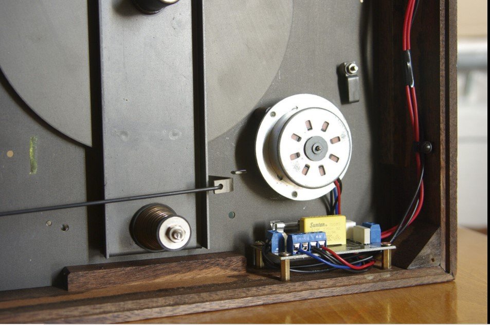

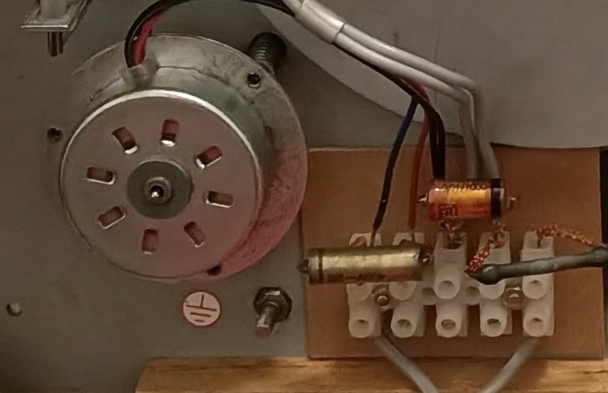

southern_tango Posted January 15, 2021 Author Posted January 15, 2021 More questions appealing to your experience, should I replace the 240 V. wires to two pole and earth connecting the earth yo the chassis ? ( screw next to the motor) would it be beneficial to replace the caoacitors and resustor for newer ones ? ( on a circuit board with all the connections soldered)
Guest Posted January 15, 2021 Posted January 15, 2021 If you're comfortable working with 230v AC there are PCBs available on eBay to update the Thorens supply.These have the benefit of an inline fuse plus suitably rated X2 mains capacitors.You need to specify which turntable/motor you have in order to get the correct phase capacitor and dropping resistor.The traditional Thorens earthing arrangement uses a separate earth lead connecting back to the amplifier.This is less likely to lead to earth loop and hum problems.
Guest Posted January 16, 2021 Posted January 16, 2021 https://www.ebay.com.au/itm/Thorens-TD150-TD160-etc-Power-Supply-PCB-Upgrade-Linn-Ariston-REV-5-0/114629122017?hash=item1ab06d97e1:g:ErcAAOSw5ZtaUPxO

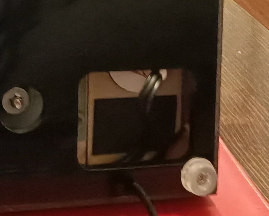

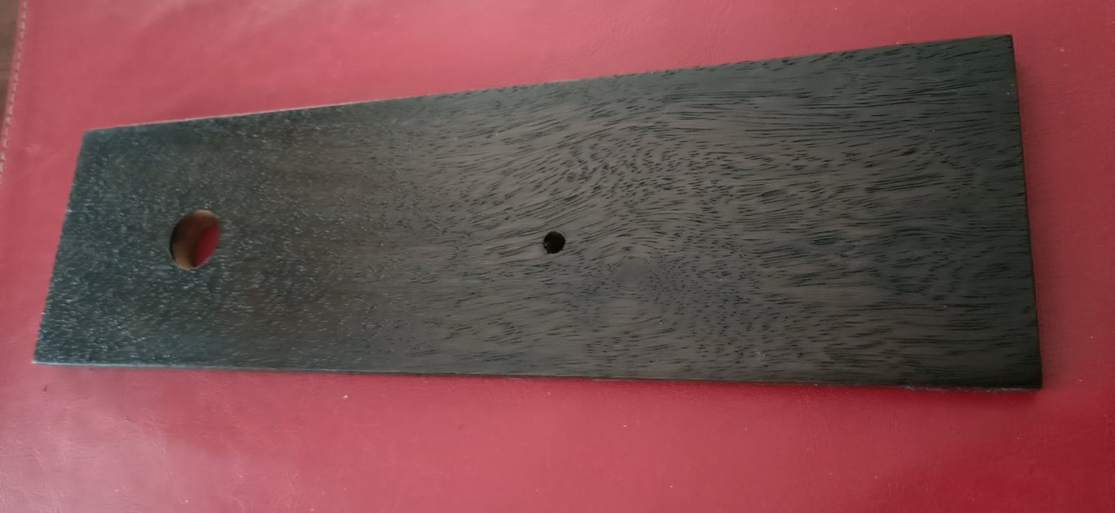

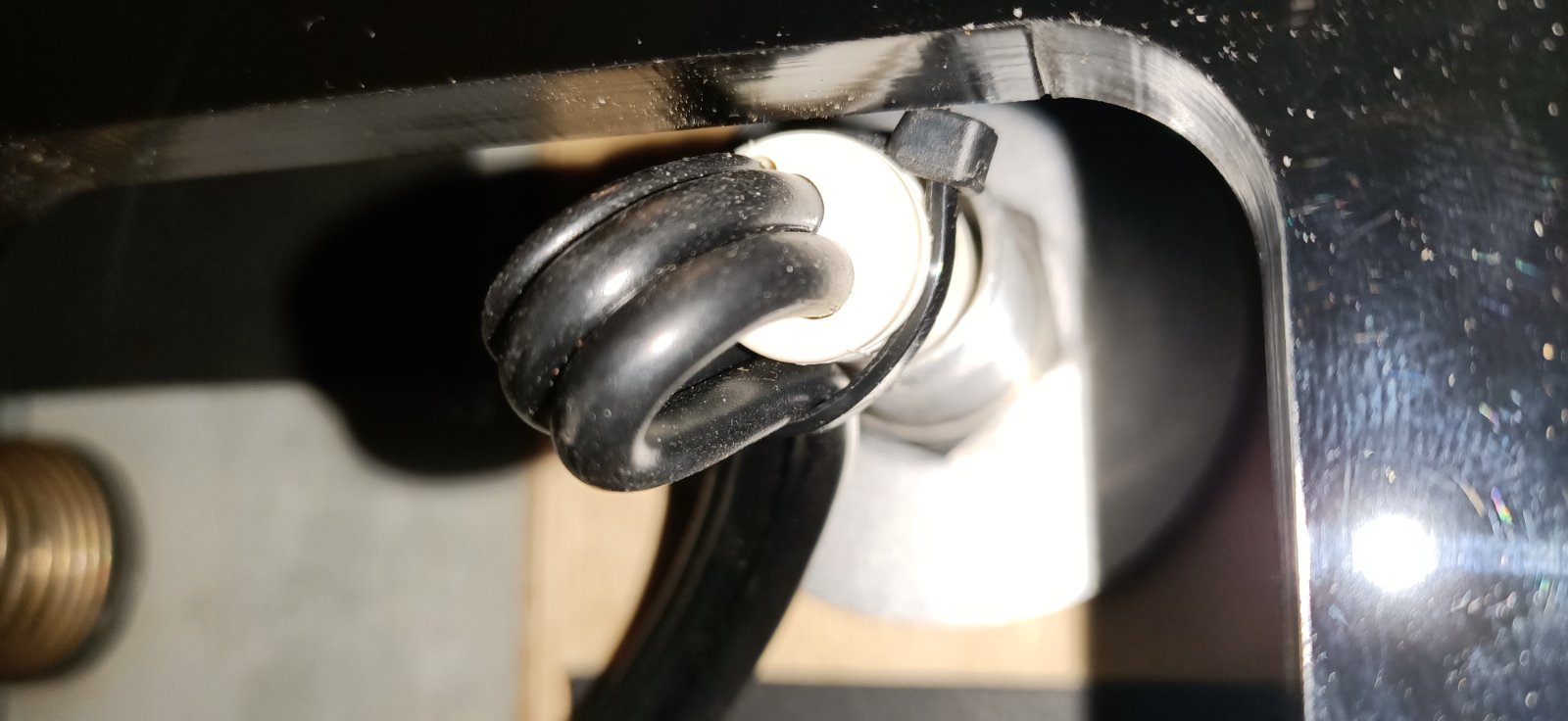

southern_tango Posted January 16, 2021 Author Posted January 16, 2021 (edited) So....I did as Ian F but with a little twist letting the wires "float" from the p clip , everything looked ok until I put the base and suspension locked up again...worked a bit on the springs pressure ,nothing. Until I put the tt on it's back one more time...and discovered the problem...It was ME !! when installed the tonearm did a jig to get the 222 mm center to center spindle to axis and trying to compensate for the longer counterweight...well tonearm connector hits the edge of the perforation in the base Edited January 19, 2021 by southern_tango

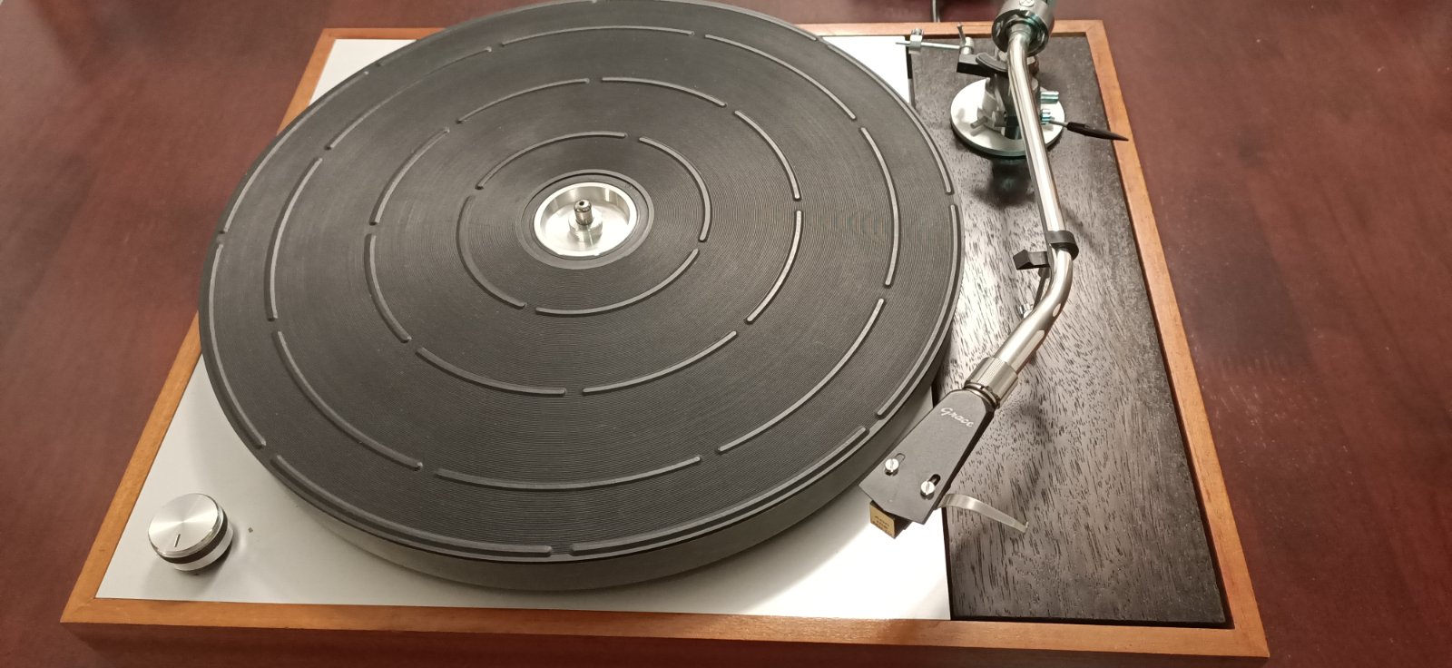

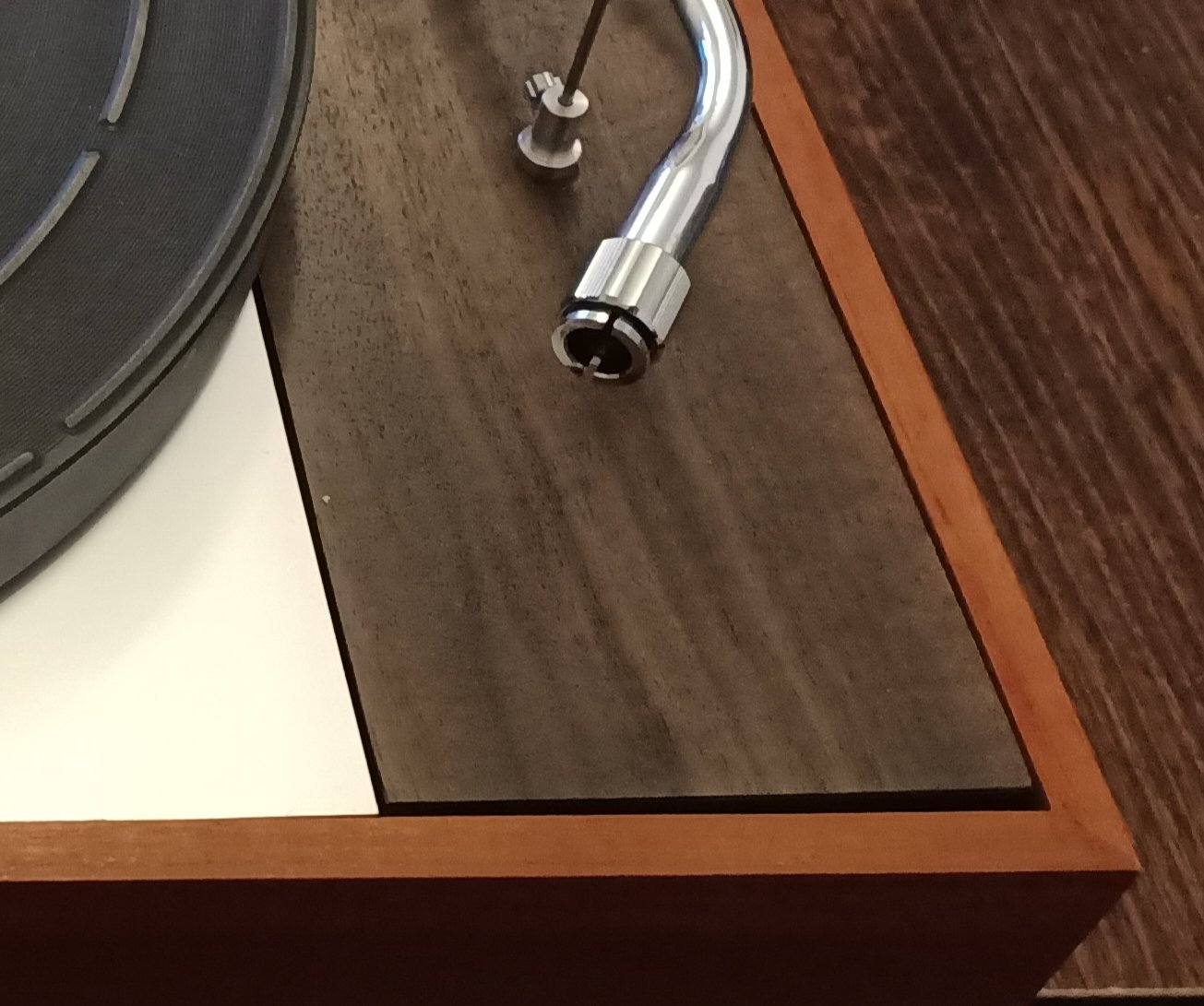

southern_tango Posted January 19, 2021 Author Posted January 19, 2021 (edited) And it's done... Solid timber armboard ( guess the timber get the price) Corrected all measurements now it clears the base , unluckily the cover doesn't fit so for the moment it is going to seat inside a cabinet ( I have a cat) Edited January 19, 2021 by southern_tango

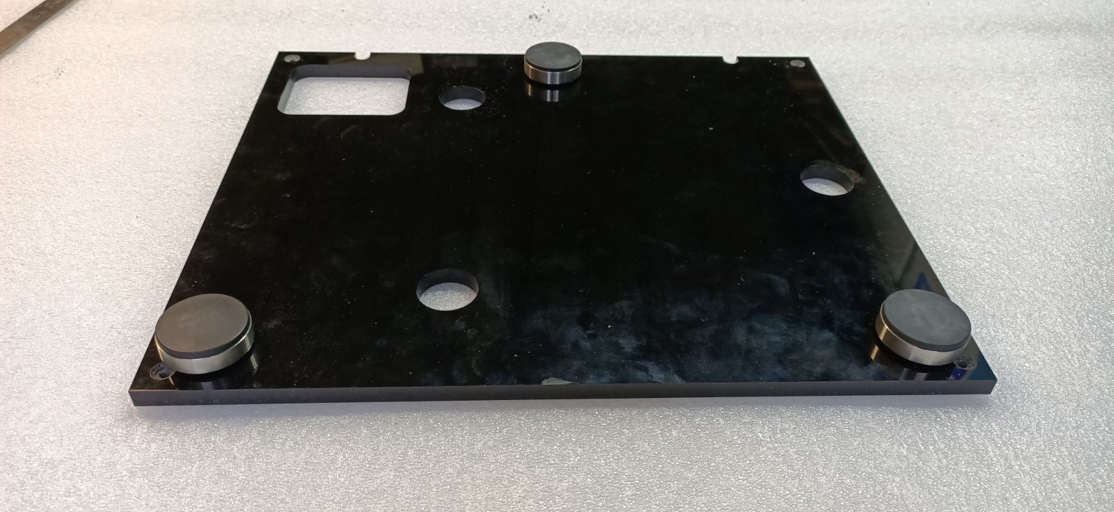

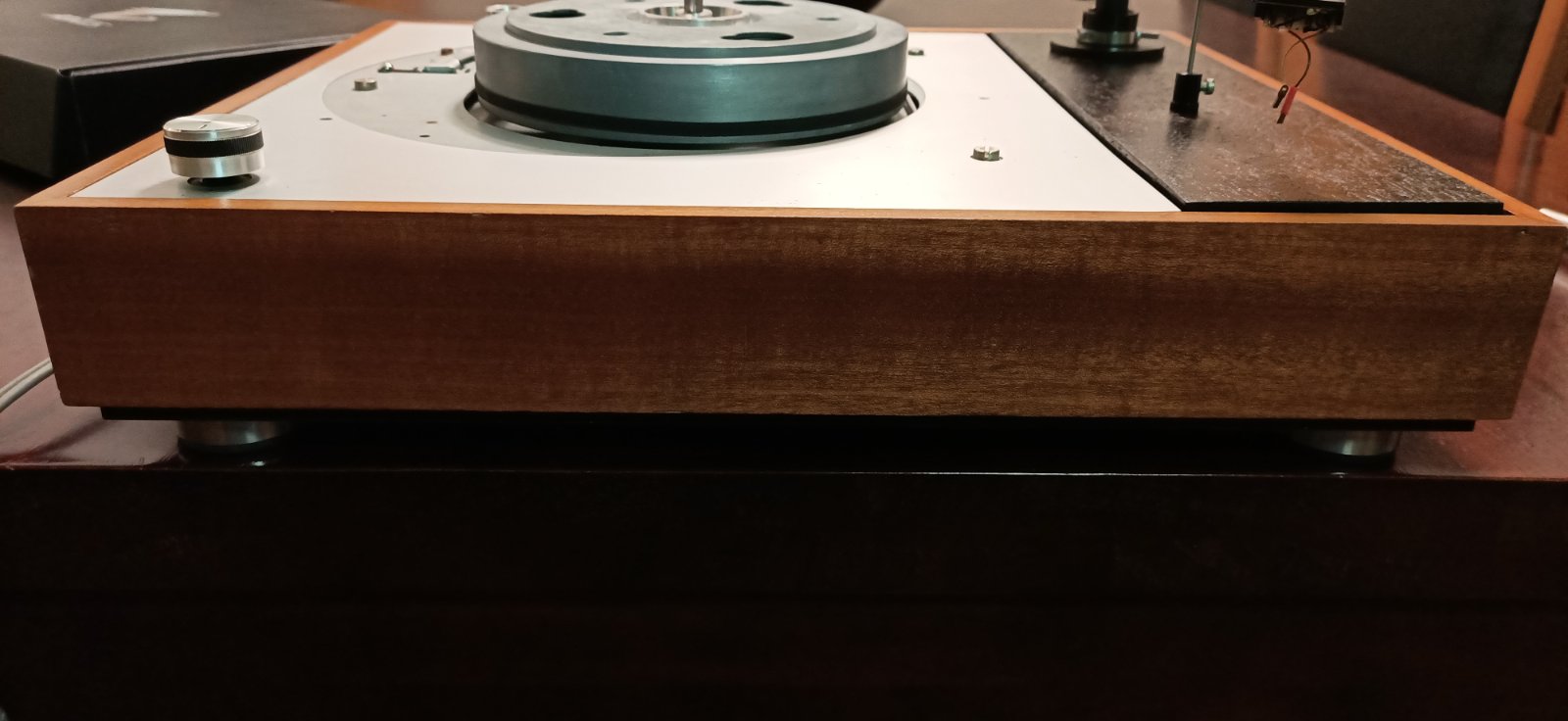

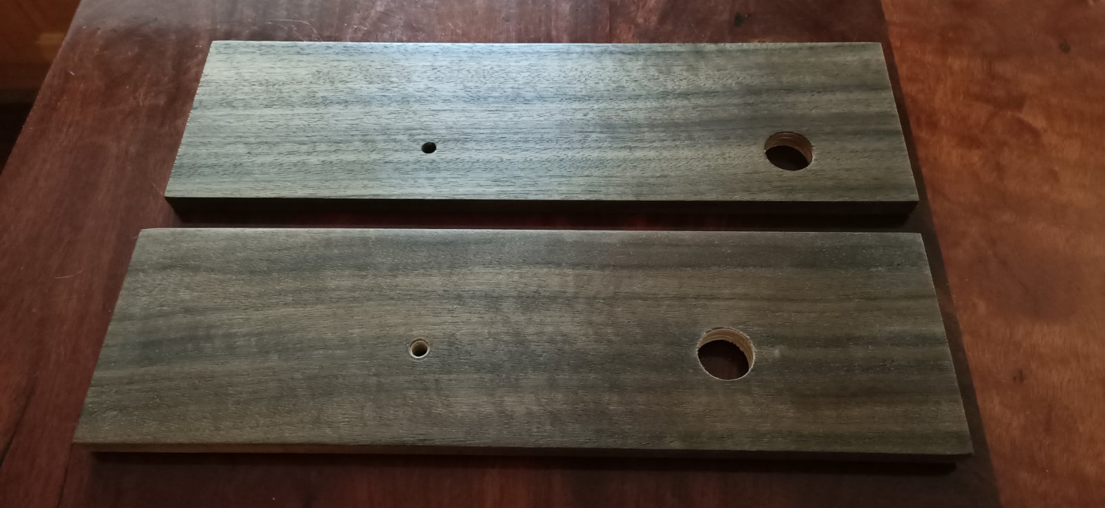

southern_tango Posted May 30, 2021 Author Posted May 30, 2021 So,been months since the last update on the Thorens ,so after making the second board ,posted a pic in a oage on Fb and comented about the 840 not fiting properly on it, a gentleman from UK asked if I wanted to swap the 840 for his 707 ,months oassed I got the arm a couple of months ago ( he still waiting on mine as it is miss located in post) Installed the 707 and it looked too much forward so today...armbord number 3 ...the ones before ,wrong measurements. Pluss added better feet ( at least visually)
