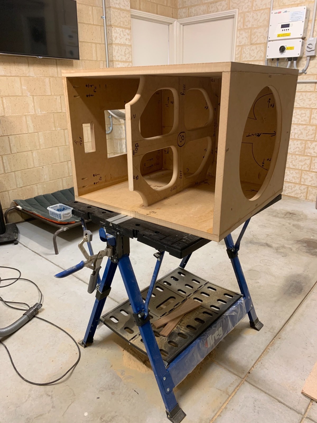

just thought l would share my DIY build. I did not have any means at the time to calculate volumes and performance so my cabinet size was a recommendation. I was told 6 cubic feet and sealed was the right size and anything over was a bonus.

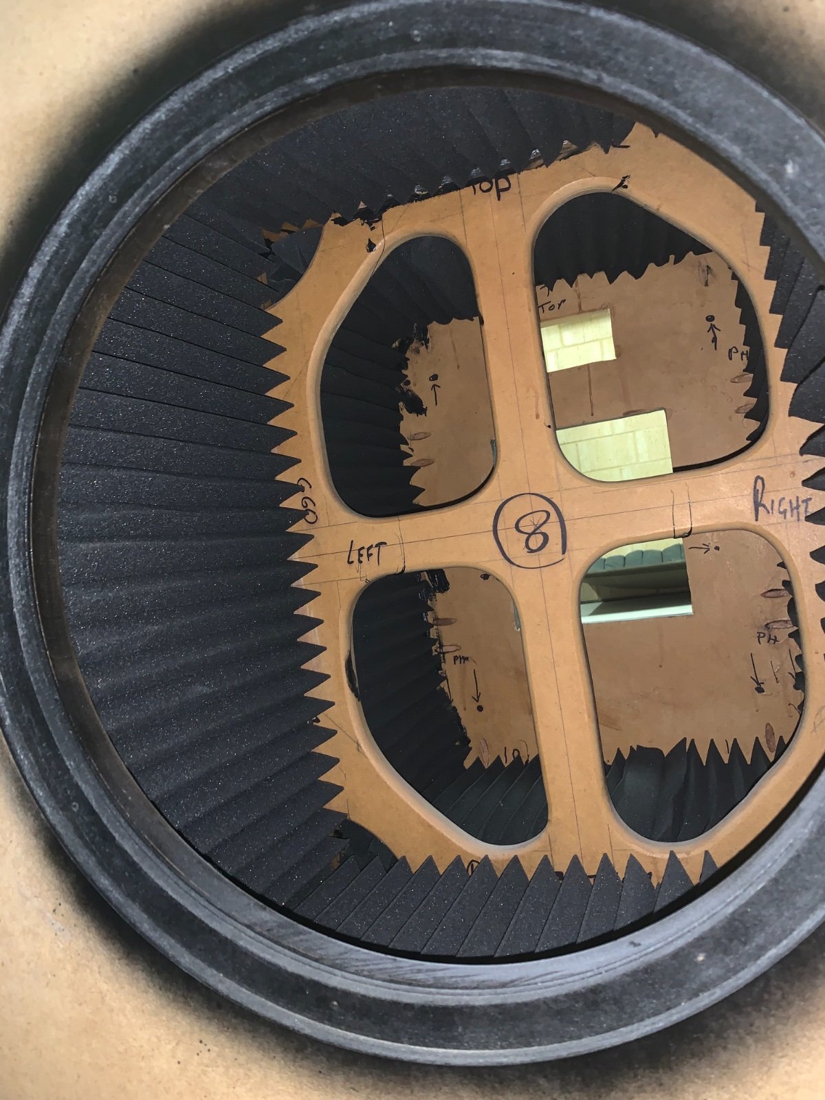

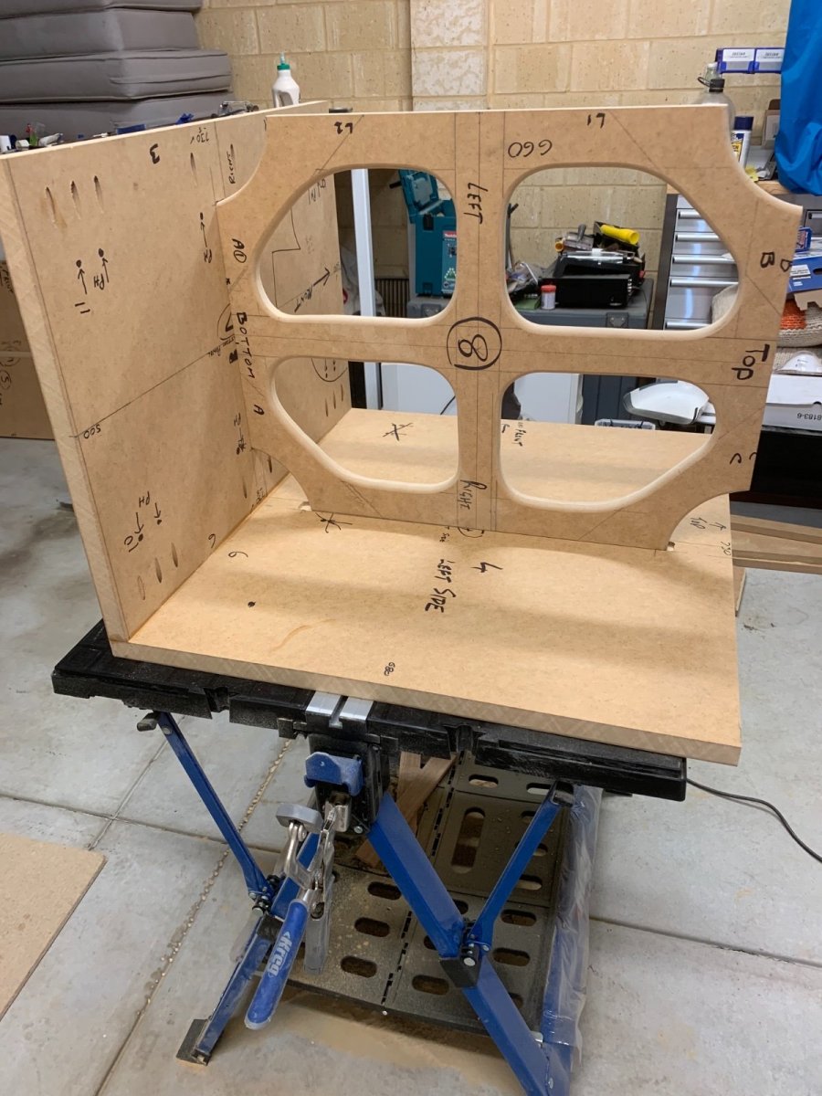

 I measured up my space and ended up with 550mm W  x.  700mm H. X. 750mm Deep . After driver displacement and bracing etc l am left with 211 ltr’s volume.

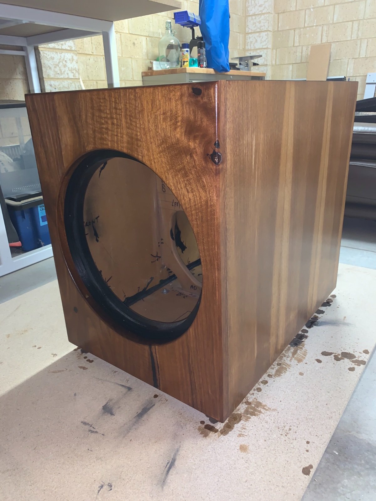

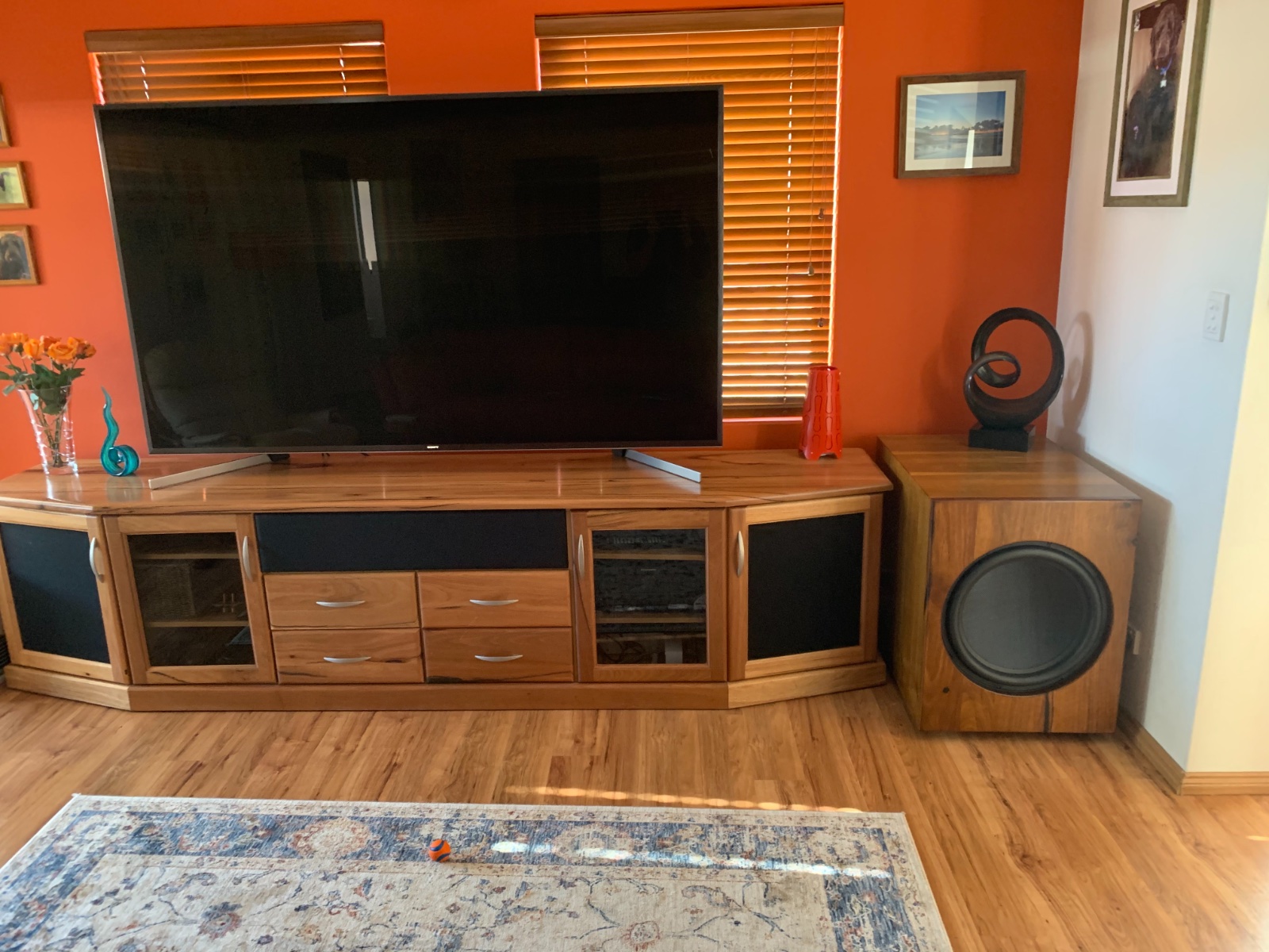

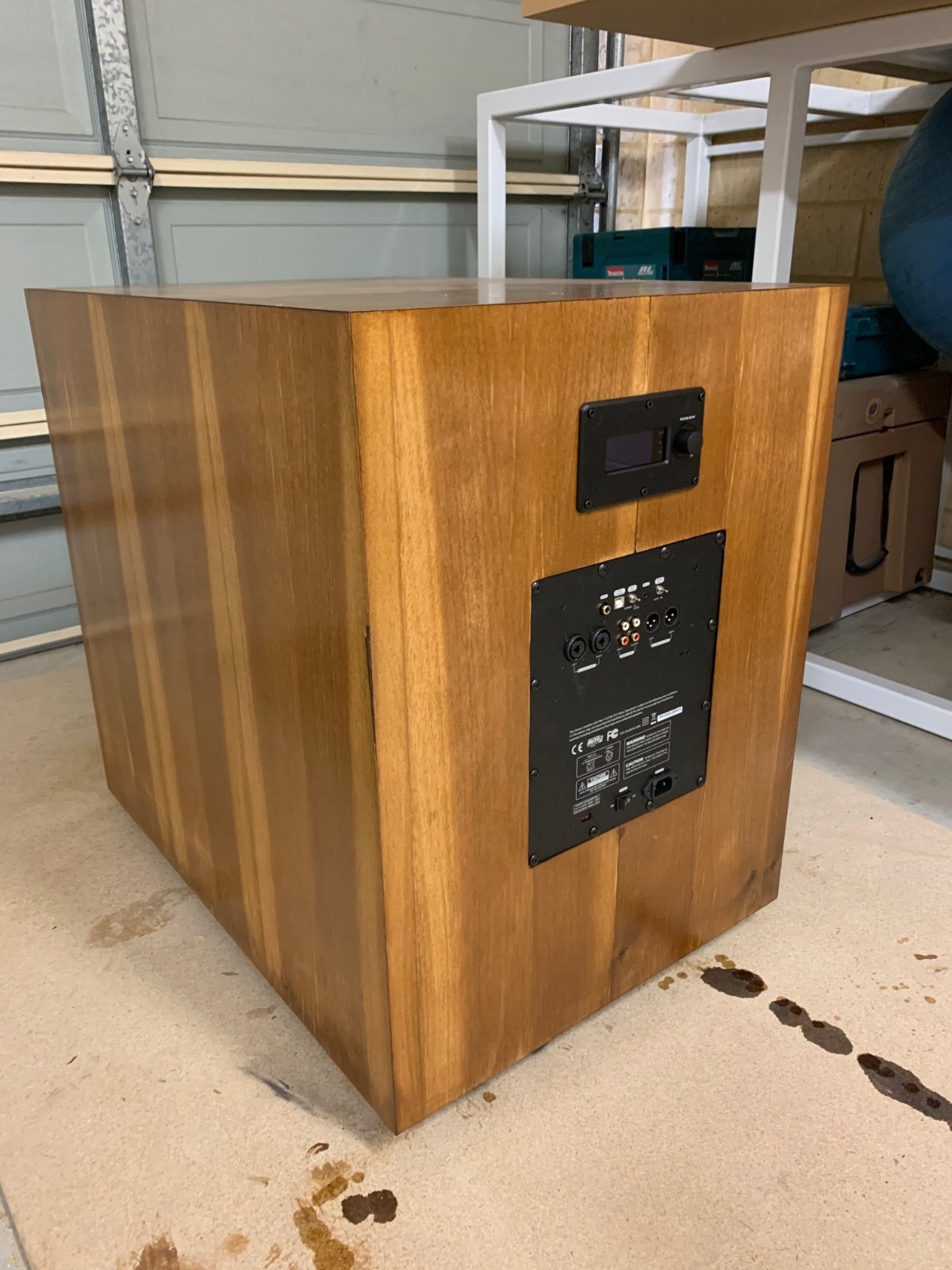

A few pictures of the build l laminated the cabinet to match the TV unit to keep the wife happy.
