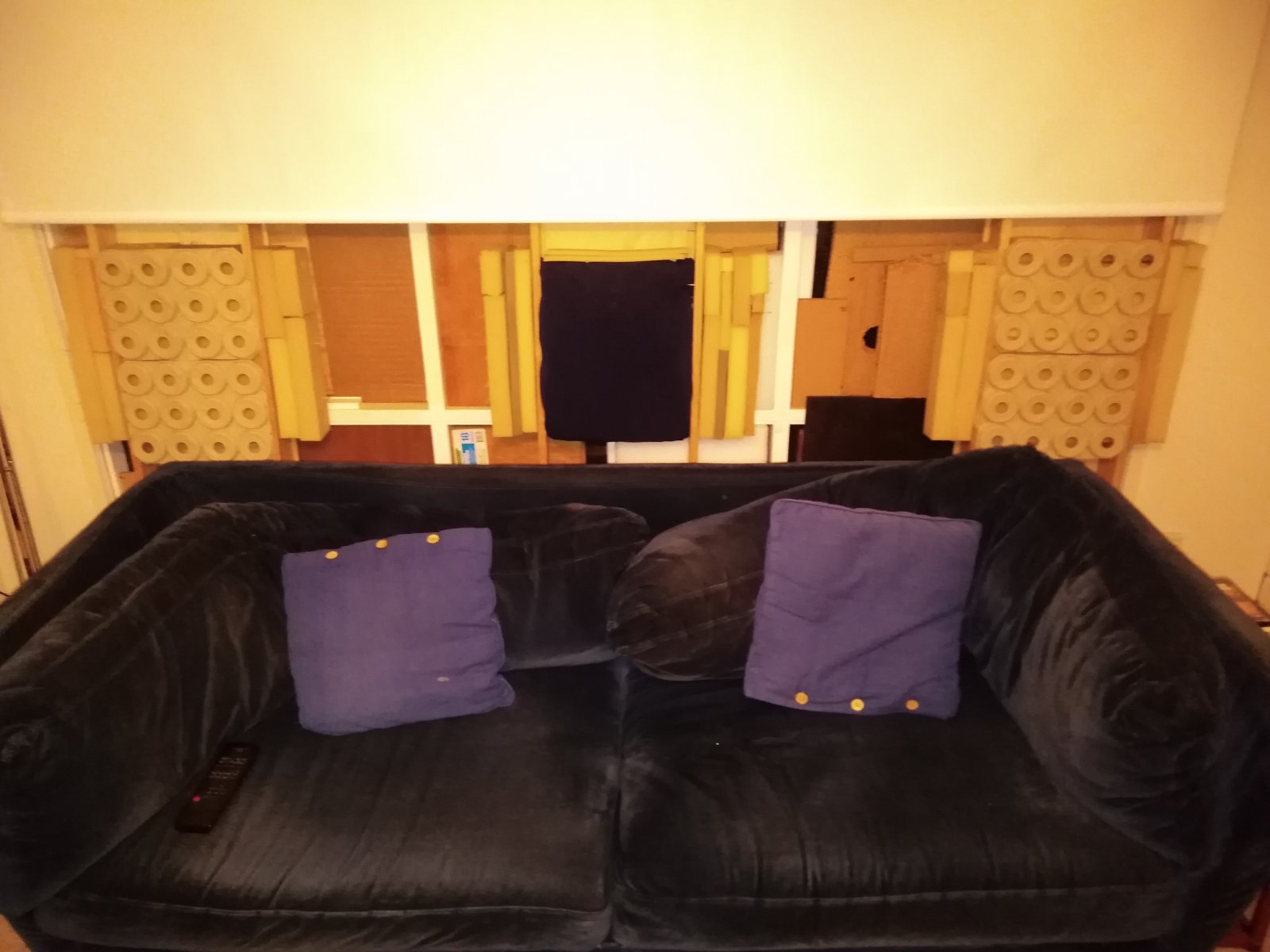

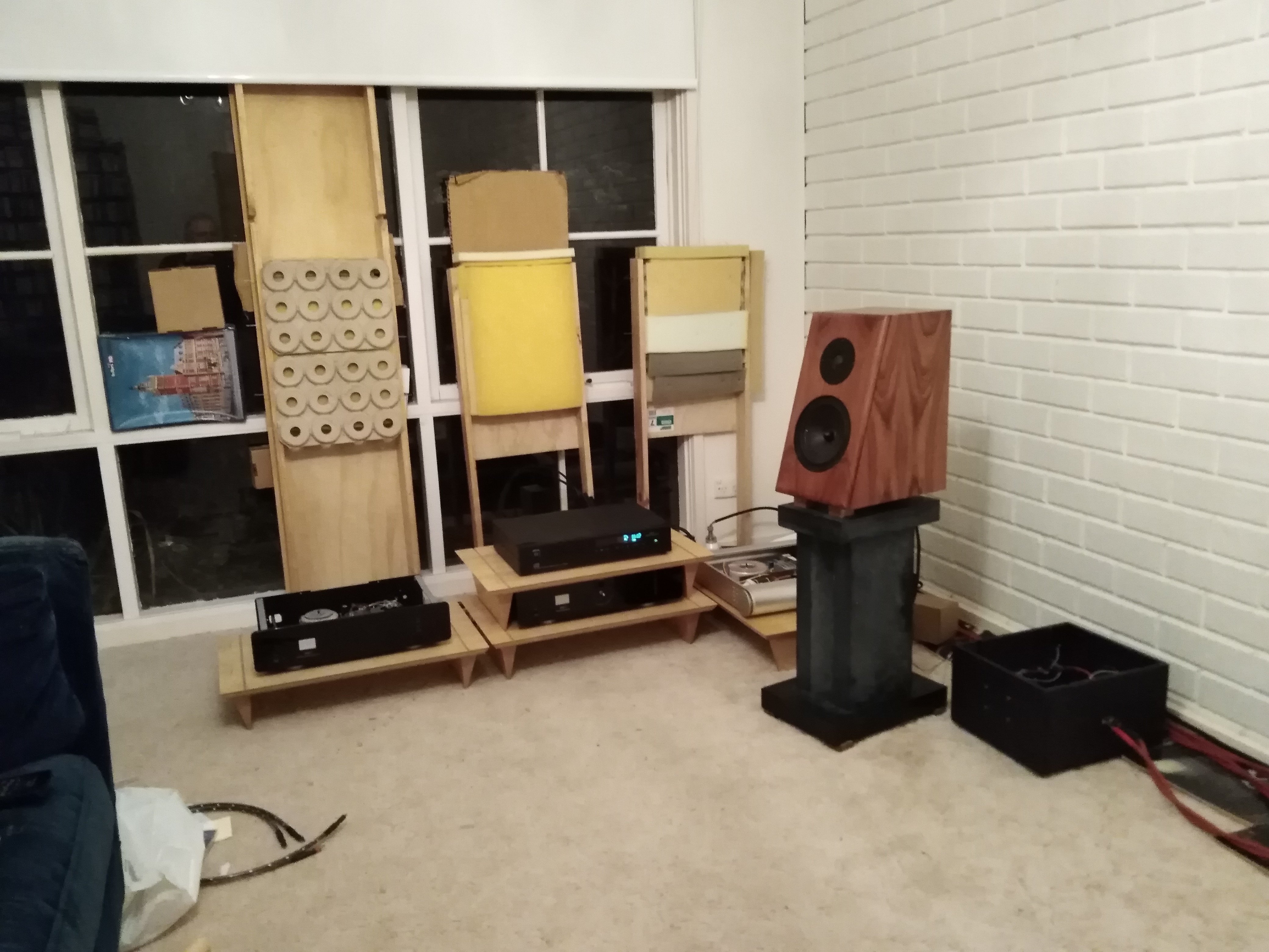

My humble little system

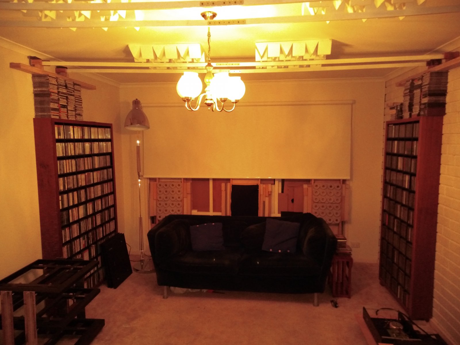

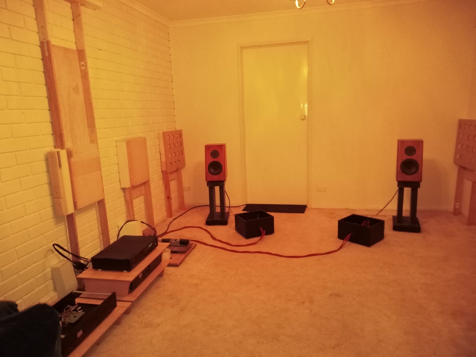

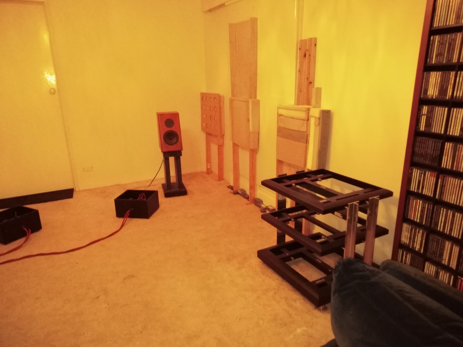

I moved house in April, so have been moving into a new room. I had to lose my big speakers as the room is small.  I have a small amount of acoustic treatment. Here are some photos.

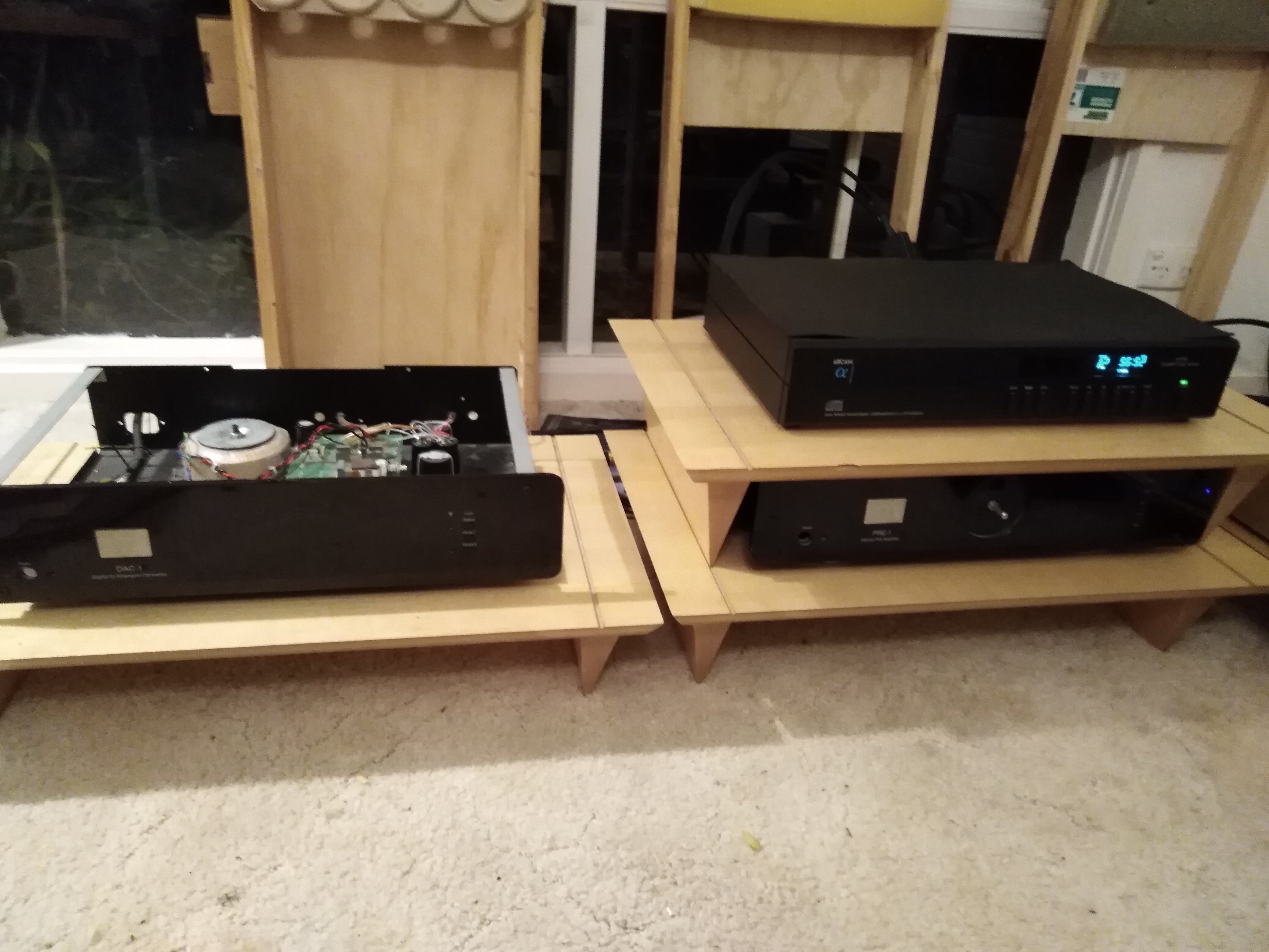

The racks are home made, based on Isoblue.
The equipment is :
Arcam Alpha cd player ( nos and modified )
XTC preamp
Orelle sa100 evo amp;
Orelle Orator speakers;
interconnects are xtc, speaker cables are VDH Revelation.

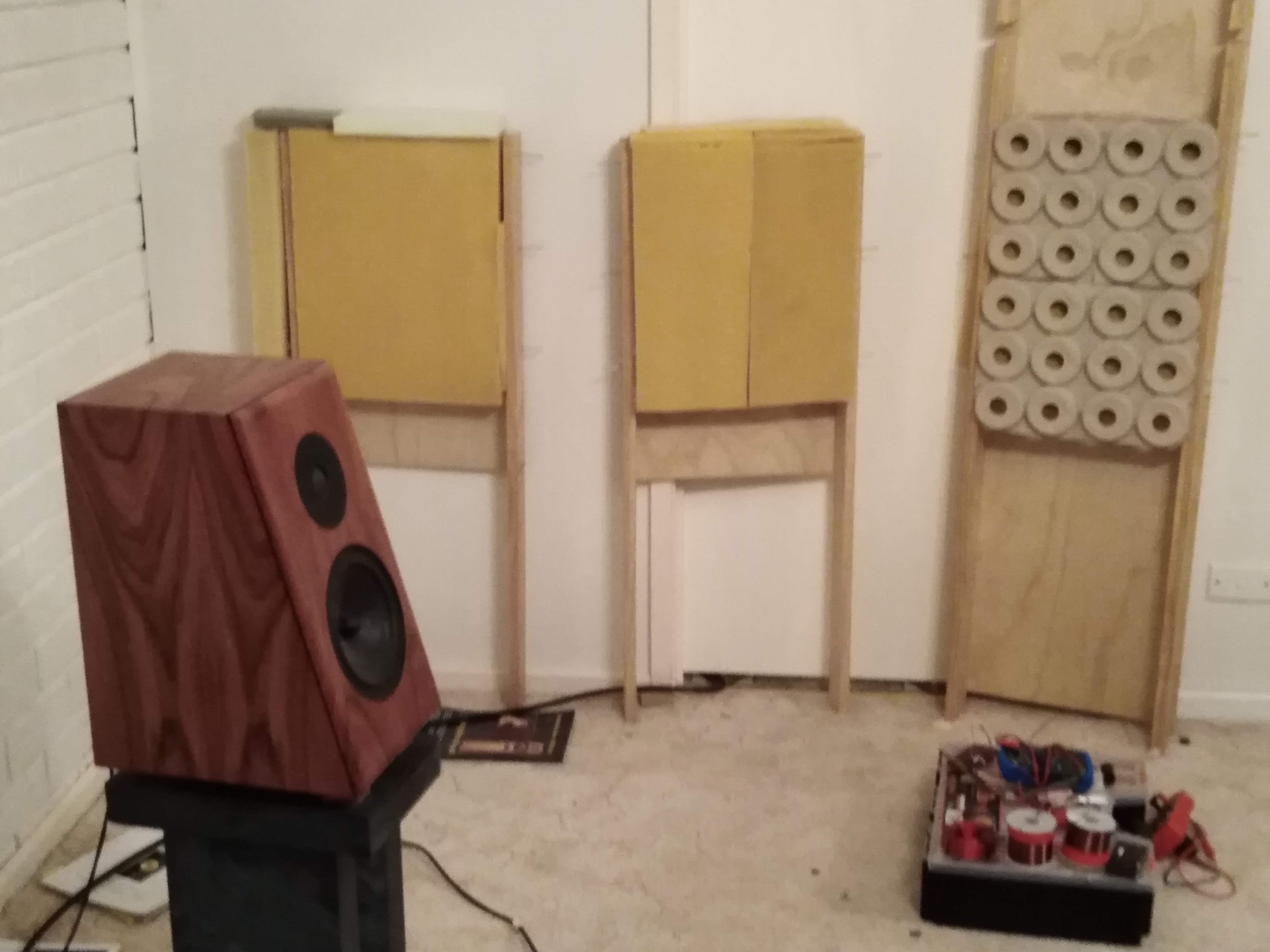

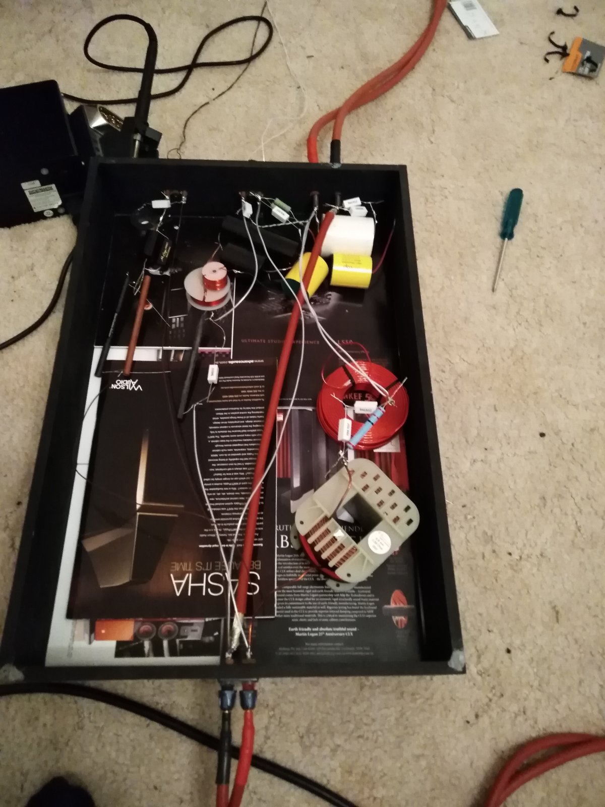

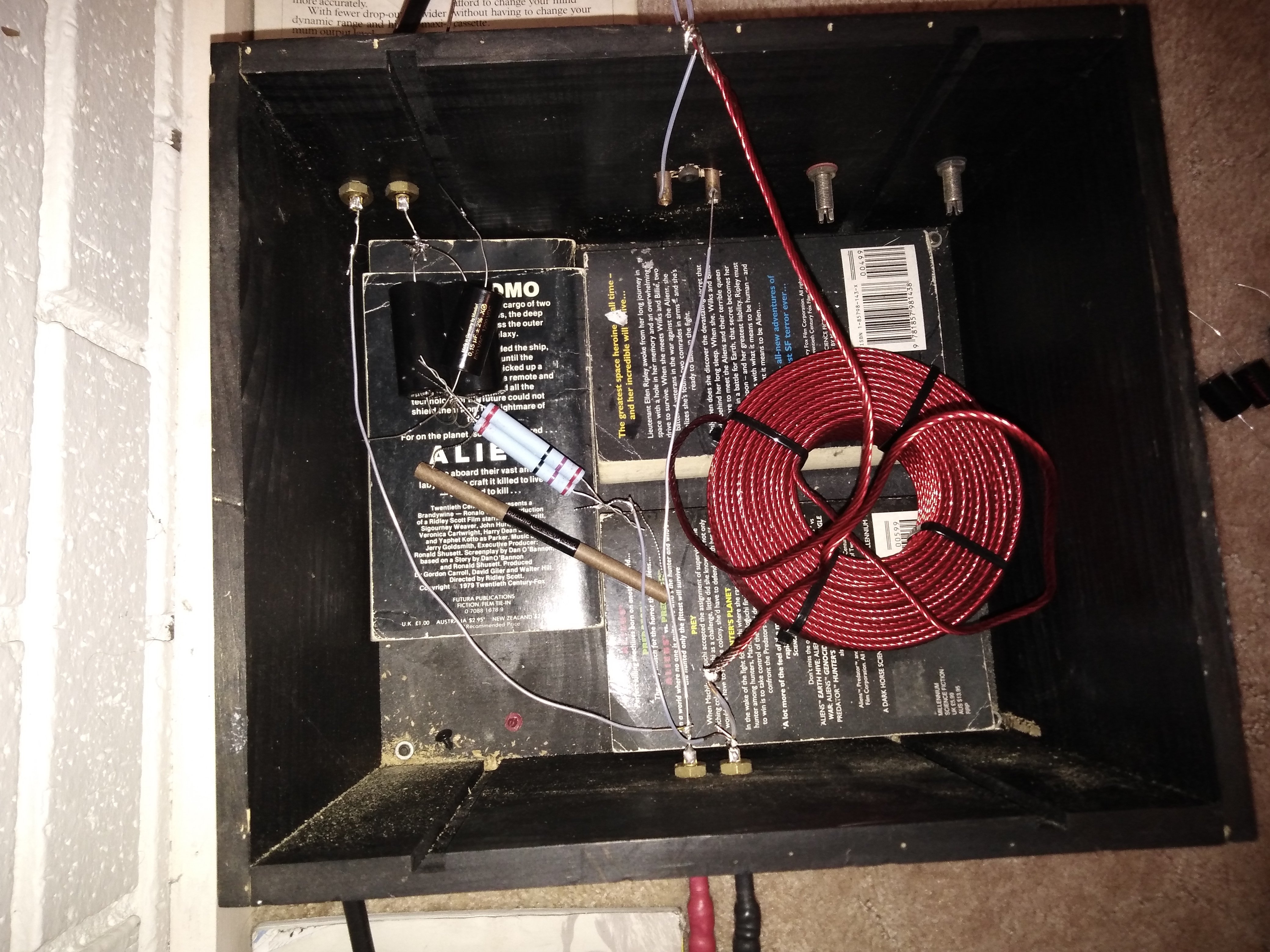

Here are a few more photos. A close up of the speakers,  then  electronics, and the crossover.

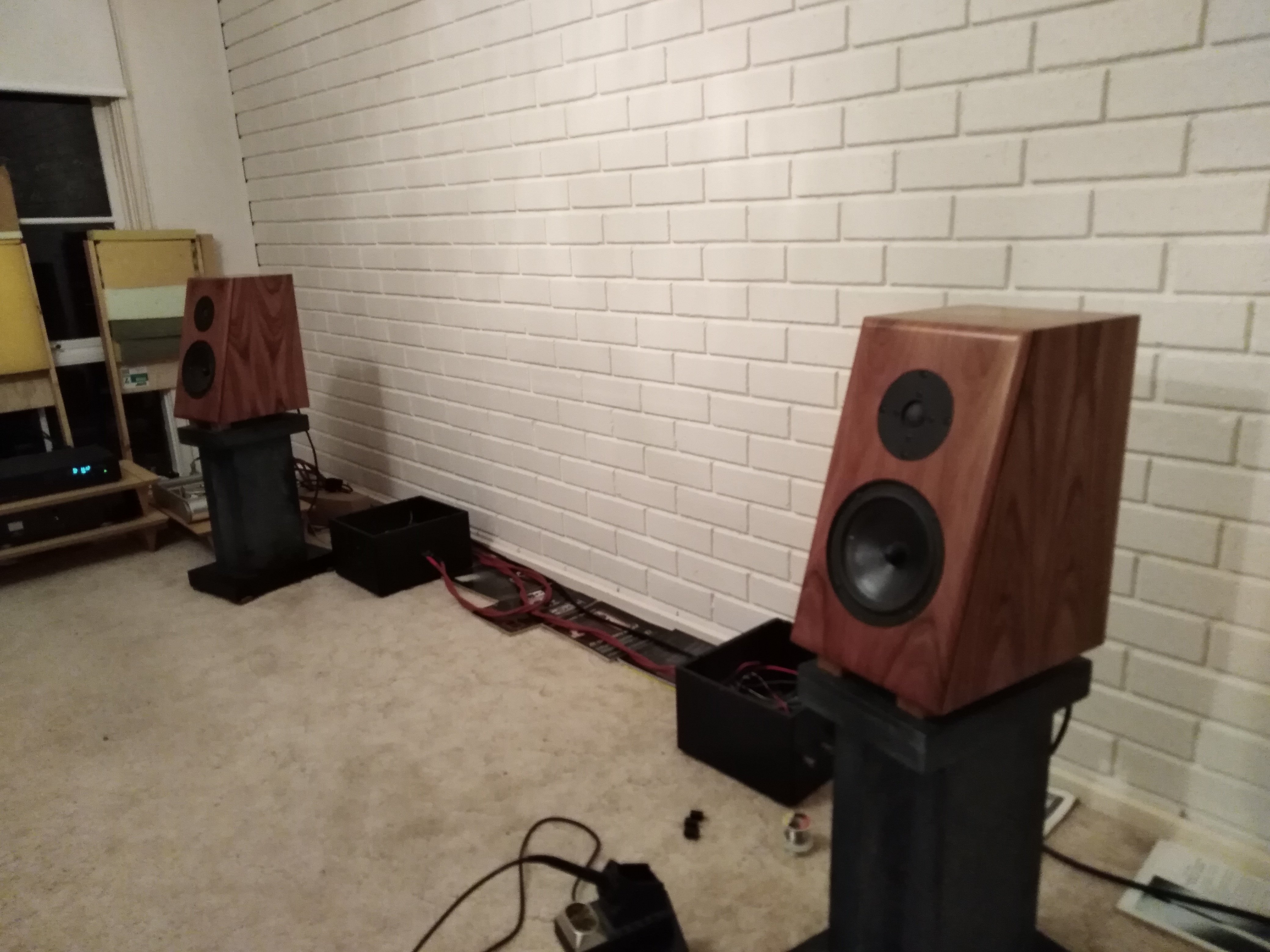

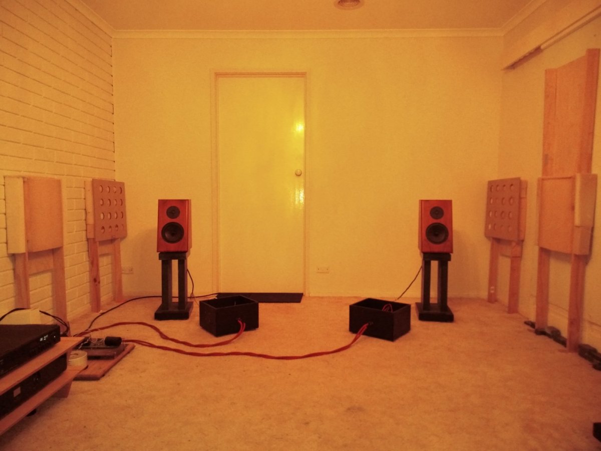

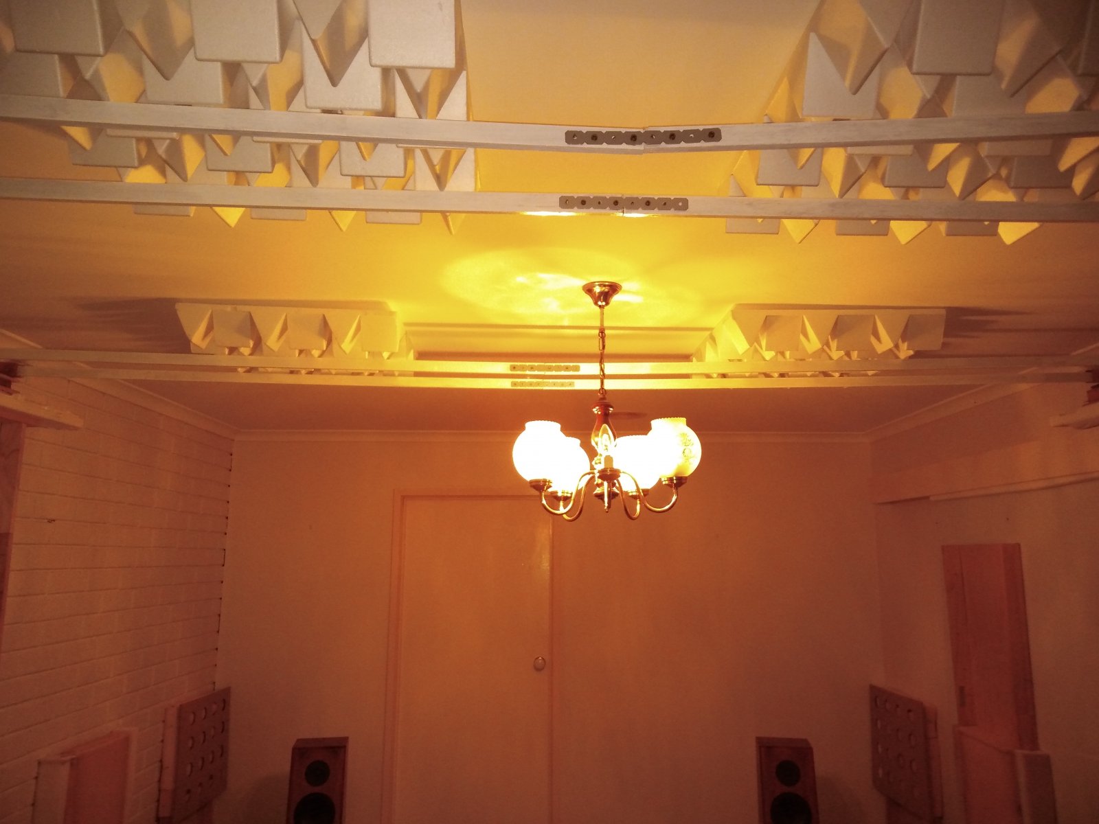

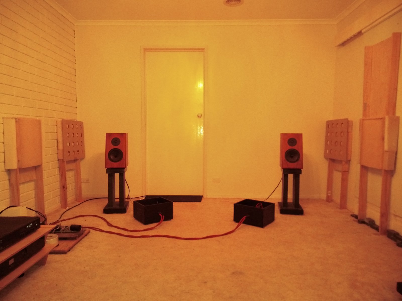

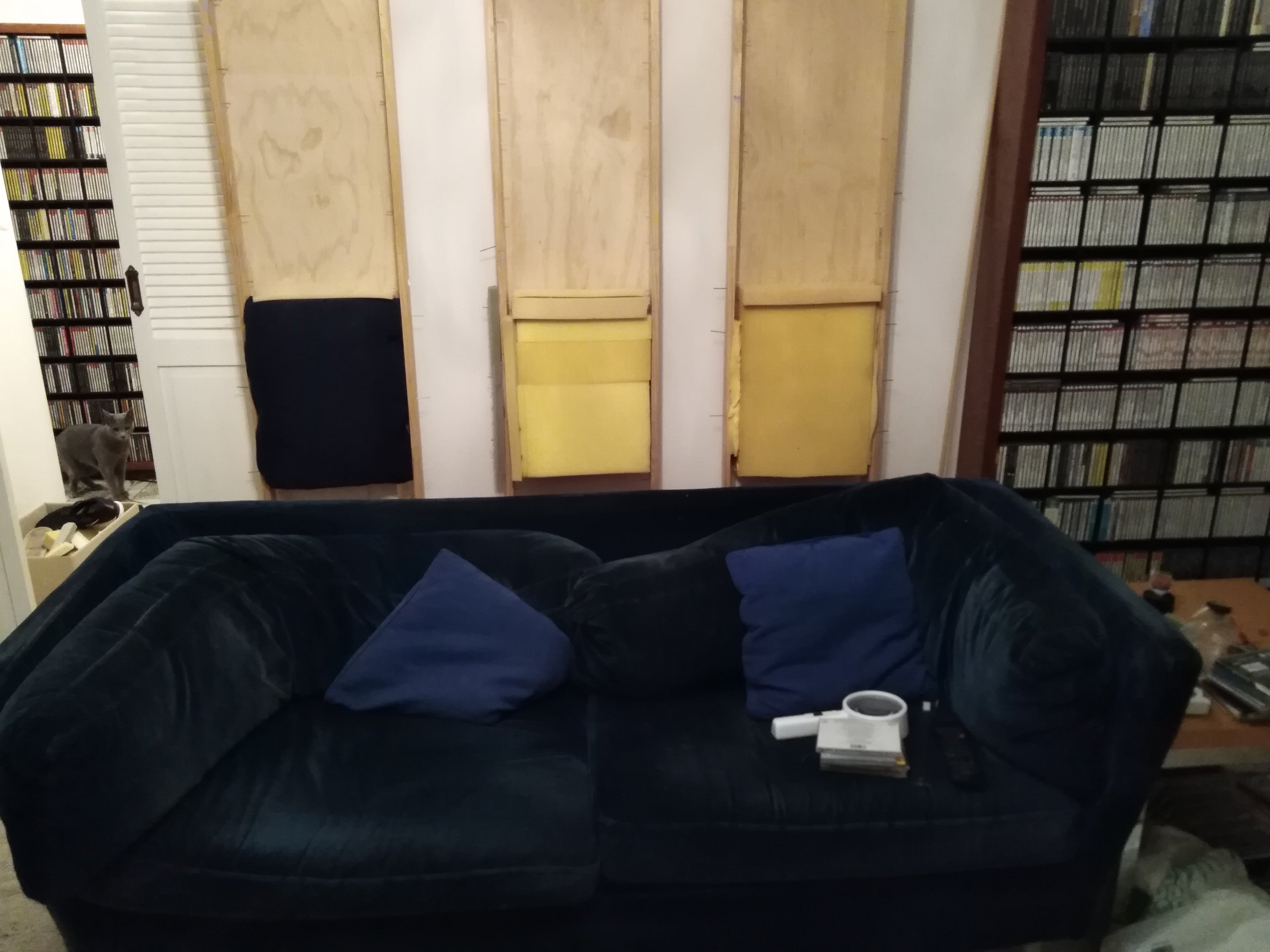

I swapped my room orientation from across to firing down the room, some months ago, installed my 150W (semi DIY) power amp, and have been playing with the room acoustics. Here are some photos taken today:

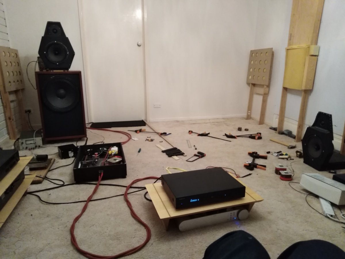

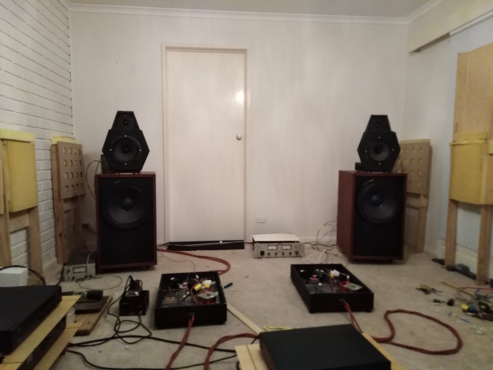

My system is down, my speakers are gone, and my room is a mess!

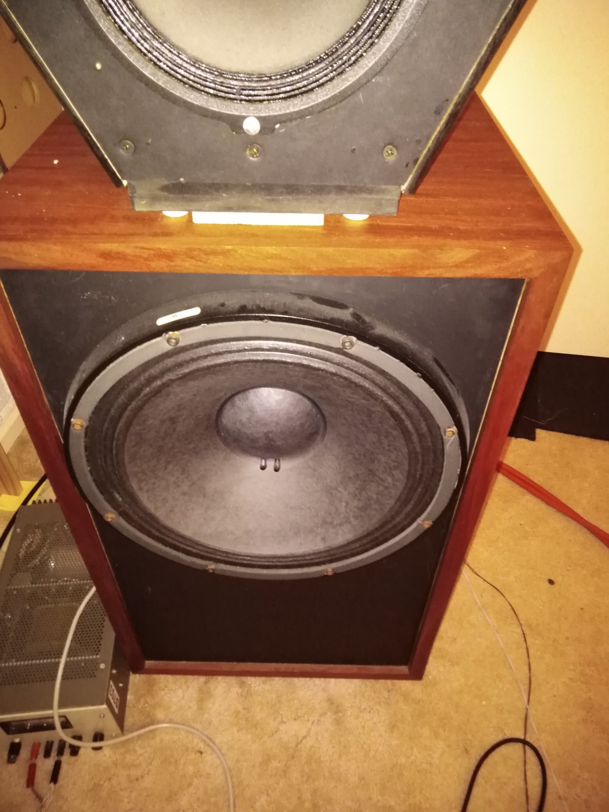

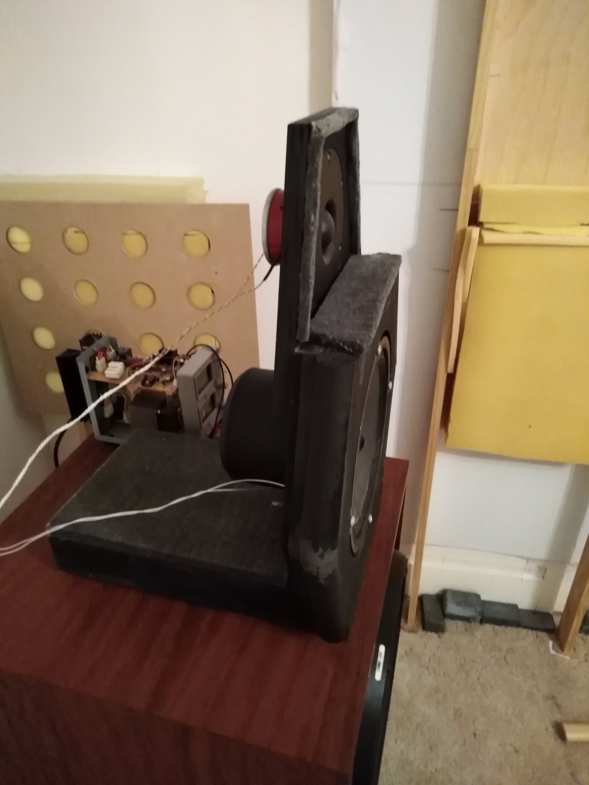

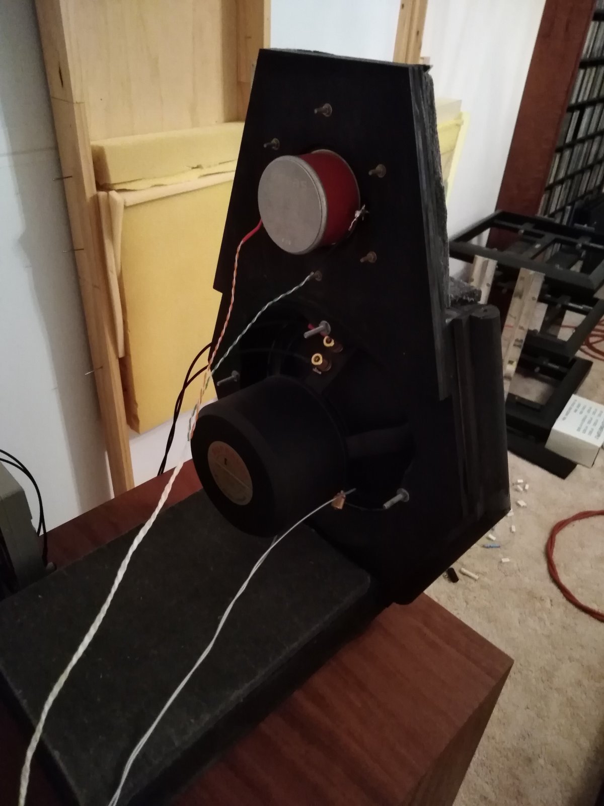

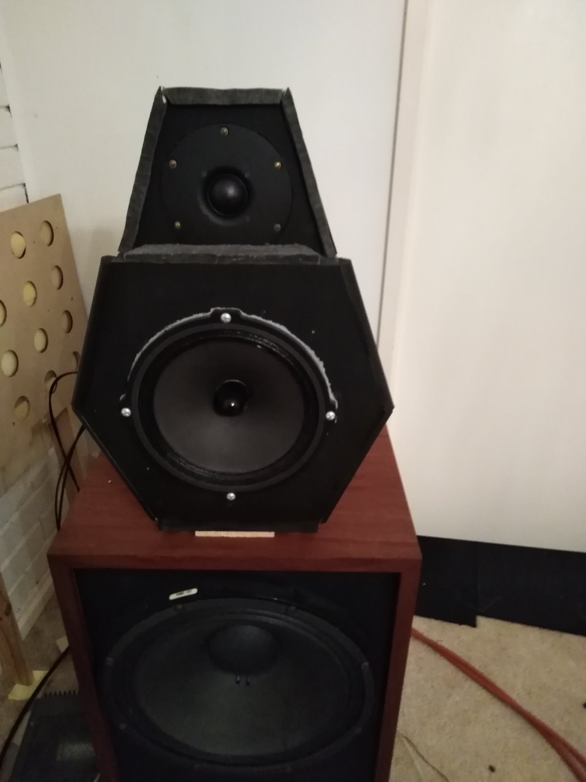

I am using the lockdown to finish a project that I started years ago: my partial open baffle speaker system.
The idea being to have a high efficiency speaker based around the Supravox 215 widebander in an open baffle, supported by a sealed 15" bass and a helper tweeter.
The speakers were built many years ago, but I did not complete the crossovers.
The drivers are listed below:
The Wolf Von Langa A150 15" bass field coil
The Supravox 215 EXC field coil wide bander
215 EXC Haut-parleur large bande 20W / 90 à 99dB / 4Ω - Supravox
The Seas Exotic T35 tweeter:
Photo of SEAS Exotic T35 X3-06 Tweeter with Alnico Magnet
The bass is in a sealed and brace 130 litre cabinet, while the Supravox and tweeter are mounted on a baffle - more pics to follow.

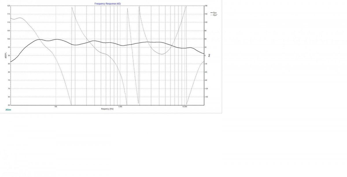

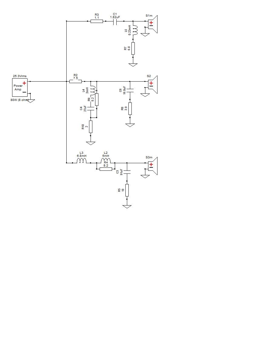

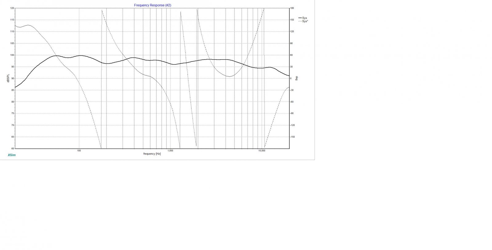

I have been using omnimic to do measurements, and Xsim to model the crossover.
I have then been listening to the one speaker, adjusting the crossover then remodeling.
here is the crossover schematic snapshot from Xsim (S1 tweeter, S2 Widebander, S3 Bass)
Here is the current modelled frequency response 1/3rd octave:

  • Author

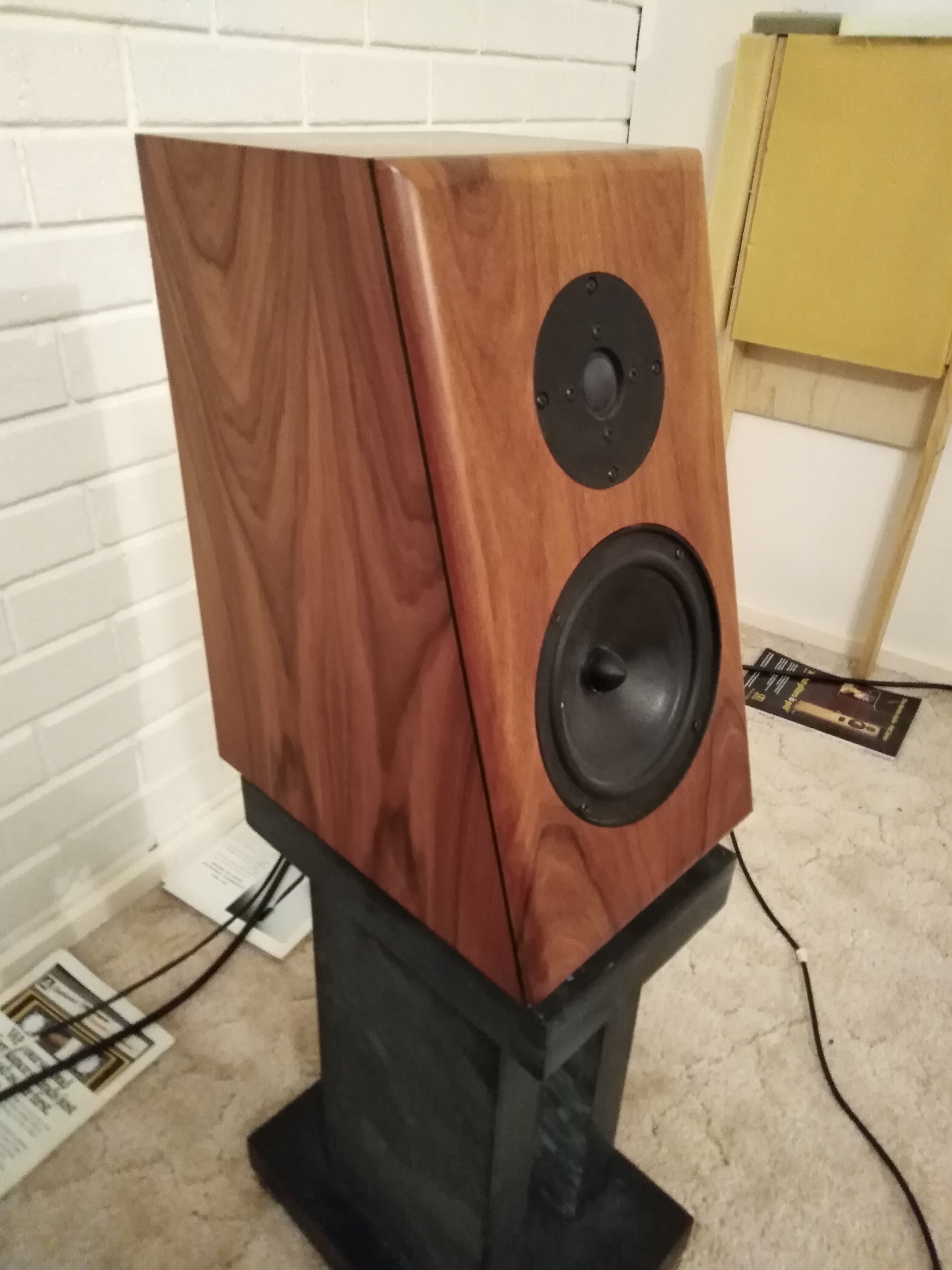

Some more pics:
