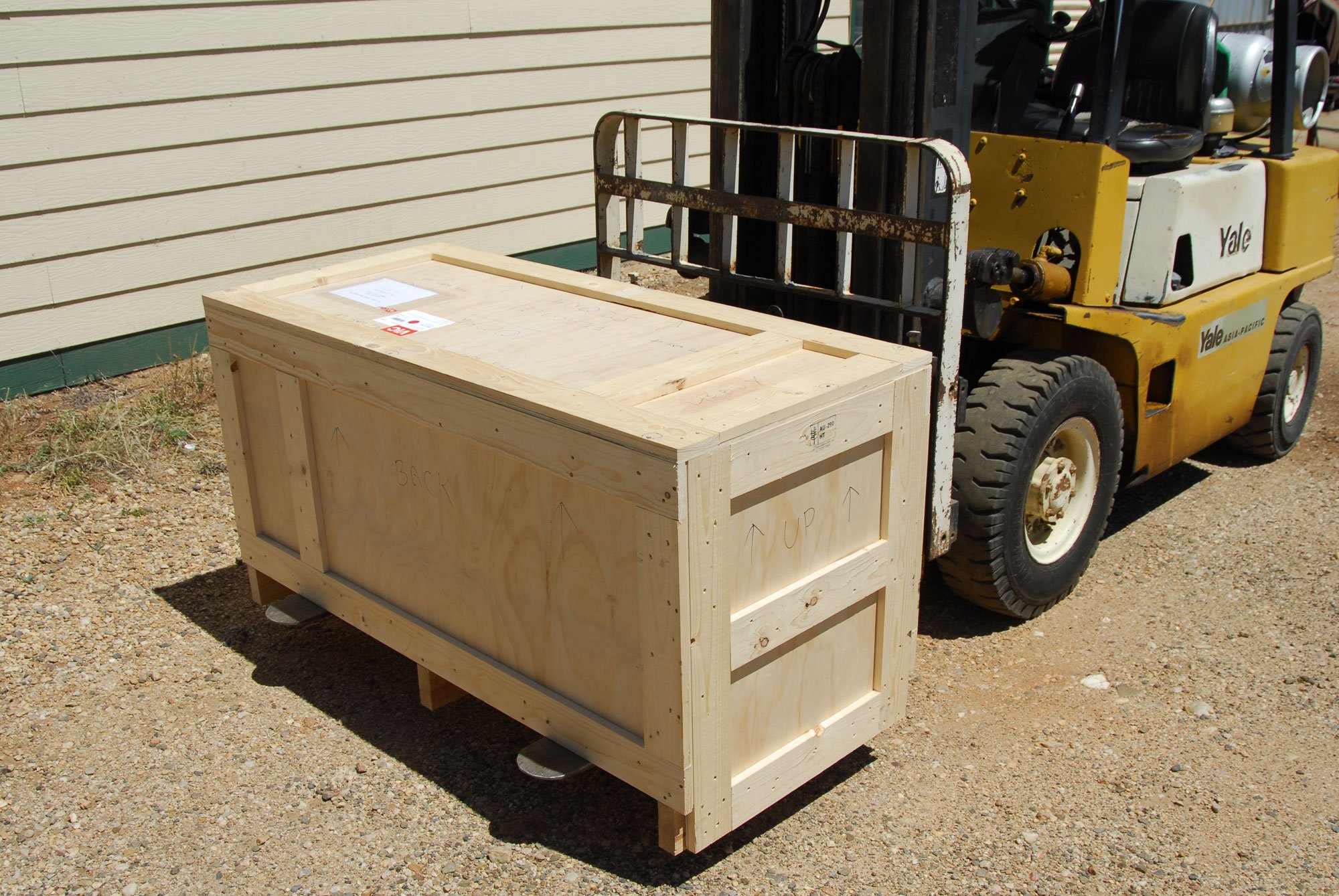

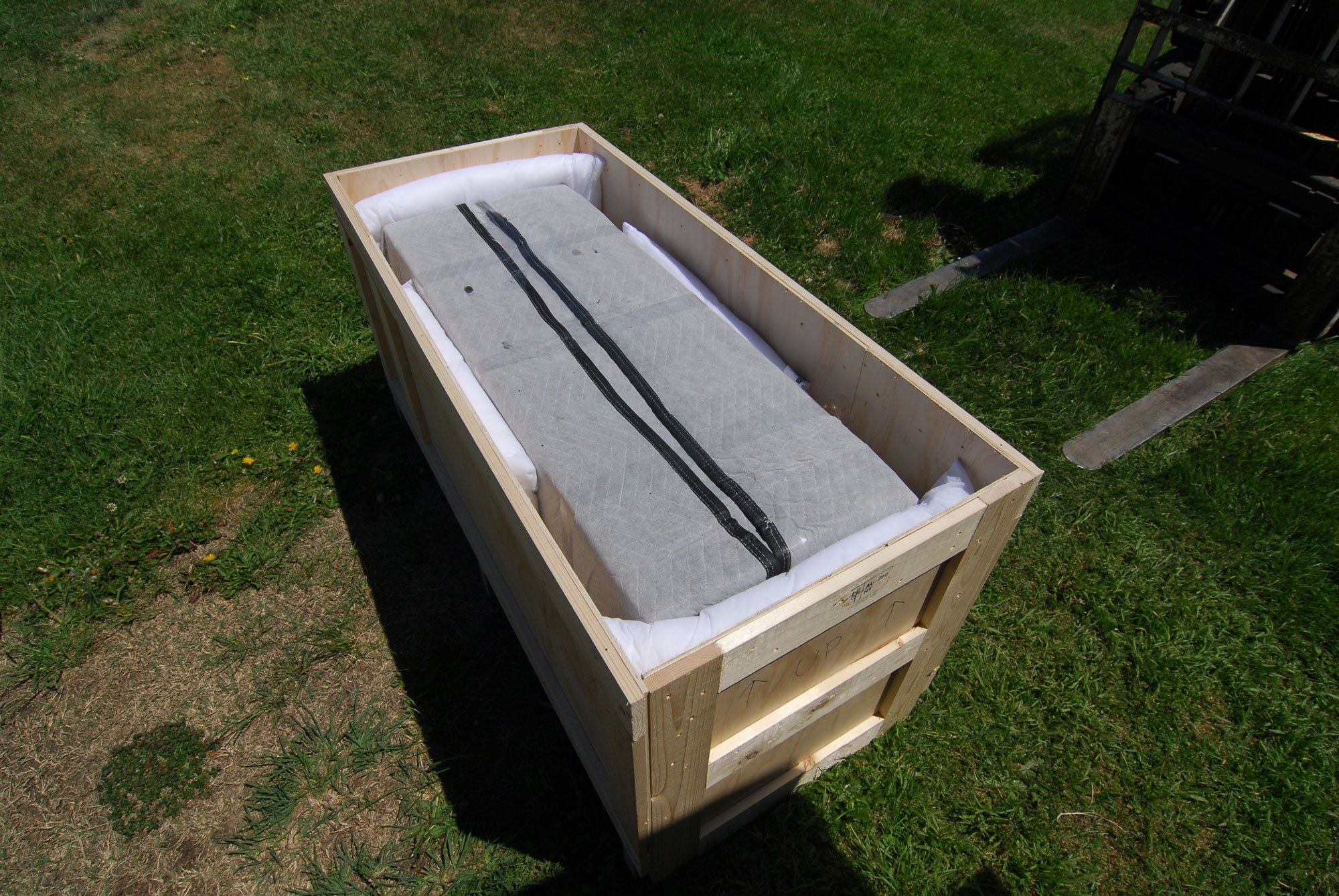

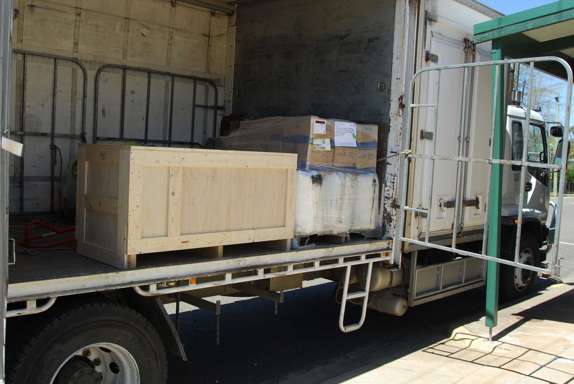

The speaker came in at 75KG......so a flimsy cardboard packing box wasn't going to cut it. Matthew had a custom packing crate made and used a very well regarded freight company to get it to me.

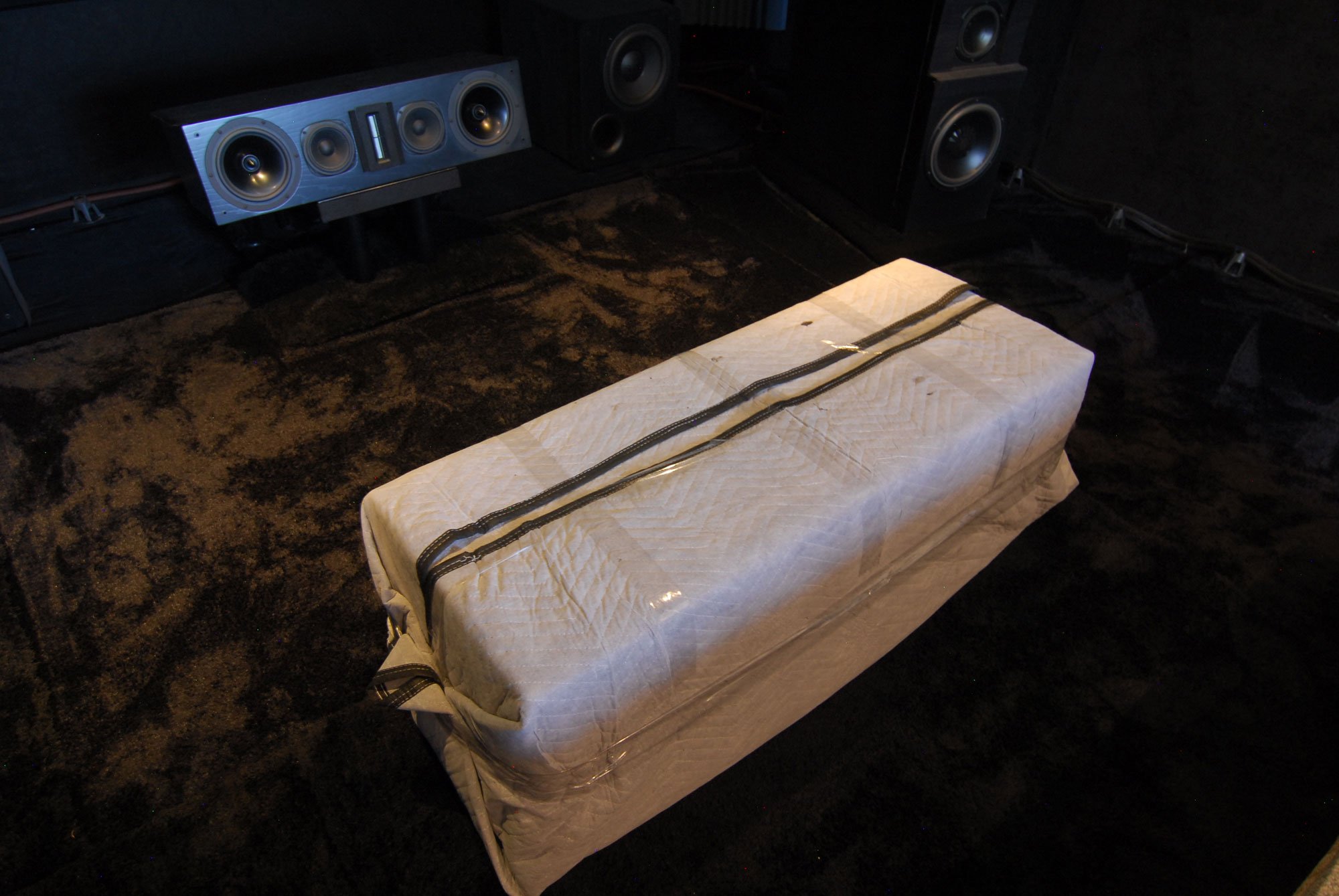

On receiving the speaker it was all good from the word go.....the crate ensured it got here 100% damage free....internal packing was excellent.

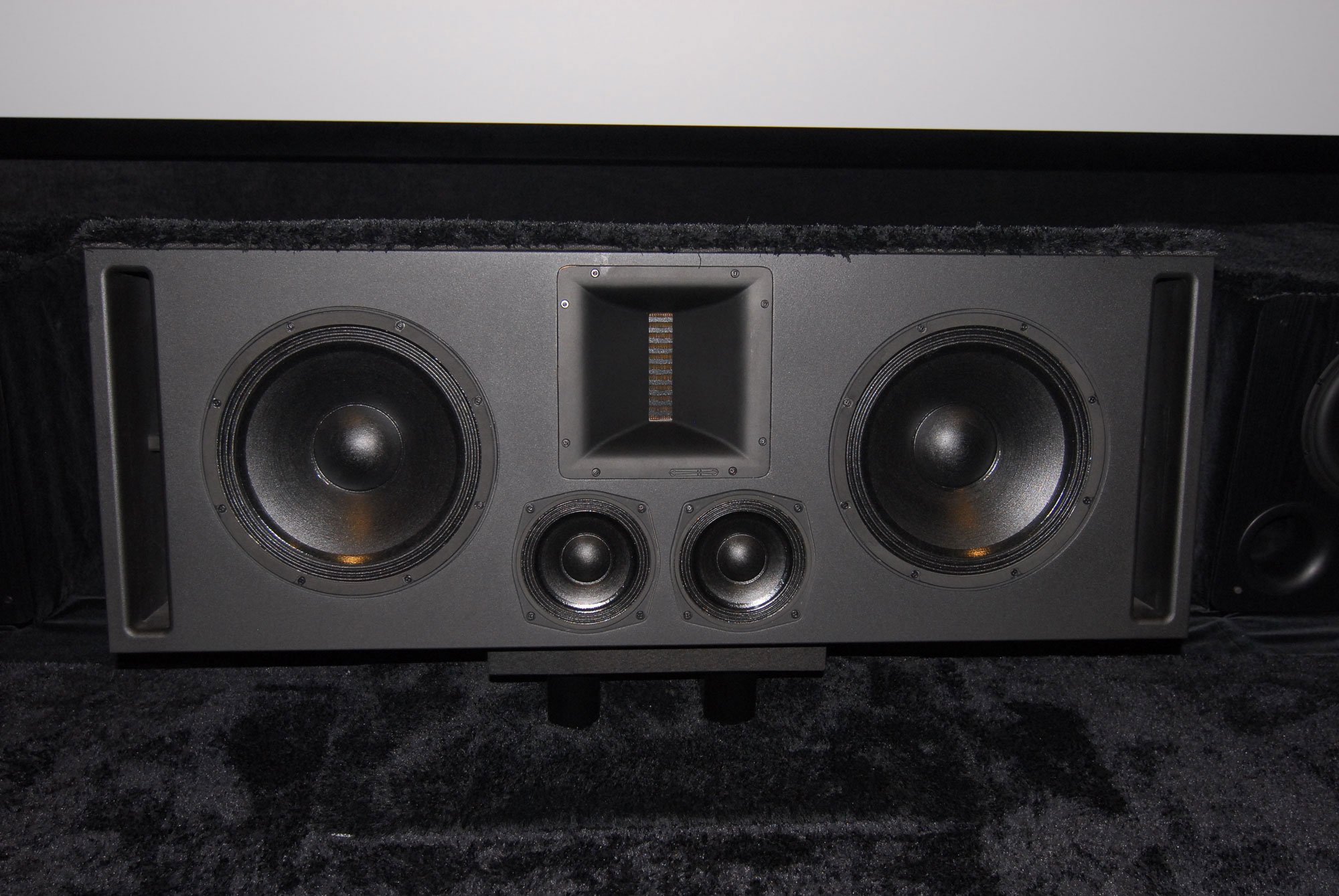

Results...... to sum it up ... it the BEST centre i have had in my system by a margin !
VERY happy with the results/ performance ........lets just say some "Brand Name"  manufactures should be ashamed of the prices they are asking of their speakers!!!

very nice woofer !

That’s an impressive looking beast. Well done for looking outside the square. It seems to have paid off handsomely. M

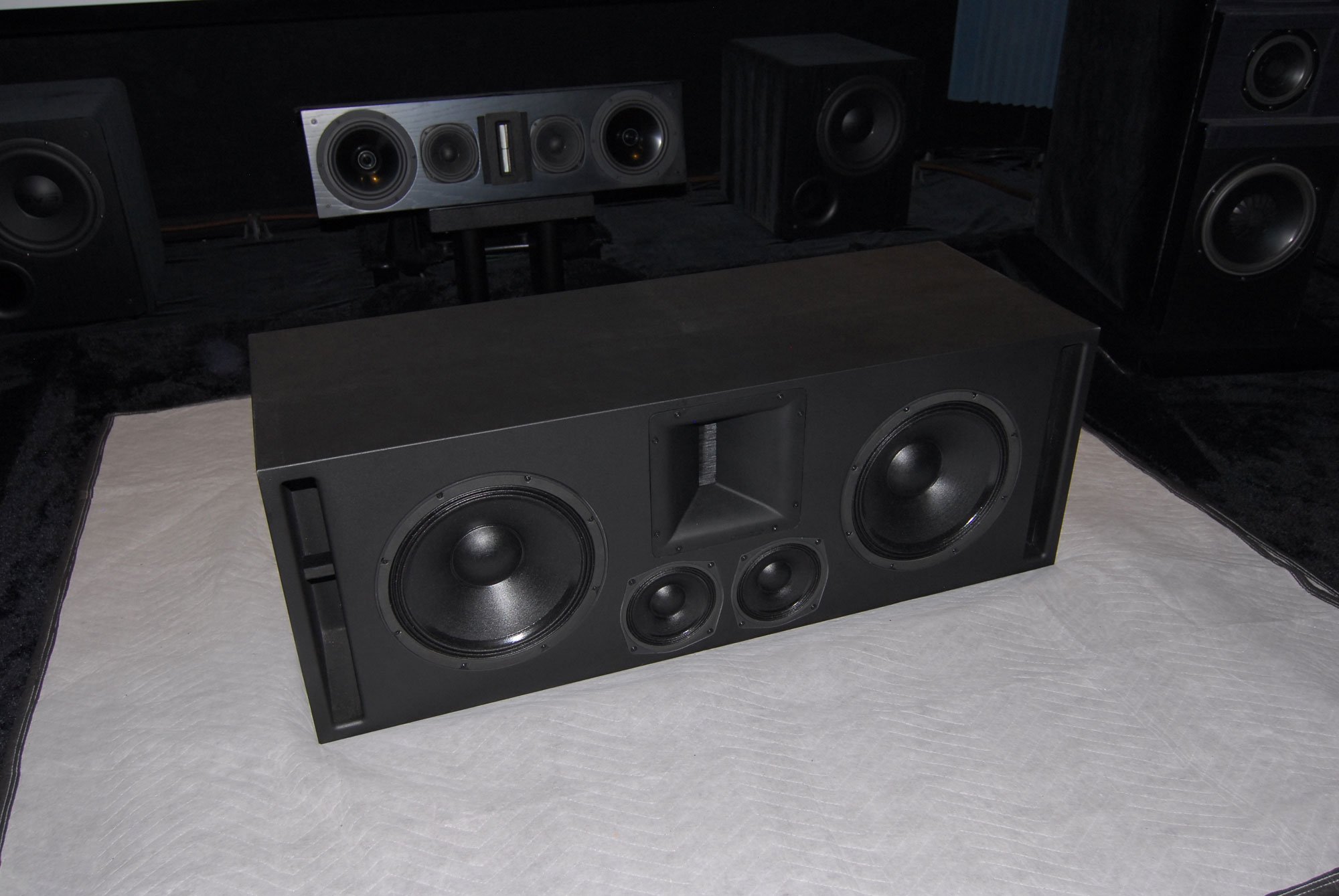

Hi, a few people have asked, so a little more info on this particular speaker...
The final price on this particular speaker when it becomes available will be in the neighbourhood of $4,000.
The Drivers are:
2x 12" Faital 12FH520 16ohm in Parallel Low Freq Woofers - https://faitalpro.com/en/products/LF_Loudspeakers/product_details/index.php?id=151050111
2x Faital 6PR160 8ohm in Parallel Mids - https://faitalpro.com/en/products/LF_Loudspeakers/product_details/index.php?id=151050110
1x Beyma TPL150H AMT Tweeter. - http://beyma.com/products/diapharagmtweeters/1TPL15H8
Speaker impedance is about 4ohm, lowest it drops is about 3.5ohm. It would probably be able to handle north of 1000w. Its final sensitivity would be extremely close to 100db/watt, so by the time you throw 25 watts at the speaker, you are already well over 105db reference levels. Your ears are going to give up before this speaker will, it should be good for 125db+.
The Box is constructed of 25mm MDF, with a 36mm front baffle, and a fair bit of internal bracing using 18mm MDF. 76KG Weight loaded with drivers. The box itself is about 60KG.
The Crossover points are 300 and 1800hz. In room, its pretty much -3db at 35hz and has a steady decline over the whole range downward (a little like the harman curve) and a bit steeper roll off in the tweeter at about 8khz. This is a Home Theatre Center obviously, with a tweeter like this being behind a waveguide I have found its best to have it a bit more laid back in the very top end.

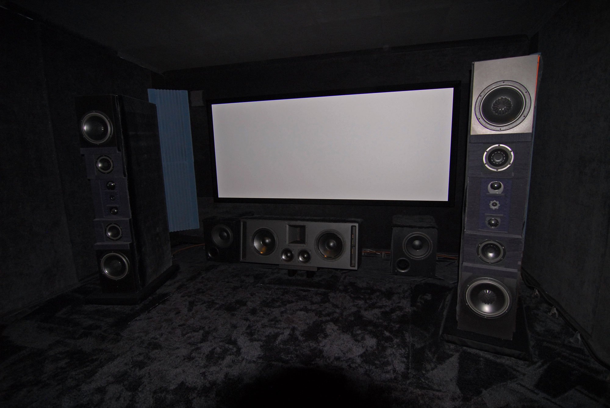

I have been building using this tweeter and these LF Woofers for some time now, I believe this is a really exceptional AMT tweeter. I currently use 7 of them all around me in my modest home theatre room.
My L/R consist of a large scale modular tower system which is fully active 3-way, standing 2m tall. I am using 2x Faital 15FH520's for LF in that build, a Beyma 12p80Ndv2 for the Mid (amazing mid woofer) and the TPL 150H Tweeter. The crossover points for that speaker is 200/1200hz. My current personal Center is using the same Beyma mid as mu large towers, and the same 12FH520's from Woofers, Center.
Here is my room, and my other speakers currently,
The 6-point averaged response of that particular active speaker.
The 'Rears' (Which are easily big enough to be a lot of peoples L/R) are an MTM configuration using the TPL150H Crossing at 1200hz to 2x Faital 8PR200 Woofers.

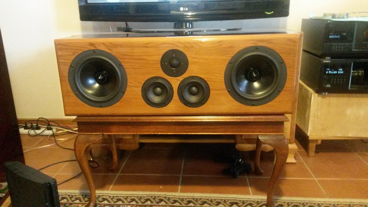

@wooferocau The centre your replacing this one with who made that and what design is it.
It looks similar to mine which is a Jim Holtz Statement centre.
I nearly made a centre with 12in drivers to match my mains and sort of wished I had.
  • Author
The just installed speaker is a "Javelin Audio" ...see above post by Matthew...
Previous centre was an " Adelaide Speakers "
Its interesting....... both the "Custom"  NOT "Big Branded" speakers have outperformed some very high end/high priced centre speakers that  i have had here.. ?
