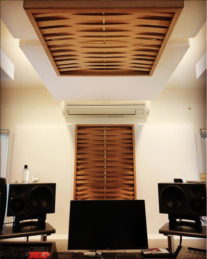

lowpoke Posted August 30, 2018 Posted August 30, 2018 (edited) I'm a little late to the party on this one, but if you're interested I can put you in touch with a local craftsman who has just made some clouds and diffusers for a local sound engineer's home studio. Here's a pic. Clouds can be seen above the diffuser. Snd me a PM if you want his contact info. Edited August 30, 2018 by lowpoke 2
cyberkank Posted September 4, 2018 Author Posted September 4, 2018 On 30/08/2018 at 2:57 PM, lowpoke said: I'm a little late to the party on this one, but if you're interested I can put you in touch with a local craftsman who has just made some clouds and diffusers for a local sound engineer's home studio. Here's a pic. Clouds can be seen above the diffuser. Snd me a PM if you want his contact info. Hi, that would be great. Can you PM me his detail?
