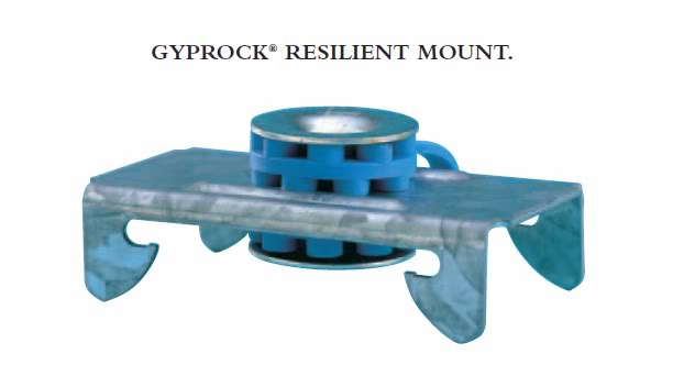

5a8a3c86a7ac6_resilientmount1.jpg.2a3fbb14a916443216d0d35e96851f10.jpg5a8a3c8aa3715_resilientmount2.jpg.f3b24d7e06db604ccb000befa75af1c4.jpg

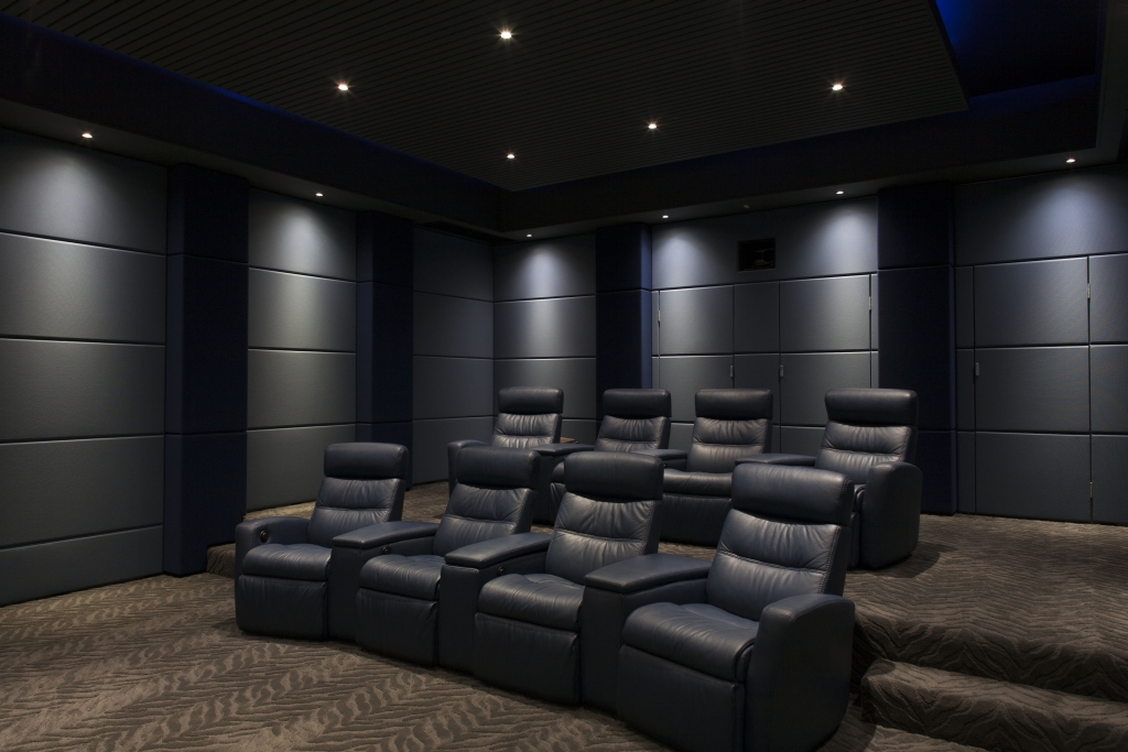

This looks so inviting. Very lovely space. well done! :wub::wub:
Hugely impressive Peter , a beautiful space.
That is CRAZY ,  in a good, good, envious way
Amazing space peter, just wow!!

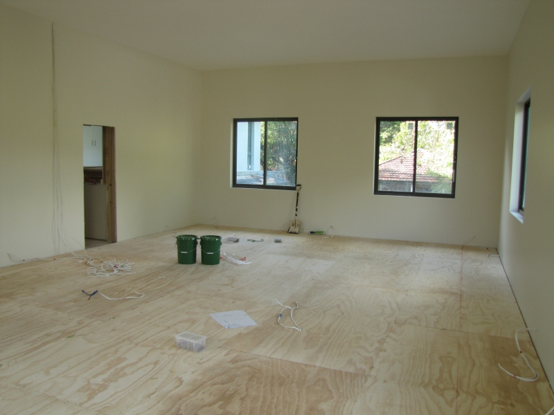

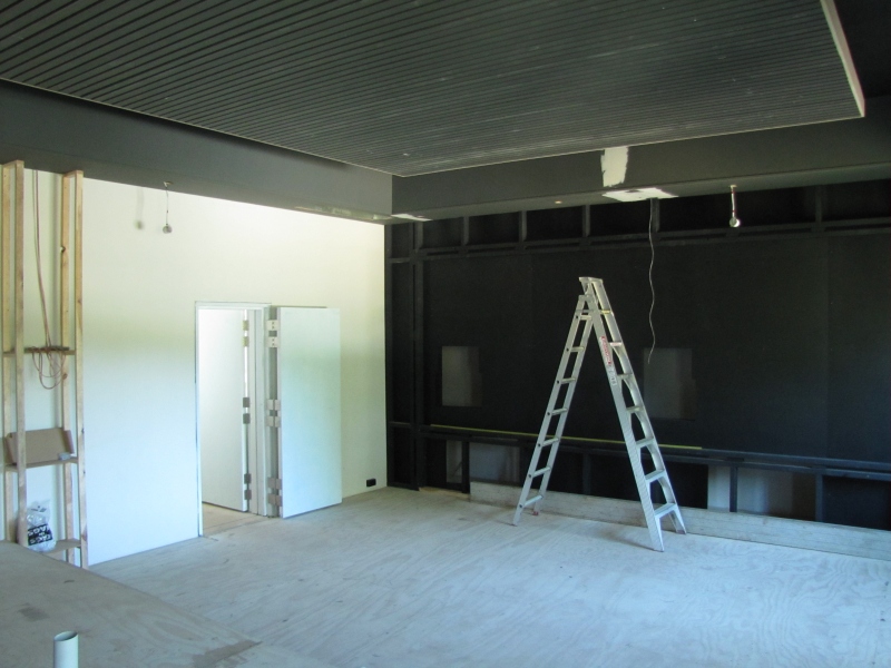

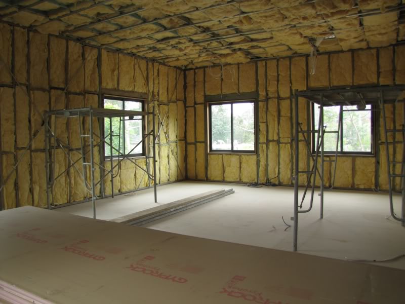

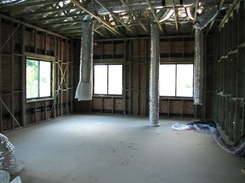

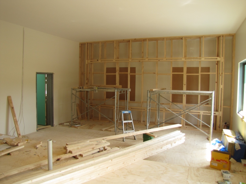

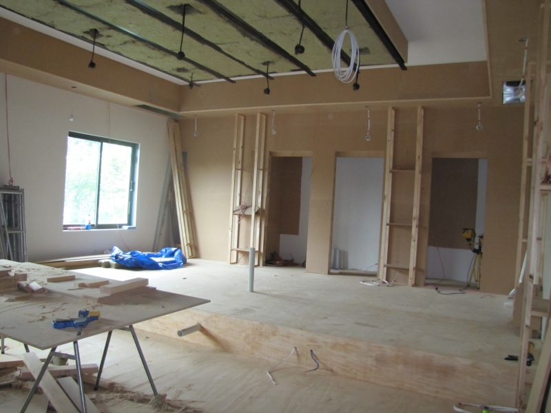

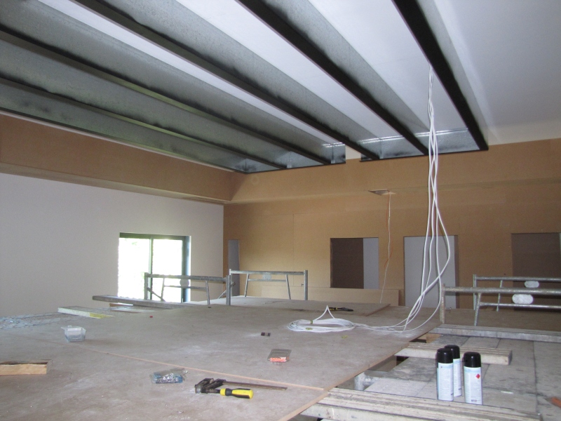

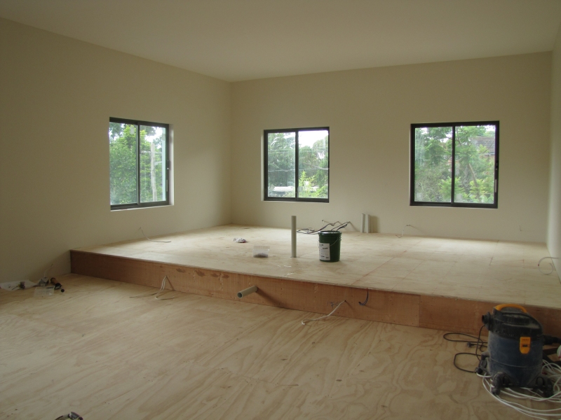

I had to laugh that you still installed windows in the room only to completely cover them up ? im guessing so the house didnt look silly for the outside right?

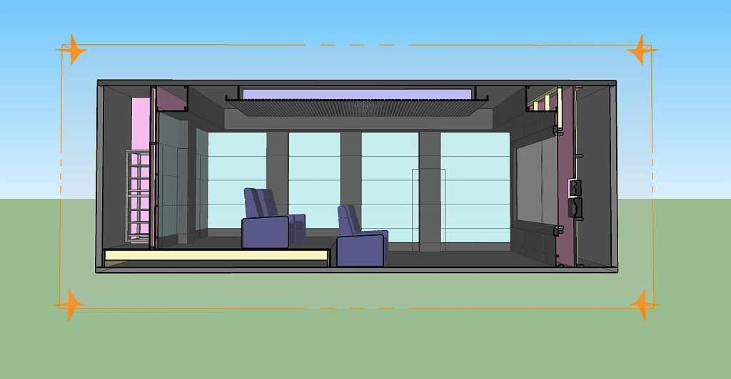

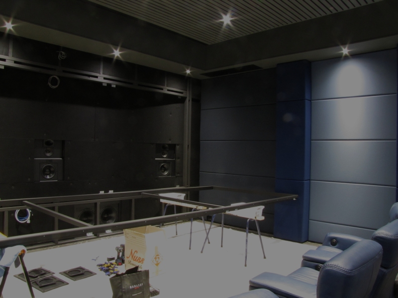

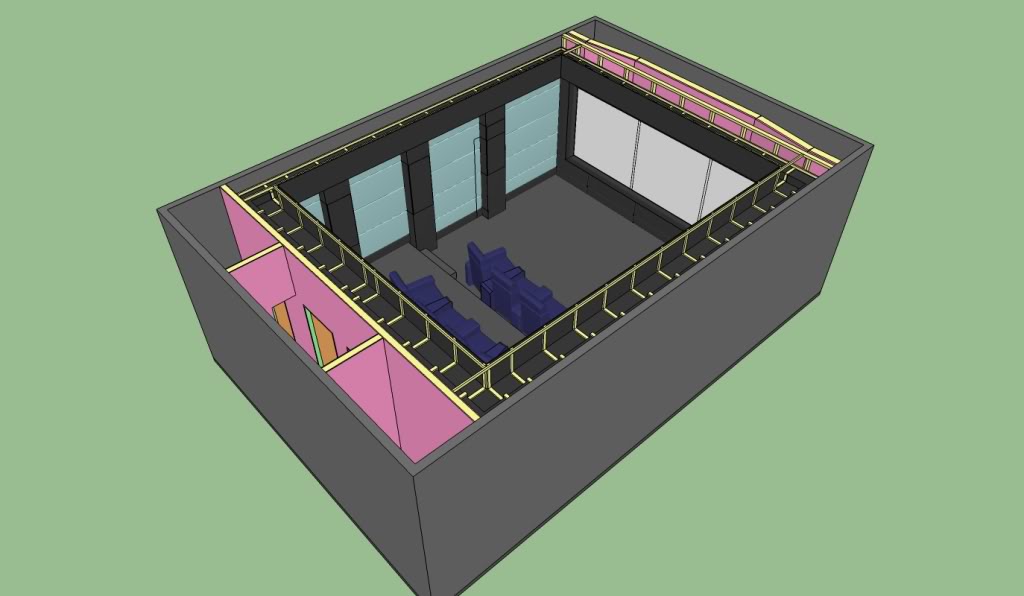

Out of curiosity what are the dimensions of your room?
Again just wow!!! Love it!!
Wow!  What a setup!  Respect!!  :thumb:
Andy
  • Author
solman,

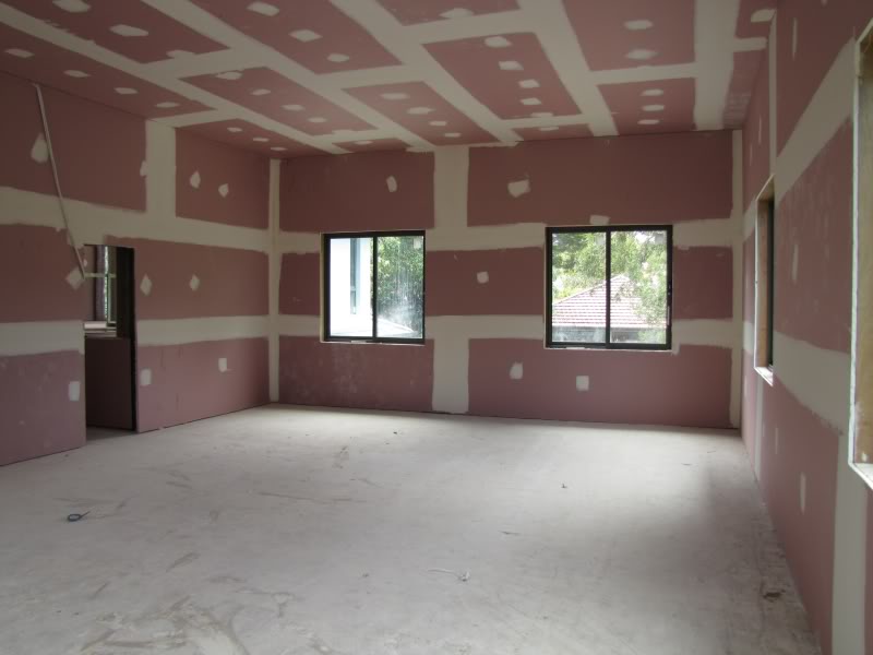

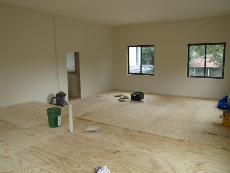

The windows were required for code compliance as well as external appearance.  They'll also help with resale at some point, as some buyers would want to re-purpose the room.
The acoustic shell dimensions are 9.6 x 6.4 x 3.6m and the finished room is 7.5 x 6.2 x 3.3m.
Cheers,
Peter

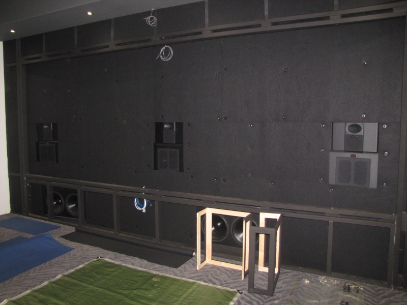

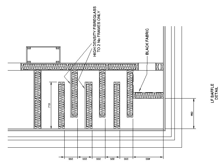

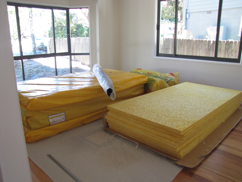

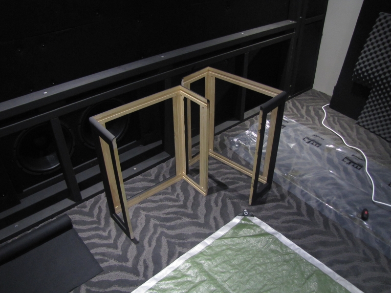

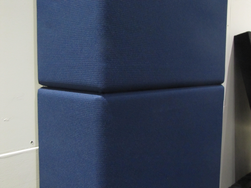

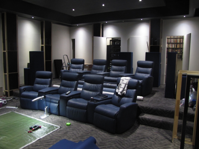

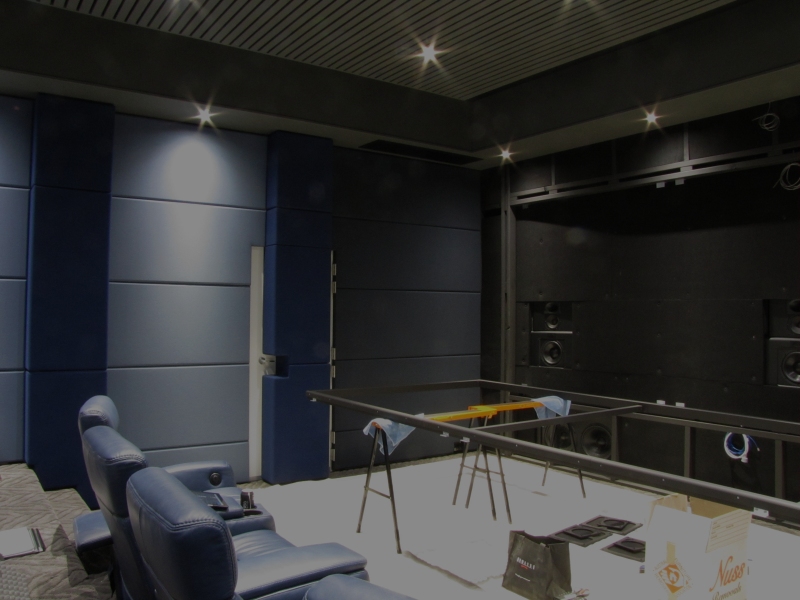

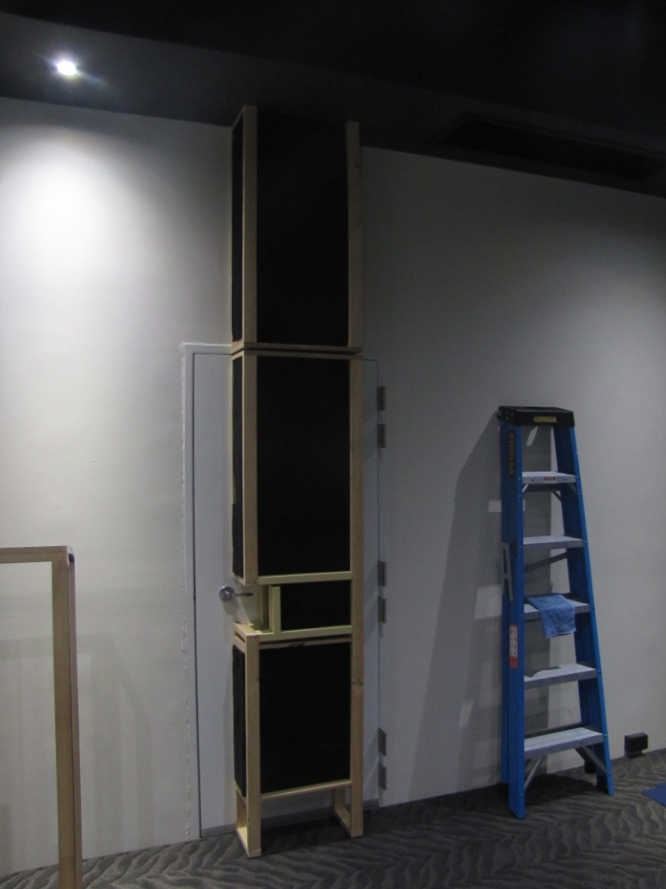

Thats an awesome size room. Are the panels on the walls BAD panels wrapped in a material?
If so where did you get them from? That look amazing and i'm hoping to get the same finish for my room.... when i eventually start it ?
Thanks for sharing just a great space
A labour of love - fabulous!
  • Author
Solman,

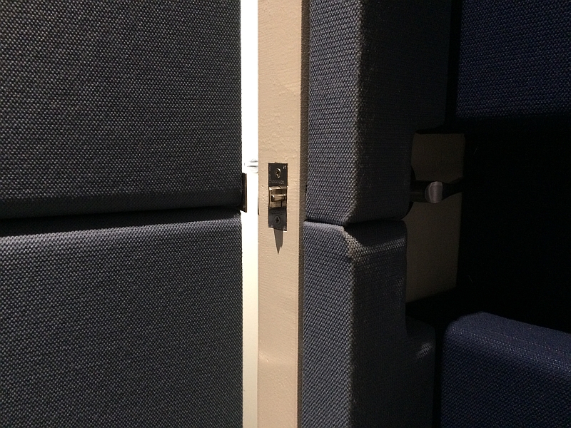

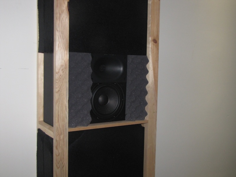

There are three different types of wall panels which were placed by the acoustic designer.
I made all the panels using timber frames, fibreglass insulation, heavy plastic sheet and fabric wrap.
One of the panel types uses Quest AI Perfsorber which is a perforated high density fibreglass, manufactured in Dandenong under license by Acoustic Vision.
Cheers,
Peter

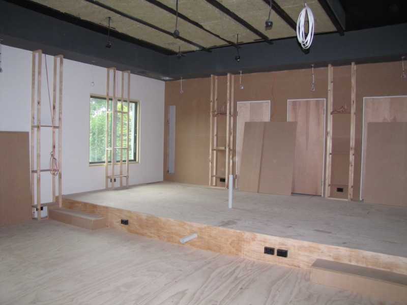

Awesome! Missed your thread on DTV, glad you decided to share it here.

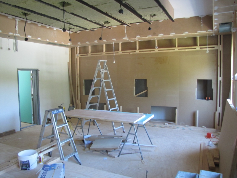

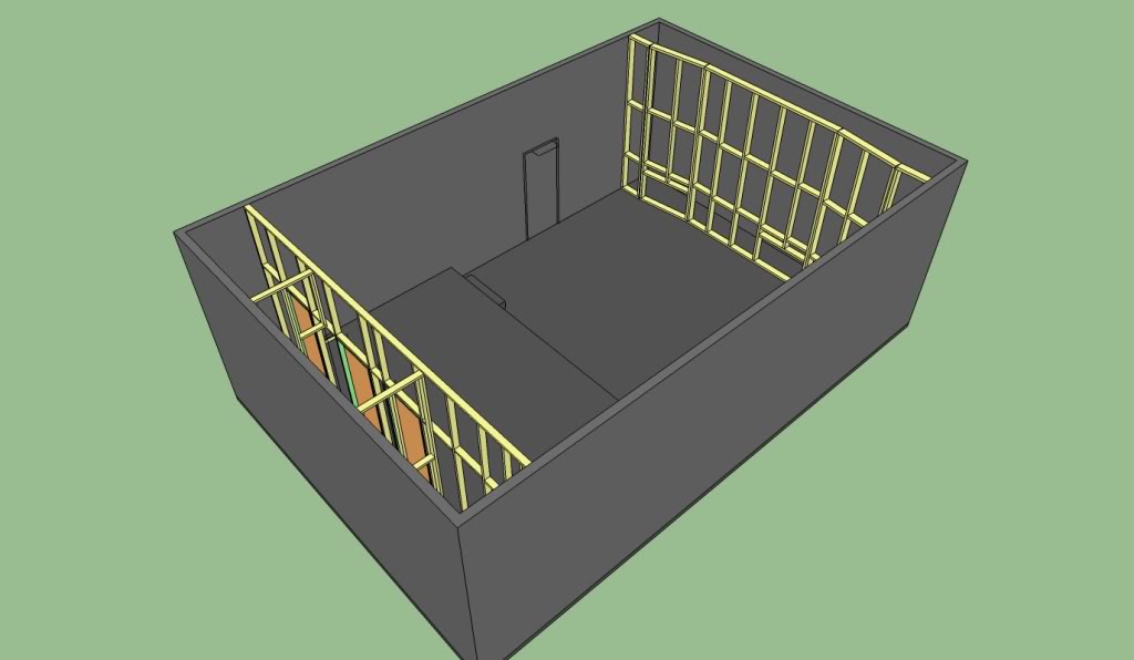

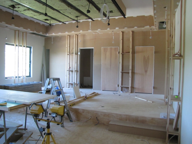

Was this a new structure or an add on to an existing house?
  • Author
AudioGeek,

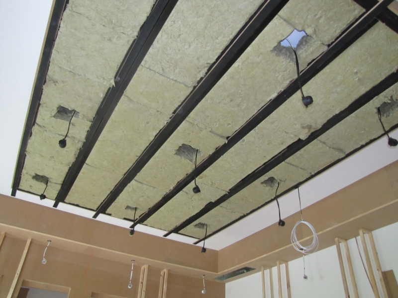

It was part of a new house build and sits above a double garage.  The theatre / garage appears to be part of the same structure as the rest of the house, but is separated with a building joint and there is no connection between the two structures.  This has worked really well in isolating structure borne vibration / noise from the rest of the house.  Mrs M is convinced the whole house was designed around the theatre !
Cheers,
Peter
1 hour ago, Peter WM said:
AudioGeek,
Cheers,
Peter
Thats a great way of doing it - a true dedicated separate space. Very envious!
So the entry is via the garage underneath - and there is no walkway/connection to the rest of the house? How does one get away with that?
