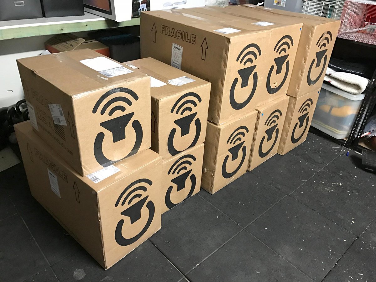

So 10 of my 12 speakers arrived today! I'm decking the theatre out with a full Power Sound Audio setup. Here's 7 main channels and 3 of my atmos / surrounds. My sub and 4th surround got re-routed by mistake to Mudgee instead of Ulladulla! Whoops. Big thanks to Peter at Deep HZ Audio for his customer service and recommendations. Was a pleasure to deal with.
PS - these things are quite big. The 7 main channels all feature dual 10" mid/bass drivers coupled to a horn tweeter. (see next pic)

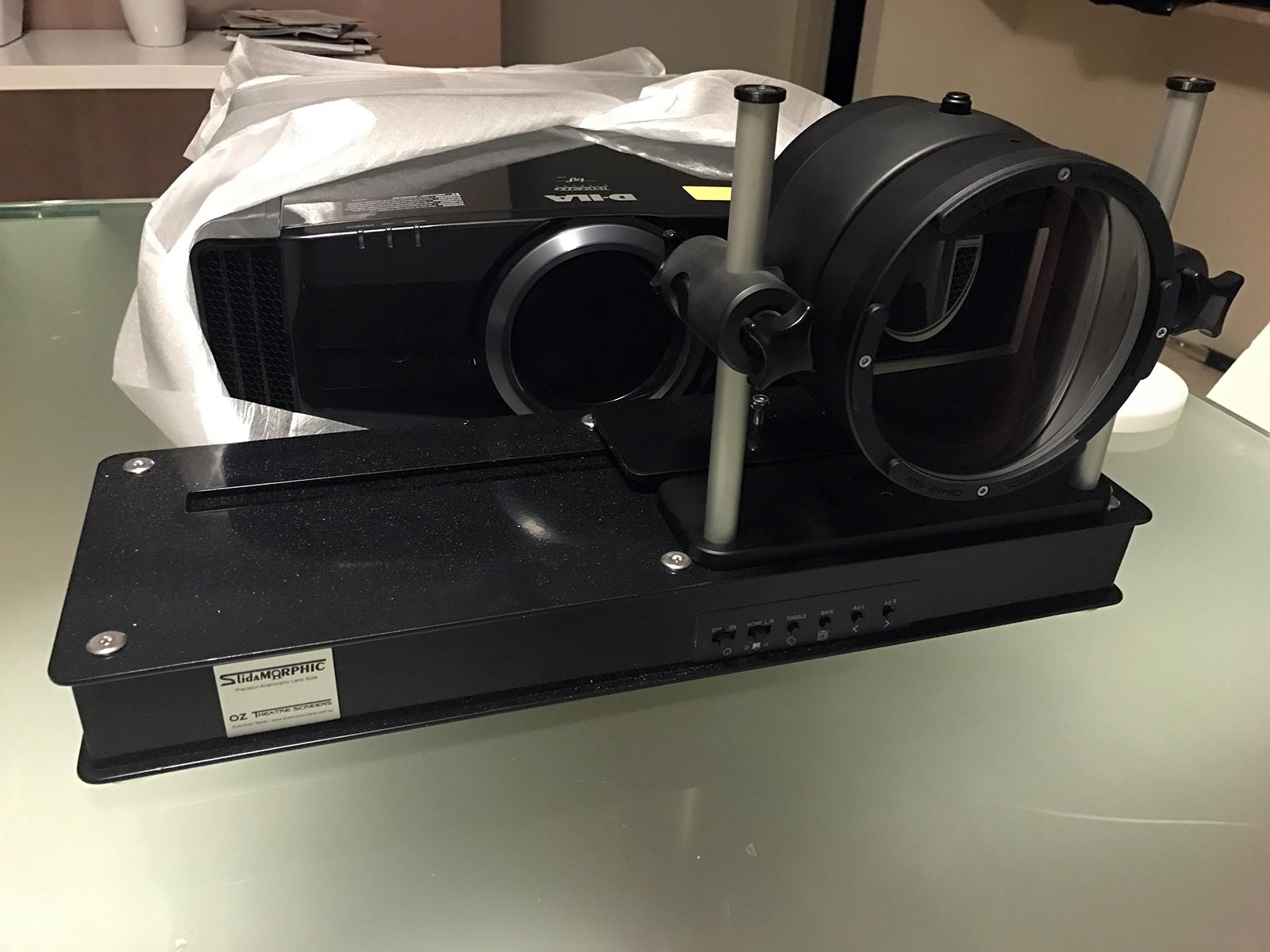

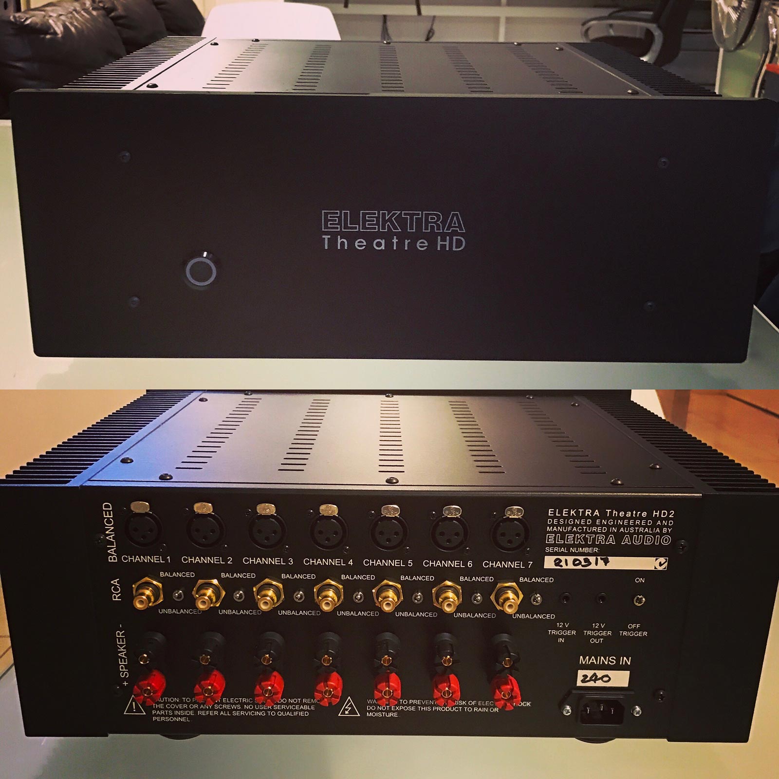

So much equipment has arrived over the past month. My screen, lens, slider, JVC X9500 Projector and yesterday my 2 Elektra Theatre HD2 power amps arrived. I unboxed the 7-channel version to take a look. What a thing of beauty. It's incredibly solid, and HEAVY. I was tempted to hook it up to the two PSA mains I unboxed to play with but need to grab some RCA's in town to do it - that's if my borrowed receiver has pre-outs!

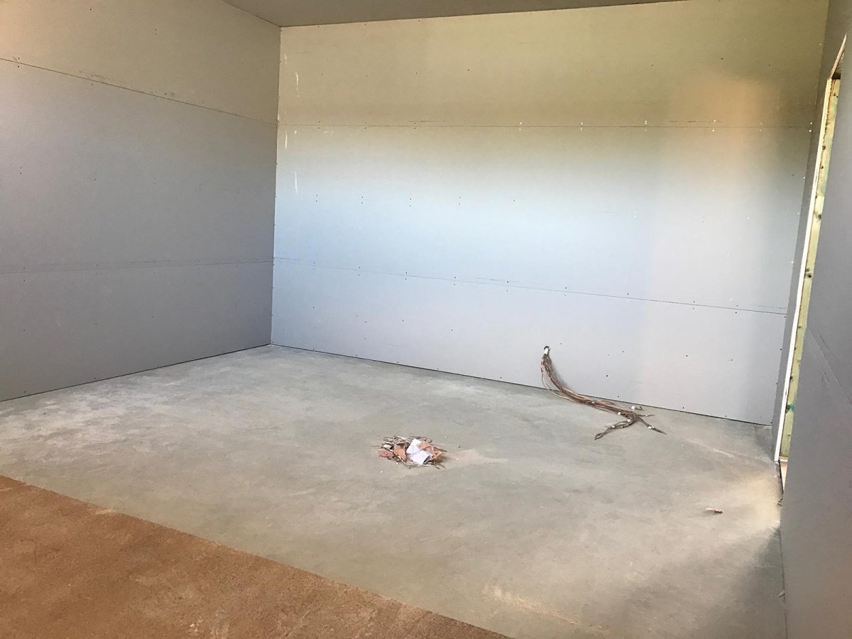

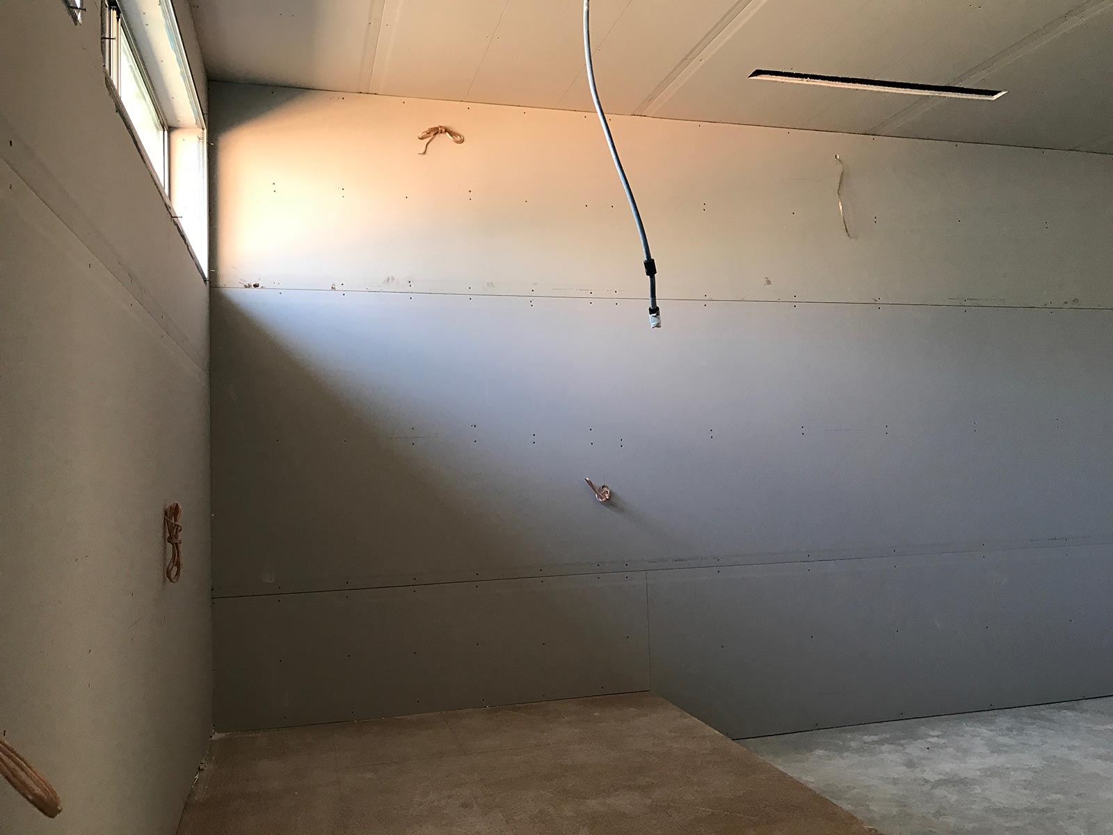

Progress on the house goes well. The gyprocking is all finished, with two x 1cm layers in the theatre room walls and roof for 20mm all around which will aid with the sound isolation.

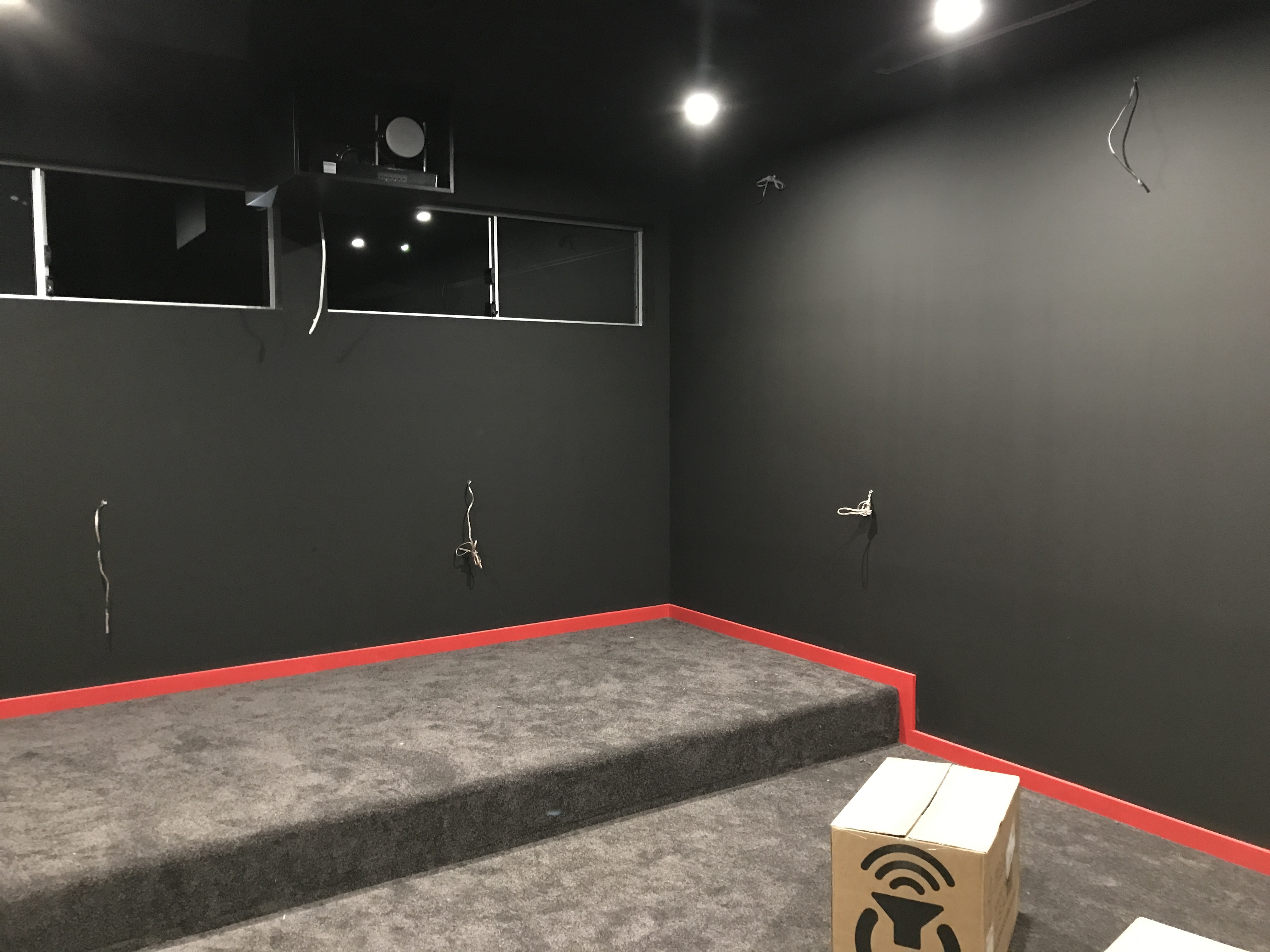

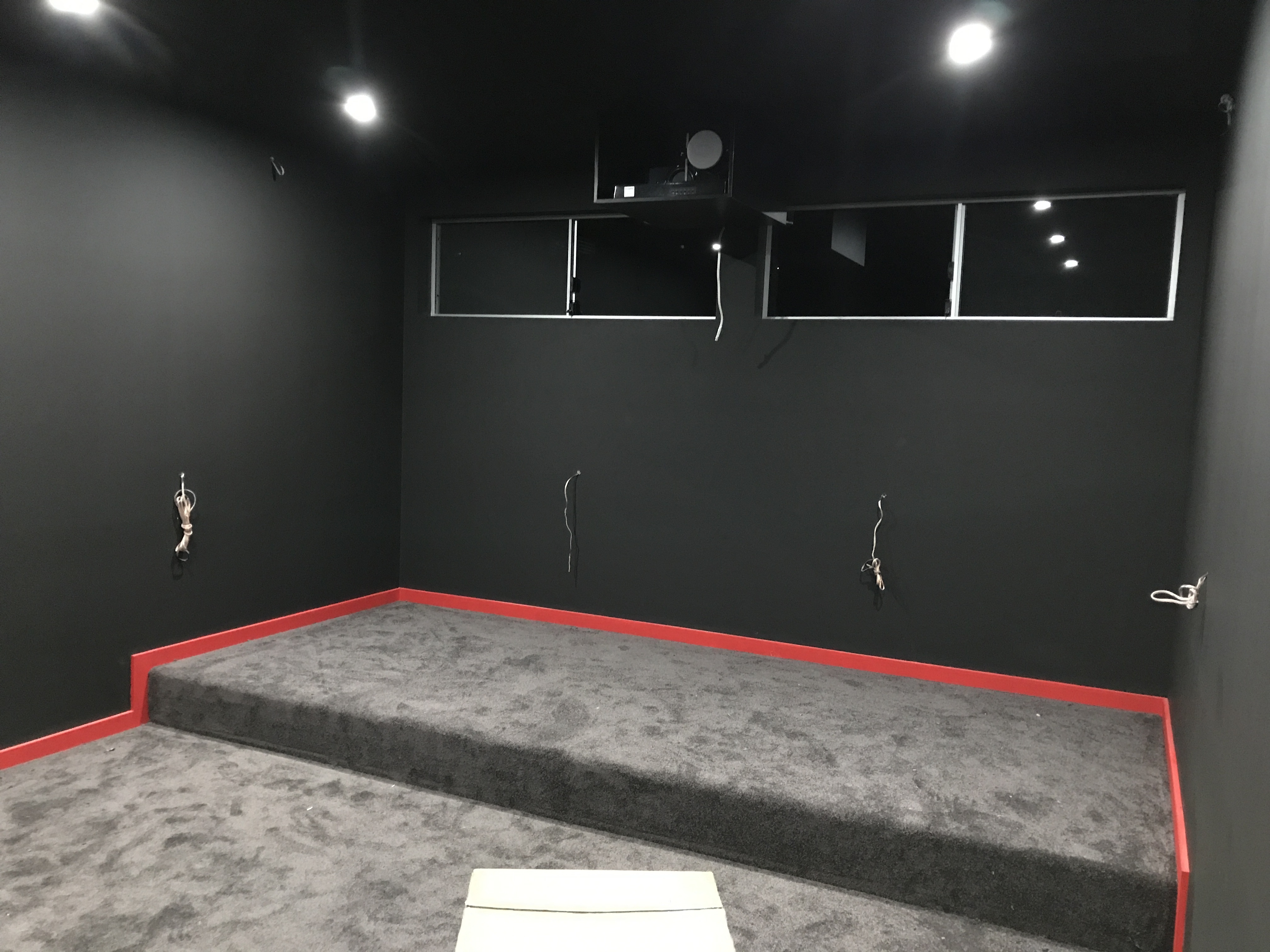

So we've started moving stuff into the new home and so I have a few more pictures of the room now carpeted and painted!

Took this terrible photo of the gadgets sitting in the projector bulkhead. Thankfully bolted through the rafters with four very strong rods. Would be an expensive accident if it fell! I need to lift the projector up a little to align with the lens.

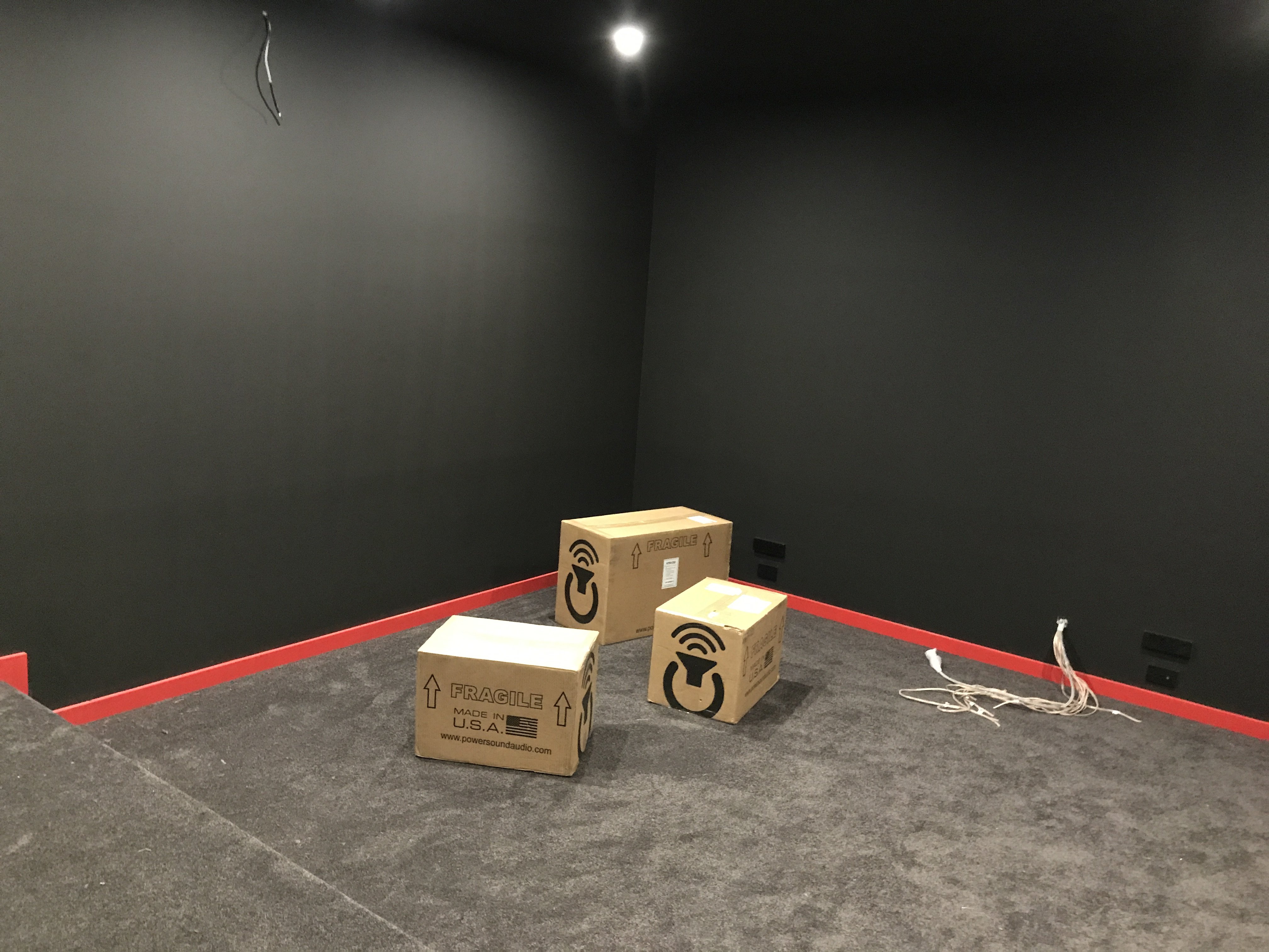

And a shot of the (lockable) door. Solid timber door to help with sound leakage. Also can see the red trim that we went for. I will be adding red and grey acoustic tiles to the walls to match the colours. You can also see the bundle of 10 speaker cables for the 8 surrounds and 2 outdoor speakers.
Im yet to buy a rack to put my amps and soon-to-be-purchased processor on. They will likely start life on a sheet of MDF until I settle on the right way to house the gear.

I'll let you know how I go with the screen setup process. I had to get the builders to move the projector box back another 500mm so that I could ensure the PJ was far enough away from the screen with the lens in front to avoid any distortion issues.
