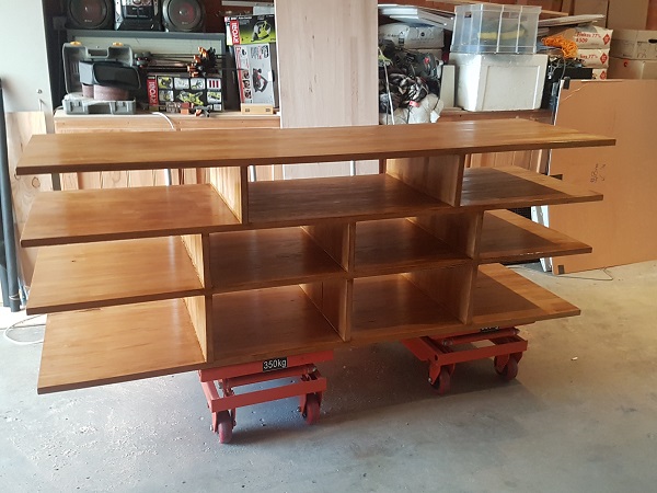

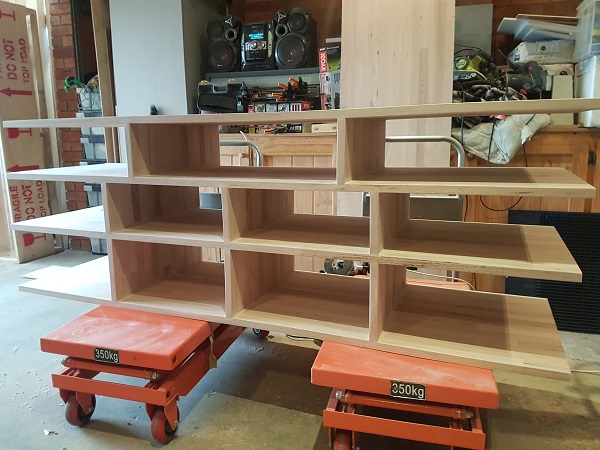

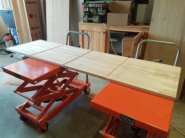

After deciding I was going to use a preamp / amp setup the next bit was to find a spot to stick it all. Like the next bloke I like a bargain so started searching around for the decent sized TV stand. They dont make em to big do they? With all the toys one can buy you'd think someone would come up with a stand that holds everything plus a bit more. Perhaps they do & I just never looked in the right place. Any way, I decided to build one that suited the bits I wanted to use, couldn't be that hard could it? Yeah right lol. Took a gander at some YouTube vid's laminating timber & figured that was above my skill set. Bench-tops! they are long, wide & solid. Found a local place that supplied raw Victorian Ash 26mm thick, 2100mm long, 600mm deep & figured that's gotta be as good as anything to build a stand from. We have a lot of timber around the shack so a coat of stain should blend it in nicely.
A few pics of the stand I built
Started with this bit first lol
Then progressed up to the top bit
Spent more then a couple of hours sanding & throwing around a paint brush to end up with a suitable stand

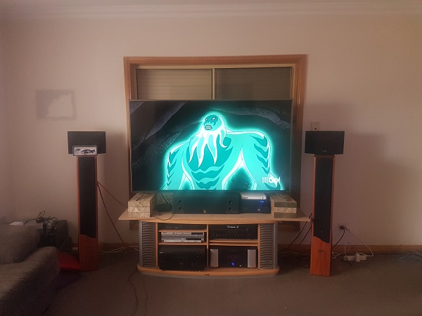

So then the cook pipes up with "your not putting that inside smelling like that! So it had to sit outside for a few days till the smell of the stain had drifted off to the neighbors. One weekend I started pulling the old pretend Harvey Norman stand out so I could maneuver the new stand in. I was half through doing that when I thought of taking a pic lol. You can tell it was a Saturday morning as Ben10 was still on :) Still have to finish the wall repair, we had to run cables to a second switch board for the tank & that was the easiest way to get into the back of the main switch board.
My wiring skills need a bit of work so hopefully this time around I will make a better job of running wires. I do have some power boards I'll use to switch off stuff that isn't used everyday. We use lots of power so switching gear off instead of standby makes a difference each month. I haven't worked out where I'm going to mount them yet.
At the end of the day I ended up with 3 speakers hooked back up, the TV going & the Xbox's in their new home. The original NES has been taken upstairs & plugged in up there. Not the greatest pic I know :)

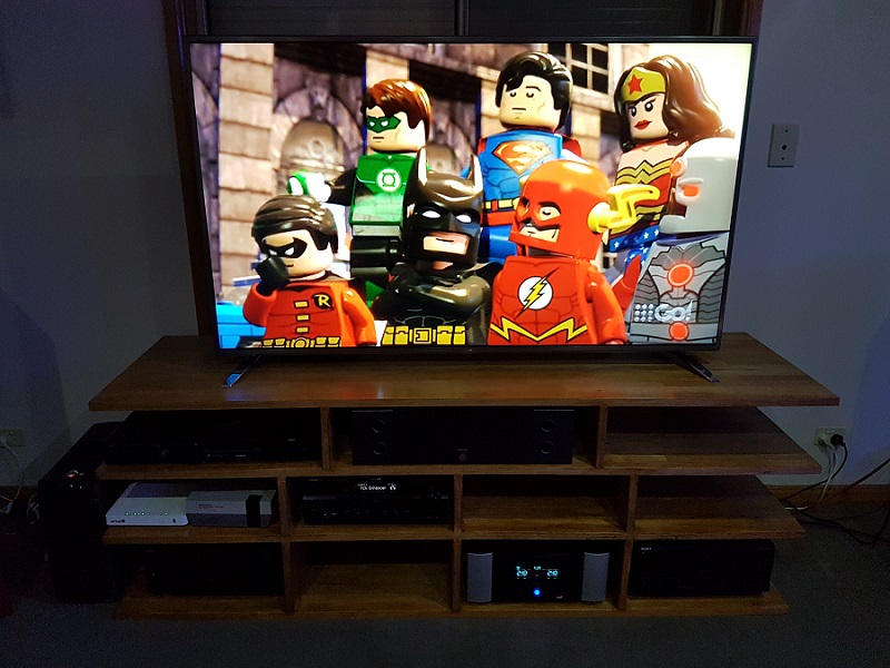

I picked up the preamp last week along with the Bluray (CX-A5100 / BD-A1060) so they are installed into a hole & waiting on the other bits to get them running.

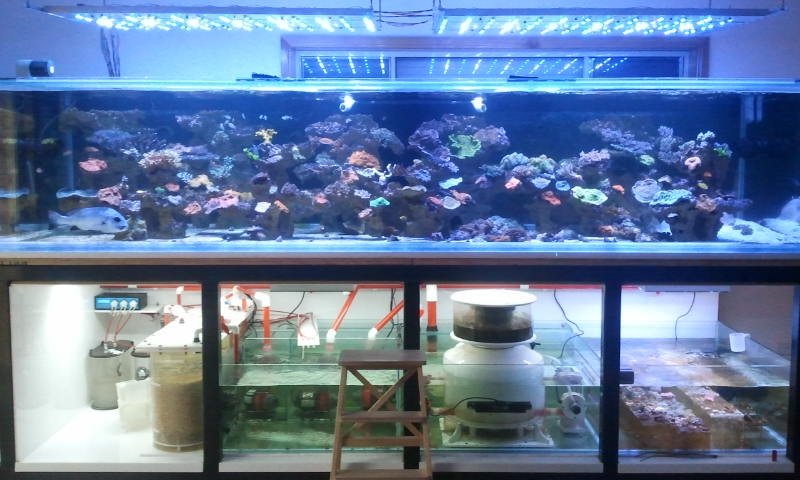

I did have a message asking about our tanks. So I'll drop a couple of pics here. There are other tanks around here? I don't take to many Full tank shots as you cant see much being so far away lol, more close up coral pics.  Marine tank is 12ft long 4ft wide & 2.5ft deep, 4000Ltrs total volume. There's also a 8x3x2.5 tropical tank in the same room. 6000Ltr's in our lounge with this HT stuff lol.
I'll leave you with these, sorry for dribbling on so much lol :)

Love the AV rack! I couldn't find what I needed for mine either ,so had a simple one made for me.

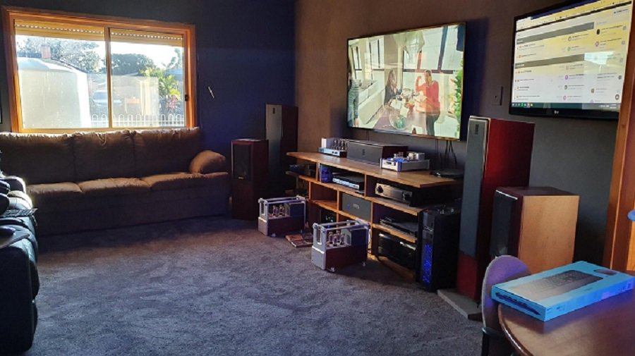

A fair bit has changed on our TV wall in that time. Looking back when I started it looks so, blah. I'm happy were it is now for the moment but still things to dick around with I guess.

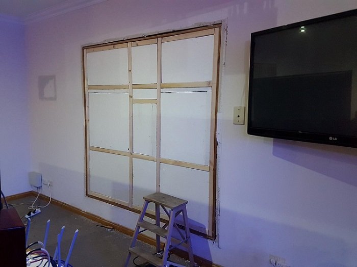

I ended up sealing the window behind the TV, so that's gone & had a blank canvas so to speak. Although this is our lounge room I wanted a dark colour, just couldn't be black. Ended up picking a midish-dark grey. Came up OK but really highlighted the cream walls & ceiling. Picked a shade or 2 lighter & attacked said walls & ceiling.
All I did was remove the window trim, frame out the hole allowing for the 10mm plaster sheet, add an extra piece of timber for the TV wall mount, filled the frame with 50mm, polystyrene, sheet, plaster & paint. If ever required it is easy enough to reverse, the window trim is is hidden in the window cavity behind the plaster lol.
Pics tell a better story then me lol. These are old pics now from when I did the wee jobby.

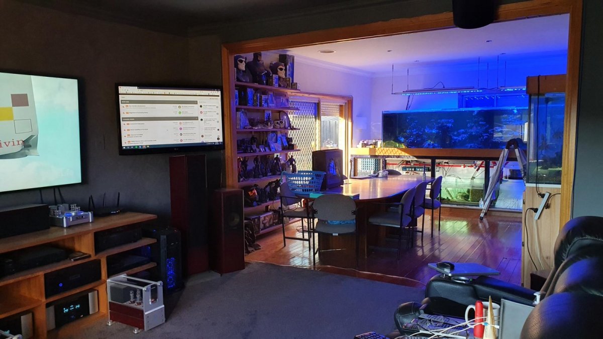

It is def a lot easier to watch movies now, speaker placement is a bit of a bugger with the shape of the place.
Pics from today.
Where I'm up to with bits & pieces since the last post 4yrs ago lol.
The big bits...
The LG TV crapped out so was replaced with a 75" 4K UHD blah blah blah Samsung
Yamaha CX-A5100 pre-amp
7 Ch Elektra Theatre HD
Balanced XLR - XLR Canare L-2E5 / Neutrik
Yamaha BD-A1060 Blu-ray
Sony UBP-X700 UHD Blu-ray player
2x Thor PS10 & board's
Xbox 360 & Xbox One S - Waiting for the new Xbox to be released
Sony CDP-CX260 linked to a Sony CDP-CX200 CD mega players
The valve bits...
Shanling MC-30 - used as pre, not the internal 3W amp
Consonance Cyber 800 Mono-blocks - need to find something to put under them, off the carpet.
Music Angel XD-800 MkIII integrated - has not been molested internally,,, yet.
The loud bits...
Main- Martin Logan Motion 60XT
Center- Martin Logan Motion 50XT
Rear- Martin Logan Motion 35XT
Surround- Martin Logan Motion FX
Sub- Martin Logan Balanced Force 210
Osborn Interlude's hooked up to the valves
Speaker cables for the 60's 50 & Interludes is Osborn Data Link.

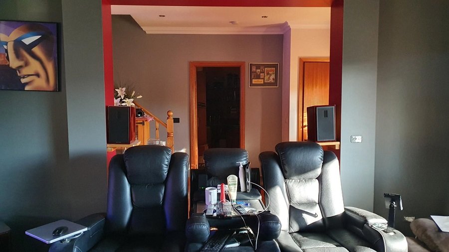

So where to now?
I'm happy with things & it sounds OK to me, but would really like some experienced ears to check things out & tell me where I've gone wrong.
A lot of threads cover room correction, think that's what I will look at next. No idea where to start lol, once you guy's start talking frequency's & reflection points I start thinking about what the girl is cooking for dinner lol. I will put a few pics here of the while room from different angles so you can get the gist of the odd setup. Anyone with an idea about bass traps or panels feel free to yell out.
Am I right in thinking that the ceiling is the first place to start? Seems bloody bare up there lol.
Don't want to put curtains over the window, the windows are privacy tinted (helps with UV as well) & we have shutters. At work all day so movies & TV are 80% night viewing. Weekends the stereo is usually going while we potter around so light on the screen is not an issue. The water tank on the front lawn is for sale lol, not a perm fixture.
