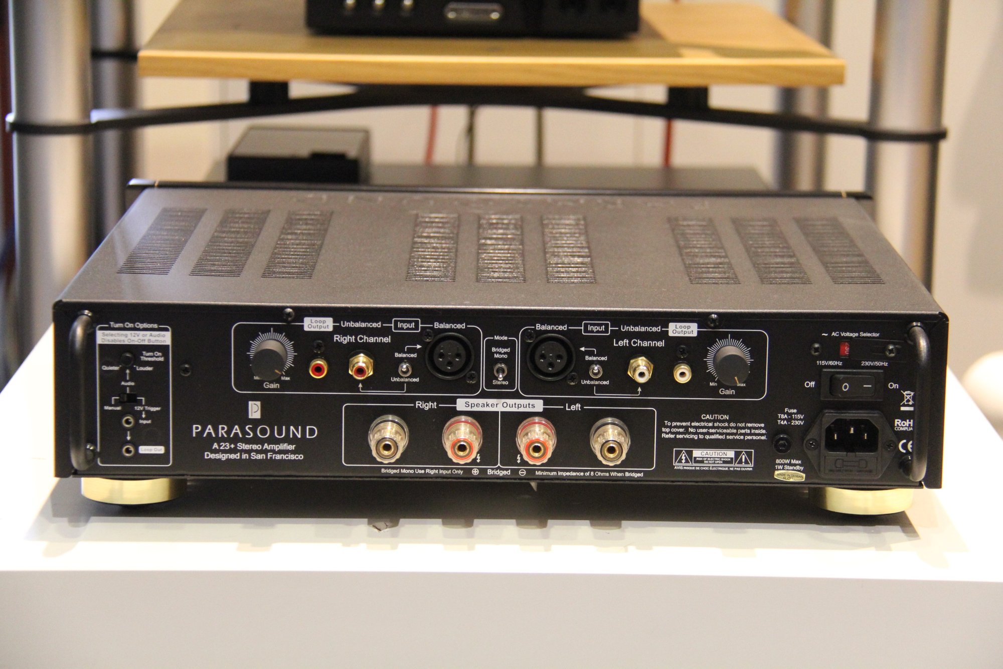

Features
45 amperes peak current per channel
Stable with speaker impedance dips below 2 Ω
Balanced inputs with discrete circuits
Heavy-duty 24k gold-plated 5-way speaker binding posts
Gold-plated RCA input & loop output jacks
Direct-coupled signal path, no capacitors or inductors
DC Servo and relay protection circuits
AC turn-on inrush surge protection with relay bypass
JFET input stage, MOSFET driver stage
12 beta-matched 15 ampere, 60 MHz bipolar output transistors
1.1 kVA shielded toroid transformer w/ independent windings for each channel
Independent power supplies for input stage, driver stage and output stage
54,400 µF filter capacitors for output stages
Full power is rated all the way down to 5Hz for unrestricted low-end bass
Harris hyper-fast soft-recovery bridge diode rectifiers
Automatic turn-on by 12 V trigger or audio sensing
2 rack space chassis with rear carry handles
Rack mount hardware available separately

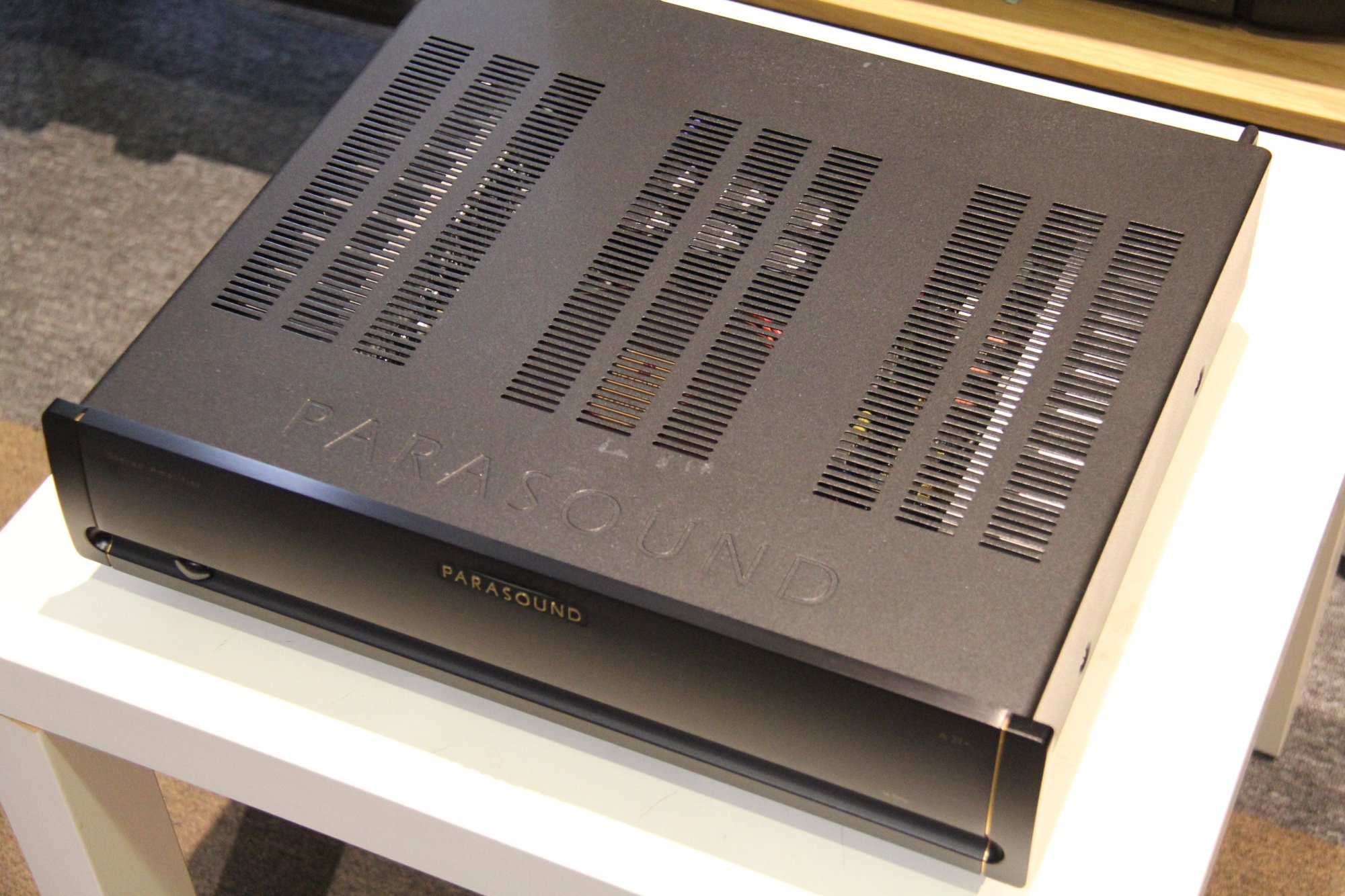

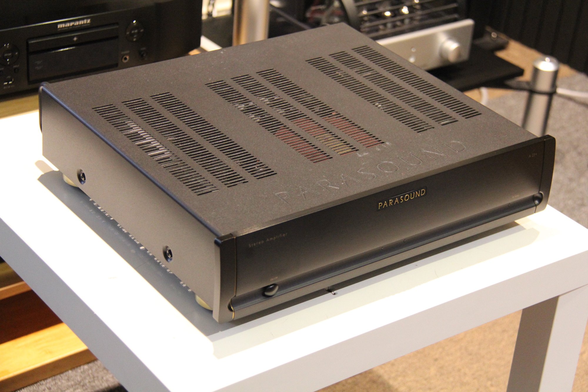

Dimensions
Width: 17-1/4" (437 mm)
Depth: 15"-1/4" (388 mm)
Depth, with cables 17" (432 mm)
Height, with feet: 4-1/8" (105 mm)
Height, without feet: 3-1/2" (89 mm), 2U
Net Weight: 27 lb. (12.2 kg)
