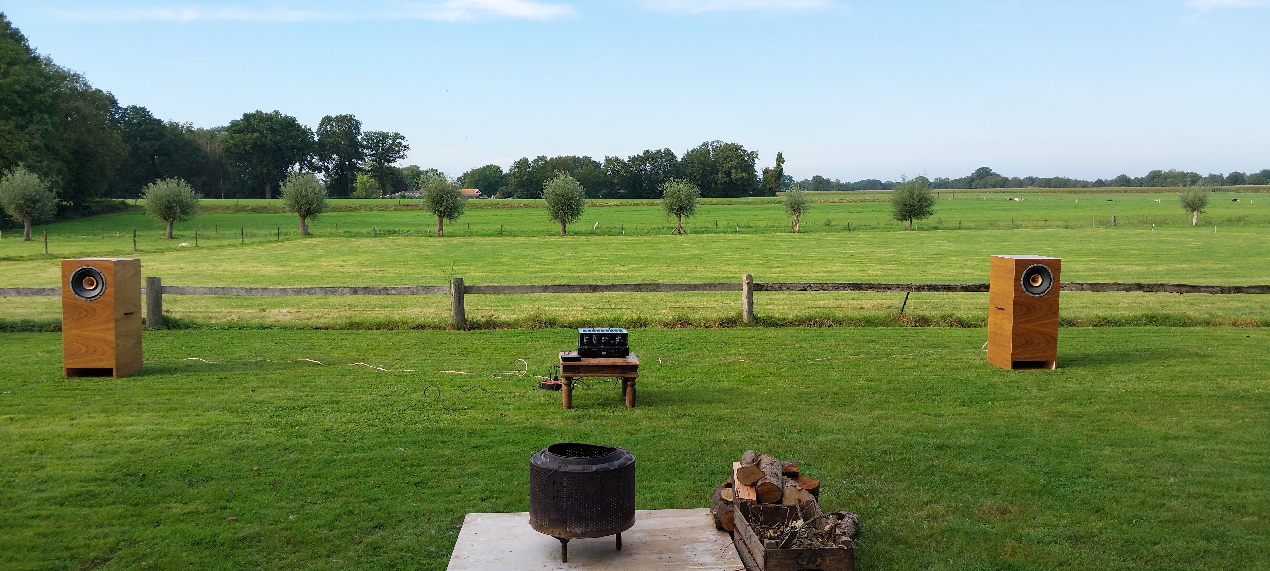

27 minutes ago, DeBreuk said:
So, if you have space in your garden and your neighbors don't mind, I can definitely recommend it! 20240907_165555.thumb.jpg.0e249a6824f820ca260b992a0b82fda1.jpg
It's good that you've the cage over the tubes as the bovine in the background may think the bottles are udders otherwise when the gear is left unattended. What do you do when it rains? What are the speakers? Lii-audio 10's or similar? It looks great. 👍
This listening setup is temporary and highly dependent on the weather forecast. Although many modifications have been discussed on this forum, I have yet to come across a waterproof R8. The drivers are Fast 12's from Lii Audio.
How are you finding the Fast 12's?
I don't have much experience in comparing sound systems, but the combination of the F12s in this enclosure together with the R8 suits me very well. The drivers aren't particularly dynamic, so don't expect high-end audio with speed metal 🤘🎸
@DeBreuk Hand down the best interior (exterior) design I have seen involved an R8. Have you try toe-in and move abit closer to the speakers? say 3 feet? Oh and welcome + kudos to reading 600+ pages.
I've done quite a bit of experimenting with an outdoor setup. Outdoors, I can turn up the volume on the R8 much further (upto 2 o’clock) without it sounding too loud or harsh. The limiting factor is the Lii-audio driverset not the R8. The drivers are very sensitive.
The greater the distance between the speakers, the larger the sweet spot (up to 3 meters wide). I prefere a distance of 6 meters between the speakers (with an 8 meter distance to the chair). I angle the horn speakers slightly outward (toe-out).

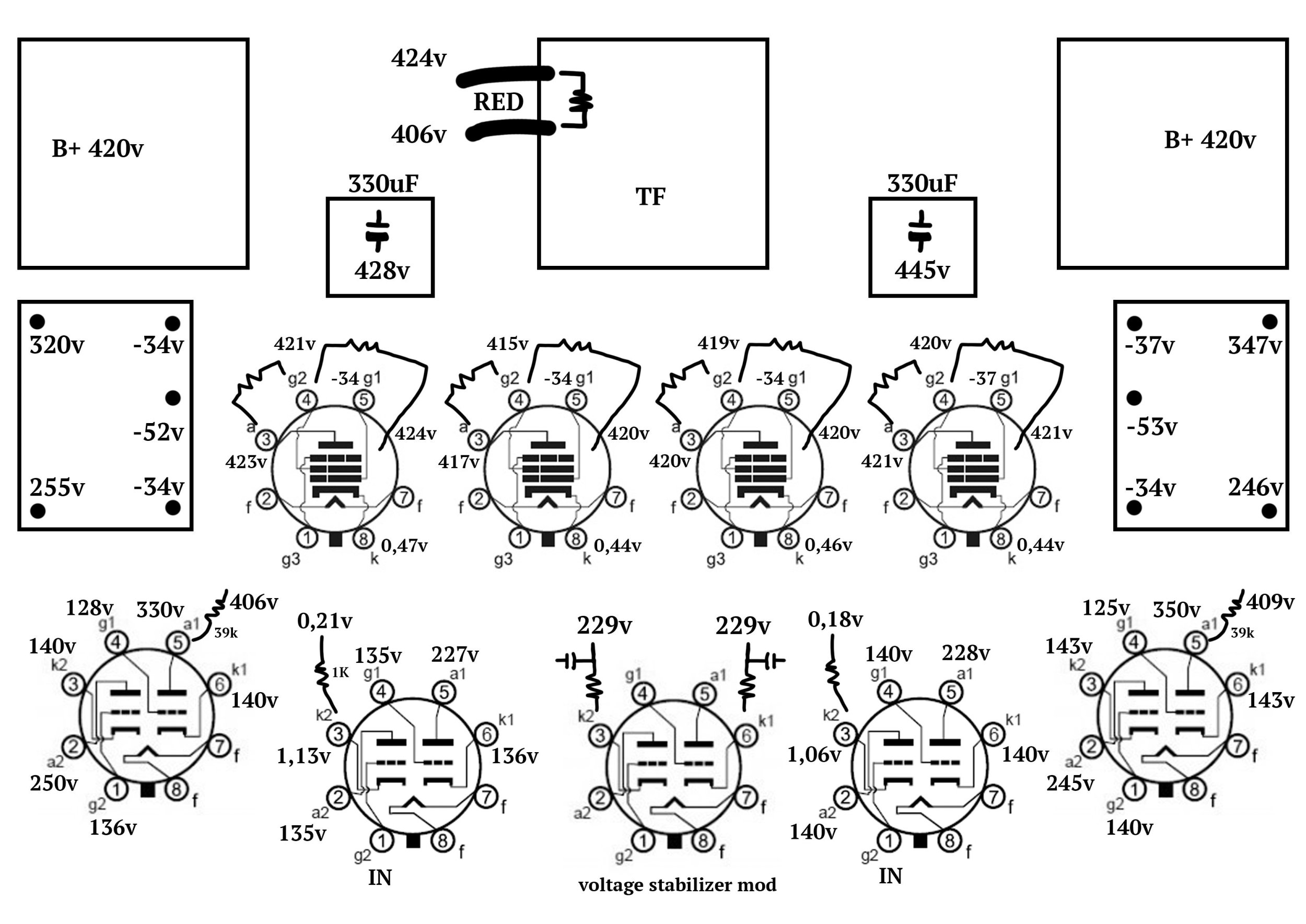

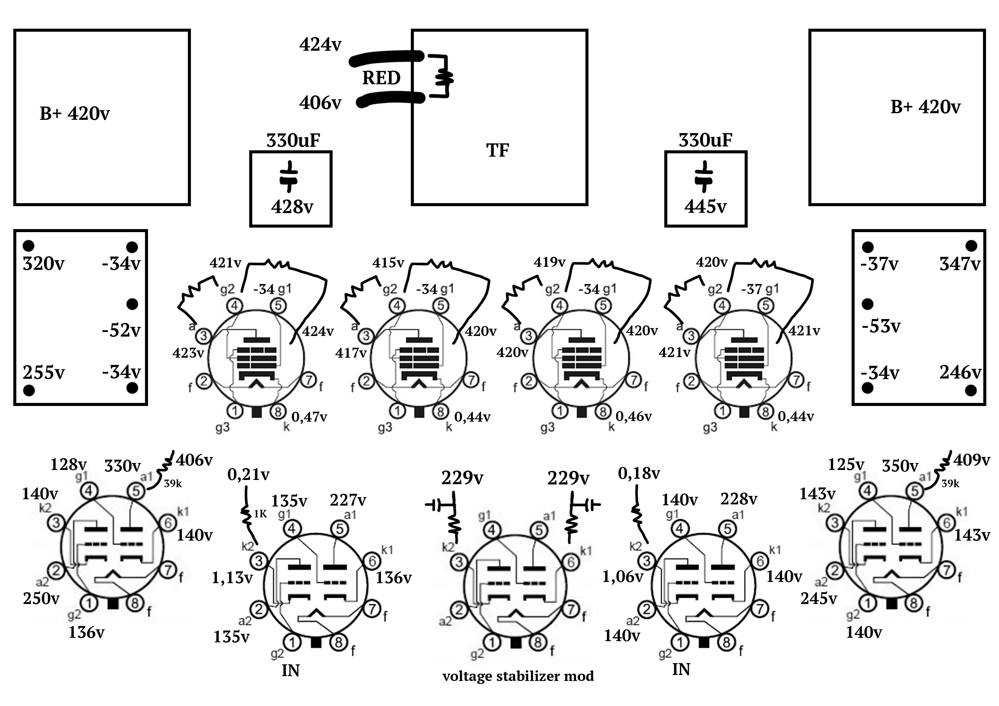

SOS !!!!!
Good morning, everyone! I need some help.
I've completed most of the modifications, but now, while measuring the voltage points, I'm seeing unexpected values (highlighted in red) at pins 2 and 5 of the 6SN7 on both channels. 😞
What could be causing this issue? Any insights would be greatly appreciated!

The voltage at the cathodes appears good indicating current draws of the triodes are good, but the voltages at the anodes appear lopsided.
Without having access to the unit nor precise voltage readings around the 6SL7's the above observations indicate, to me,  a non-zero voltage offset at the input.
I would disconnect all inputs and ensure that the 220K and 1K at the 6SL7 are good and soldered properly.

Good morning, and thank you for your valuable help!
I have checked the resistors, and they seem to be OK. Now, I have installed the original tubes and redone all the measurements, which I am attaching. I also have an issue with the BIAS meter, which fluctuates and is difficult to stabilize.
Thank you, I really need your help!
Best regards,
Mauro

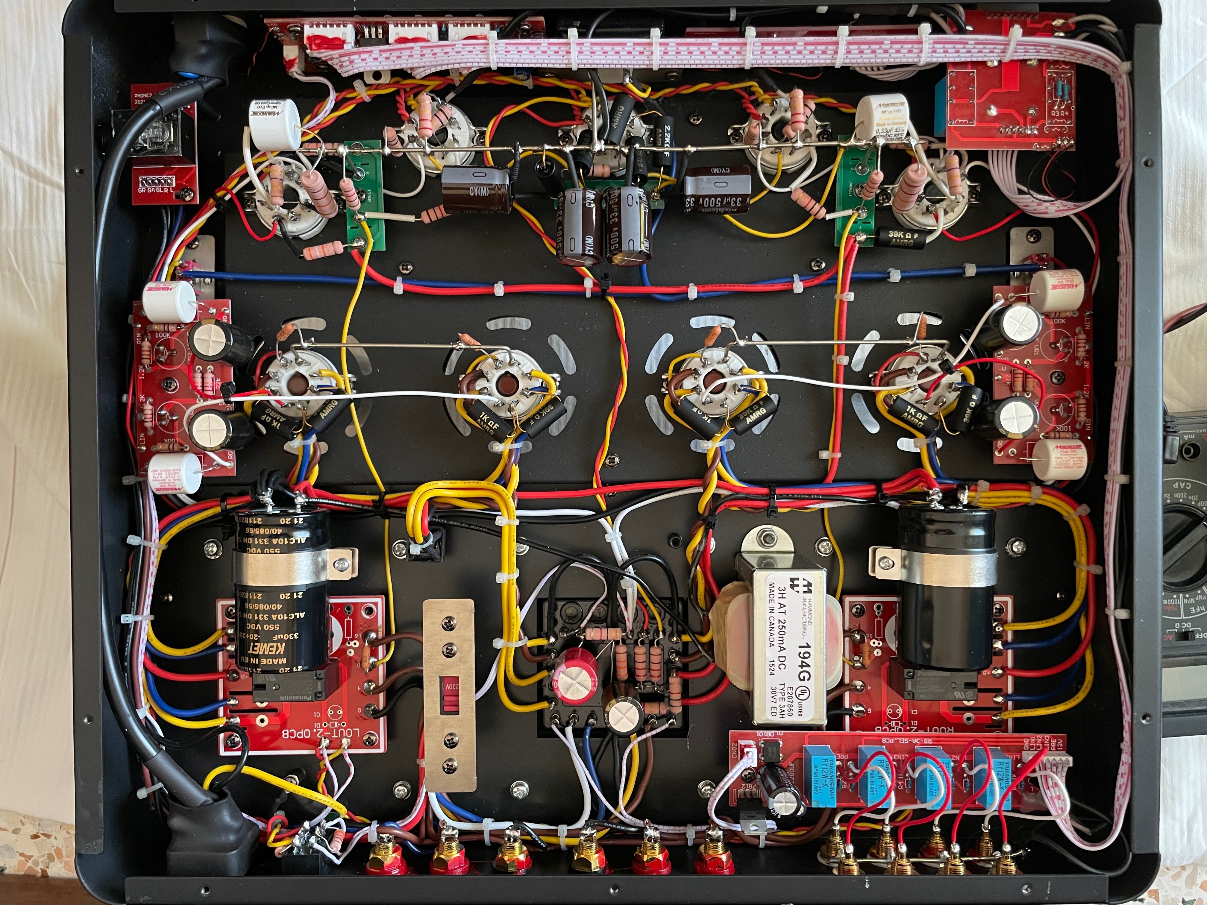

@Mauro, any chance of an actual photo from inside the unit, we can't really know 100% which parts were replaced, this would make it easier for everyone to assist you.
There is a bit of discrepancy between left and right V of 330uf caps,
 - Is it still original choke or Hammond?
- Have you check for cold soldering?
- Have you triple check all your grounding?
With the erratic bias reading, could be faulty pot or tube,
- Give the pot a few turns and see if that can be fix and also test it with different tube.
There seems to be multiple issues on your unit that needed to be tackle one at a time, I would suggest you to take break from the R8 for a day, clear your head and come back.
- Then check your soldering and reflow if needed ( I would just reflow everything)
- Tackle one issue at a time, confim your V readings for everything, test the unit and move on to the next outstanding issue.

Good morning and thank you for your help. These are the components I have replaced:
330µF power supply capacitor with two Kemet 330µF 550V capacitors
Two capacitors on the transformer
The choke, replaced with a Hammond 194G
The four capacitors on the bias boards and added a safety resistor
Duplicated the circuit of the 6SL7 and brought the filament power supply to the center
Replaced the resistors on the EL34 sockets
Replaced the 0.33µF capacitors on the 6SL7
No modifications to the ground path
Thank you for your kindness.
Mauro
