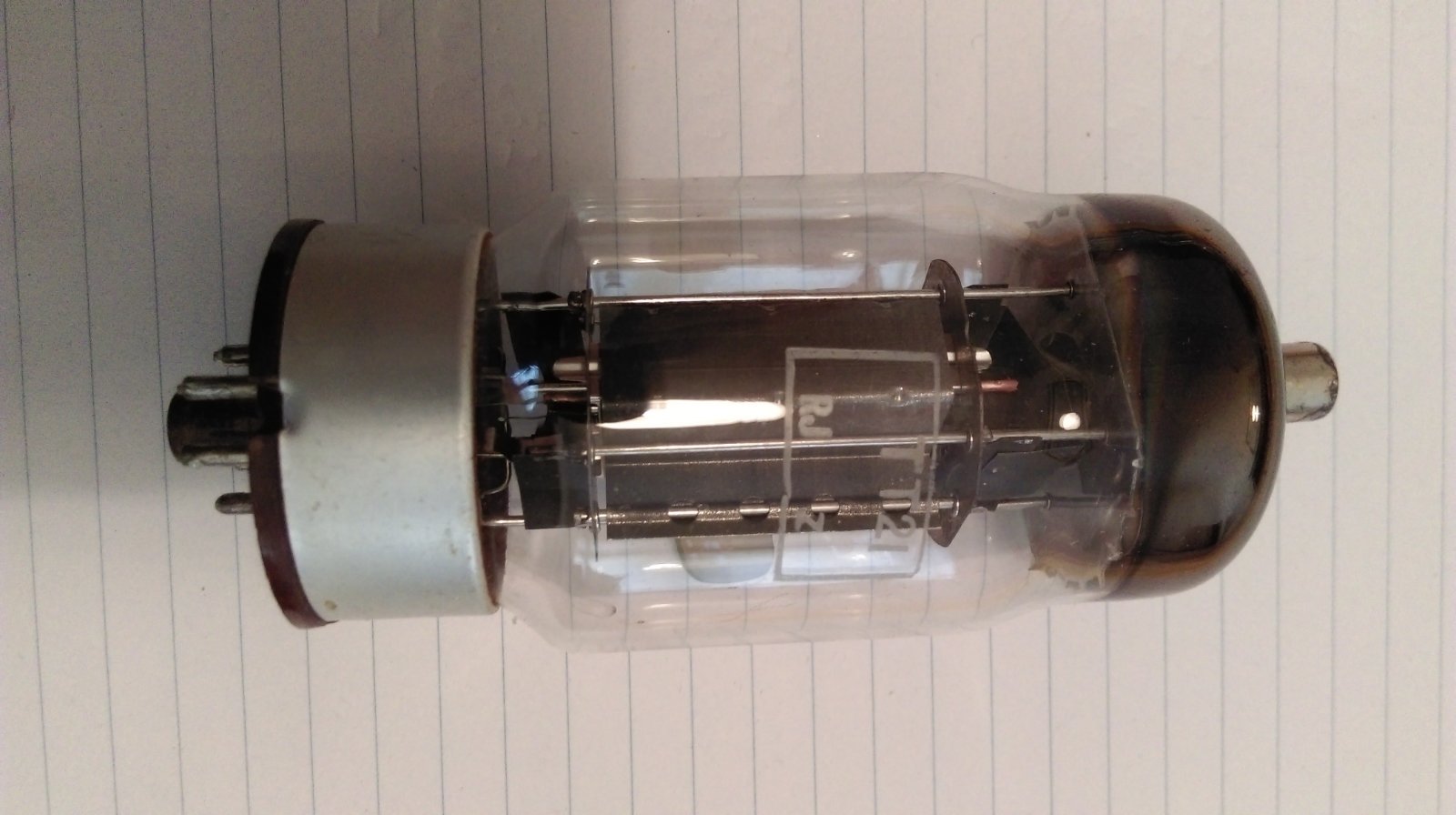

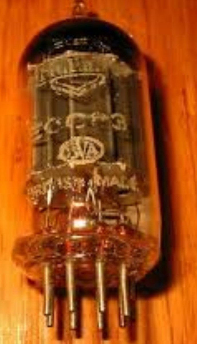

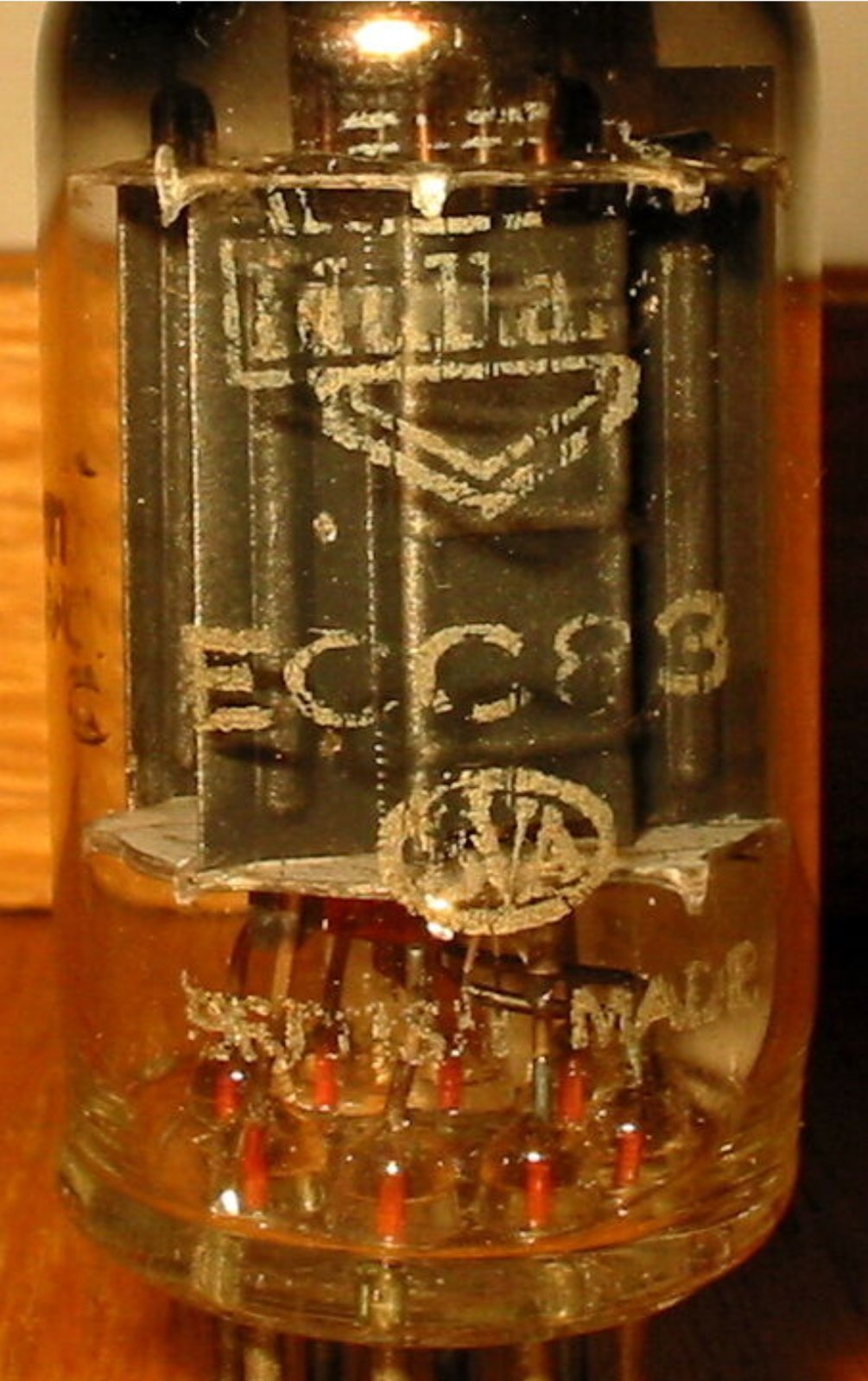

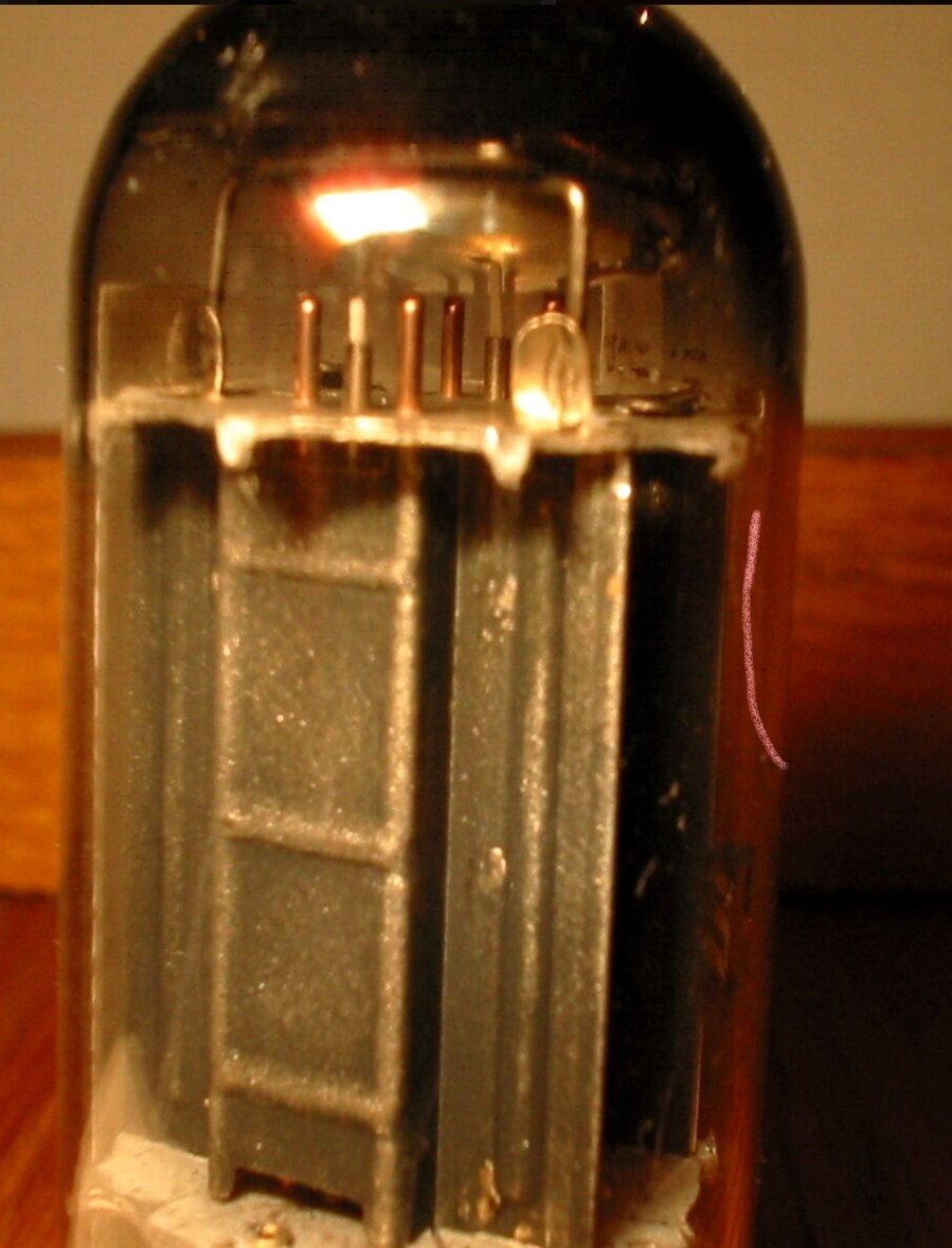

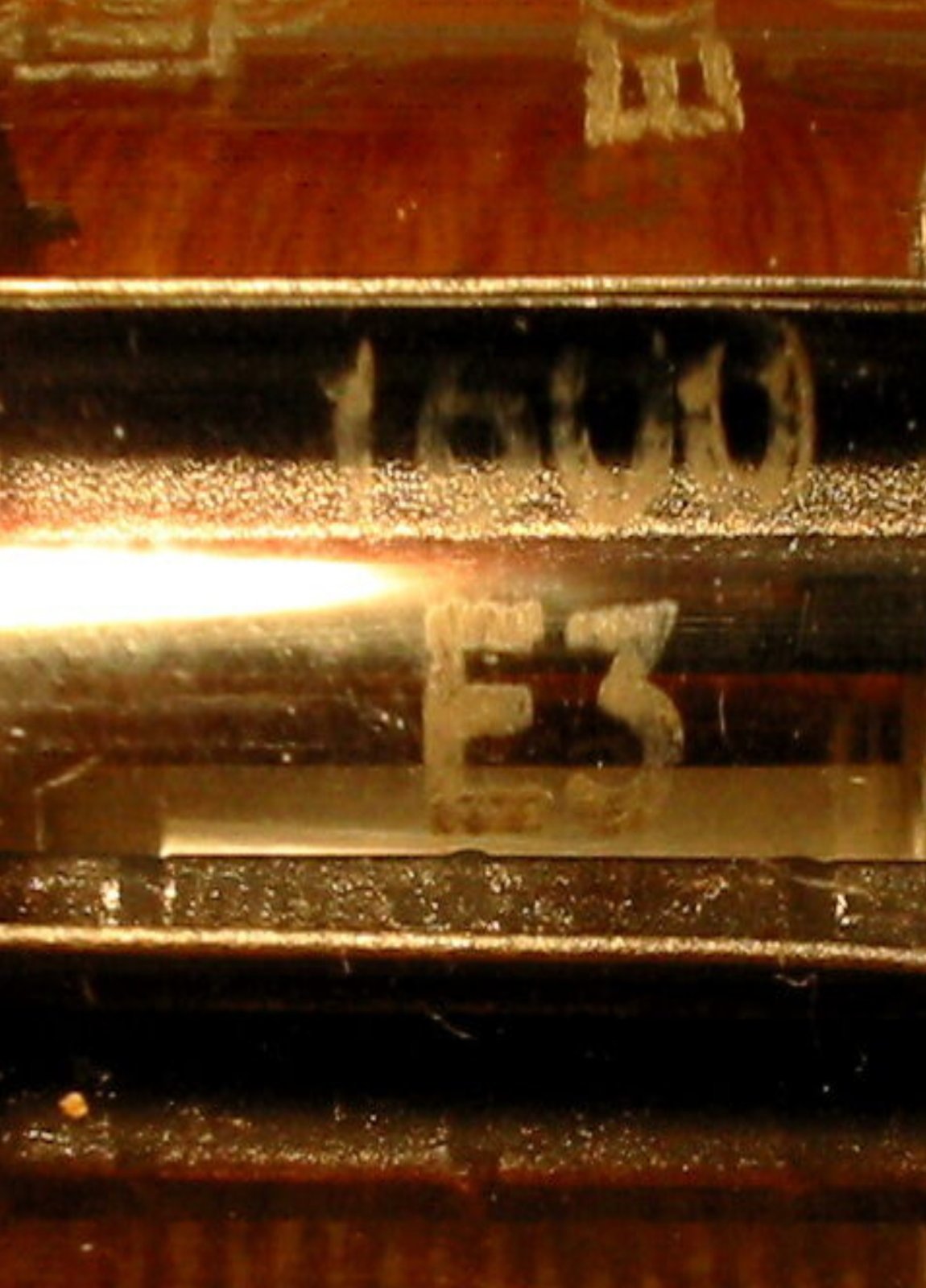

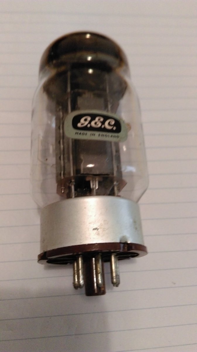

 I will add my tuppenceworth here if I may,
   I've been running tube gear for a bit over 25yrs (that's not as long as quite a few on here though) I do not own a Wilsenton, but I've owned classic, Chinese, American tube amps running EL84, 6L6, 5881, EL34 family, KT88/6550 with both solid state, and tube rectification.
    The actual input tubes will make the greatest difference in sonics. 6SN7's can be really microphonic, I've had many NoS one's that as I turn the stepped  volume attenuator, the 'clunk' comes out of one of the speakers. So you can either 'put up with it, or have a small collection of 'those tubes'. You'll read plenty of advice to get XYZ brand with triangular square getter <(joke) etc. These are often 'holy grail' tubes. I have some for sure, but I reserve their use for those 'special' listening sessions. The average brand 'NoS' tubes will outperform 90% of modern production, and are often a lot cheaper than the 'boutique' modern ones.  There is a subtle difference between say KT88 and 6550 tubes in sound, but the EL34 setting is where you will have the most fun, EL34/KT77/6CA7 all plug and play in the EL34 setting. However you have 3 very different construction tubes the KT (tetrode), EL (pentode) 6CA (beam) they all have subtle differences in sound. The 6SL7 will obviously also make a difference in sound The 6SN and 6SL will make the greatest difference in your amp.
       However the rectifier tube WILL indeed make a subtle difference. (the 'voltage sag' and current delivery) So even different brands of rectifier WILL make a very subtle difference. Also the bass performance especially at higher volumes produce a difference between valve and solid state rectification. My current amps use tube rectification, but even the manufacturer recommends a particular solid state rectifier if you are frequently on high volume settings. (the SS one can give double the current delivery of a GZ34) Here you need to be 'careful' and something I have experienced personally. Depending on your HT voltage, you could have 500v+ HT on the tubes (mine does) which 'allows' for the voltage sag of a tube rectifier. Putting in a simple replacement SS rectifier the voltage goes up on the tube HT line, pushing these modern production tubes close to the limit (my amp HT voltage).  You are likely to get a little firework display inside the tube quite 'early' with many of the cheap KT88/6550 tubes.  I owned a Radford STA-100 classic amp, which gave 100 watts per (1960's design) this amp got 100 watts from a pair of KT88 by running 600v on plate and screen. NO modern KT88 has the build quality of old. It had a 20+yr old quad of GEC's in it, which were replaced. 1990's there was nothing like the current selection of tubes (brands) in production. Any of the then Chinese made tubes (often gold dragon) would give a firework display, within a couple of weeks at least one, by 3 months? all 4, gone. The best tubes in that amp then were the Svetlana 6550C, but even they were 'done' by about 12-16 months. If you go solid state rectifier, I'd strongly suggest the weber coppertop WZ68 if your rectifier is GZ32 or 34, this is the one used in my amps (recommended). It is the one that gives double the current of a GZ34, BUT, it has a large resistor in it that reproduces the voltage sag found in a tube rectifier keepin g the HT correct.
 My final thought and GRIPE, the new Mullards, Gold Lion, Tungsol etc are NOT 'reissues' they are simply a brand name owned by that group. Modern tubes are not produced with the precision, care that was required back then, and as tubes did 'everything' in a circuit, those factories scrapped 'defective' tubes.. these days 'seconds' seem to find there way onto the 'cheap supplier' market on eprey etc. If you want to get a bit of insight on that, google for the comparison between a genuine, and modern mullard 12AX7 where Matt Lachesky actually dismantled and inspected them both.

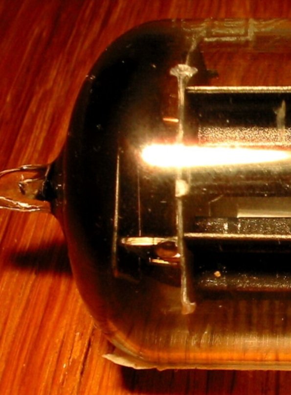

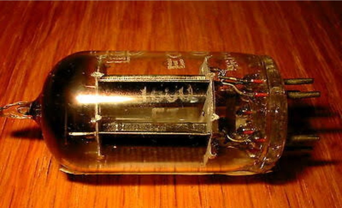

A very fitting post by @Graywulf and to share the same sentiments let me share the first ever Mullard 12AX7 valve made in the Blackburn factory in 1953 by those female engima machine decoders a decade earlier. Distinct features include 17mm  black toasted welded plates, wrinkle glass and square goal post getter. These are pre mC1 and are all coded 1600. While I'm at it let me throw in the GEC TT21 from 1960.
