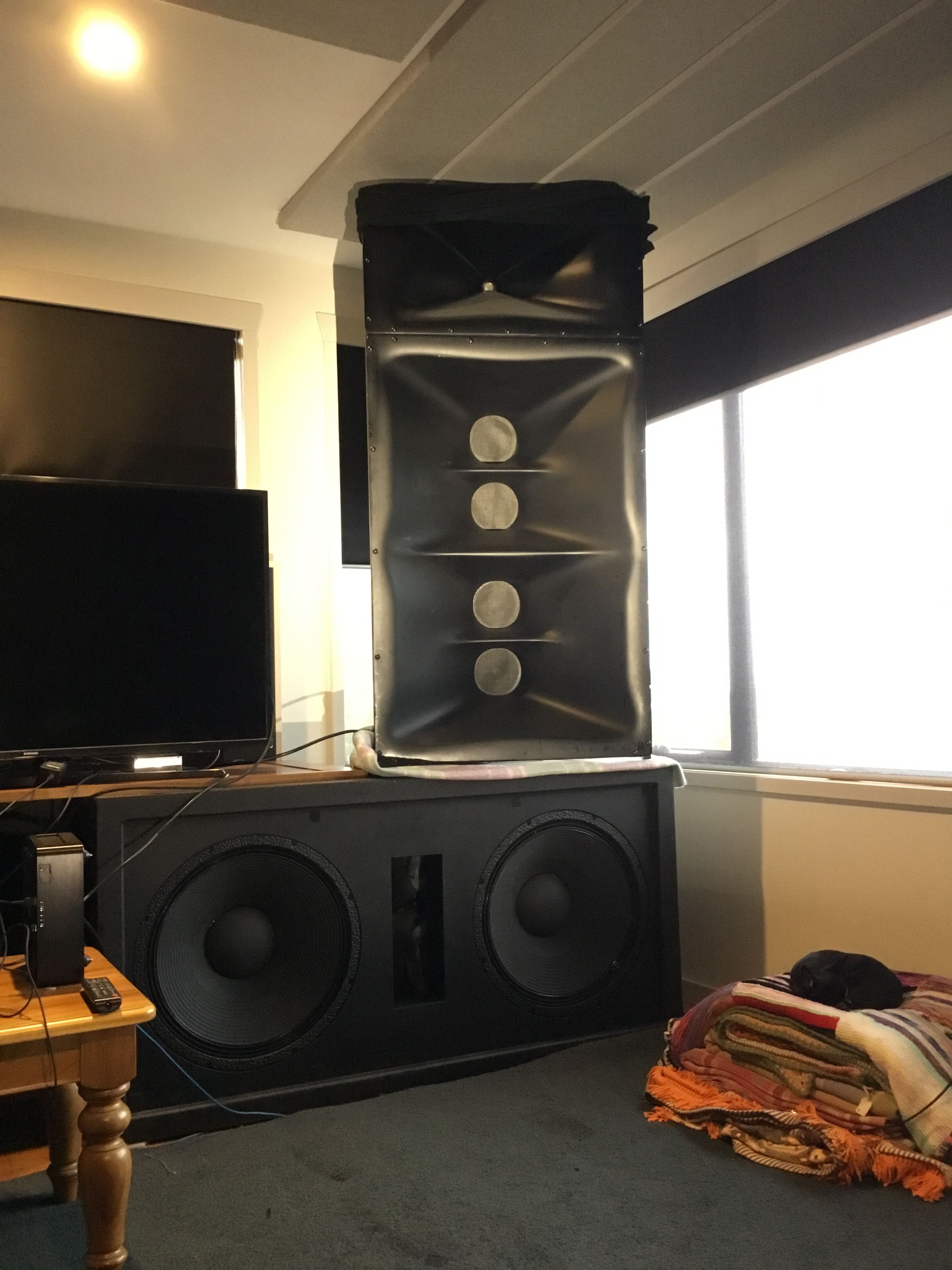

Carpet and curtains suck the life out of the music, they're like putting up massive absorption panels that only absorb over 2-3KHz and you can't thicken the 'panels' or add an air gap to make them broadband.  It's really hard to then add proper absorption for broadband treatment, you've always got that high end sink.
My big room, casual listening, sounds much better, it has some pull down blinds that are backed which are usually open and a tiled floor.  When I add absorption it produces a reasonably even response and the  room has 'air'.
Id love 5o try my TAD speakers in this room but they're too damn heavy to move.

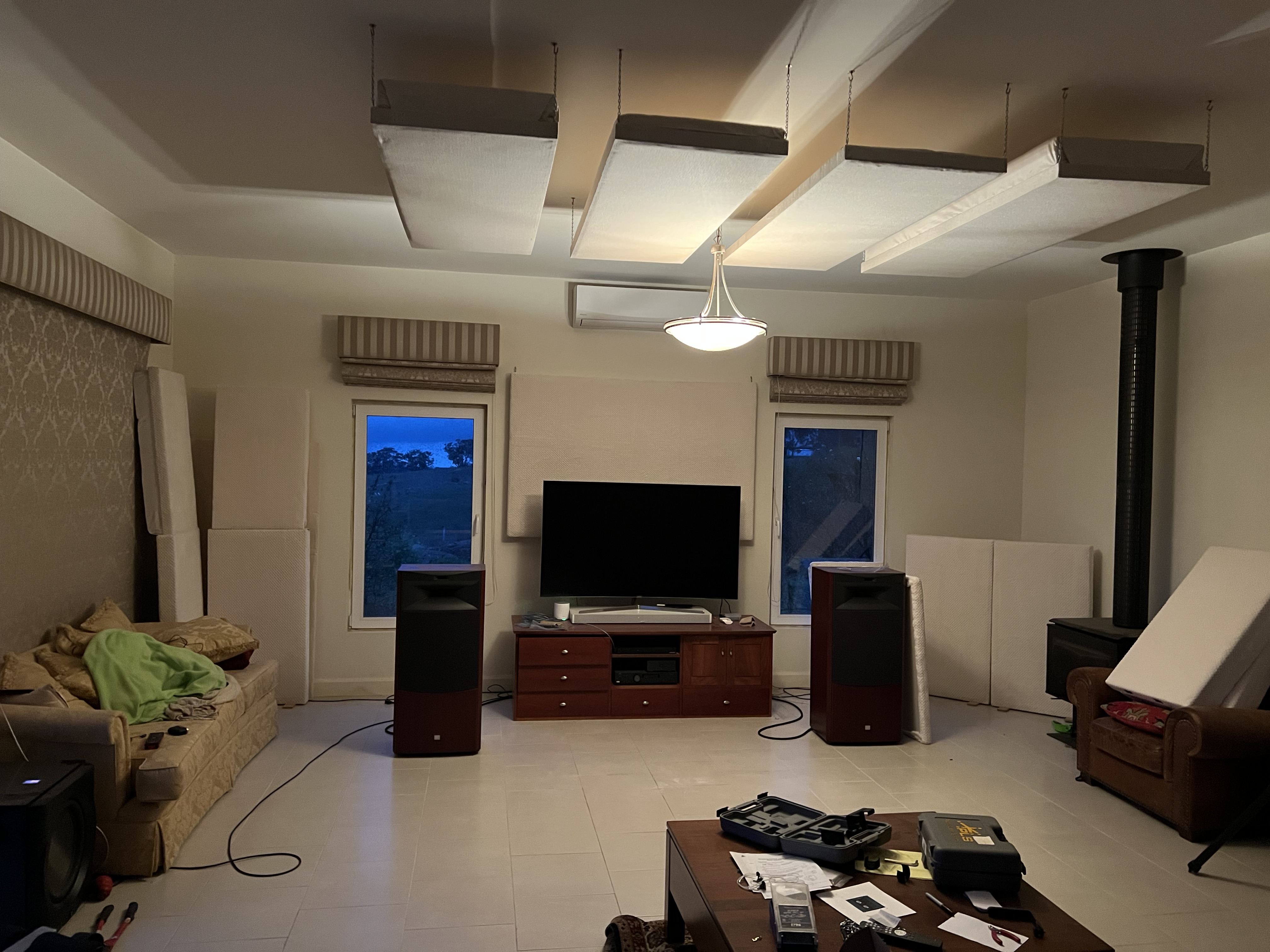

Don't waste too much time on my chart, all I did was stand some treatment in two corners. some on the side wall and behind the TV.  It was just a starting point.  I've since properly fixed the treatment behind the TV and the at the first reflection point.  I've also added the cloud and I will do the corners properly next.  What I did got rid of all the ringing in the room and I did the measurement just to see what I'm working with at the start.  The corners will have treatment on the diagonal and filled behind, not just leaned against the wall and the cloud will have made a lot of difference, just with first reflection off the ceiling.
I'll do another measurement when that's all done.  Music in here sounds very good though and to me that's the point.
See picture of treatment so far...  As you can see I've taken down some of the corners and I'm working out framing for those in the right hand corner to begin with, the cloud shown wasn't there when I did the last measurement.

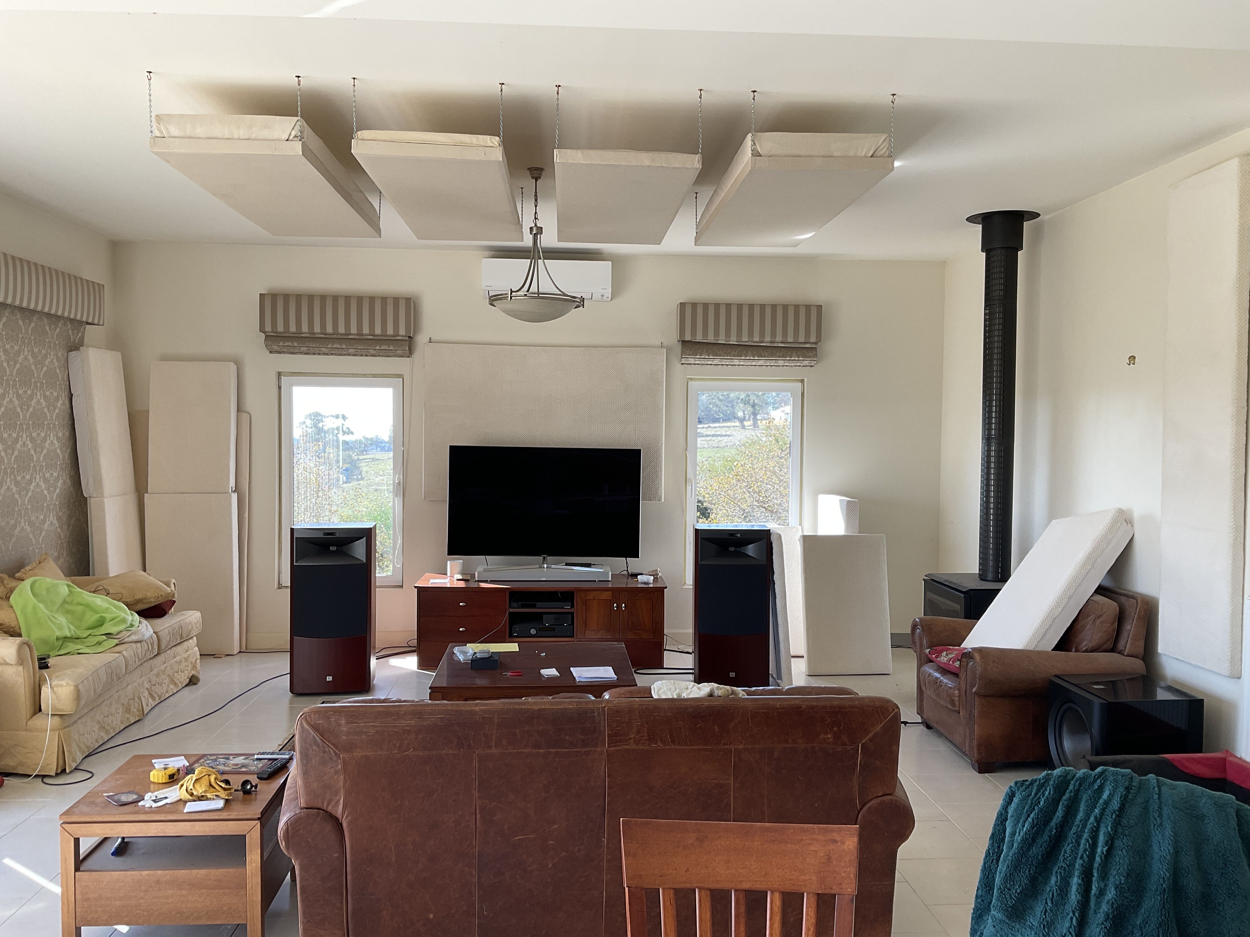

No, from the front wall.  The lounge has been pushed out the way to manoeuvre the ladder around to hang the cloud treatment.
Here's how it looks now, you can also see the narrow panel on the right, the same is on the left.
Ive taken some of the panels out to do some framing work on them and get them setup properly.  I got all the treatment with some gear I bought, so I'm reusing it as best I can.
