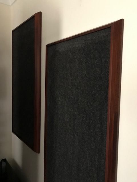

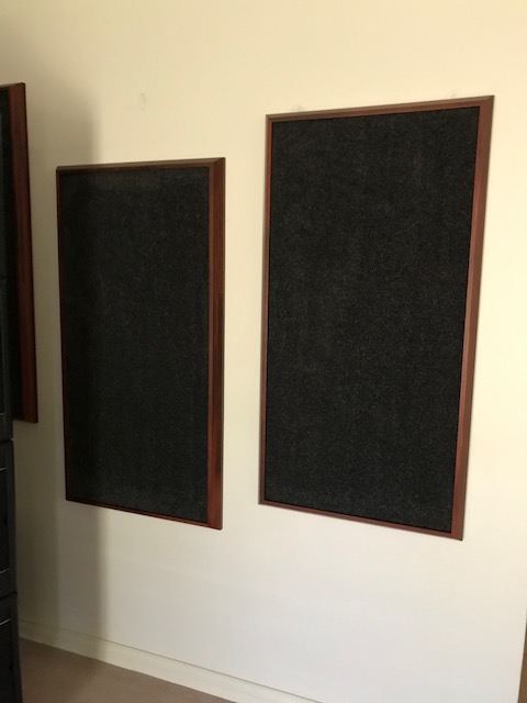

Just finished making 4 - 1200 x 600 HF panels, again using recycled jarrah for the frames and also managed to score a roll of high quality charcoal color carpet very cheaply.  These should be very effective for reducing slap and echo, and hopefully will blend with the decor when I repaint the room.
They look great Pete.
What have you used behind the carpet?
  • Author
Thanks Jon.
The carpet is glued with spray contact adhesive to 8mm MDF with a 15mm MDF frame. Very cheap, just time consuming! I then glued and nailed a 45 degree angle cleat at one end and also on one side (centre) to mount either vertically or horizontally - still undecided.

I managed to install the block matrix diffusers and HF panels. The results are not huge, but noticeable with improved clarity and dynamics. Surprisingly they actually look pretty good too. I tossing up on making another 4 x smaller block matrix diffusers or a couple of HF panels to go above the TV, and then I think I'm done.😎
