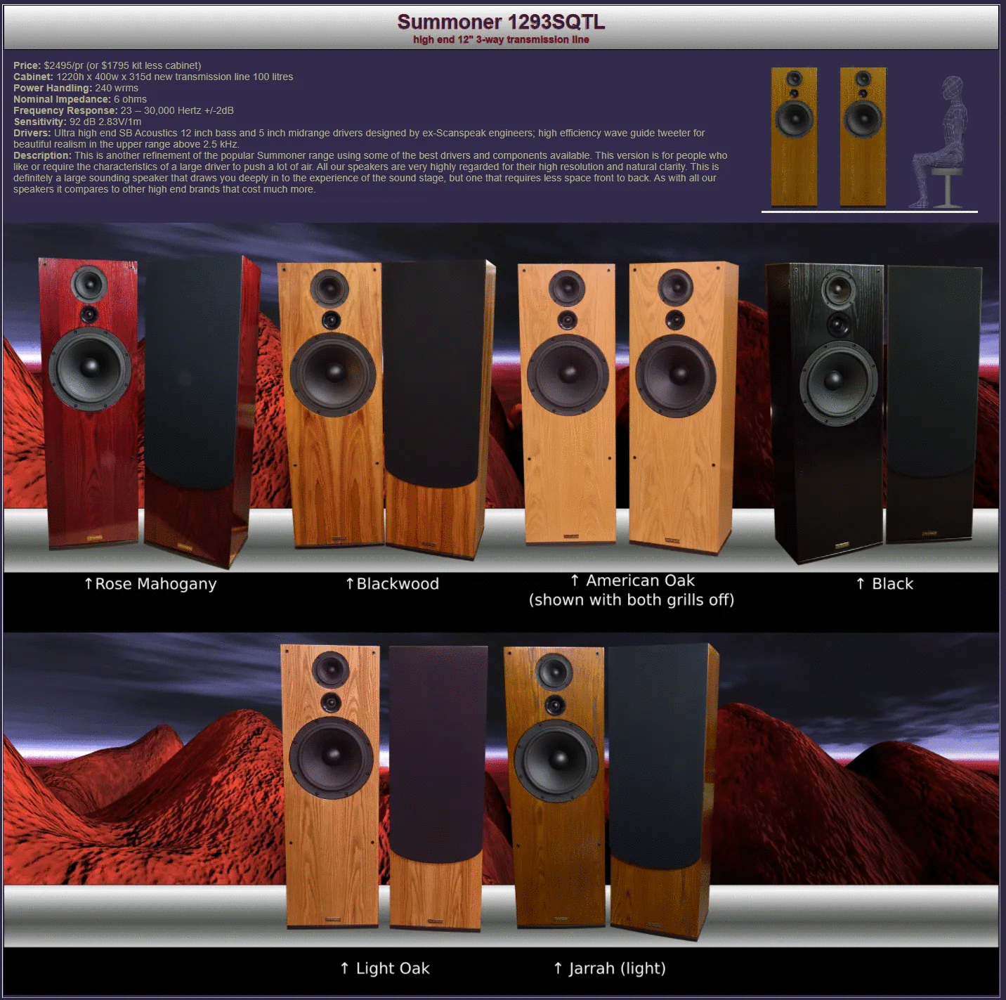

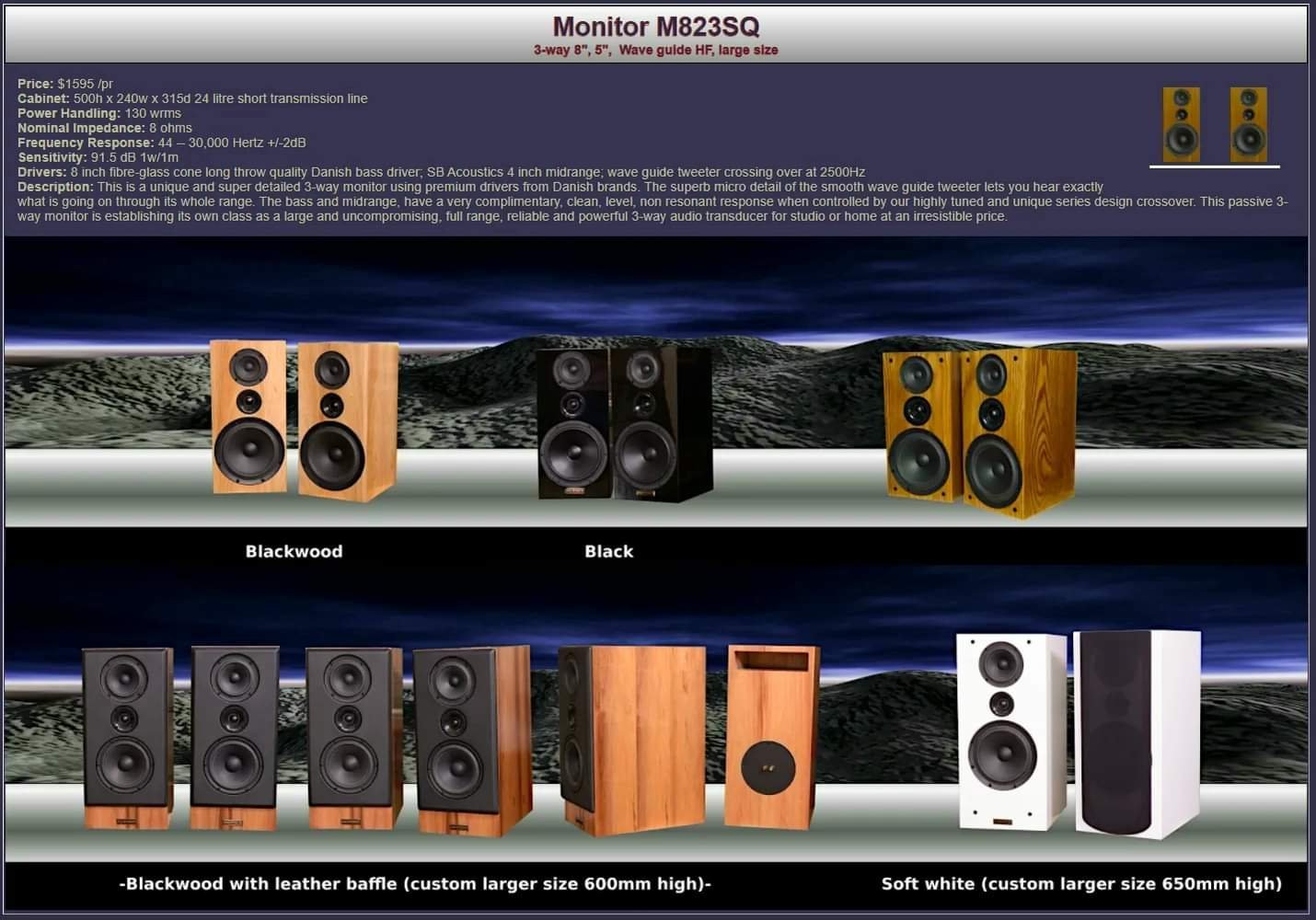

Main speakers will be 9x Adelaide Speakers "Ascension" Summoner 1293SQTL 12" speakers. 2 subs will be Harbottle Audio C24 24" subwoofers. Atmos speakers will be Adelaide Speakers Monitor M823SQ with modified dimensions to be able to sit closer to the ceiling (just need to either make or find something to mount them to the ceiling, unsure atm on options)
